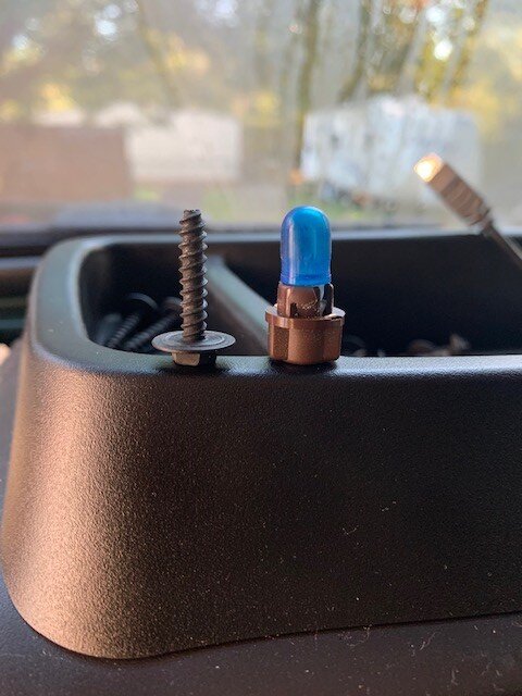

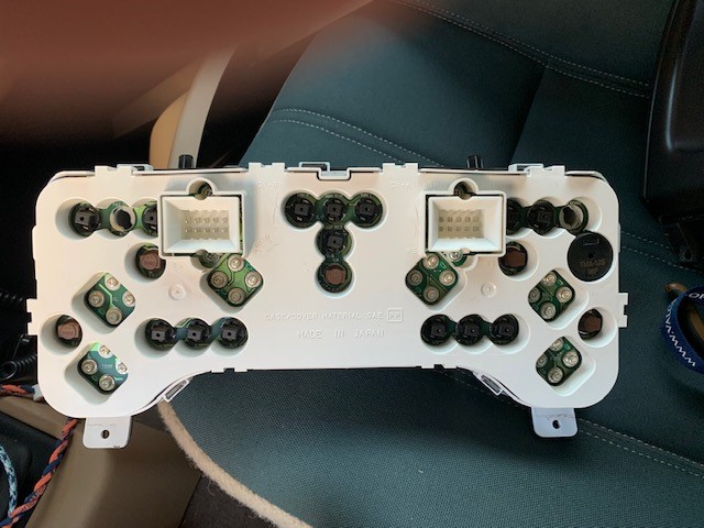

I removed my gauge cluster to see what bulb sizes I needed to order and found 21 different bulbs. Several have brown bases, but most have black bases. Does anyone think 4mm would replace all or a combo of 4mm and 3mm? Thanks! Confused also that some are missing. Should I replace those also? Any help would be greatly appreciated.

I just replaced the 5 with LEDs, mine had a flat black bottom with the blue over the bulb. Got all the info off the write up on this forum.
I removed my gauge cluster to see what bulb sizes I needed to order and found 21 different bulbs. Several have brown bases, but most have black bases. Does anyone think 4mm would replace all or a combo of 4mm and 3mm? Thanks! Confused also that some are missing. Should I replace those also? Any help would be greatly appreciated.View attachment 194161View attachment 194165View attachment 194166
Your cluster may look a bit different, but the only bulbs that should be replaced for the backlighting in the cluster are these:
The 74 LED is the correct bulb for the cluster.
