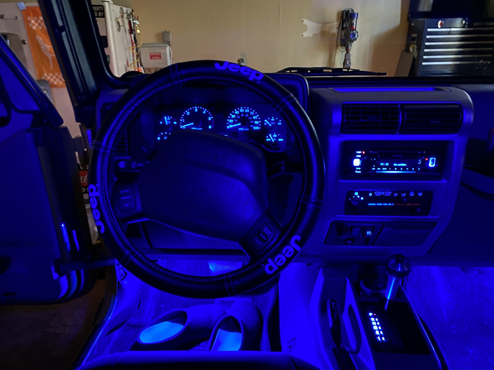

The footwell lights in my 98 are #89 bulbs. There are adaptors on Amazon to the 194 bulb. I am going to use those because I want the lights to be uniform. My HVAC lights are the same as the cluster and only use 2 bulbs. The fog light switch “on” indicator has a green lens so my blue bulb there doesn’t really change anything. It will also need to be a 3mm as stated further along in the thread. Since I used two of my cluster lights on the HVAC i haven’t pulled the cluster pending getting the other 2 bulbs delivered. Will post pics when done. Also what I did on the shifter was use a 1/2 inch bit and drill out the socket. I then used heat shrink wire insulator to secure it. Be very careful if you do this because it leaves the socket wall very thin and you will crack it. Love the look with the blue so far. Some of my bulbs were getting dim and this has given my dash a great new look. I also like being able to match my aftermarket HU.

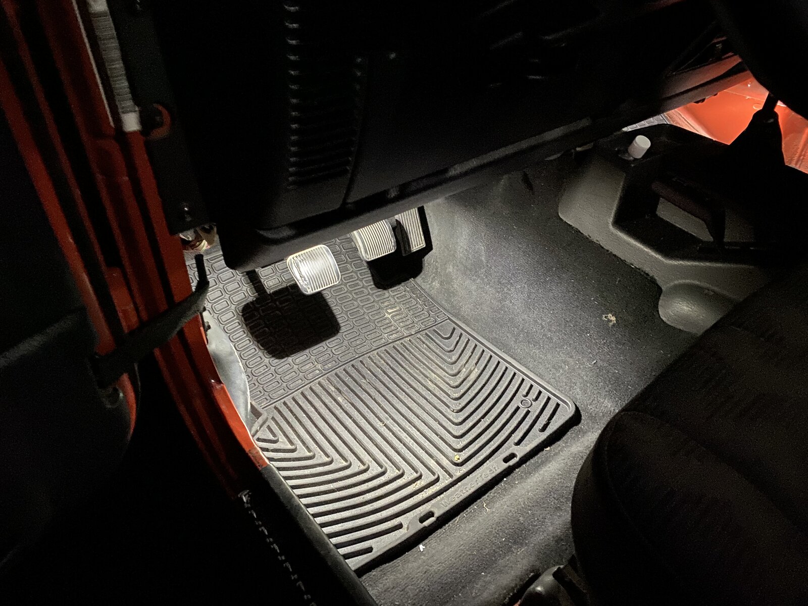

Replaced the dome and the drivers footwell bulbs and added an extra to the passengers footwell.
Can see everything in the TJ at night , without a torch
