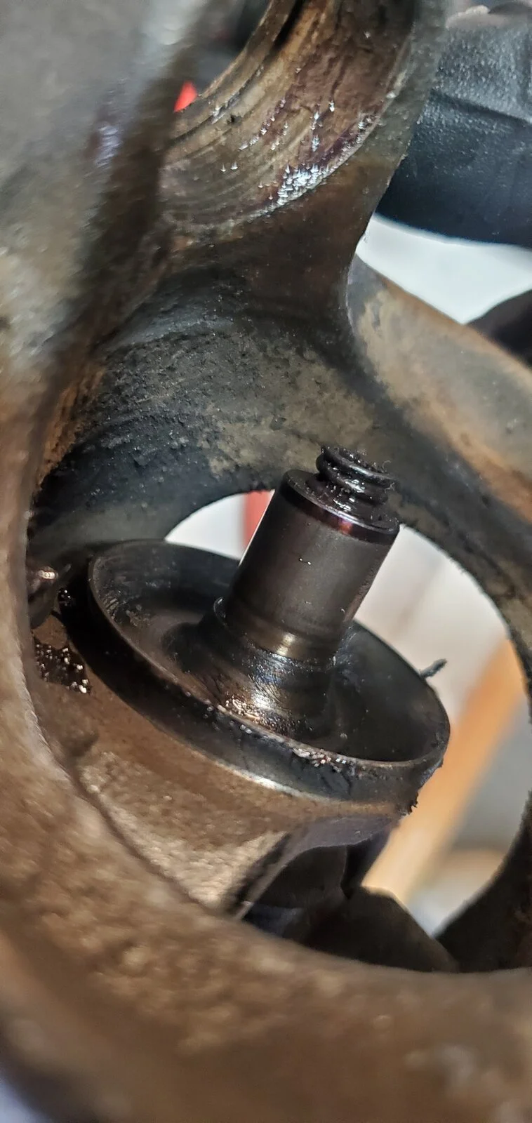

So now I am confident(ish) that it is not the rear diff making the sound so I began to investigate the TC. While trying to check for chain slop I noticed that my front hub bearing is completely shot. I am in the middle of replacing the hub bearing now but given the sound if from the mid/rear I don't think this will help with the sound.
