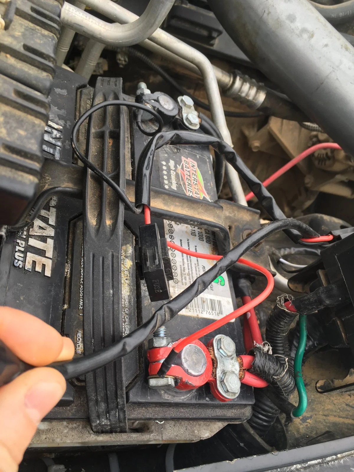

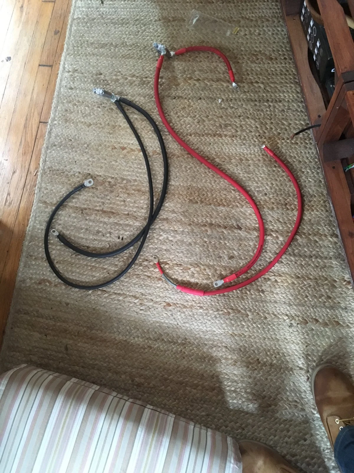

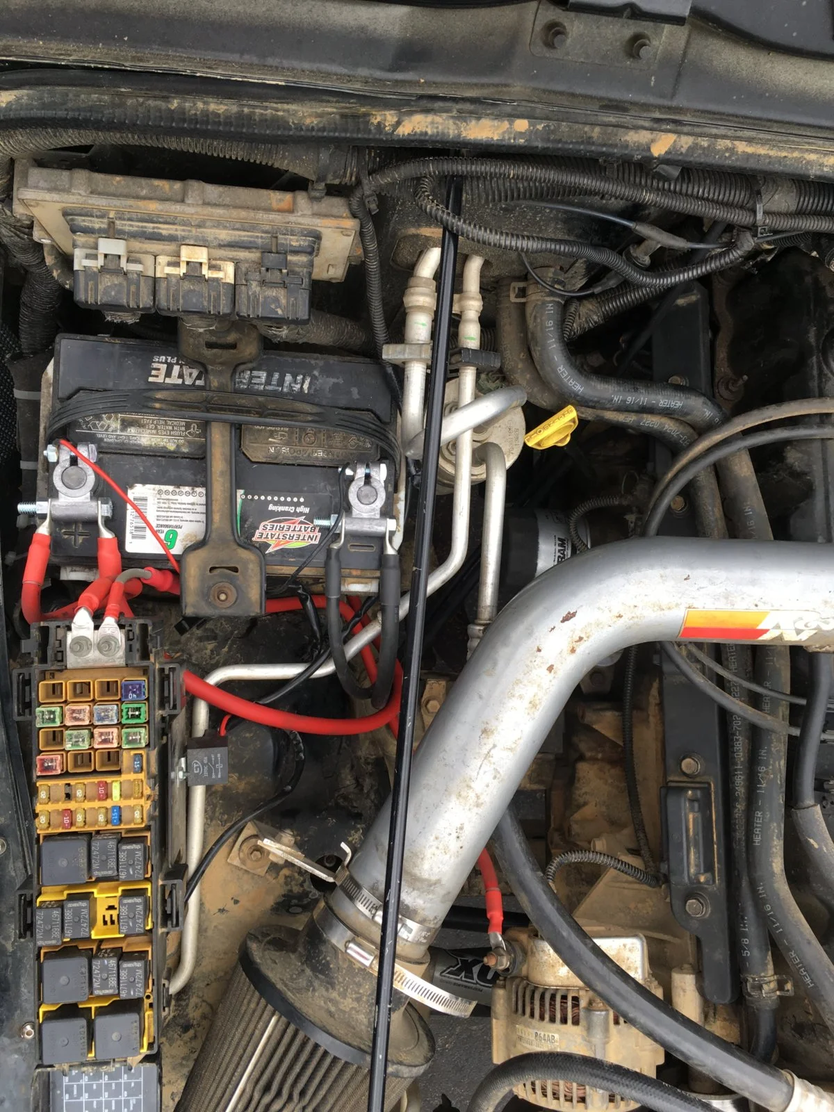

Oh and this week I added new battery cables and military style battery terminals.
82108
The Above replaced what’s below
82109
Sounds like you've got a lot to do, but also already accomplished a lot as well!
More details on the battery hardware would be appreciated.
Check out this post.
https://wranglertjforum.com/threads/recommended-battery-terminal-replacements.7779/page-4
I was able to order everything from BatterycablesUSA.com and they even included a fuse link for me at no cost. I think i paid like $68 for the whole thing.
Everything was pretty straight forward. i did have to dremmel out the plastic part of the PDC a little to fit the larger gauge cables but when its closed you cant even tell.
the only issue i ran into was the engine ground stud. It is a stud that screwed into the block and when I was trying to get the ground off it came loose from the engine and the wires,nut, and bolt all spun together.
82214
it was a pain...
I ended up snipping the old ground ( no going back now) and twisting it out a few turns to get a pair of vice grips around the middle ridge and after a few ugahduggahs it came loose.
ill try to grab a few pics of the set up and new cables

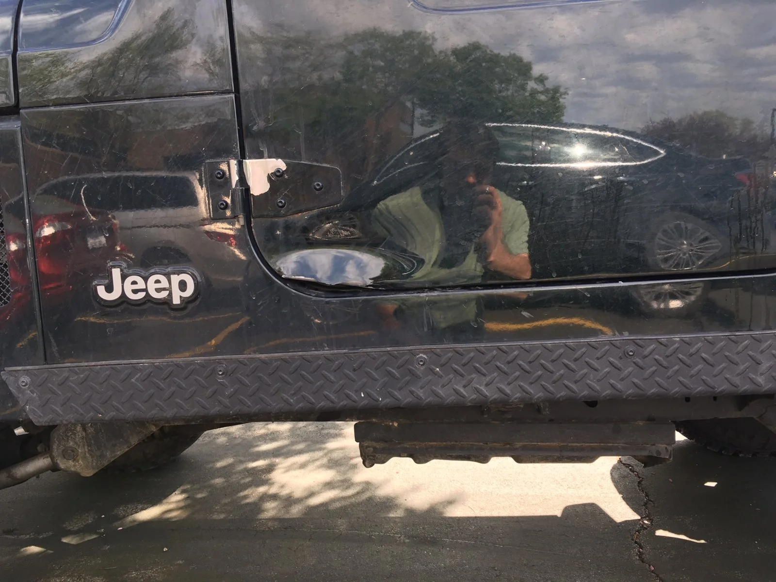

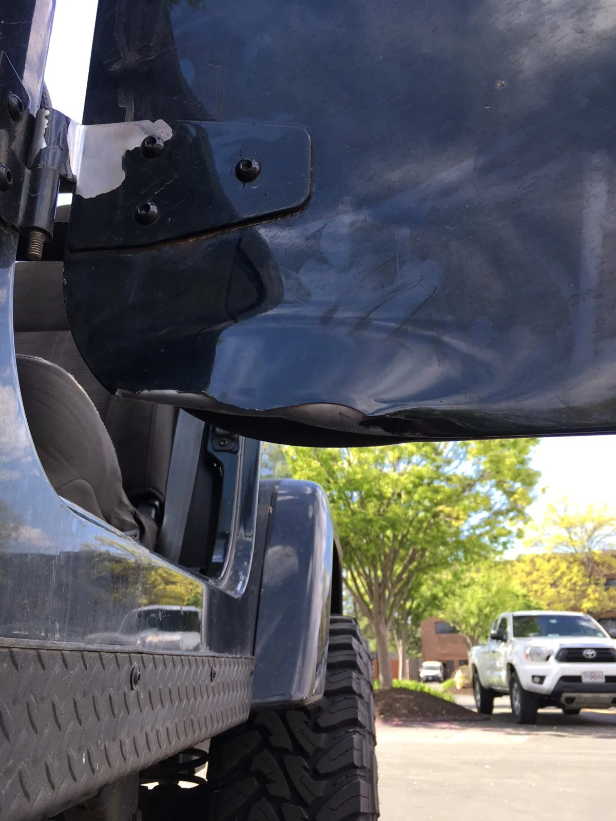

Yesterday was a very nice day out so I figured I would change those fluids above ( trans & transfer case). Before I headed to the store for some tools I decided to hang my doors in my new garage and use some existing hooks that were up there..... Thinking everything was secure I left to pick up a 17mm hex key so I could take off the plugs to the transmission, a soldering gun to heat up the door hinge bolts, a hand impact driver, and some other odds and ends.

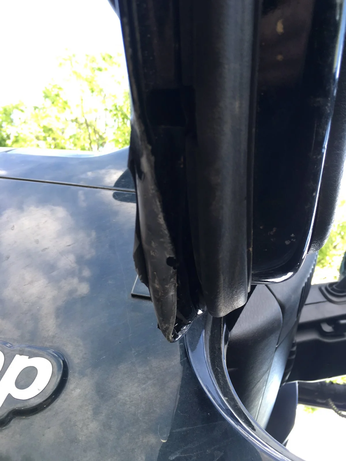

when I got back I found the driver side door had fallen and I about died on the inside. I almost lost all desire to even wrench yesterday. The bottom corner was bent in and rolled on itself. I'm lucky as it still closes and functions as a door and only one was damaged. It's just that i was already having a hard time looking at the door hinges paint coming off and now i have to look at this dent all the time!
I know i have some other repairs coming up next but this is just such a sore thumb I think ill try to tackle bending this back and the fixing the hinges next
Here are some pics of the damage.

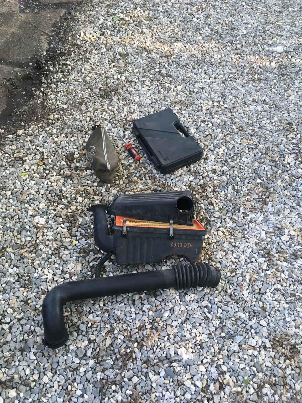

Today I received an OEM air intake assembly from Daveysjeeps and swapped it out with the K&N cold air the P.O. put in. Having removed the intake tube before it was a piece of cake. One bolt holding a bracket was rusted and when I was cranking on it the bolt snapped. Lucky me! I was about to dremel it off.
I was doing some trail riding a last week and was going over about 30 inches of water a little too fast and got a LOT of water in the intake. Luckily I was able to get it running and let it dry out. After that I knew I had to move that up on the list. Bing bang boom, the new intake is on and no more worries about water ( or at least a lot less worries)!

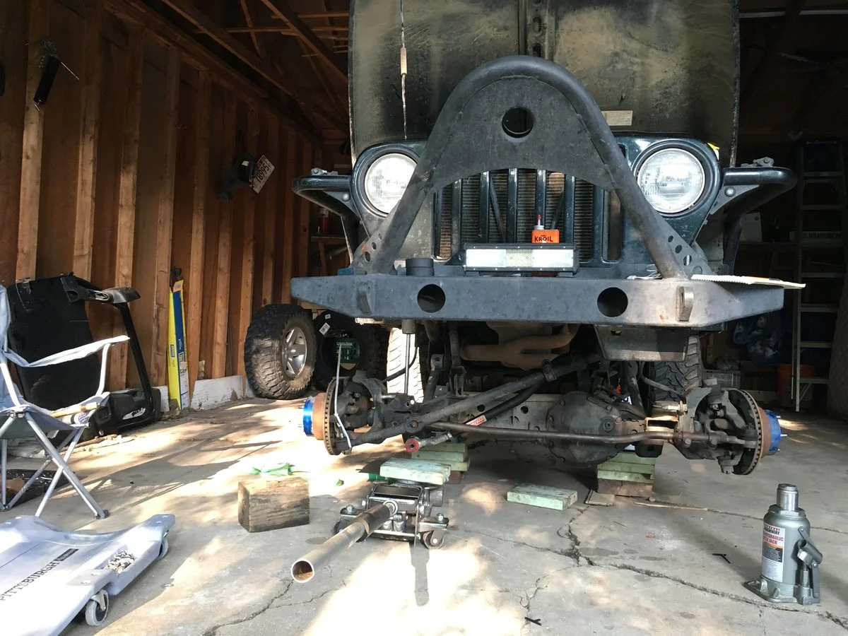

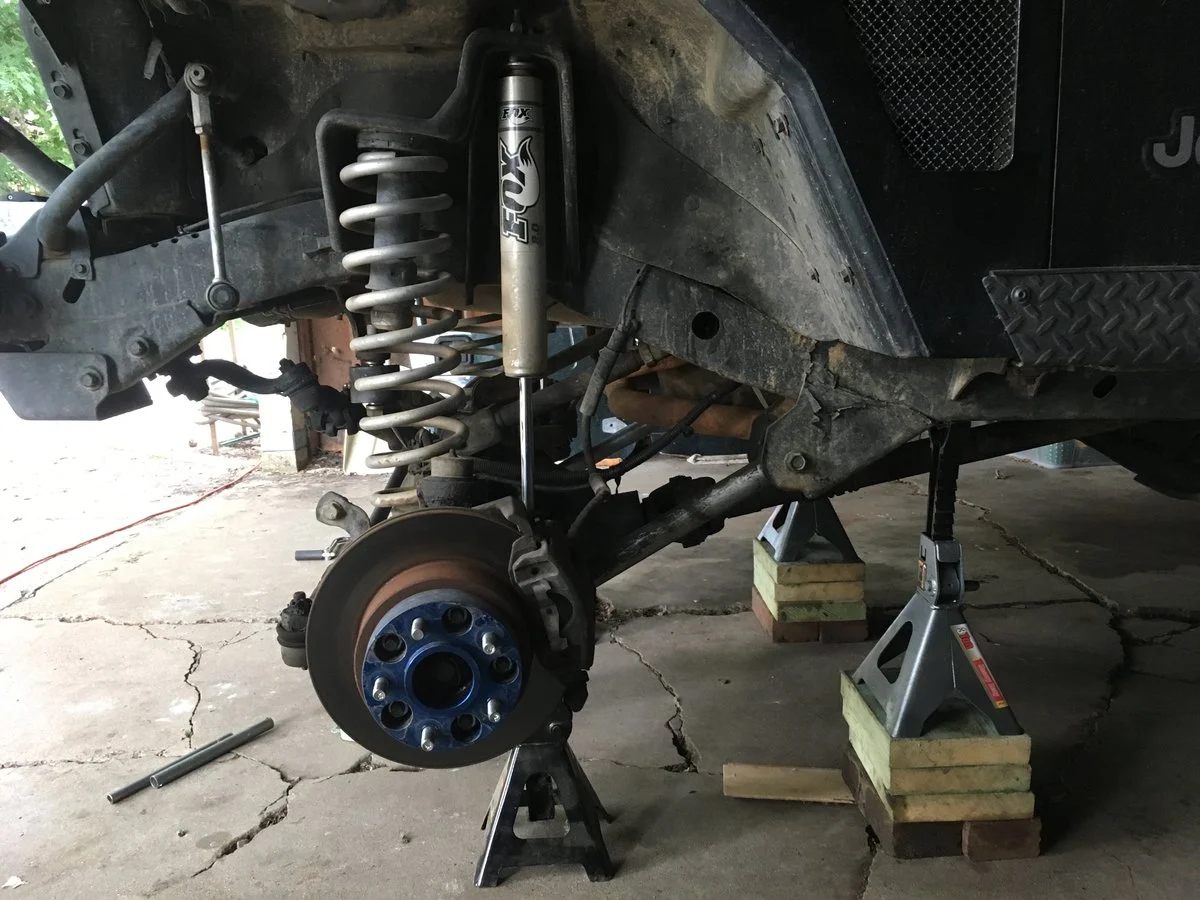

Been under the Jeep quite a bit lately trying to prepare for a trip to Colorado.

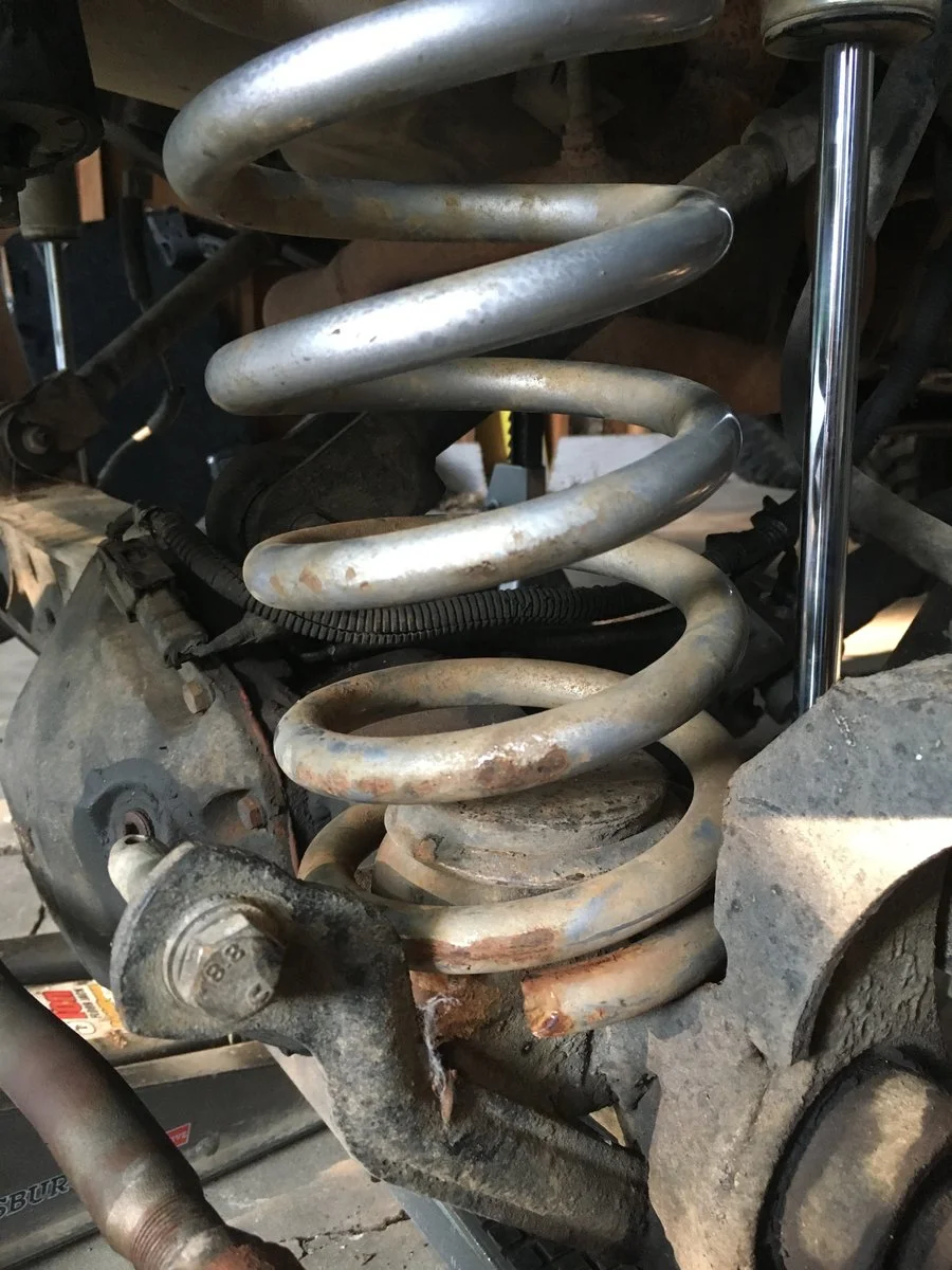

First thing on the list was cycling the suspension and checking bump stops. But that’s just where the fun started.

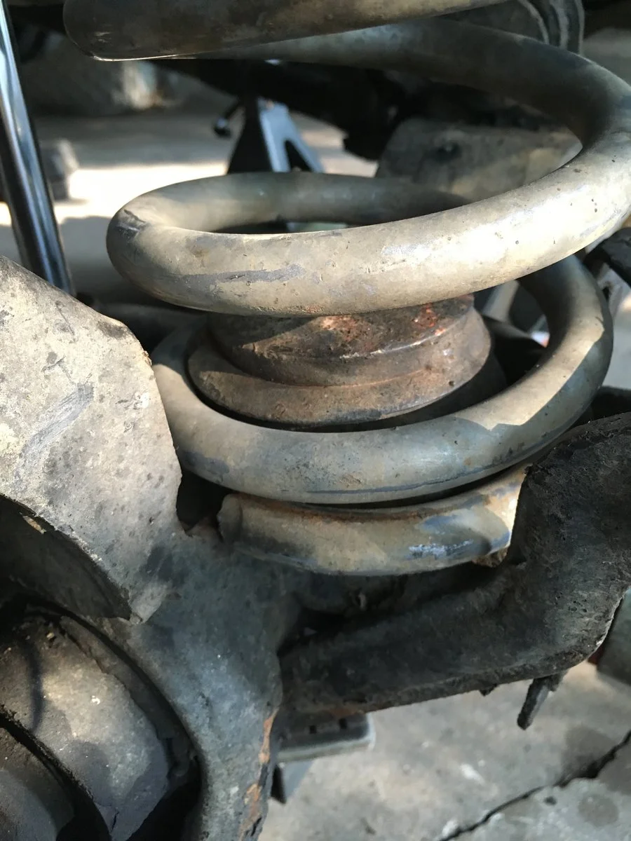

I had never taken the shocks or springs out before and without a big floor jack boy that was fun. I had to juggle the axle between 2 bottle jacks and every time it started to slip I stopped and adjusted the stands and jacks.
I took a moment to look everything over and saw I have some issues with my dampener. I figured to just replace with the Monroe model and move on. So then I busted the threads on the u bolts and the plate was slightly bent. Pressed that flat and going to get new bolts tomorrow.
The neighbor saw me and offered some conversation and help in the form of tools. I now have a floor jack to use and it is making the whole process a whole lot easier!
He also said I could use his air tools! Bonus for when I have to get the pinion nut off!

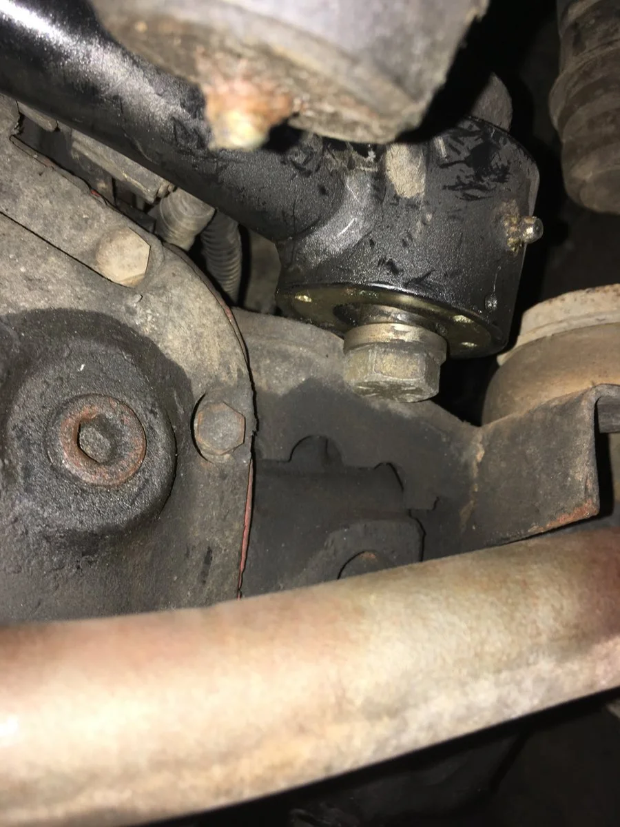

So I’m checking the clearances and notice my track bar hits the truss of my axle.
At this point I decided to start from the bottom and put it all back and do an wheel alignment. That’s as far as I got on that really.
I also got some Kroll in the mail and put Some in the nuts for on the drag link. Now the sleeve is like butter! Best and pb both failed where this stuff was amazing. So my steering wheel is straight, or atleast will be easy to make straight when I’m done.
I then started to adjust the track bar but called it a night.
I recently moved and now I have a different garage.. this one had some cracks and isn’t a nice flat smooth surface. It’s relatively flat but not level. How much should I expect that to play a difference in my adjustments.
I guess I’ll have to do my best and worst comes to worst find a somewhere down the road or something to make the final adjustments.
After I finish the track bar I’m going to try and check my bump stops again for alignment.
I’m worried they won’t lineup nicely and I’ll be in for some new adjustable control arms.
Back to the truss, if I can’t get the axle/truss to clear the track bar l will end up cutting into the truss to gain the clearance I think. It’s unfortunate but I don’t see a way around it.
Side note:
Fun trick I was using for the shocks was a ratchet strap the hold compressed while installing and uninstalling. I’ll get a pic tomorrow.
Also the come along is way better to use when pulling the axle against the Frame for the track bar.
Also going to try and see how everyone’s springs are placed on the bottom of the axle.
The last rung in the coil, how should it be oriented and does it even matter?

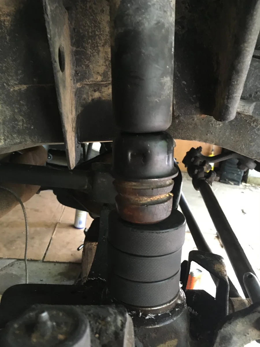

Finally got those bump stops on, going to get my angles all 100% before I decide on how much to cut down from 3 pucks. The track bar was hitting the truss and. Is it doesn’t but once it’s all properly aligned I’ll try again.

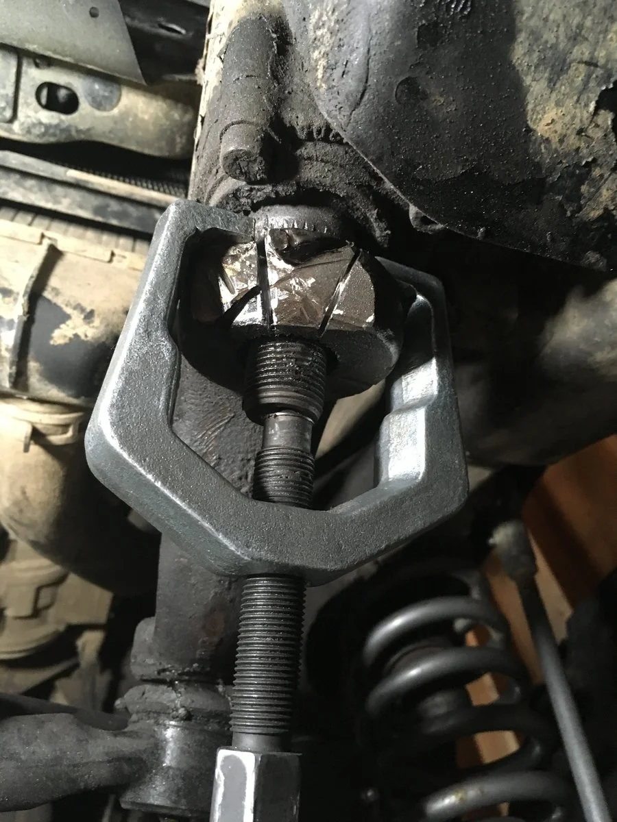

I figured while I was in there it was time to switch out that pitman arm. I rented a pulled and a 32 mm socket from the local parts store.
The socket was very tight and made an indent in the nut.
The nut came off with an electric impact fairly easily.
The pitman arm was not easy.
I tried kroil and mapp gas and constant tension over 2 days. Nothing was working so I decided to cut into the dropped pitman arm so I could remove it.
I made many cuts trying to be careful of the splines.
I used the angle grinder when the cut off wheels couldn’t get any farther in. I made more “relief cuts” but I don’t think they did much. Nothing seemed to do the trick so I decided to go deeper. I ended up cutting the arm in half about 1/4 of the way and it came off. No real damage and on goes the new one!

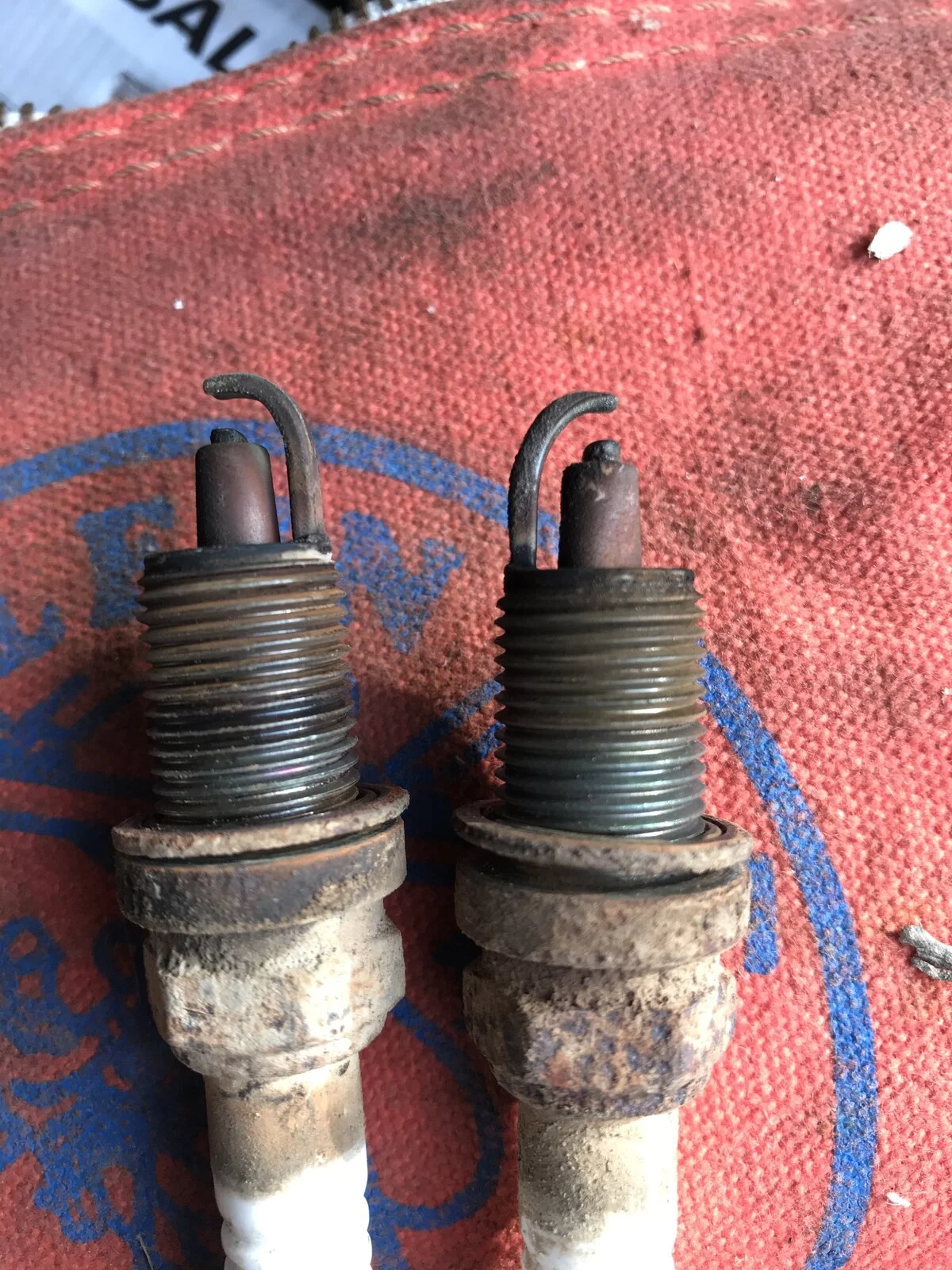

Recently experienced a misfire on cylinder 2 and followed the thread here to trouble shoot https://wranglertjforum.com/threads...the-dreaded-misfire-and-how-i-solved-it.4212/
the first thing I did was change the spark plug locations then test the coil rail. Switching the spark plugs didn’t do much anything as the P0302 came back with a bite. One morning my Jeep didn’t start but luckily the new plugs had come in. I installed all 6 new plugs and she was firing on all 6 cylinders.
The videos I took are too large but I friend the lights off and put a threaded rod close enough to contact the springs in the coil rail and turn red the key. I had the phone in slow motion so I could easily tell if everything was firing in sync.
here is a pic of the old crusty plugs that were gapped around .6 -.7

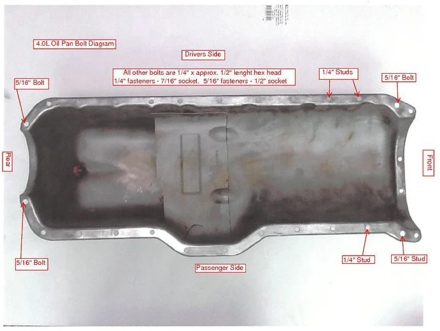

2nd, I finally got around to doing my rear main and oil pan gasket since the exhaust was coming off anyways!
