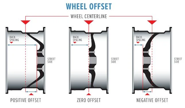

Here's a diagram from google that describes offset and backspacing:
The tire will almost always center itself on the wheel centerline, so you want to maintain the centerline location to maintain tire location.

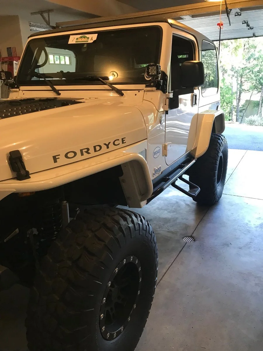

15x8 wheels with 15X12.5x35 BFG KM2's no problems at all and I air down to 10-12 psi and have not lost a bead yet, knock on wood. Don't let those pretty wheels in the first picture fool you.
