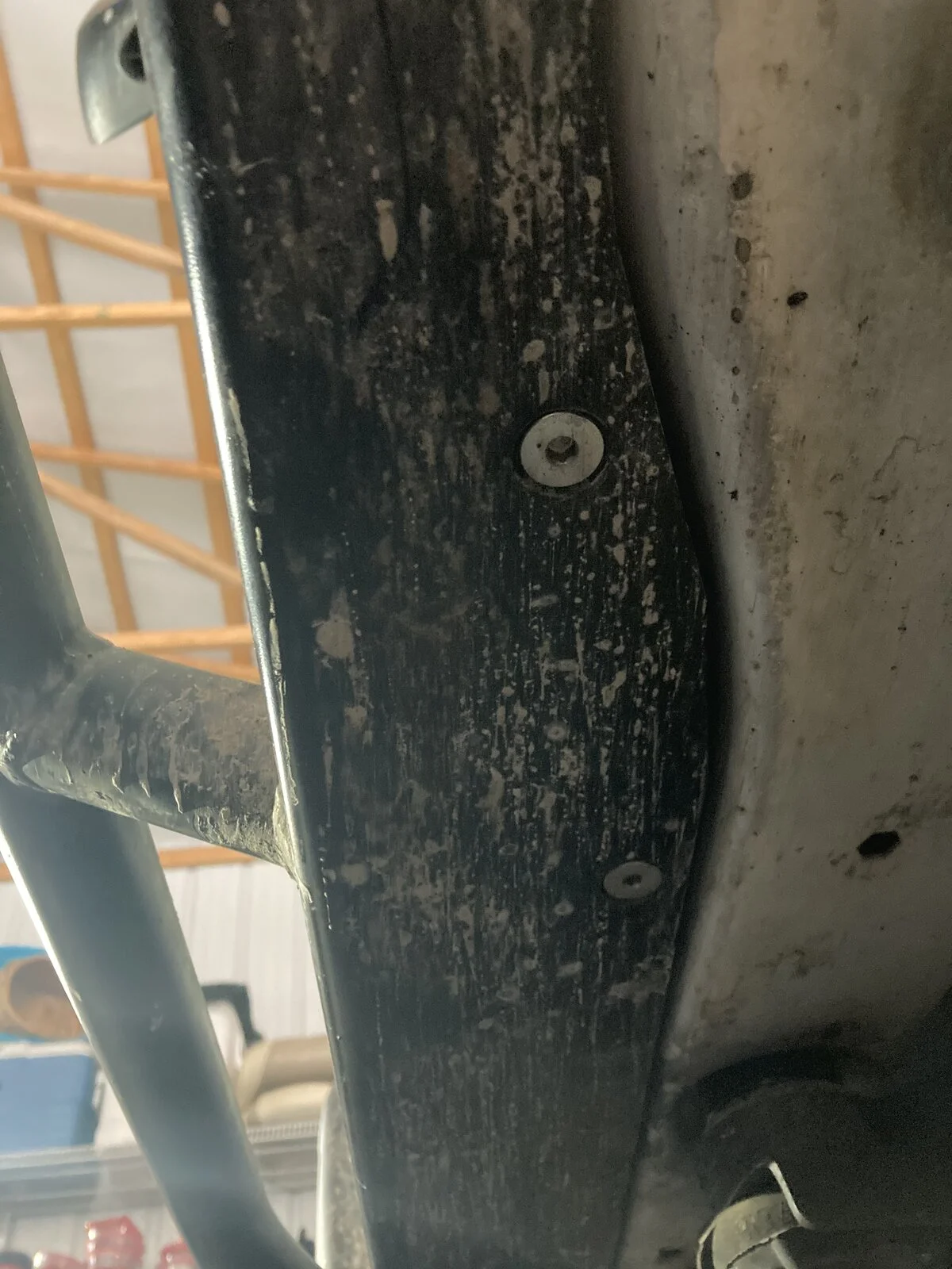

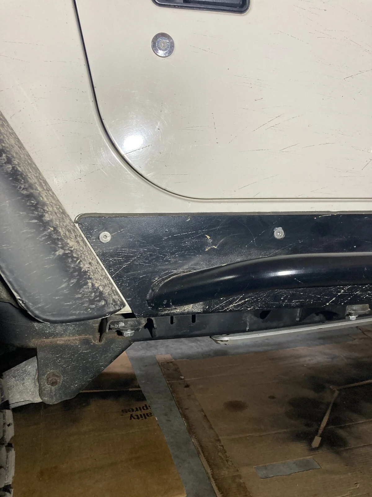

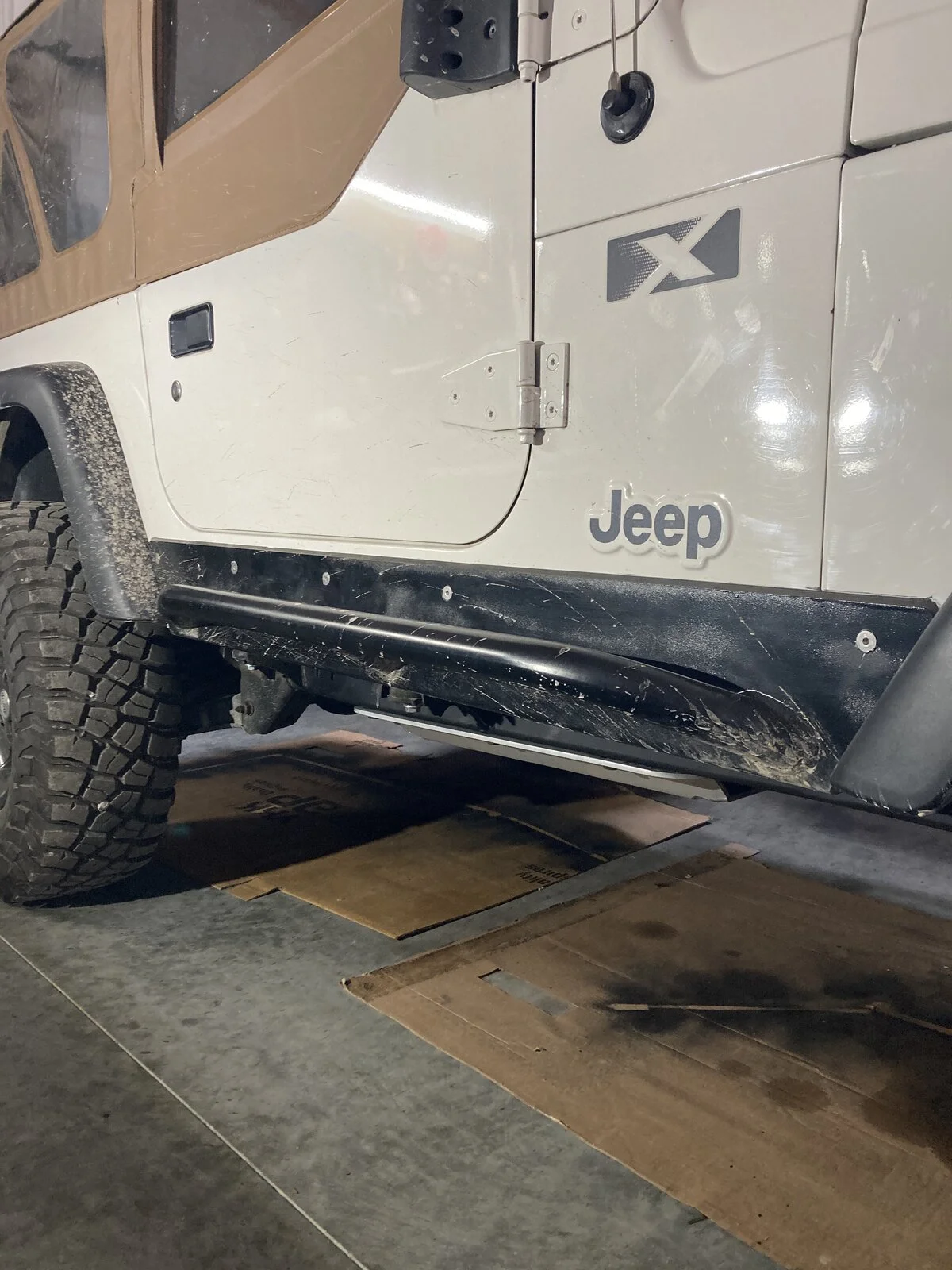

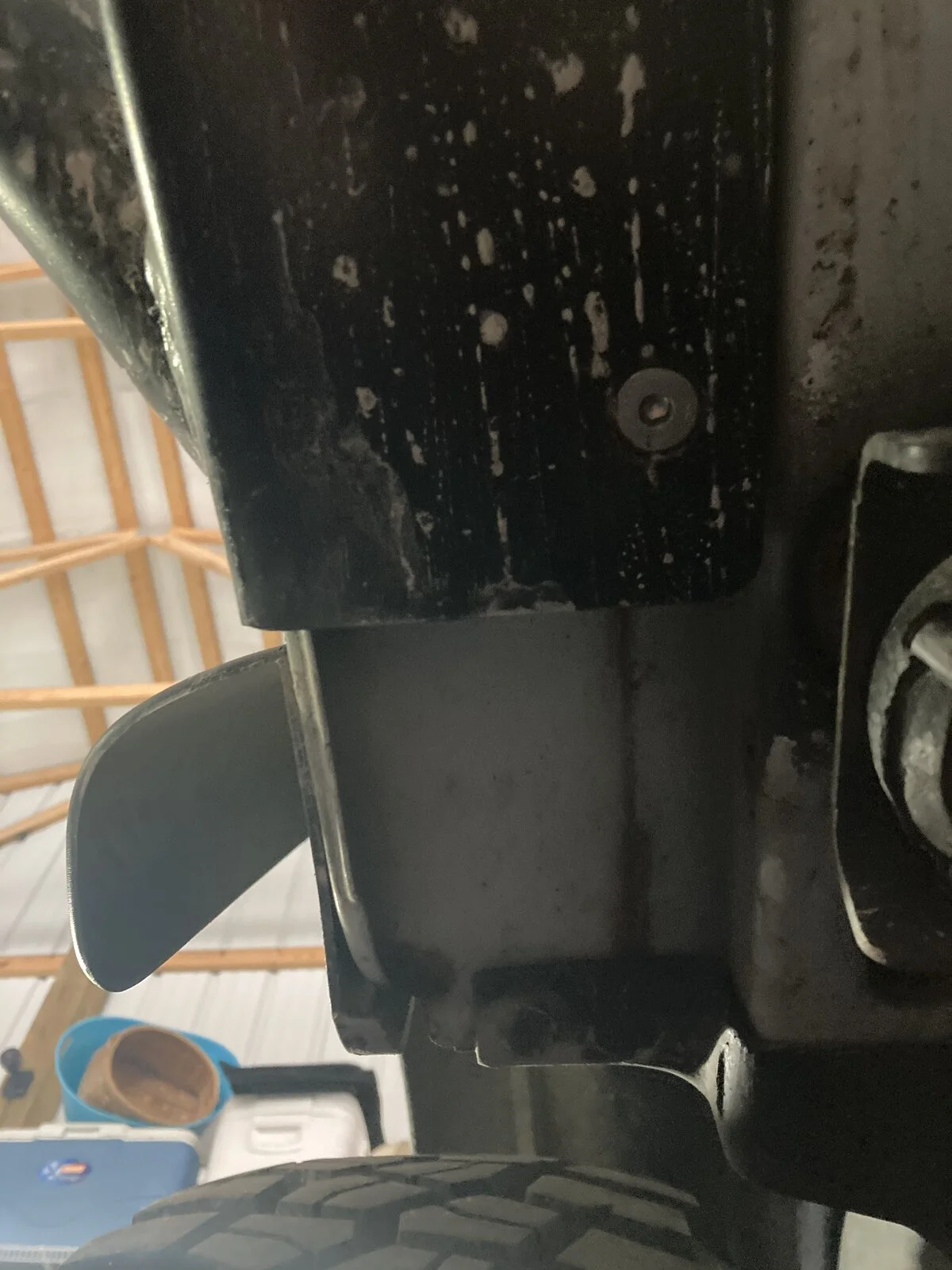

Thanks. Do you have a picture of how close to the wheel wells go? I have 6'' pocket flares btw.
I can post one tomorrow as I’m away from where the Jeep is now
I do know that they fit closely to the factory flares on the side and angle forward underneath. You may have to notch your aftermarket flares if they are if they fit differently on the sides

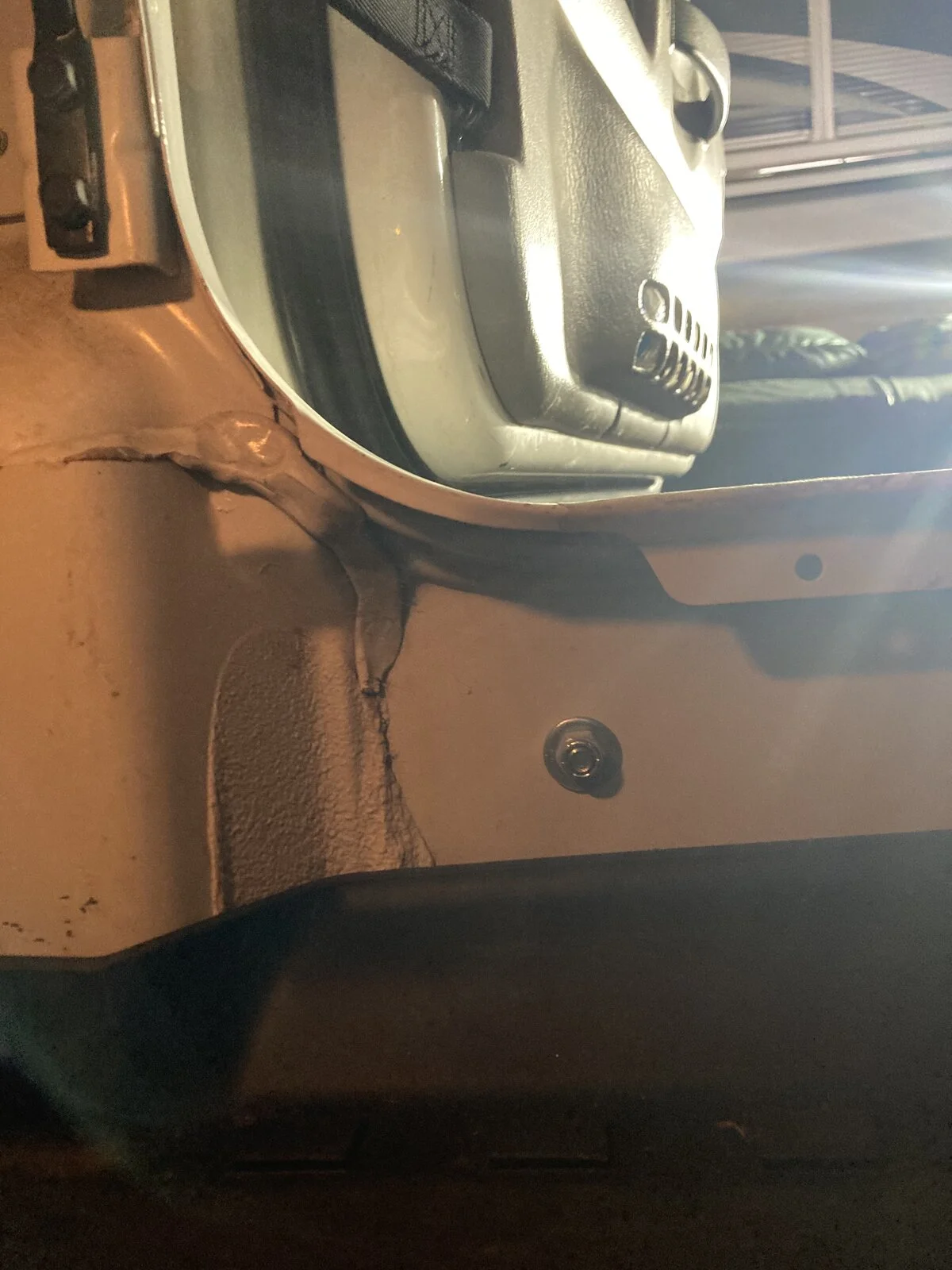

The pocket flares are mounted on the existing holes of the factory ones and are maybe a bit more bulky on the ends. That's why it would help to see some pictures.

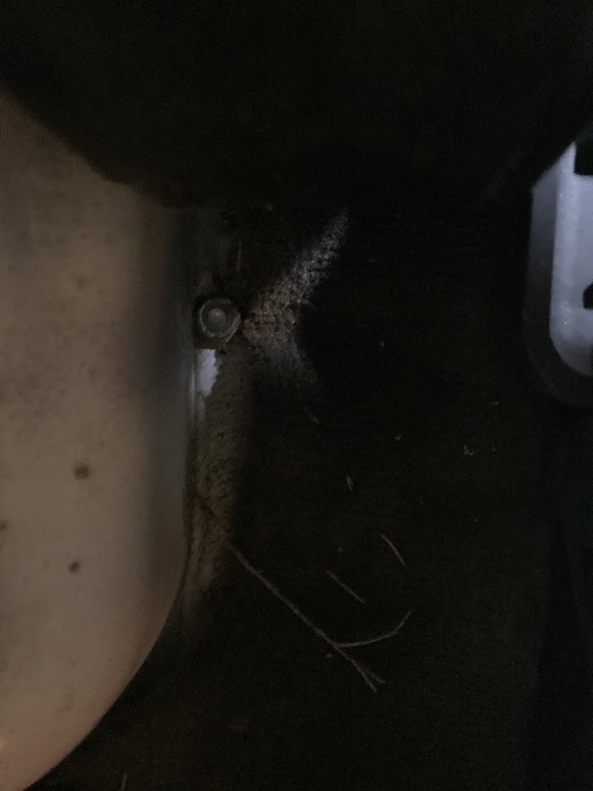

Would also appreciate if you can post a picture from the inside to see how the bolts on the side of the tub look.

Will do this weekend
