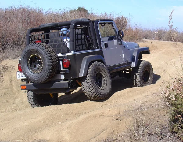

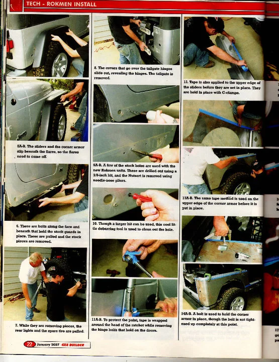

Fast forward to 2006. I had an opportunity to get a Rokmen Mercenary Bumper, Rokmen Rock Sliders, Rokmen Rear Quarter Panel Armor, 2" OME Suspension, OME Rear Panhard Rod Extension Mounting Bracket, OME Bump Stop 20mm Extensions, OME manual transmission spacer kit, JKS 1.5" Body Lift, JKS 1" Motor Lift,
JKS Upper Control Arms, JKS Sway Bar Quick Release, Allied Bead Locks and MTR's at a discount. They were based out of Colorado and they had a magazine that wanted to do a write up on their Mercenary system. My Jeep was chosen for this article and their head mechanic came to California for a week to do the build with me in my shop. The photographer was in Hollywood so he drove down for Phots and to take notes on the progress. This was phase one of my build. Here are photos of the article.

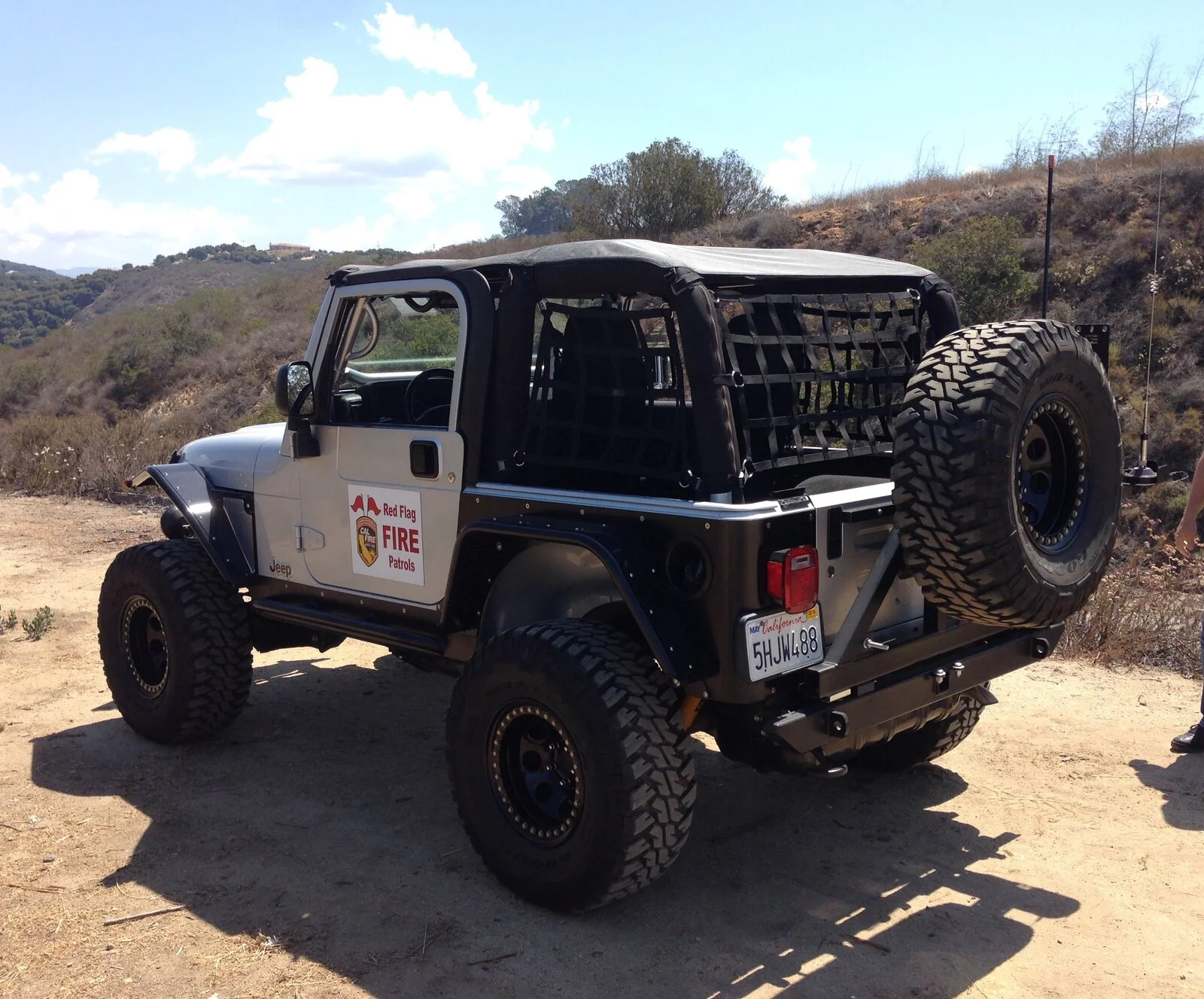

The fenders got close to finished things up on the outside but I still needed a rear bumper. I went to an off-road expo and found my setup for a good deal.The deal was so good that I ended up getting the ROCKHARD Roll Bar system as well their Rear Bumper with tire rack, small rack the sits above the spare tire and a gas can carrier.
Other odds and ends that I picked up in 2006 that I forgot to mention earlier are Harley Davidson Long Stem Black Mirrors, Rain Gear Jeep Cover and a set of Rockcrusher Diff Covers.
So the name for my TJ was created from ROKmen and REV 111 or ROK111. Sorry ROCKHARD!

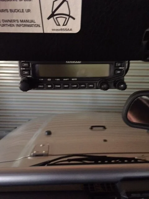

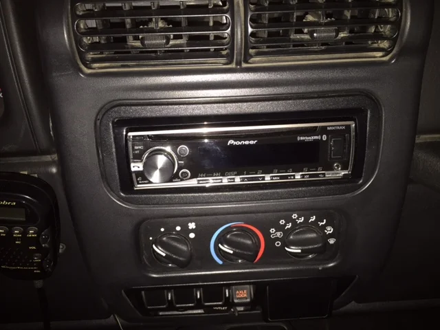

On the inside I put a Kenwood TM-V71A Ham Radio hooked up to a Diamond NR770HA Dual band Mobile Antenna. The antenna is still on a Mag mount on the Gas Can rack but I plan on mounting it the right way soon. For tunes the main thing for me in 2015 was hands free and bluetooth so I picked the Pioneer MVH-X560BT Car Stereo. After that I needed some better seats so I went with MasterCraft Baja RS Seats.

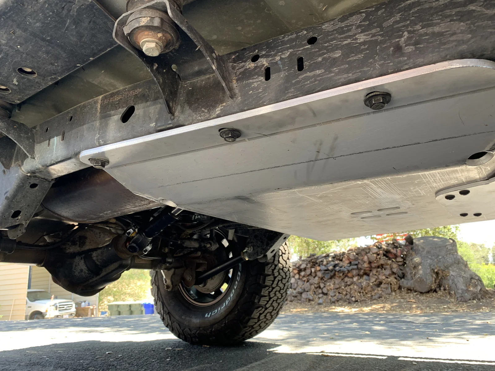

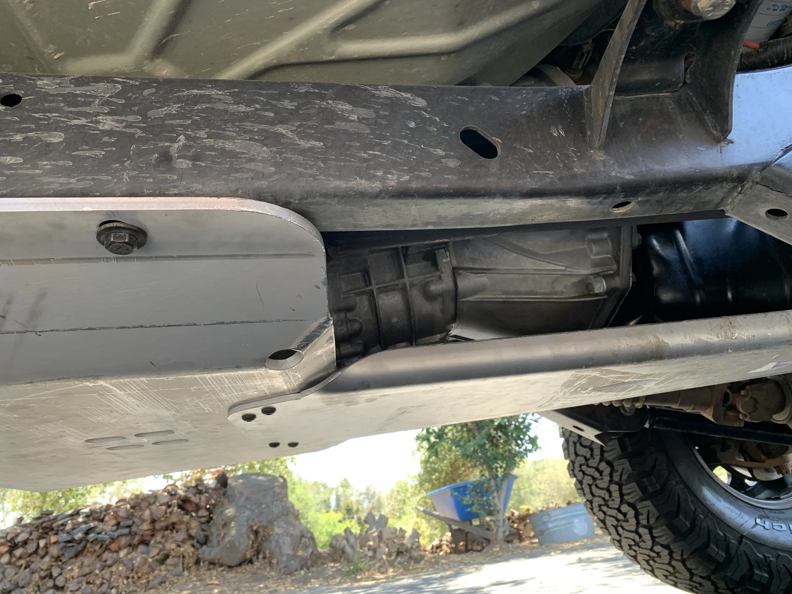

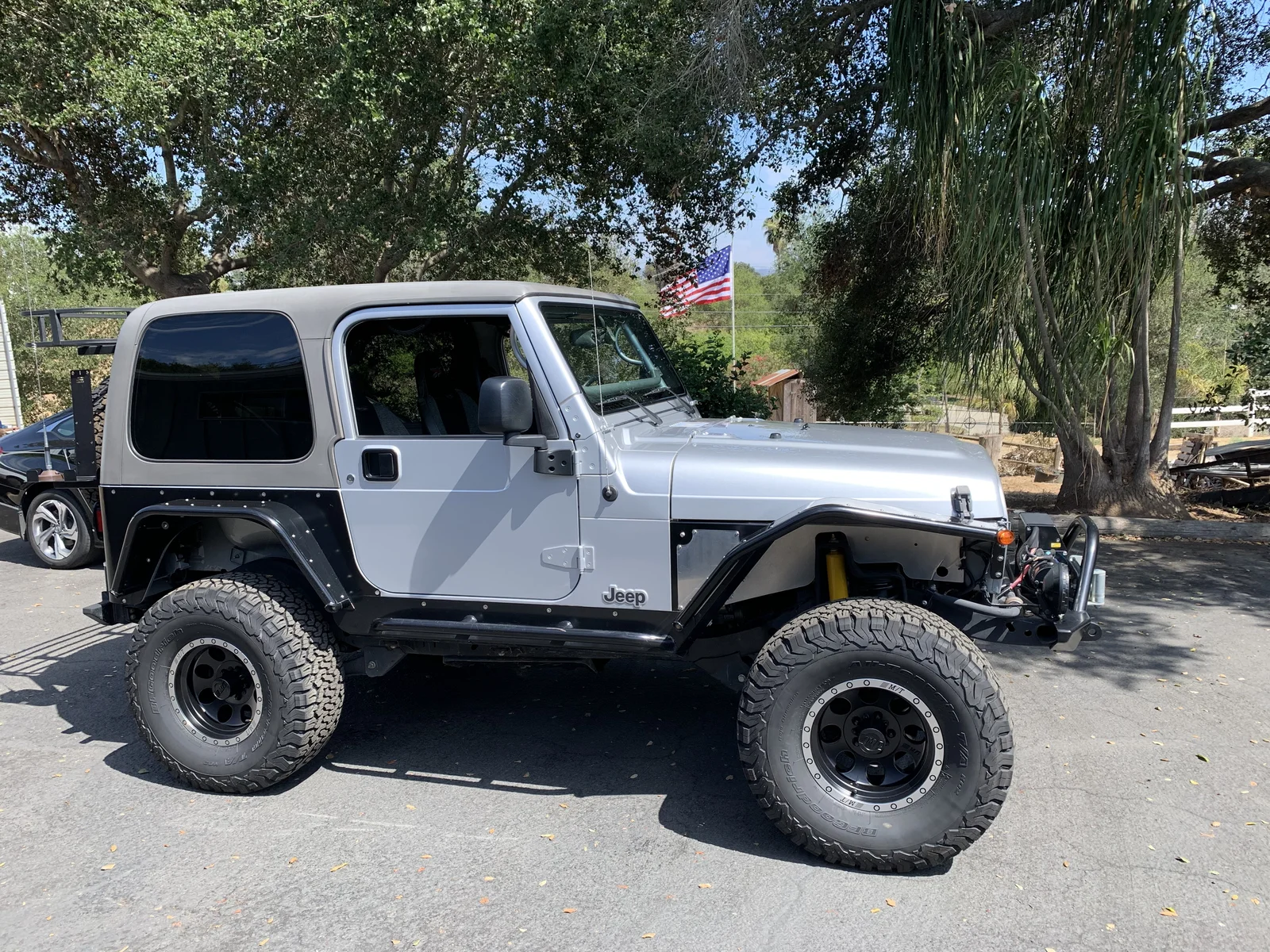

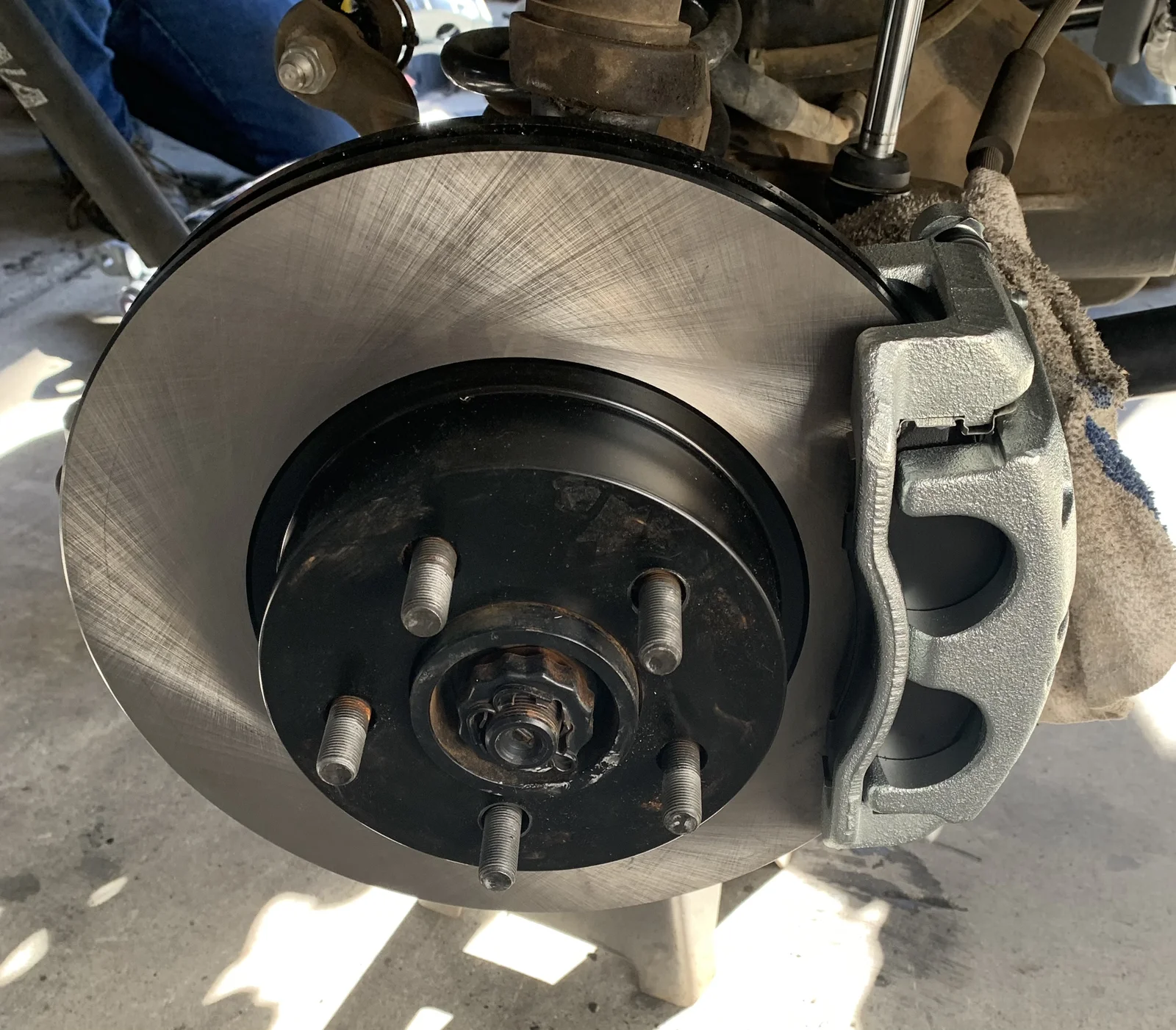

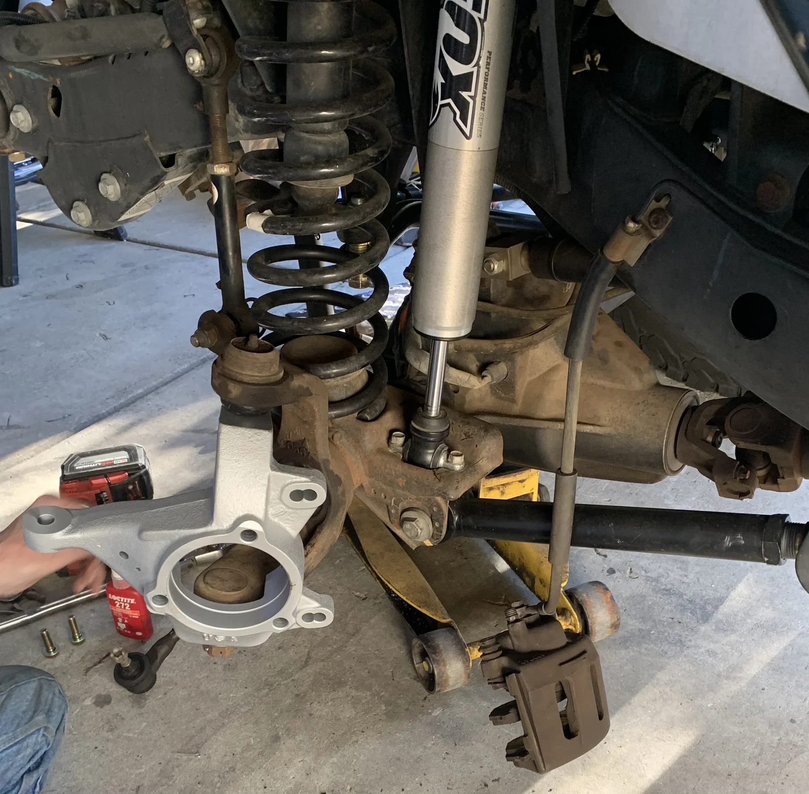

I just picked up the TJ today after having some fun things done that I have not had time to do myself. I really enjoy working on my vehicles but for the past few years I have been putting in lots of overtime at work and there has just been not enough time to enjoy this part of being a Jeep owner.

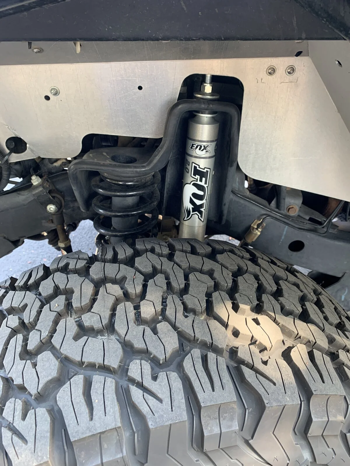

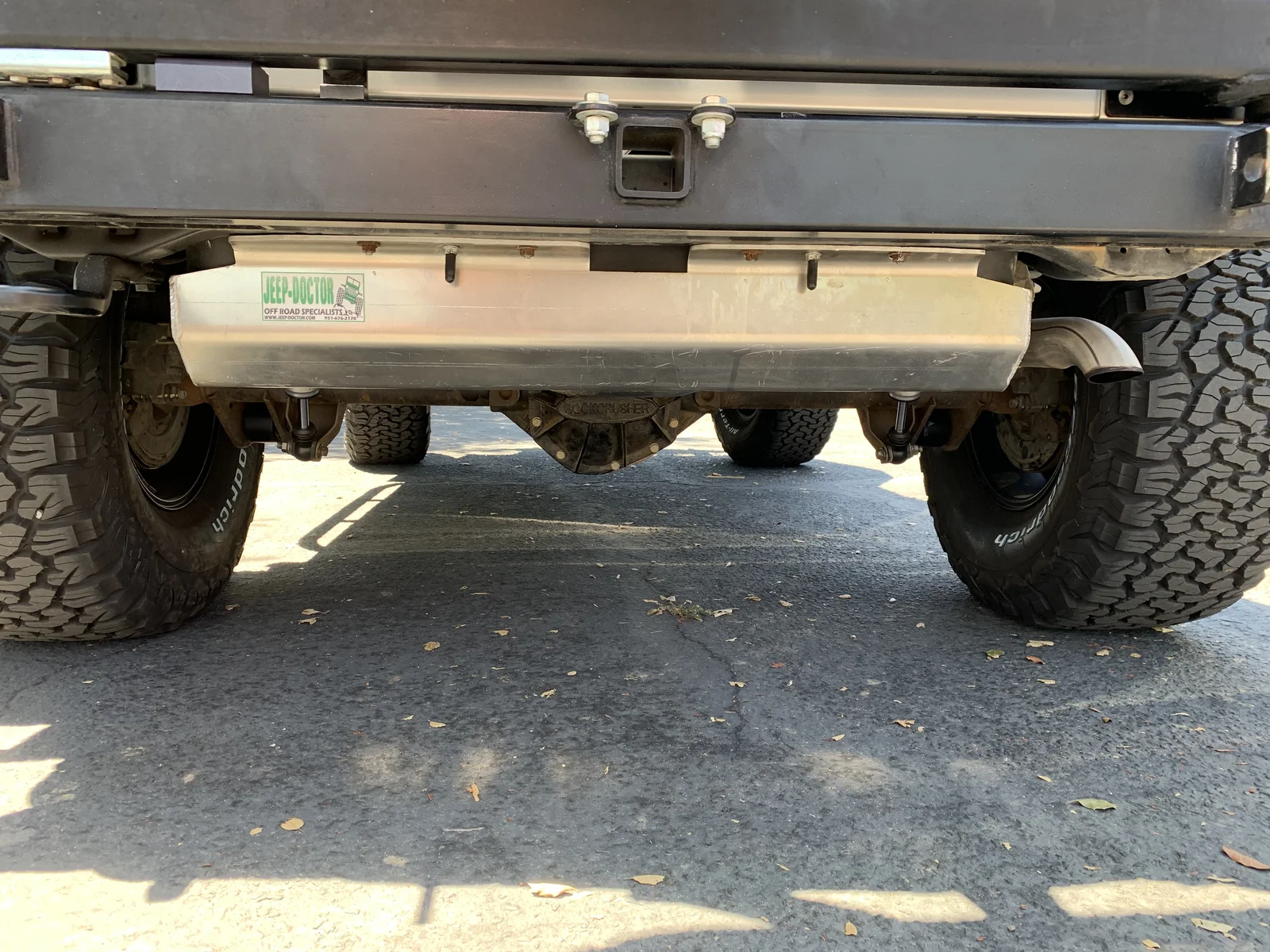

So, I had the Under Armor that has been sitting the shop for a couple of years installed. During the installation of the under armor there was an issue with the OME shocks hitting the mounts due to the alignment of the rear diff so I had some Fox shocks installed which gave about an inch more clearance. I also had some Metal Cloak suspension items installed so they could adjust the rear diff. So new upper and lower control arms and a new track bar were installed. The need for a Tom Woods driveshaft due to raising the Transfer Case was also installed. While they were there I had them install the Savvy Transfer Case cable linkage.
They were able to use the stock Transfer Case mount which save me some potential vibration and eliminated the need to modify the stock exhaust. The 30 minute drive home was wonderful with no significant issues. One of the benefits is that when I put on the Body Lift the manual transmission linkage felt a little sloppy. Raising the Transmission tightened up the sifting and it is now shifting better than it has in a decade. Next up a little black magic...
Here are some pictures to prove it really happened!
