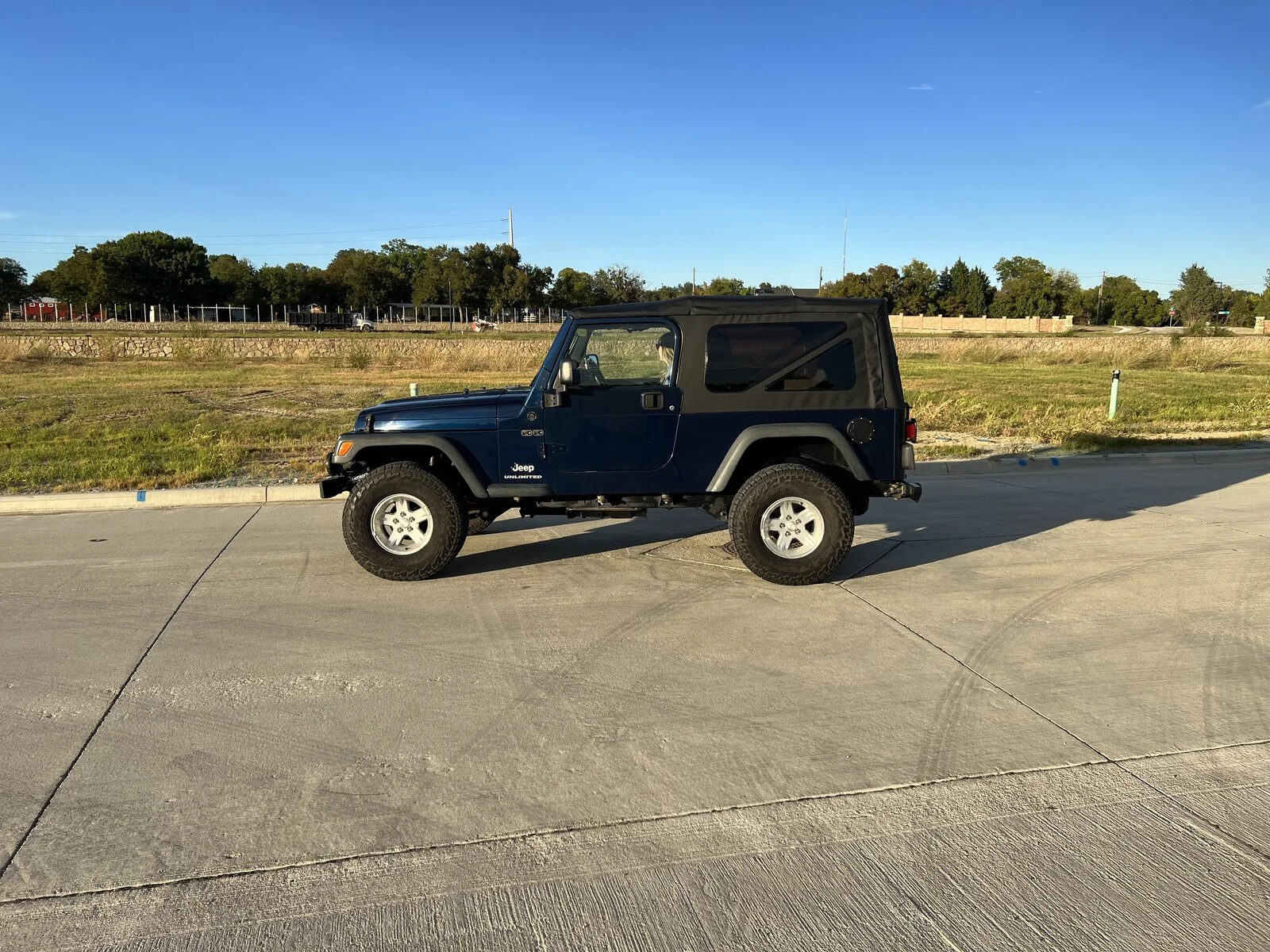

looking for advise for a better, not so jarring ride.
October of 2021 I installed a DPG super ultimate
OME shocks, steering stabilizer and springs
Jks track bars and sway bar disconnects
Core 4x4 tier 2 arms these are the half Johnny joint half factory style bushings
Jks rubber body lift
Jks engine mount lift
With this setup and the 32” bfg running 28 psi per forum recommendation.
This was all installed on a bone stock LJ with 82k miles and 32x11.5x15 bfg ko2’s it had an awesome ride before installation of the lift even with these tires, only issue is rubbing with the flex of a speed bump
Since that installation, I’ve added a currie antirock up front and switched to 33x11.5x15 falken wildpeak at3w tires
I’ve driven the Jeep around 6k miles mixture of trails and around town on the weekends before the Currie and falkens with just the dpg kit and the ride is still super rough.
The falkens are set to 25 psi
I know these springs and shocks get rave reviews but this ride is rough, what am I missing?

I’d call Dirk back and walk through this description.
Are the tires load range c?
Good post, I’d be chasing a better ride too, if it rode great before.

It sucks having to spend dollar after dollar chasing a good ride but the two budget shocks mentioned most often for a compliant ride are the Rancho 5000X and Skyjacker Black MAX
The springs have nothing to do with it.
I believe @Jerry Bransford has reported that the newer OME shocks didn't ride as well as the older OME shocks he had run.

X2 to the springs having nothing to do with it. And it's true the current OME Nitrocharger Sport shocks ride a lot more stiffly than the now discontinued OME Nitrochargers did I used to run. Someone opined the current Sport version of the Nitrocharger was made stiffer for the heavier JKs and JLs which makes sense to me.
Since the issue began when you switched to tires that are a larger diameter, try cycling the suspension to check for interference.

The newer OME nitrocharger shocks ride rough. I have a set of the old ones on a rig and they ride pretty much like stock. As suggested by others, try some Rancho 5000X 0-2" or Skyjacker BlackMax. A recommendation becoming more common is Rancho 5000X in front and Skyjacker BlackMax in the rear.
You should also tune your AntiRock by moving it up toward a stiffer setting. The looser settings allow too much play up front in my opinion and the ride quality suffers. A SwayLoc made mine dreamy with the right shock bias for my ride height.

Help me with my 2006 stock TJ. It is my daily driver. About two years ago I put on some rancho shocks because my left rear stock shock was leaking. Stock springs with replaced stock sized bump stops. I have a Smittybilt winch on front with a stock 4.0 motor. In th last few months, when I roll over a sped bump or over a moderate hole at slow speed the rear is bottoming out. do I need new springs, shocks or both? I thought the Ranchos would last longer, if that is the prob?????
Could be one or more issues. Hard to know without getting more info. Feel free to call me if you'd like to discuss in more detail.
Bottoming out could be from bad springs but it can also be caused by shocks that are too tall for the suspension lift height.
