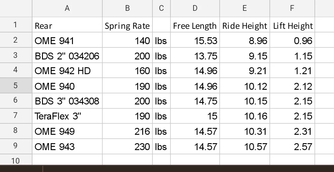

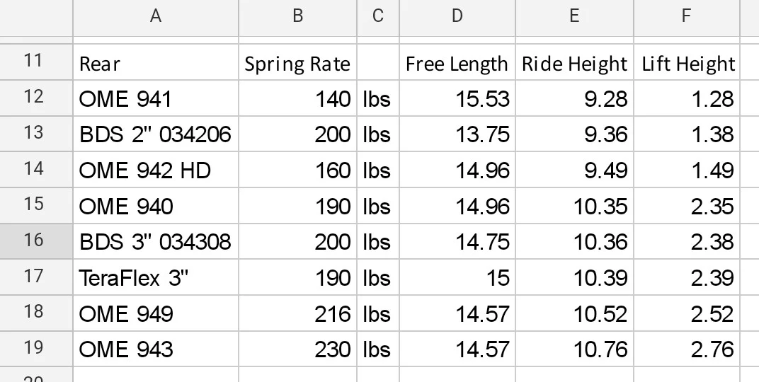

Linear rate springs like OME, BDS, RE, etc, all work the same way. And they can all be calculated the same way. Even the allegedly dual, triple, quadruple rate coils are really just linear rate coils wound with tighter sections. The wire diameter is consistent throughout. And most don't transition between wound sections during normal driving.
The bottom line is that Old Man Emu coils are not unique or magical. The only thing they have over other brands is a broader range of rates and lengths that allow for some more nuance in selecting a lift height in the 0-3" range on a TJ.
For some reference, here are several rear coil springs in the 1-3" lift range. The lift heights are calculated based on a 920lb sprung corner weight.
And here is another set based on a 875lb rear corner sprung weight.
Reactions: JMT and Apparition
