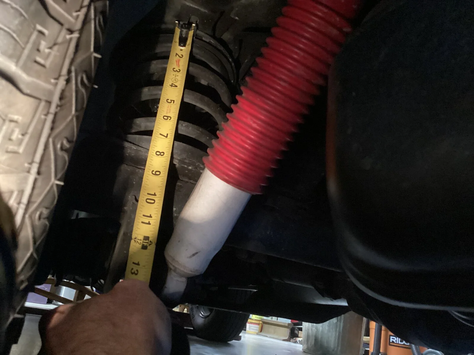

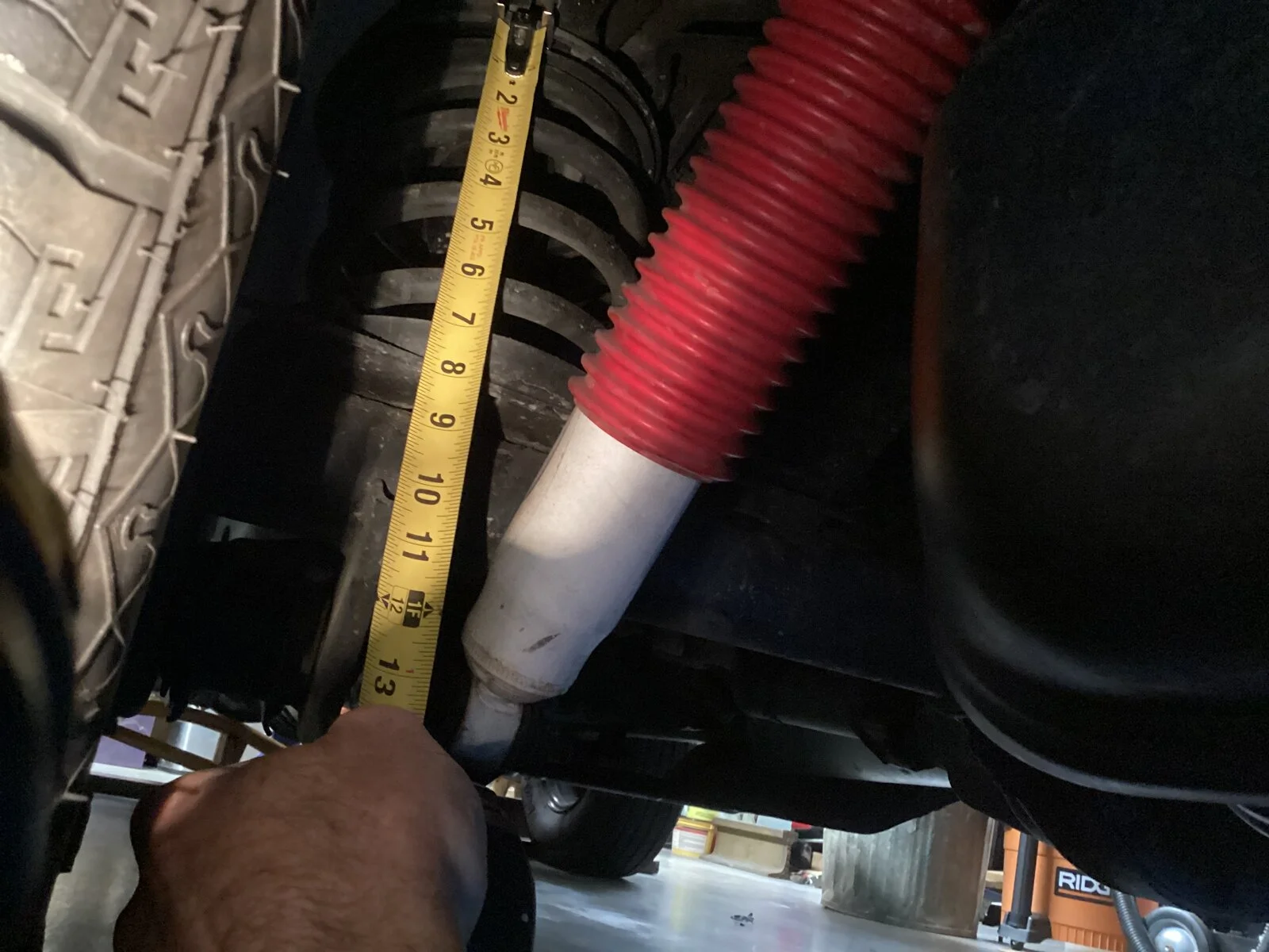

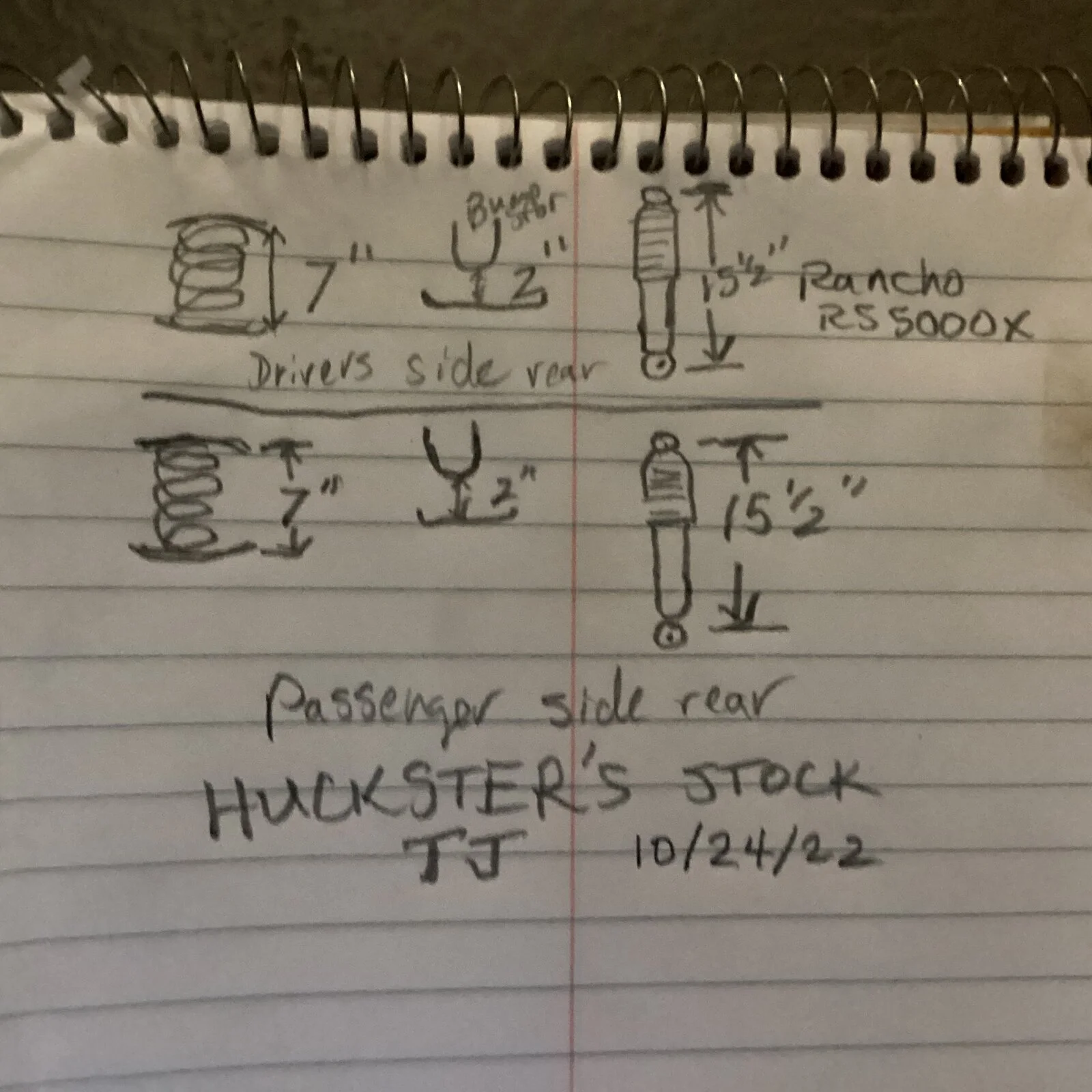

jjvw, I took your advice and measured the rear springs ( 7” on both sides) . I also measured the distance from the bottom of the bump stop to the spring perch where it would strike. About 2” which seems a little short to me but I am less than an amateur when it comes to these things. I have read a bunch of posts that have come up on this. It appears I may need a slightly l
onger spring; maybe 9” to give the mediocre rancho shocks a chance to work efficiently.
After reading a lot of posts, to my thinking, the springs set the ride height and will oscillate at a certain frequency dependent upon the poundage the spring is designed to be (140#, 160# or whatever maybe stock springs) and also how much weight is sprung weight. Then you have the shock which dampens the oscillations and needs to be the right height and made for the application…the Jeep TJ. I welcome everyones input.
Is that the measurement of your Rancho shock from eye to eye at ride height? What you need to know is the extended length of that shock. That information is available in the TJ Resources part of the forum and it is a Sticky, so it is easy to find at the top of that page. Find your shock and the extended length. Then you need to know the shock travel of that shock. Then you need to measure how much of the shaft of your shock is showing at ride height (might have to cut taht red boot off, no worries, it does nothing important). Ideally you want that measurement to be half of the travel of that shock so that your travel bias is 50:50.
Yes, that was the measurements of my rancho shocks on the rear at ride height.

You actually want to measure to the bump stop cup when determining shock length. Typical stock bump stop gives you about 2 inches of squish before it you hit the cup to the coil pad. So you have closer to four inches of up travel.

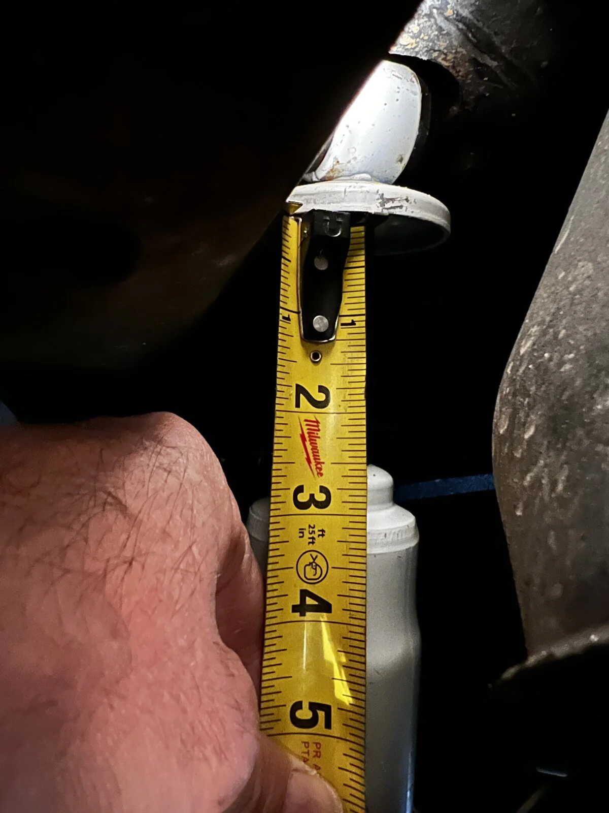

So I looked up Rancho rear shocks for my Jeep: RS 55241…extended length 21.67”. I Cut the red plastic boot off and measured. 2 3/4” exposed rod on the driverside shock and 2 7/8” on the passenger side. To acheive a 50/50 ratio there should be about ( 8.16 travel lengthdivided by 2= 4.08 minus 2.75= 1.33”… so I need about another 1.33 inches of shock rod exposed to achieve the 50/50 ratio of uptravel to downtravel….probably why the rear is bottoming out
Reactions: JMT, Ocho and jjvw
