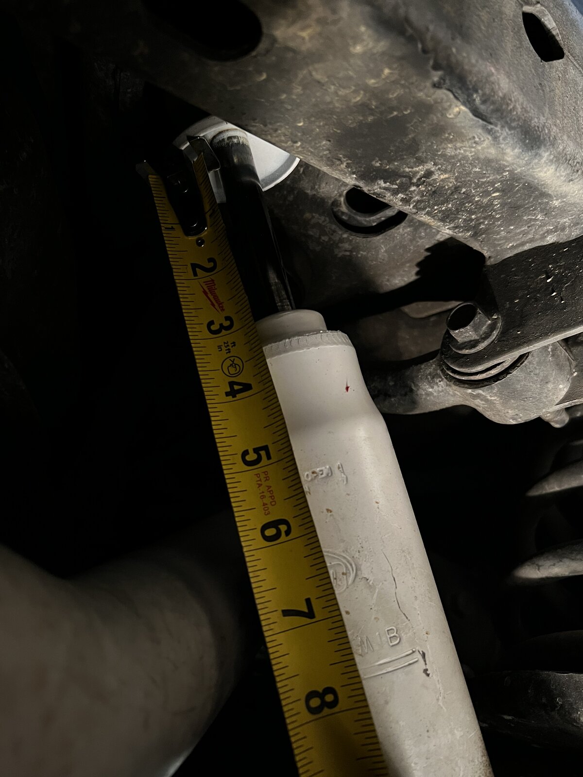

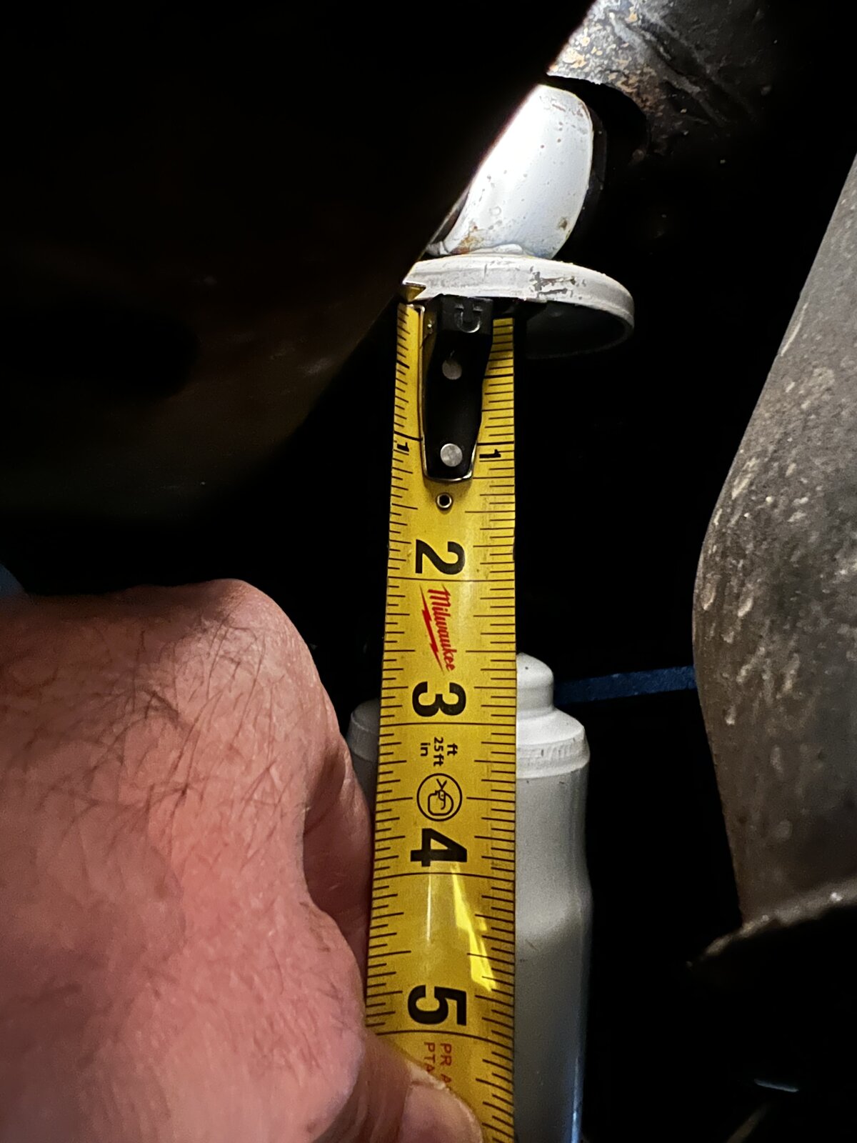

So I looked up Rancho rear shocks for my Jeep: RS 55241…extended length 21.67”. I Cut the red plastic boot off and measured. 2 3/4” exposed rod on the driverside shock and 2 7/8” on the passenger side. To acheive a 50/50 ratio there should be about ( 8.16 travel lengthdivided by 2= 4.08 minus 2.75= 1.33”… so I need about another 1.33 inches of shock rod exposed to achieve the 50/50 ratio of uptravel to downtravel….probably why the rear is bottoming out
Yep. You can use the zip tie trick to confirm but the math says you need to be taller or use the RS55240 shock which is a touch shorter.
There is one way you can fix this with springs. 🤫
That’s what I thought. Also relevant since the stock springs seem to have squatted about an inch over the last 17 years. What springs would bring my ride height up 1.5”. From the current 7” or maybe 2”????
Since the shock has squatted…maybe time for new slightly slightly taller shocks.
Shorter shocks to better fit the ride height or a taller ride height to fit the shocks.
You could add a 1.25” spacer and be about right or get a shorter shock. You’re rear spring is sagging quite a bit. Not that it means you should replace them. But a 1.25” spacer would be about right. Cheap, adequate solution.
I appreciate the frugal solution. I’m more of a mind to replace the sagging springs.probably front and rear. However, due to this forum and info I know why the rear end is bottoming out on a not too bad dip. I’ll take it easy for awhile and maybe be on the prowl fo some OME 2933/2941 or pro comp springs to raise me and my winch up a couple inches
