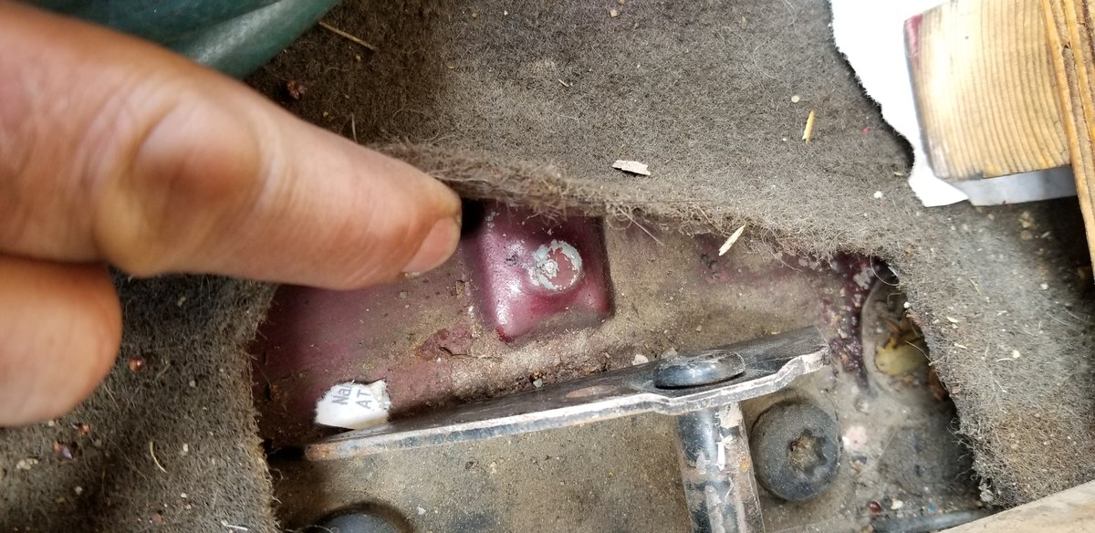

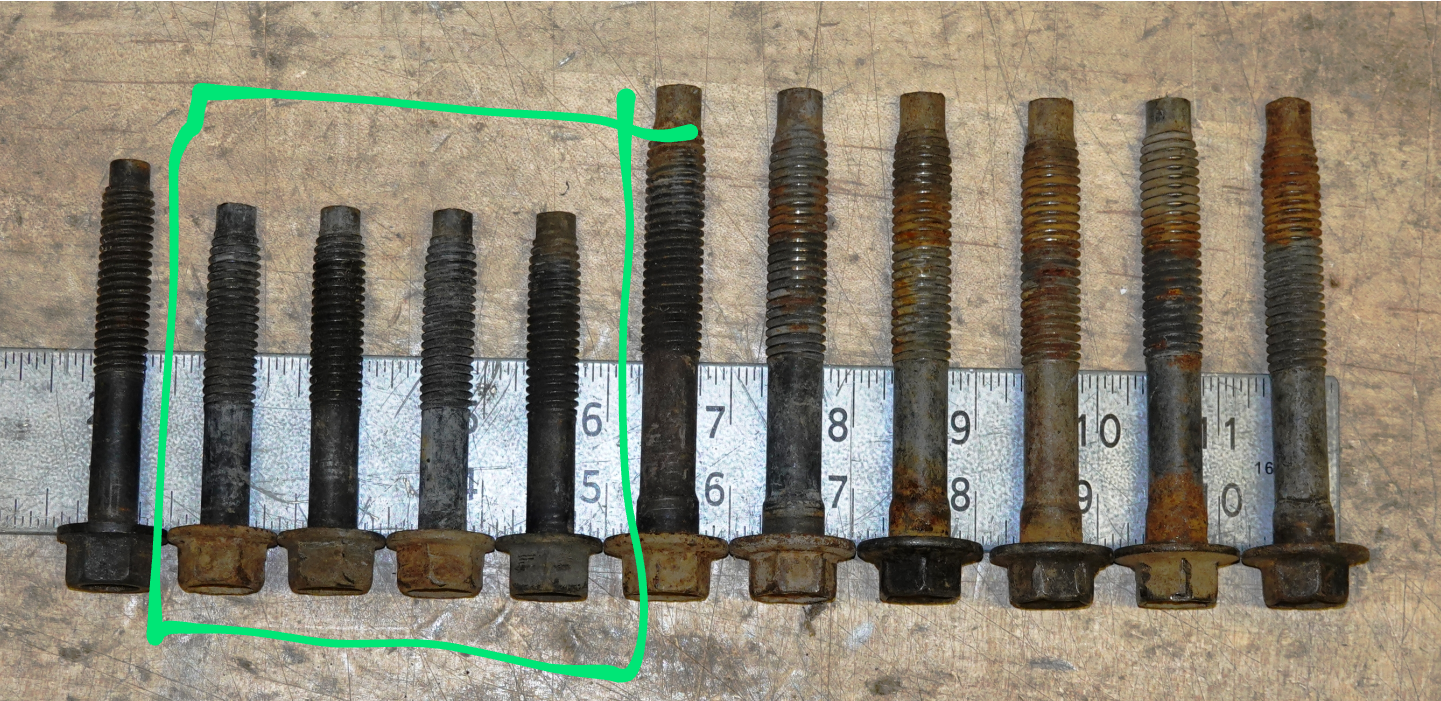

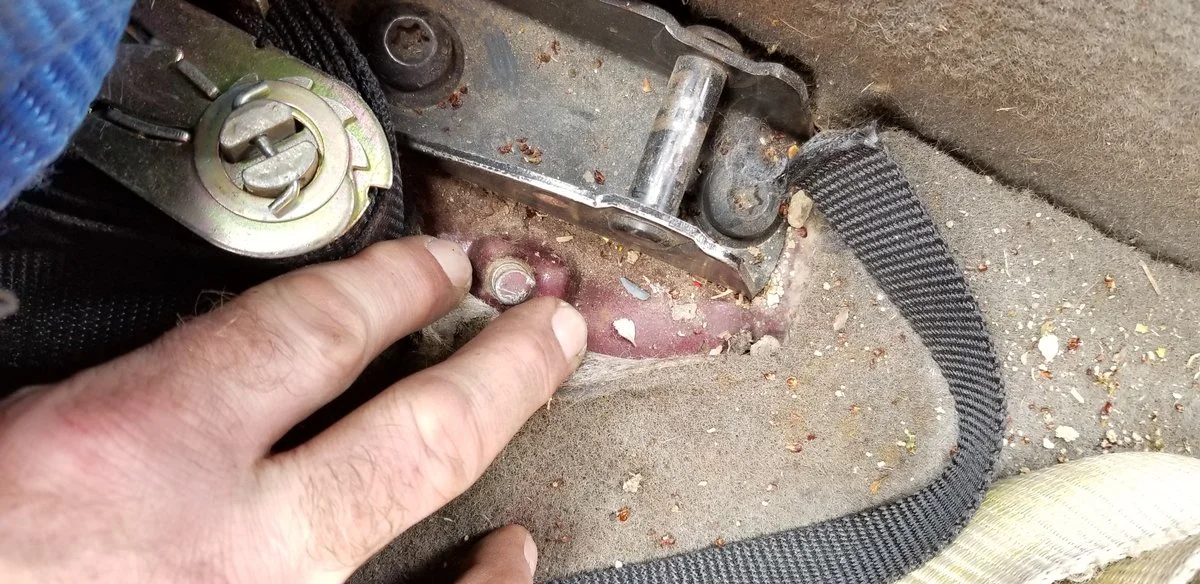

We aren't the only one who have had this happen. Pull back the rear carpet with a set of JKS pucks the have been around for a while. Jeep knew those bolts needed to be shorter than the surrounding bolts. JKS doesn't care, most owners don't pull back the carpet, most dismiss the small increase in vibration transition into the tub as a Jeep thing, and you have never paid attention.
Here are the factory body mounts. Two in the green box belong to the body mounts at the rear shock mount crossmember.
Jeep made these bolts shorter so that they don't punch into the tub. JKS didn't make these bolts short enough. Or maybe Jeep is trying to gaslight us and JKS body lifts don't punch holes in our tubs.
