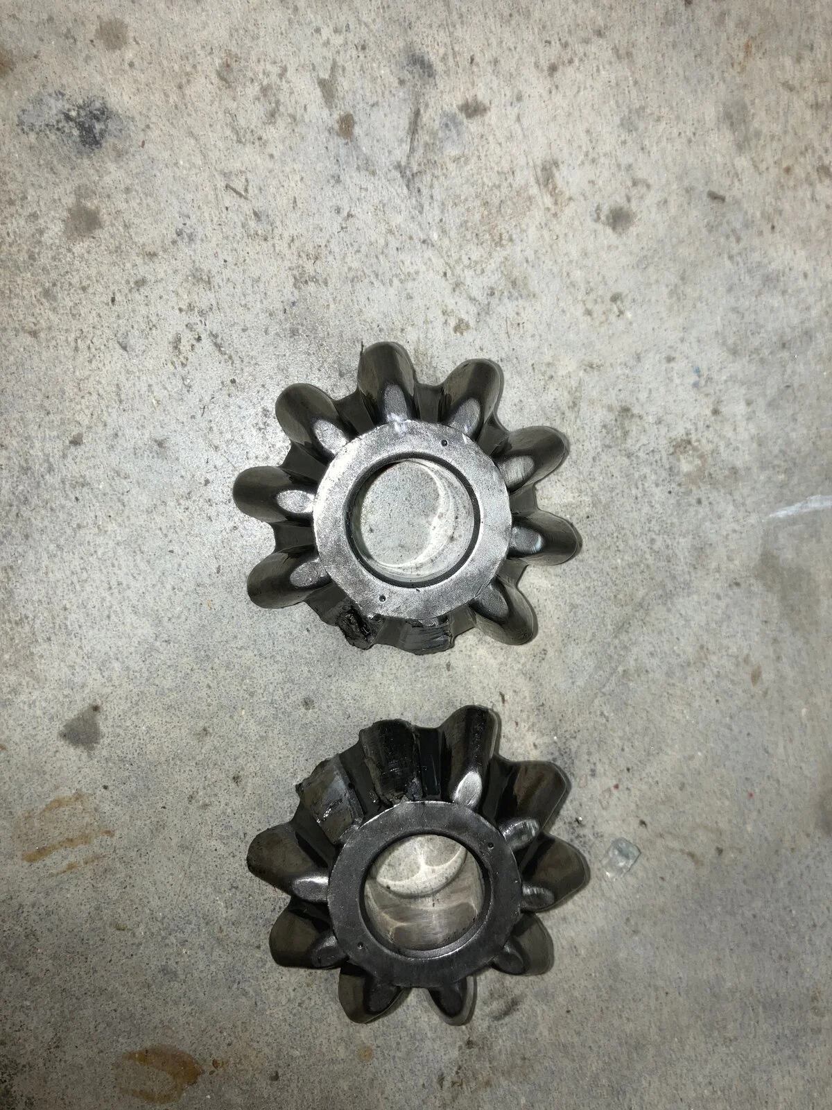

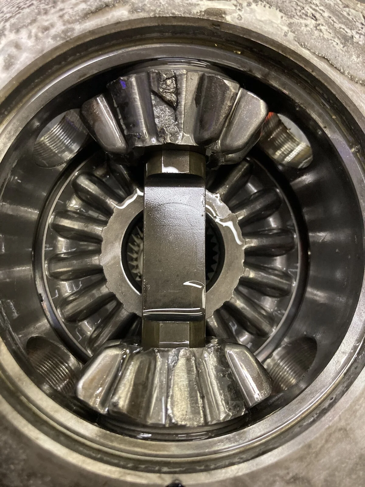

I'm running 35's on my TJ. The front Rubi locker only having 2 spider gears compared to 4 on all other aftermarket selectable lockers is the obvious weak link. I'm certainly not going to replace with another Rubi locker. I was rock crawling on 4 fingers at Hot springs ORV, wasn't doing anything crazy, front end was locked and I was burning the tires to try and get over some huge boulders. On the final climb out of the trail, noticed the front wasn't locked and went back to camp to pull the diff cover: found pieces of the spider gears in the bottom.

I never swapped my rear with a front: Broke rear and replaced with Detroit. Broke my front, and now shopping for a replacement selectable. From my experience I don't recommend anyone replacing a broken Rubi locker with another Rubi locker lol Aftermarket options have much better track records.

I was backing up your assessment that the 2 spider design is too weak and therefore should not be used in a rear application. Not that you did, no one should.
I've broken two rear Rubi lockers, one stripped locker and one stripped LSD. After the second failed, I went with ARB and never looked back. I'll do the same up front when the time comes. Short of the actuator if they are still available, saving the factory lockers is rarely worth the effort.

Yes. The Rubicon locker and LSD is in the same case. That's the problem. Both need elements to be made smaller to fit inside the case.

I have a 2004 Rubicon and have experienced failure on both the rear (LSD) and front (Spiders) OEM lockers (at different times). The rear I drove almost 200 miles home with the LSD popping and metal floating everywhere and it tore up the ring and pinion and the carrier bearings, but the axles were OK. The front I just drove approx 1 mile to get off the trail and had no other damage. Having said that I would not worry about them and would not replace them until you have to (which may be never).
When you flat tow the front and rear axles and R&P is spinning even if the transfer is in neutral. If you have a failure and there is metal floating around in the diff, there is a chance that the floating metal would cause additional damage (Ring, Pinion, carrier, carrier bearings, axles, etc...). On the front you could pull the axles and driveshaft, then just reinstall the outer axle shafts (do not install the inner shafts) which would prevent the front from turning. However, not sure what you could do with the rear, possibly clean out as much metal as possible and refill with fresh oil and hope for best. Best bet would be to get a trailer and come back and get the jeep the next day.

One tip I remembered when my LSD was breaking apart. As soon as I was able to, I stuck a few good sized neodymium magnets inside the diff to capture as much of the loose metal as I could, which they did. The week or two I needed to drive this way didn't damage the ring and pinion. In fact, I'm still driving that same R&P two years later.
Who knows when your Rubicon lockers will go out, but they likely will eventually if you wheel hard. Mine broke 3 years apart from each other, and that's a lot of tough wheeling trips on 35's in those three years! When you see a good deal for a locker, pick it up so swap it out when you have time. Detroit in the rear is a cheap and bullet proof replacement, and an OX is what I just put in my front.
