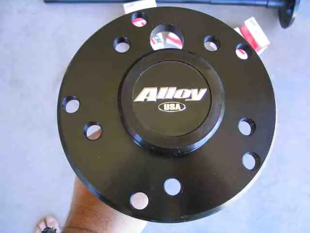

IDK about 8.8 but I put Alloy shafts in my Dana 44. THey are kinky and go both ways, Doesnt help you directly but maybe you can have machine shop drill in a similar fashion.
Reactions: Larry221
I got those for my girl jeep. She has a jk with a 44.
If I could just find those for a 8.8. Idk if there is room in the hub flange to do this. I totally would!!
