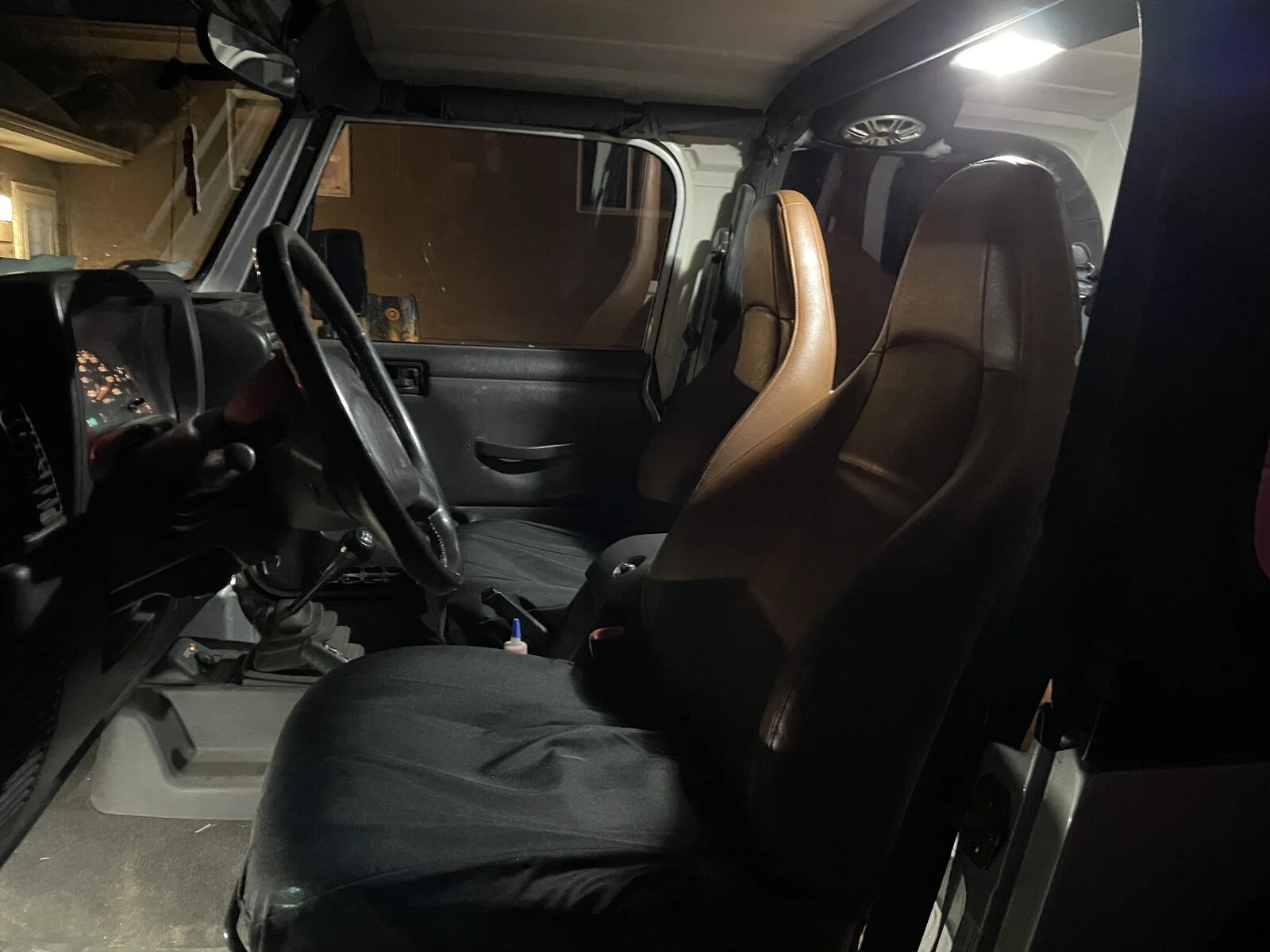

Also put an LED in the dome light and one of the courtesy lights as I found out the 2pk of 921’s I got for the dome light would also fit the 906’s for the courtesy lights.
Decided to try cheap MotoMaster OEPLUS LED’s, we’ll see if they last but so far really nice for $11 for 2.
