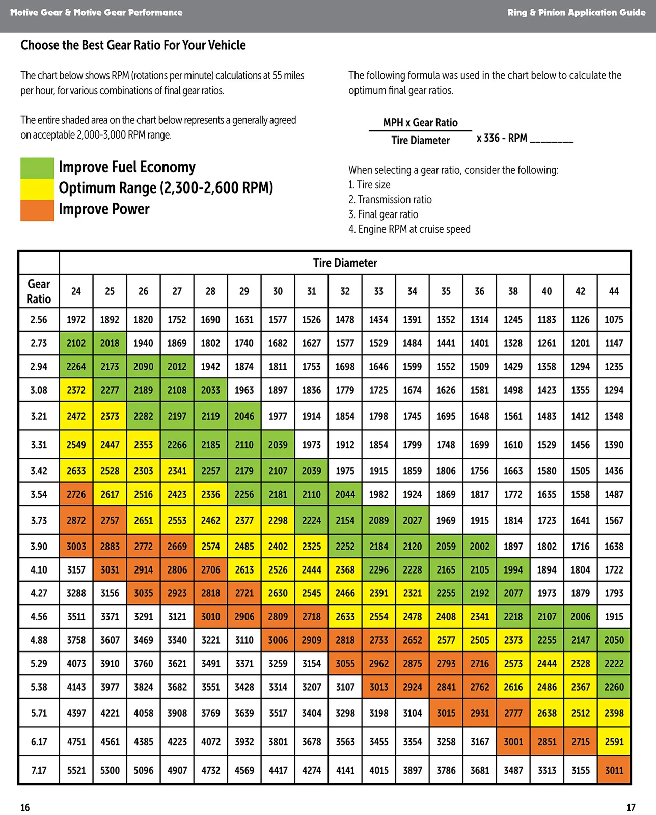

Should I re-gear for 33s or get smaller tires?
would 4.56 be a happy medium between 4.10 and 4.88 with the 33's? Aalso i have a buddy says he can help me out when i am ready to regear any idea on coast if we do the work? So many thongs you can do choices are tough. And thank you for all the replies for I am new to the TJ world

Why do that to yourself? 4.10 isn't good and 4.56 not as good as 4.88 would be.

4.10 is the factory ratio for his combo. 4.88 would be the right ratio for 33's.

Put it like this. Gearing 4.88 with 33s puts you close to stock rpms but on the high side(for a 2.5l 5 speed).
Bigger tires need lower gears than stock to overcome the extra weight and rolling resistance. Gearing anything less than 4.88 will bog the motor down and cause you to use more throttle.which in turn will make the engine use more fuel. Why drive a turd around?
Not gearing enough for a given vehicle has no benefits.

As others have pointed out, 4.88 is correct, but you seem hesitant to accept the advice. Maybe this will help to clarify.
