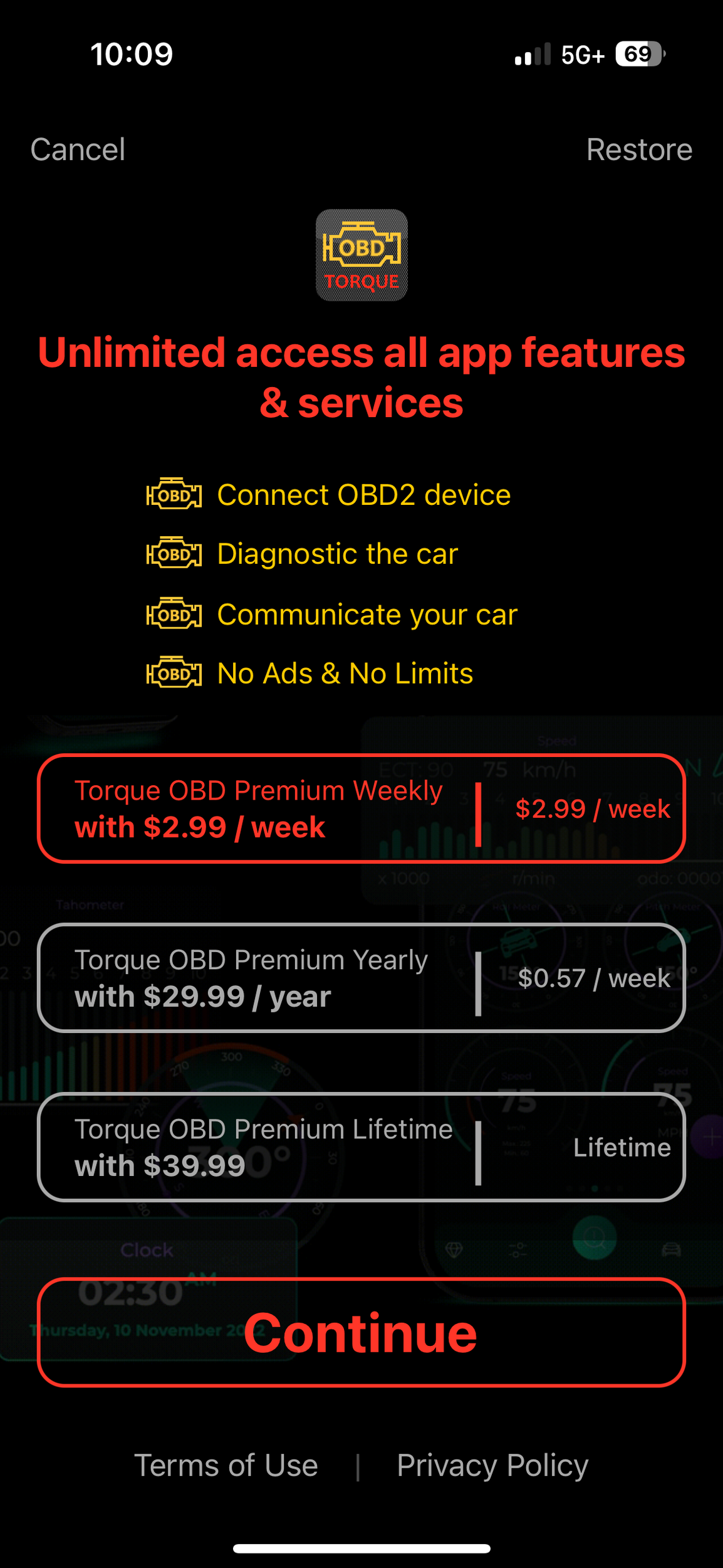

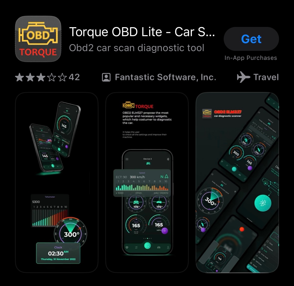

It seems like whenever I press connect it pops up a prompt to pay. Did they paywall it entirely?
Looks like I am indeed paywalled on IOS
I use torque pro on Android and have for years. I paid for the lifetime sub and it's definitely been worth it... It wasn't 40$ back then though lol. Probably still would be worthwhile if you're going to be working on things in the future. I have not had problems with connectivity with mine....

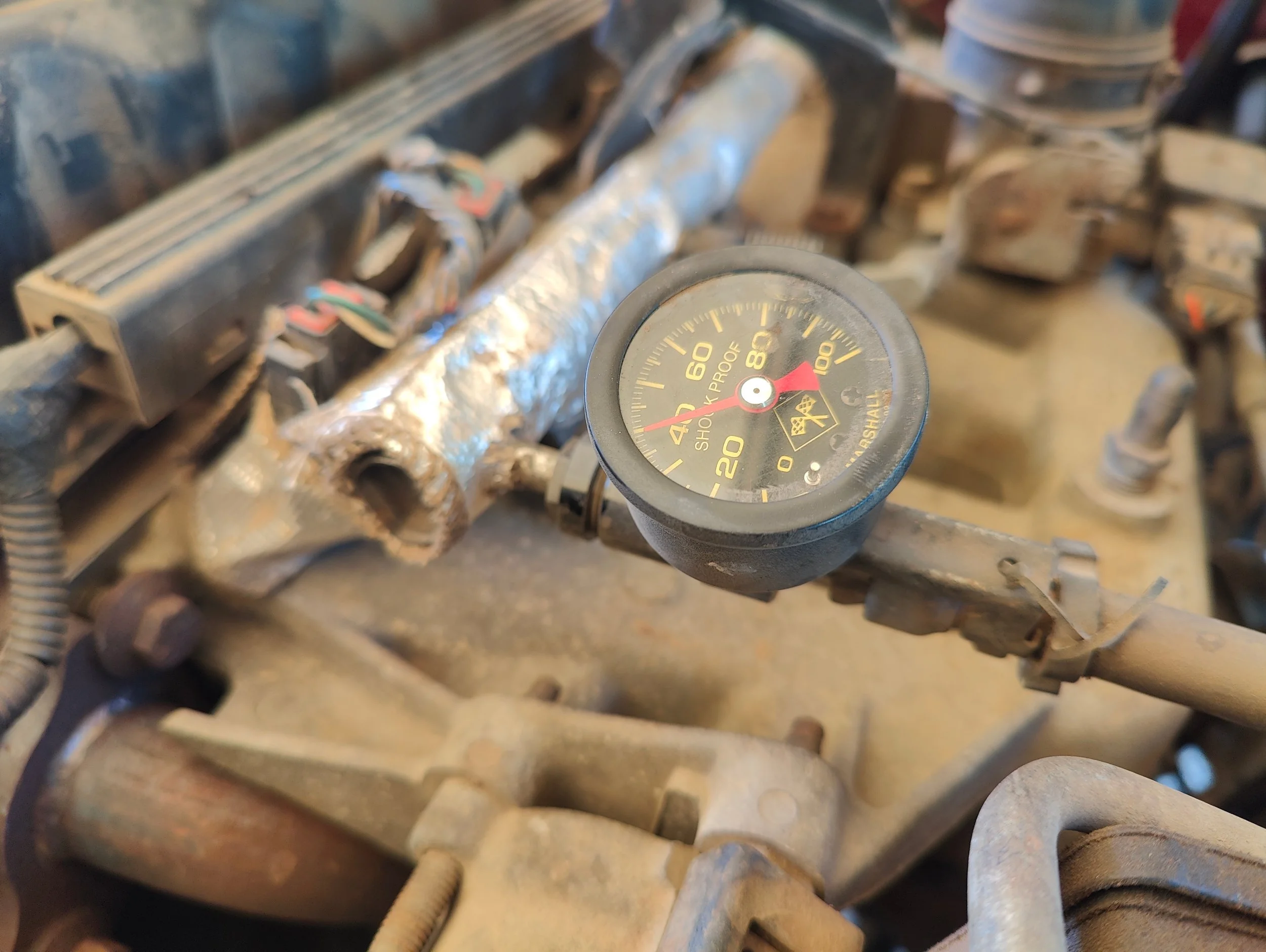

Raceworks makes a 5/16" QD adapter to 1/8"...you can hang a Schrader valve or pressure transducer off that. I put a GlowShift pressure and temperature gauge on my oil sender using brass street Ts. Probably going to put the same setup on my fuel rail so I can monitor fuel pressure and temperature.
Alternatively you can just replace your fuel rail.
-Mac
Reactions: Duner
-Mac
I tried looking for 2.4 fuel rail with a schrader valve and couldn’t find a single one. Are you saying to put a schrader valve between the original fuel line and the fuel stem off the fuel rail?
