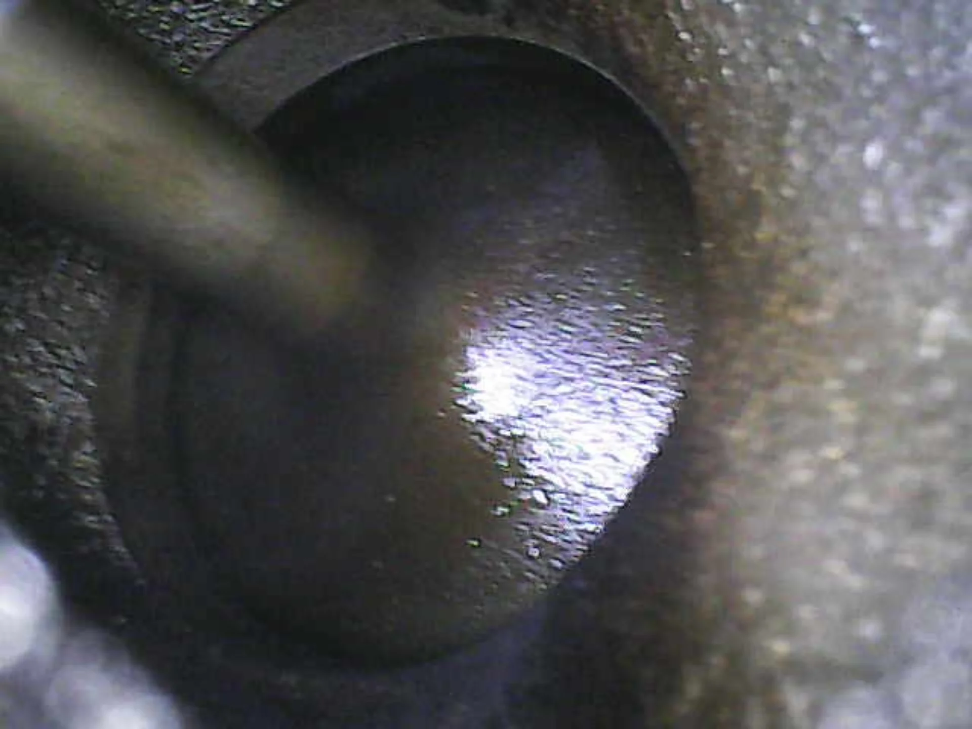

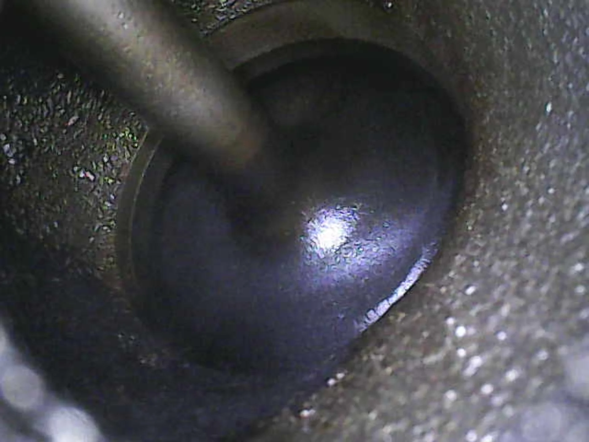

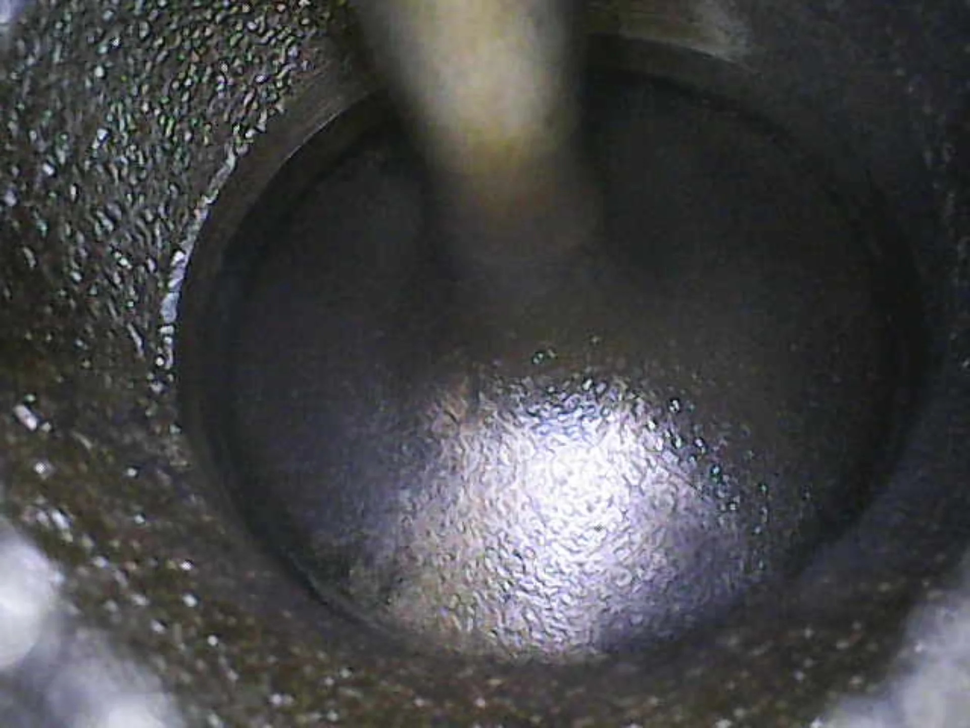

valve pictures, in cylinder order 1-2-3-4
