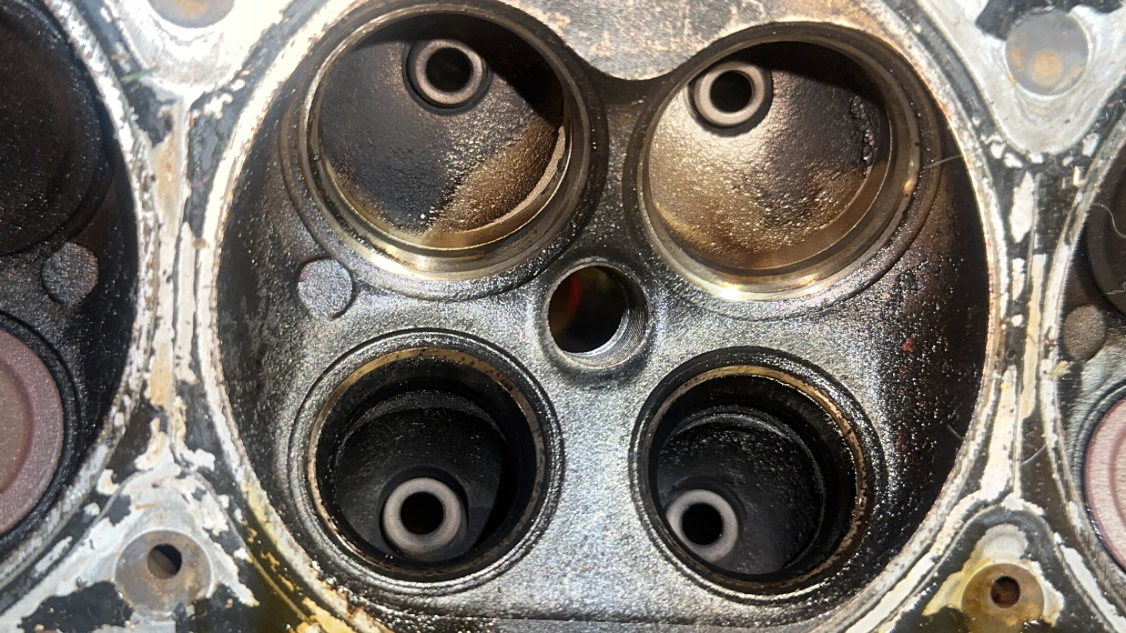

Removed head and intake/exhaust valves for cylinder 3. Im gonna assume the intake valves are disgusting. Should I be concerned with the carbon up the stems of the valves?
Valve seats also look a bit gunked.

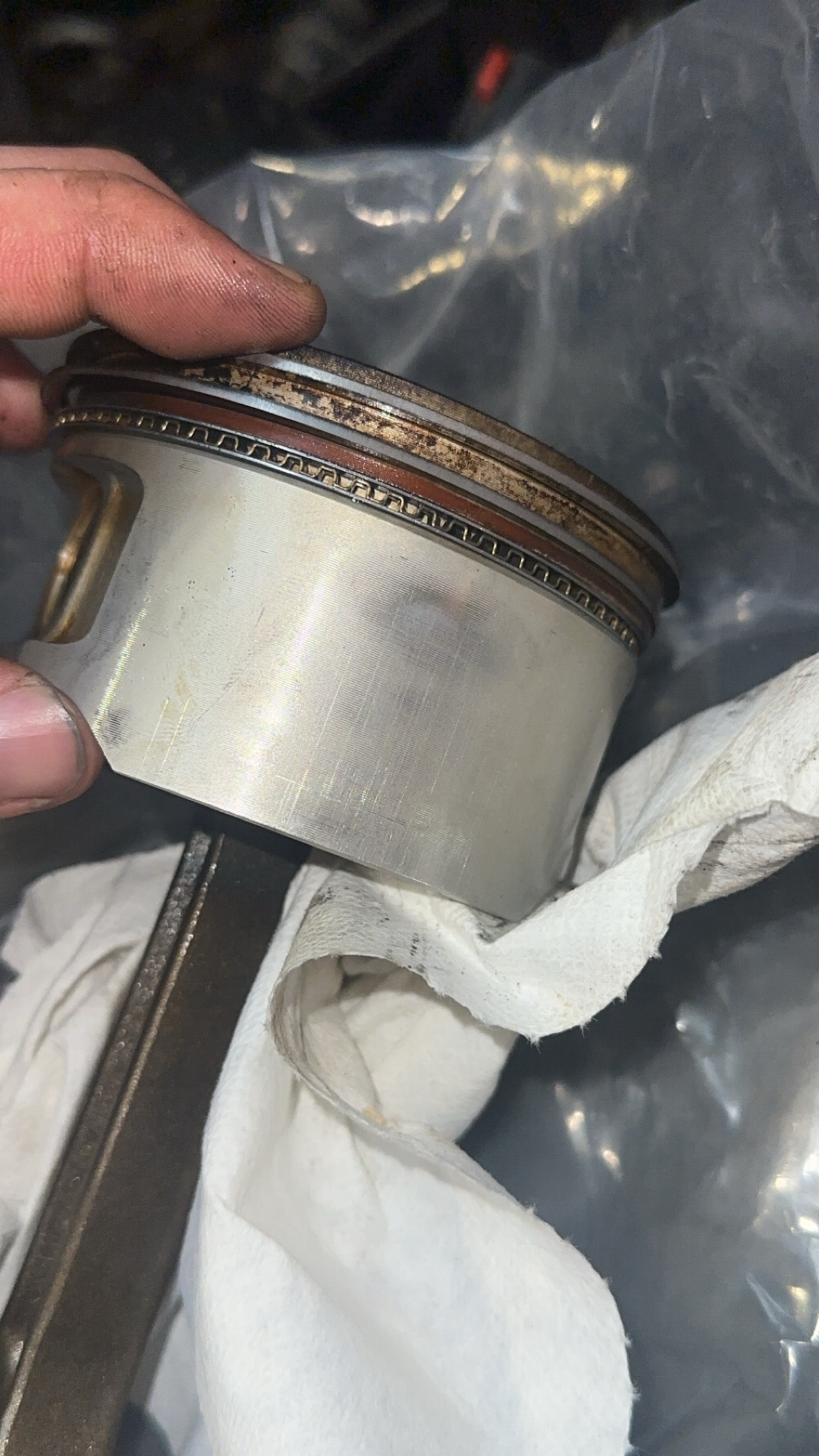

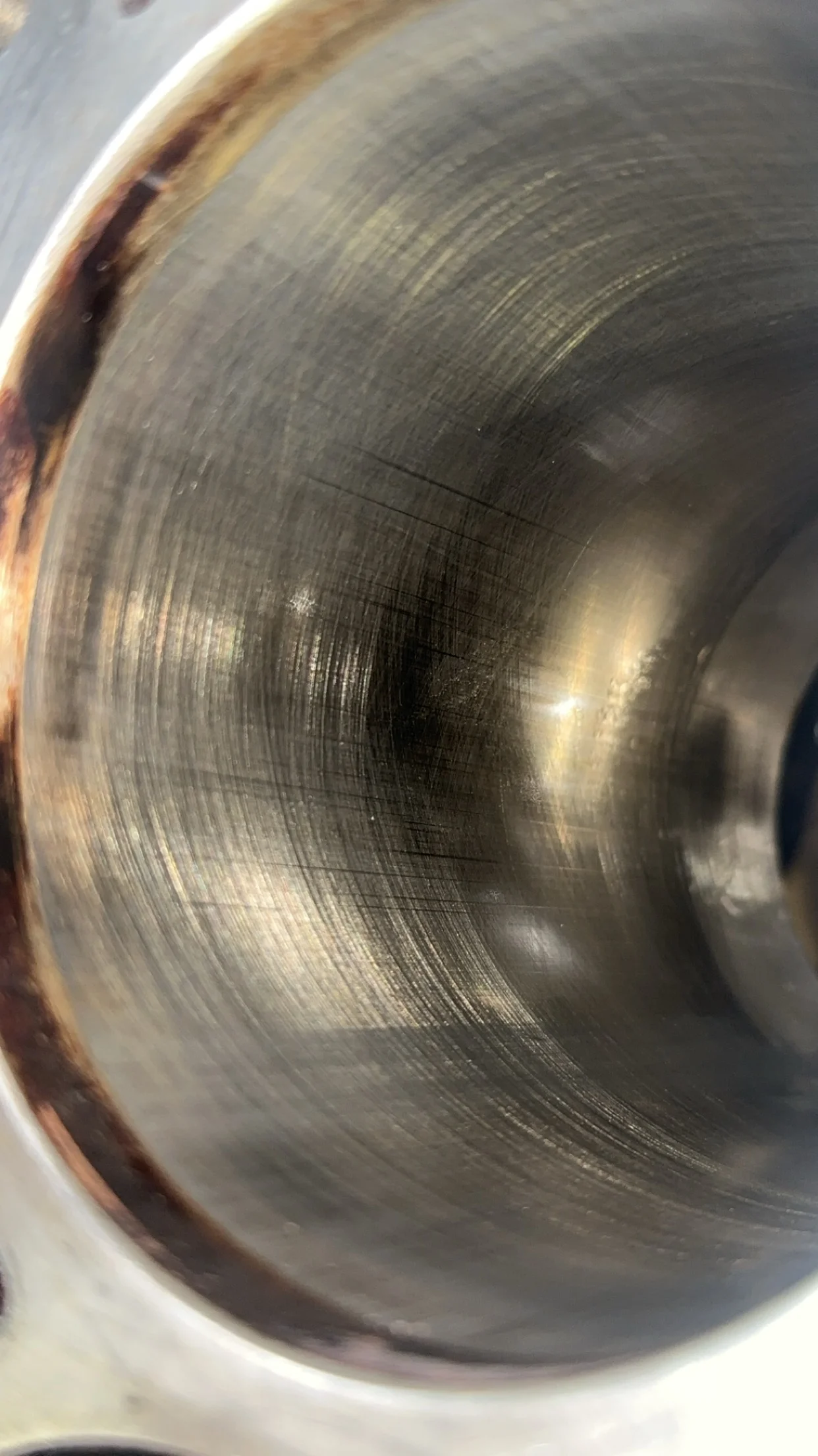

Still had 20% leak on cylinder 4 after lapping the valves, new head gasket, and getting the head machined. No leakage from the valves but a lot was coming from the crank case up through the oil drain holes in the head.
Pulled the cylinder and the wear looks suspicious. Both sides or the piston/ cylinder wall.
Decided to measure the bore diameter on all cylinders and the ring gap on cyl 4 rings, I think all bores are out of spec.
Manual specs say bore diameter should be 3.4446-3.4452 but all mine are 3.45132-3.45148, that’s roughly 0.006-0.007 out of spec.. so they definitely aren’t oversized.

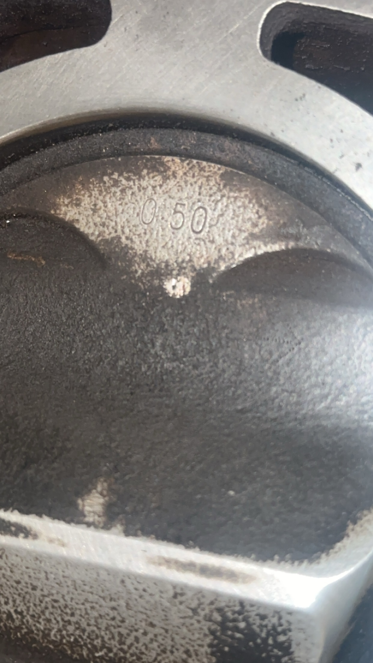

Anything stamped on the pistons to indicate they're 10 thou over?
-Mac
Just found on the top surface of the piston “0.50” which would mean 0.50mm oversized or 0.019685”, so basically 20 thou over.
The other marking said “87.97 SF0.03”, which I think means the piston diameter +/- 0.03mm
So you're 6 to 7 thou over spec, you have 2 thou larger pistons? I don't see the mm on there...so I'm assuming 5 thou over which liberally would get you in spec.
You could throw new rings on. You could just try number 4. You could do a quick hone and replace the pistons. You're there anyways so at least rod bearings.
Or find a machine shop to bore it out, order a $2000 stroker kit and send it. Maybe you'll have better luck with machine shops in your area.
Or maybe it's time to shop around for something used or a short or long block.
Clearly seems like you've got the time and enough know how to make some good decisions. I don't know what's in your budget... time or money wise.
