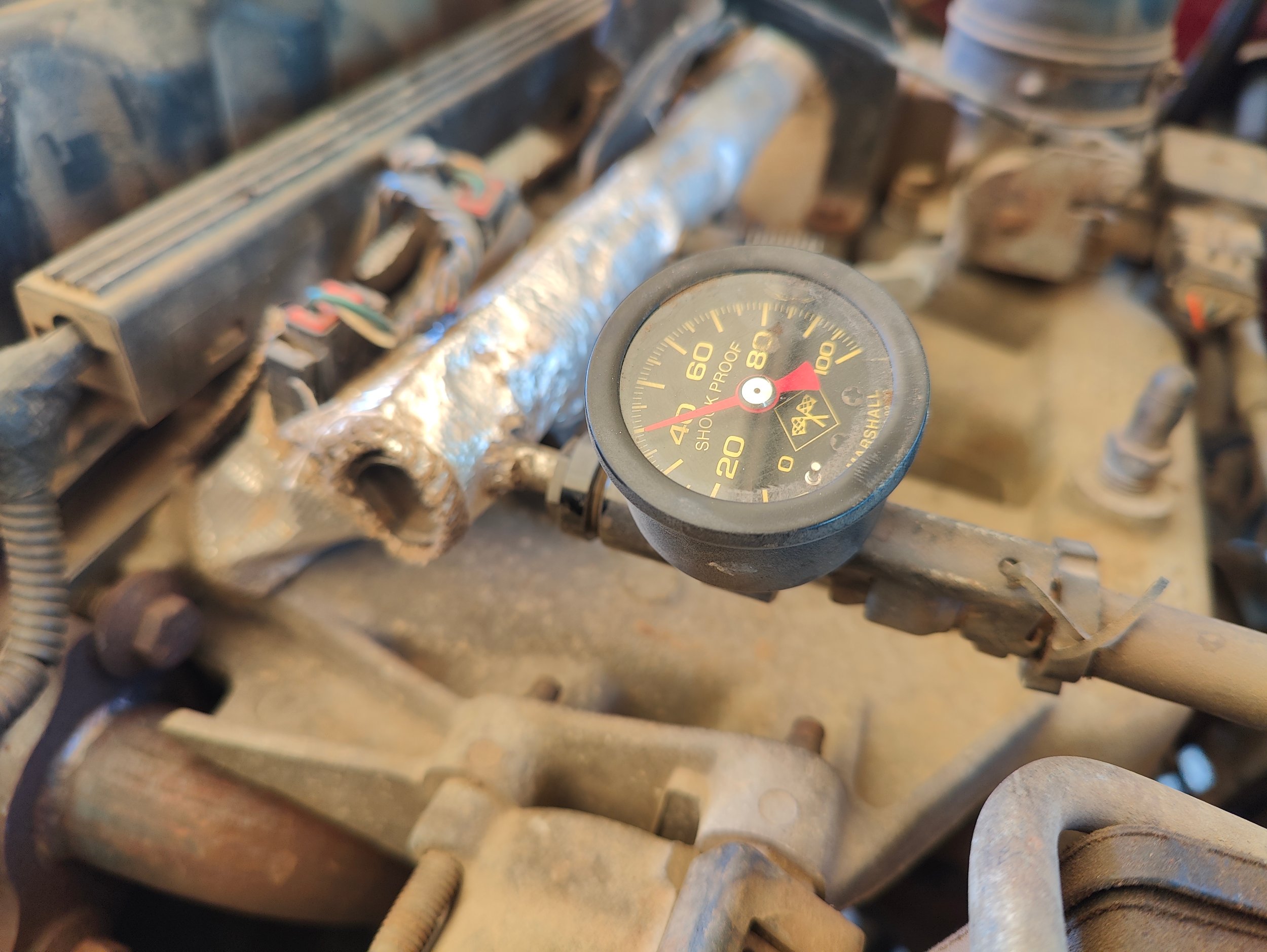

You may want to hang a Schrader valve on that 1/8" port and get a test gauge with a 3' to 4' hose you can route out the hood and tape where you can see it.
Or again an electronic gauge.
I did mine this way (for now) so I could glance at the fuel rail and confirm pressure. This was largely in response to putting the cheapest Brute Power fuel pump in my 97.
-Mac
Reactions: Stretch97
-Mac
Schrader Valve
1/8” barb x 1/8” female NPT
1/8” Fuel line
I think with this setup I could use the female npt / male barb fittings on each end of the hose and thread the schrader valve and the gauge I linked into them.
Let me know if I messed up I’m kinda a noob 😂

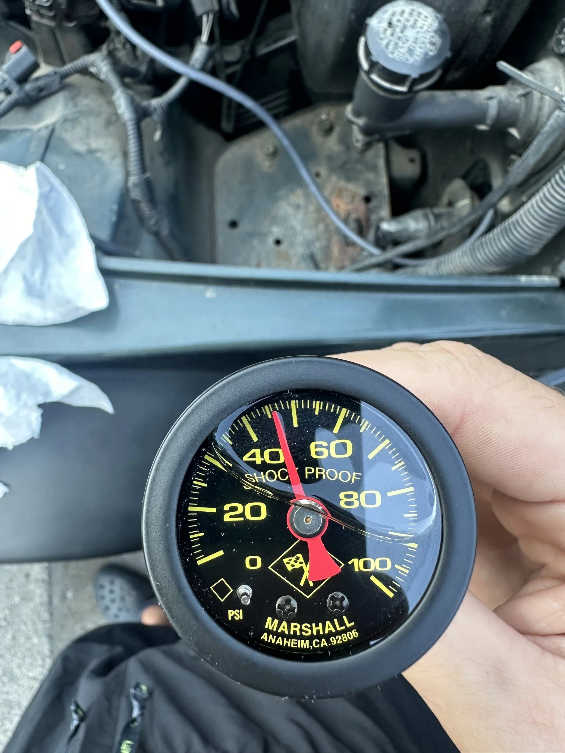

Created my fuel pressure gauge, stayed at ~46psi the entire test drive, even at idle. After shutting it off the psi dropped to zero after about 30 seconds.
I know it says the range is 44.2-54.2psi, so does mine seem on the low side? Let me know your thoughts.
Okay so fuel delivery/components should be all set then. Maybe there’s a vacuum leak under load? I know if the leak was present during idle the RPMs would spike, but I think under load it would cause it to bog down.

My first suggestion would be to check your air filter, make sure that’s not gunked. I’d then inspect your throttle body. Good excuse to clean it even if it’s not the culprit. I’d next test your cats to make sure they aren’t collapsed and plugging your exhaust, you can do this with an infrared thermometer, lots of threads on this. If that’s not it I’d try testing your fuel pressure. Unfortunately I don’t think our fuel rails have schrader valves so I built an inline one to test it while driving. There’s a link somewhere in here for the adapter you’ll need, then you can use this gauge to test. You’ll need fittings and hose to run it inside to watch it while driving.
If your fuel pressure isn’t in the suggested range, I think around 45psi, your fuel pump is likely failing.
