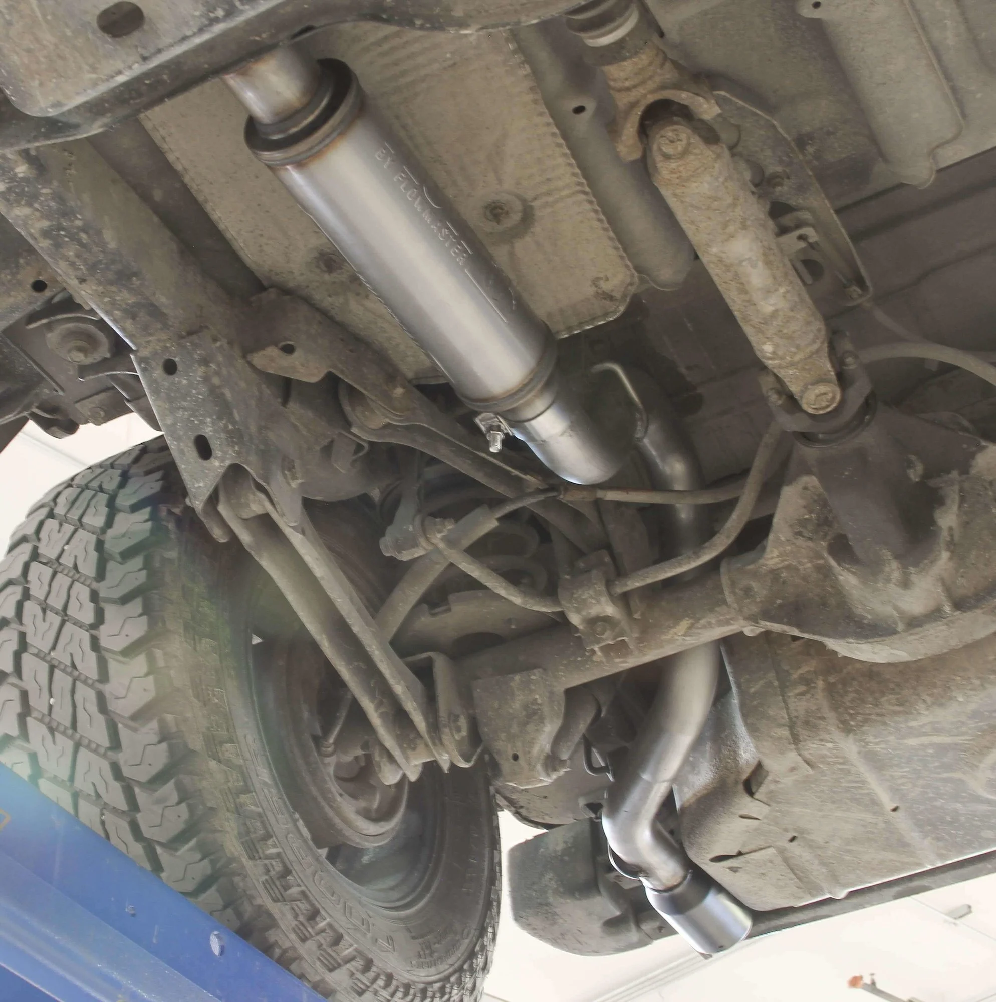

Mine with RE 5.5" LA kit (now with full set replacement MetalCloak arms) had a small blown-out muffler can attached to the rear cat-con flange. Due to limited space to the adjacent passenger side upper control arm, a wider or longer muffler wouldn't fit without encroachment as wouldn't one with offset outlet. So, I purchased a Magnaflow 17122 which fit well and mated to that existing flange and quieted it a bit inside, however the final solution was routing out the back with a Walker 54287 specific-fit tailpipe, which then required modification to relocate the mating junction point with the round Magnaflow vs oval Walker Dynomax muffler with offset outlet intended for that tailpipe. I don't weld, so had that done. So much quieter now, with no clearance issue at the RR shock body or fuel tank. Links show those products but I paid much less elsewhere than the prices shown. As seems is usually the case, one aftermarket modification leads to another and so on...

Flowmaster FlowFx’s 2.5” straight-through stainless steel performance muffler.

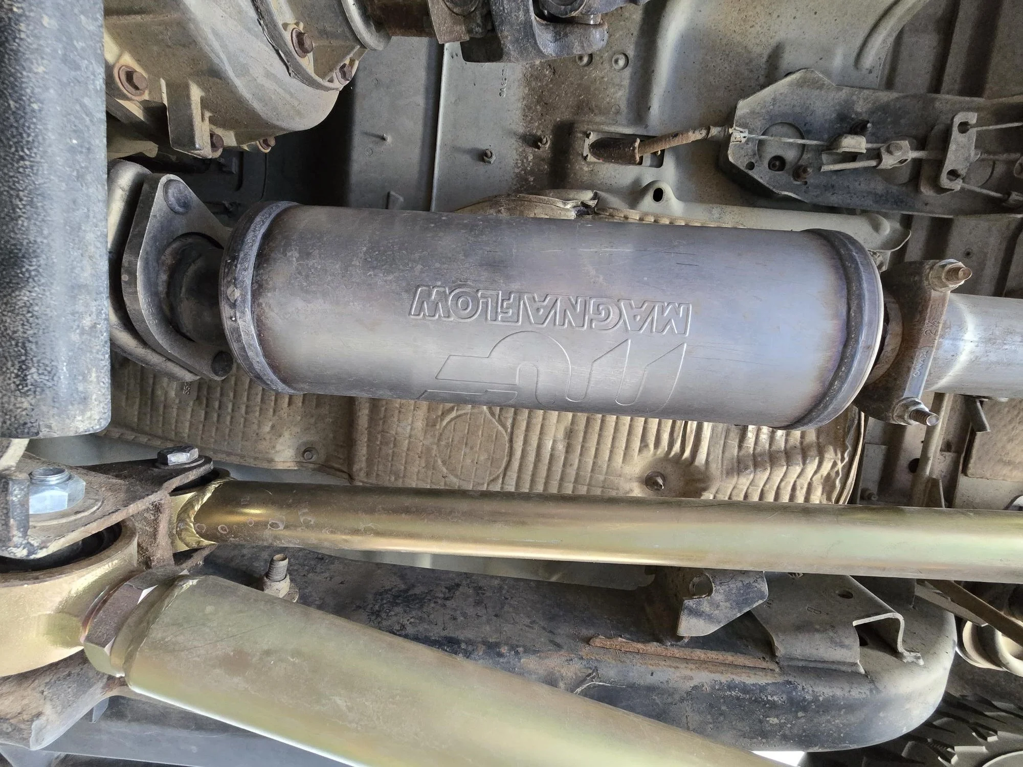

Yes, it sounds like my problem is very similar to yours. I have a teraflex long arm kit that's part of the problem... Any chance you might be able to post an audio clip of what that muffler sounds like?
Hadn't tried recording exhaust audio, so downloaded a phone app and attempted without success. Doubtful would truly be representative of "ears-on" anyway. Like the Boogieman showed, this is the Magnaflow 17122. Being 5" OD by 14" OAL with 2.5" pipe diameter, realistic expectations are needed on sound attenuation but exiting out the back from under the tub with a tailpipe is what made the difference between somewhat better and significantly better. I liked that this MF uses a captured flange plate which allowed rotating the muffler to clock orientation for best angle.
