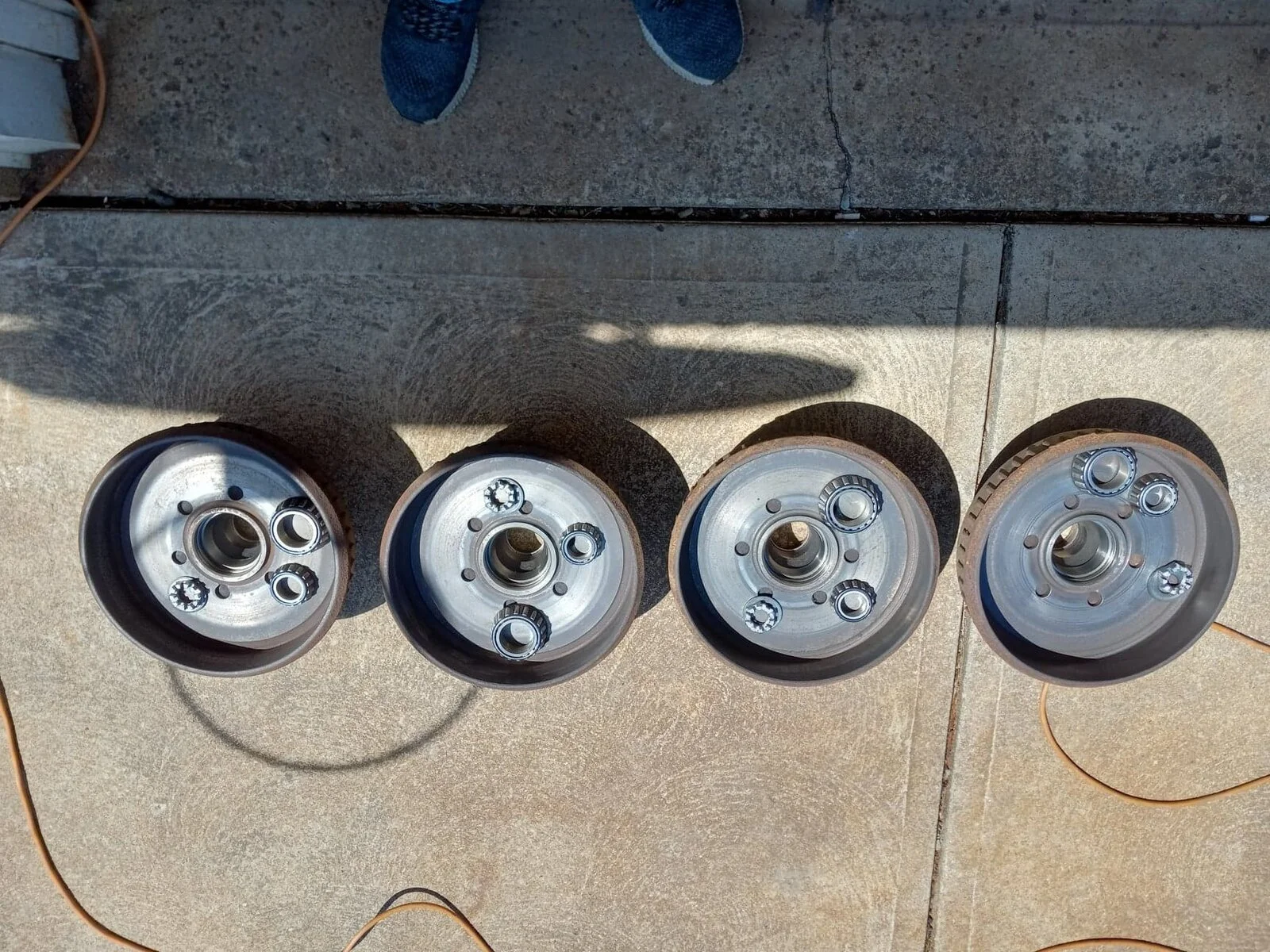

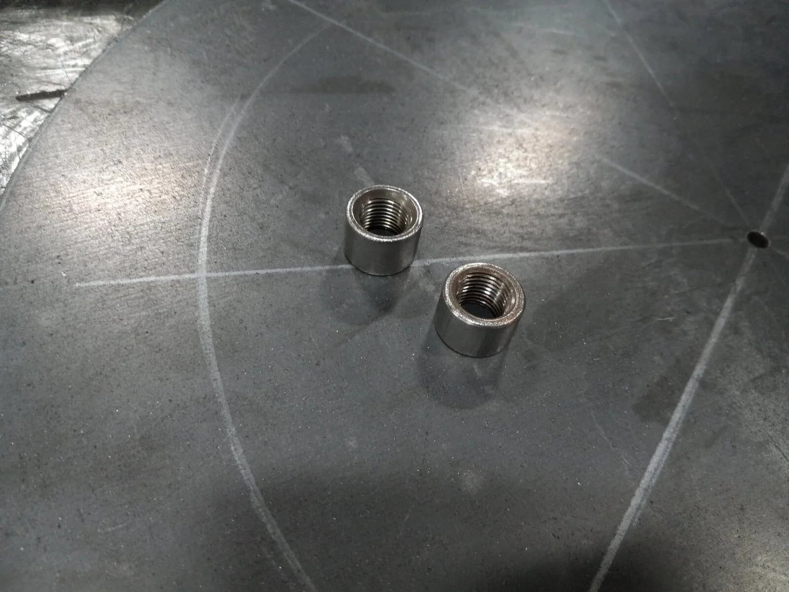

made myself several 1/8" NPT bungs gonna try and braze 1 into the trans pan and i got the trailer hubs spic-n-span, all bearing are good and ready to be repacked fresh found 3 kinds of grease in 2 of the hubs and only 2 types in the other 2 hubs all 3 different greases, i cleaned every bit of that out.
i tested those brakes 1 is no good 1 is iffy and 2 checked ok problem is the screw ups are not on the same axle and i'm not doin 1 side of each axle. pads magnets and springs cost more that new assemblies so i'm going with 4 new brake assemblies.

What's the benefit of brazing in those bungs as compared to welding?

the trans pan seems thin as crap and i'd rather not arc through it, am i wrong? seems like pot metal to me not near as thick as the oil pan even.
if i pull it off and it seems like it's thicker than i feel it is i'll go ahead and weld......but i'm prepared to braze if required.
I’ve welded bungs into a few trans pans, never had a problem. I’ve never brazed, that’s why I was asking.

You could Tig, Braze or Mig.
Tig would be first choice because of the ability to control the heat, be leak free with a small bead with very minimal distortion. Followed by brazing because the brazing material will flow into the void assuring a leak free joint and a high strength fusion weld isn't necessary. Lastly Mig isn't out of the question but since you don't need a high strength fusion weld and the possibility of burning a hole in the thin pan then I'd use this option last. Just my opinion
