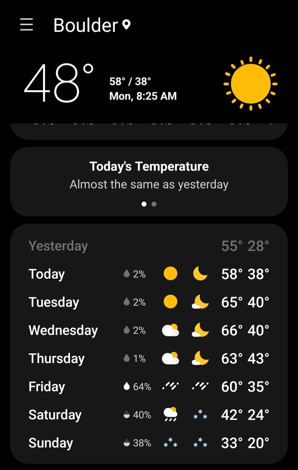

finally gonna get to see some of that mild weather, the CO. guys have been enjoying all wk, they only sent 2 days worth but it's a start.
roads are still covered with salt and brine, so the jeep stays grounded to the yard for now, it'll take several days of rain to clean the mess away b4 she gets on the road. and we always get some last season snow, so it's not over just yet.
