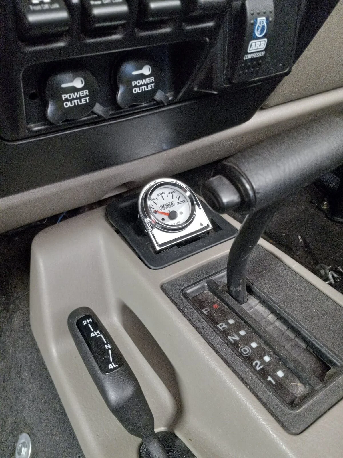

played with location for the temp gauge, don't want it up top of the dash or on any bars or riser, don't need it centralized so i become fixated on it all the time. so down and out of the way of knees and hands and levers, but still in a direct line from my eyes with no obstructions. carved out some of the plastic so it'd lean back. it's not far from the sensor and not far from vamping a power source.
well the gauge is wired in, just need to connect power and the sensor. found a hole in the tub center of the tunnel right above the trans tail the wire went right up and into the coin cubby i'm workin in.
