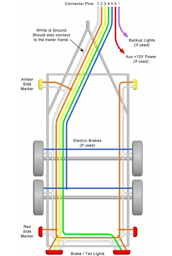

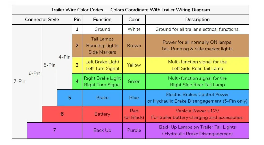

i been trying to do some research on it. this seems fairly easy to follow. if i deviate colors i'll be sure to label it.
https://mechanicalelements.com/trailer-wiring-diagram/
Good wiring project to get your feet wet. Trailers are extremely simple, as long as you have a good ground. Make sure each light has a good clean bolt and ring terminal and drill a new hole for it so you're not trying to conduct through iron oxide. Same at the tongue... White wire too a fresh, clean hole in the tongue with a good ring terminal. Now the whole frame is grounded and you'll have good lights for a long time.
while i won't claim to be an electrician or even have an apprentice's knowledge. i can fumble through most of it....i'm not uncomfortable with dedicated circuits, it's cutting into the sys that i have trouble with, knowing whats run where and fed from what and what has room to support more is where i have issue.
it's all new construction so they'll all be clean new holes.
i have seen diagrams with a ground wire run all the way around the structure and everything tied into that common and i have seen the structure used as the common. running just the power supply around the structure and grounding everything to the structure.

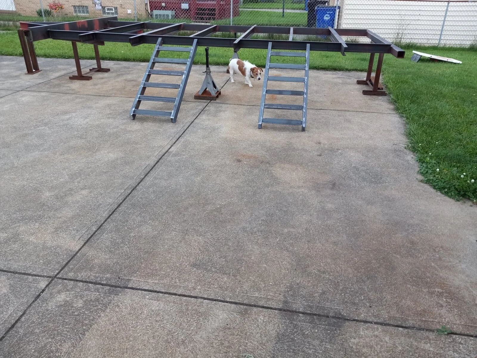

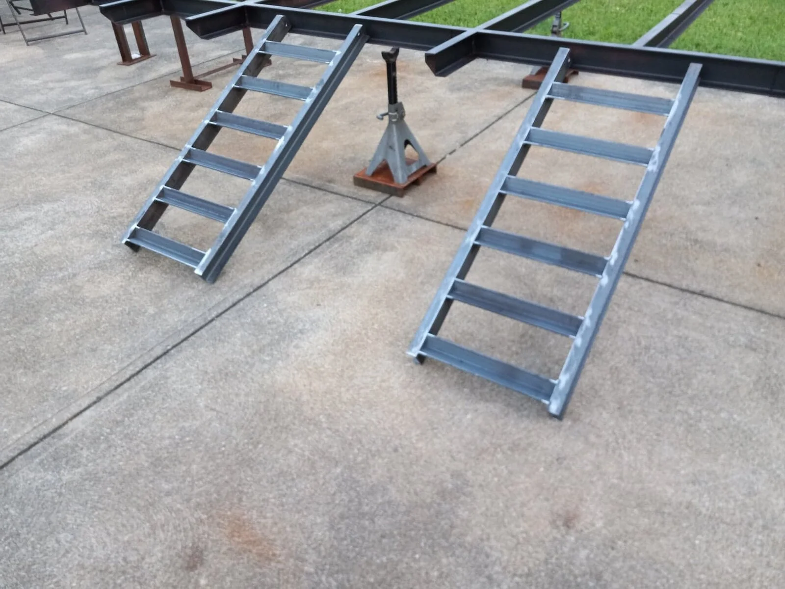

been dickin with stupid little punch list crap nothin much. did make up a couple ramps, just shortys 50"x 18" from 3" channels and 2x2x1/4 angles. i'll get pics up when i unload them.
all that wiring in the jeep is buttoned up.
even worked on the trailer the other day some, got the bottom surface cleaned and primed. made a hand full of gussets to do some tie ins from the cross members to the main beams. and started drilling holes for wires/conduit.
i did some reading on trailer construction, and specifically the way brackets weld on, i had a hunch and it was confirmed so i am adding a flat bar. the brackets will weld to the flat bar the flat bar will weld to the main beams, 1/2" x 4". i figure it might work 2 fold, 1 being not welding across the main beams and the 2nd being it'll strengthen the horizontal bend rating of the open face C channels in that zone.
gonna try and get some welding done tomrw.

couple pics of those ramps........they look steep, but not as steep as trying to load with no ramps. 8" centers on the rungs, still need to cope the bottom so they'll sit flat on the ground once i have a ride height established.

i test fit a set of springs and an equalizer and got the brackets welded on.....looks good so far.
i'm gonna clean it up tomrw and prime and paint a fair bit of what will be the underside. any burn off from welding can be touched up. then it's just clamp these up to my main beams and weld um on there.
