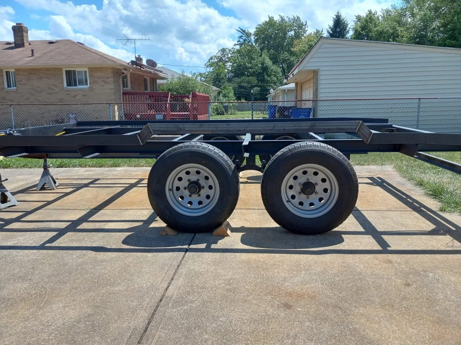

tongue pieces. that lends support so that 4" span won't be springy.
i added some belly stiffeners too. from the rear of the 3" pictured above. i didn't wanna carry them back further until axles had been placed. i sistered them up about 6"and they run back to the cross member right b4 the axles.

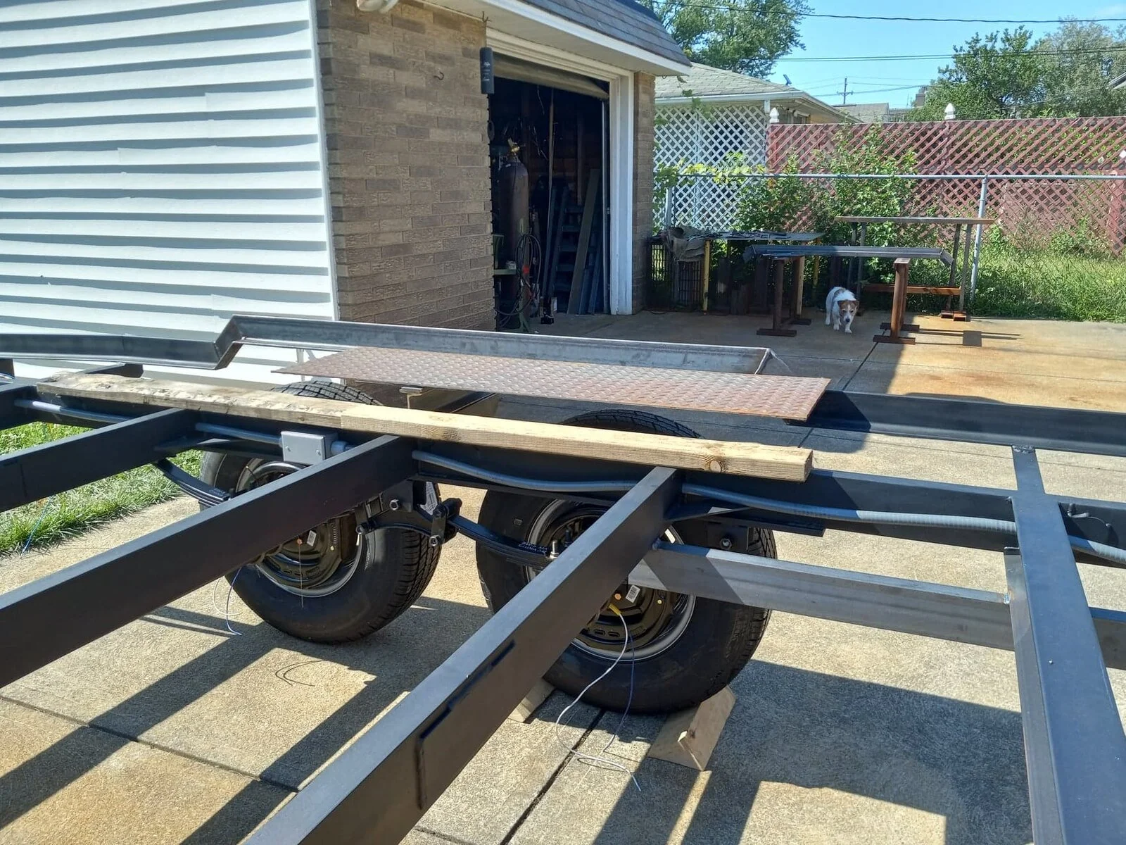

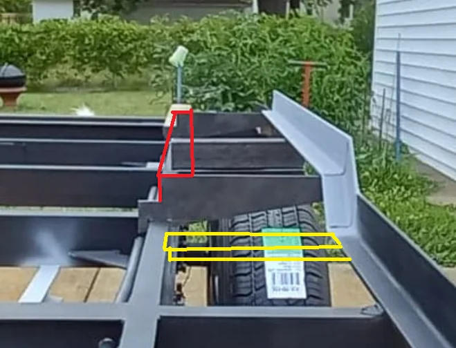

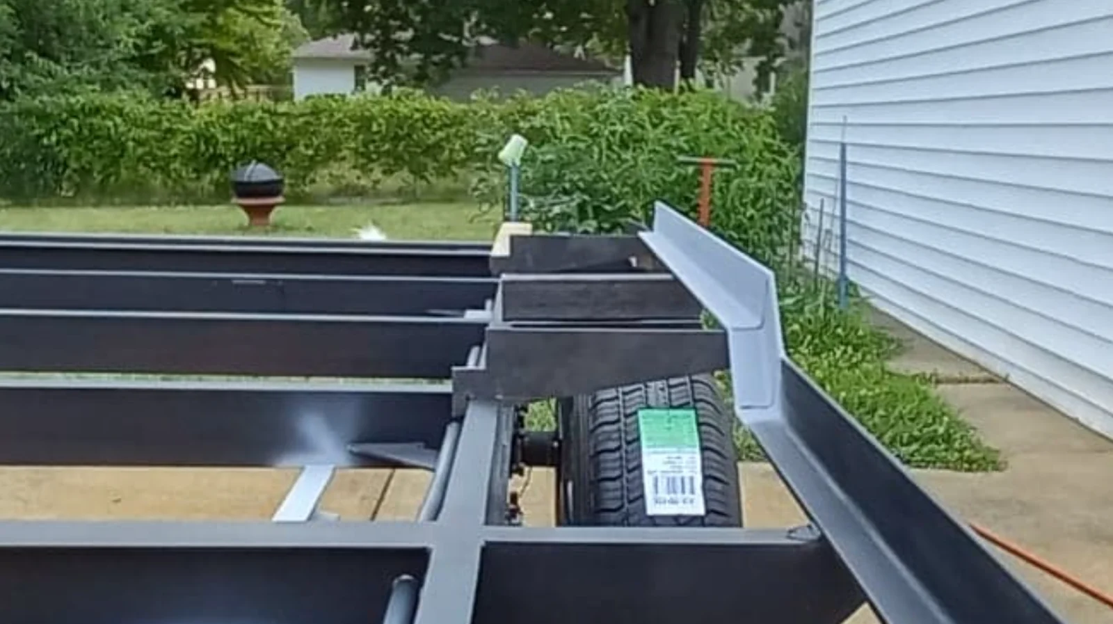

couldn't weld Sat or Sun it was raining. Sat i dodged the showers and got the tail lights brackets made and got all that fit. Sun was a total wash out. i got those 1/2" plates shown above shaped up, the tube in the center will stay.
to what's seen above, i'm gonna take what i cut off the rail and flip it around and use it for an inner edge on my humps. she got a meeting tomrw eve so maybe i'll have time to get it all set and at least tacked together.
the 2x material is the same height as the step cut on that 1/2" plate, it's not gonna leave much to run over so i think i'm just gonna go for a box with the diamond plate and i can use lumber to make my angles onto and off of it as well as along side it, just enough to break any hard edges
i'll have to add some angles to support the flooring, can't have any floaters.

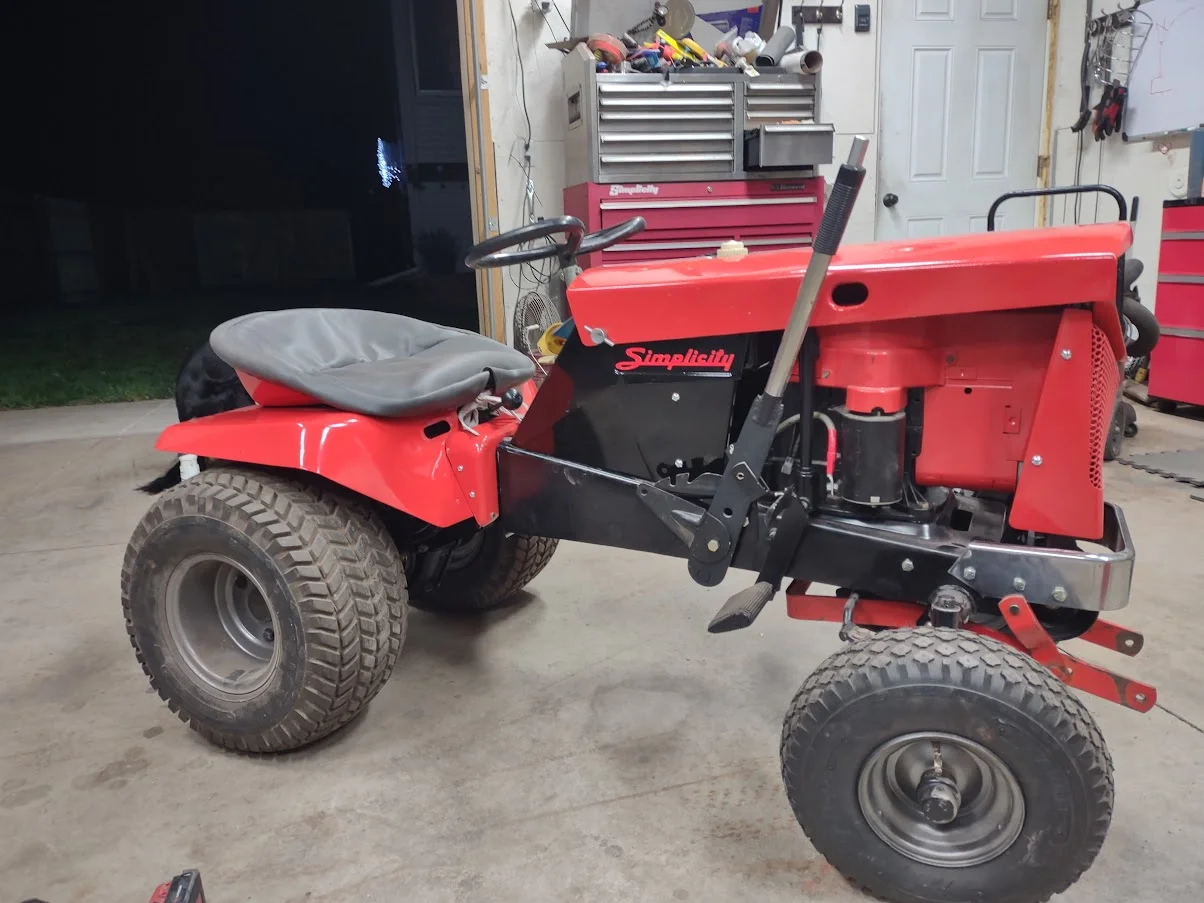

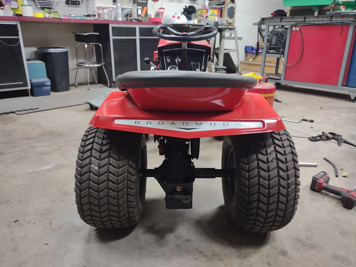

The farm and implement paint is good stuff. Run down to TSC and pick up the paint, some reducer and Hardener and spray it from a HF 20 dollar gun. I've used it quite a bit on mower decks, tractors, trailers, things that take a beating. It takes a while to fully cure (like a week) but it dries hard. Its not powdercoat hard, but its SO much better than rattlecans. Its the same base as the rustoleum already there too (alkyd enamel) so you shouldn't have compatibility issues.
Here is my last tractor I painted with that paint. The hardener gives it some shine and durability.
I've actually contemplated being "that guy" and painting the jeep with it...but I can't justify the work to paint without doing it right. The Farm and implement stuff doesn't have the UV protection like a good automotive paint does, so something that sits outside all the time is going to fade.
