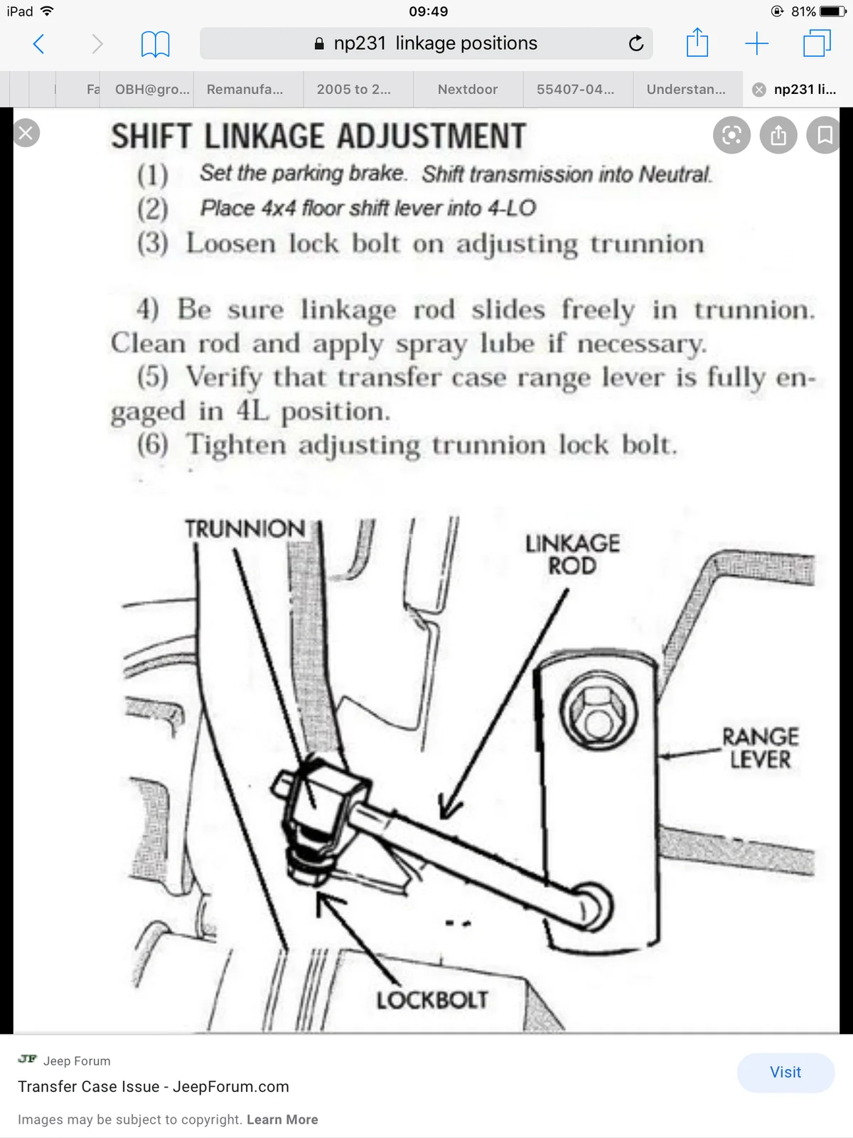

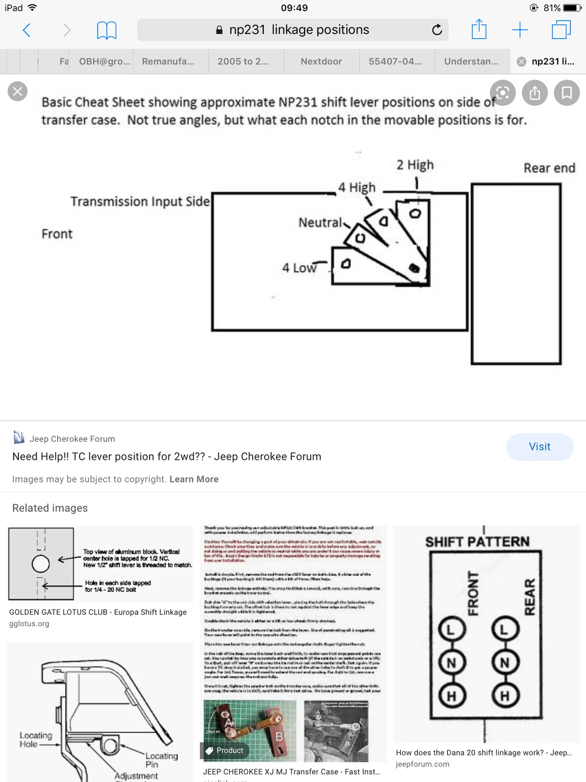

Hello. I've installed this cable shifter because my OEM linkage was badly rusted.
But it did not come with instructions and the YouTube videos weren't all that helful.
Before removing old linkage I made sure transfer case was in 2H then installed cable shifter.
Then test drive....I start out in 2H works okay....then shift to 4H seems to be okay not sure though.
Then shift back to 2H...but doesn't actually go back to 2H til I've traveled about 50 yards....
and then I hear a loud clunk....then it feels like it's actually back in 2H.
I am thinking the cable needs adjustment somehow but not sure which way to adjust.
Is there a way that I can verify all shift positions before I drive again????
Am afraid will do damage if I try to drive more.

Try adjusting it in 4L and see how it goes.
Yes I would much like to try adjust in 4L. But don't know how to determine
when I am actually in 4L. That's the problem for me. I've never actually used 4L so I don't know how it should behave. Can you tell me how to verify that I am in 4L?
