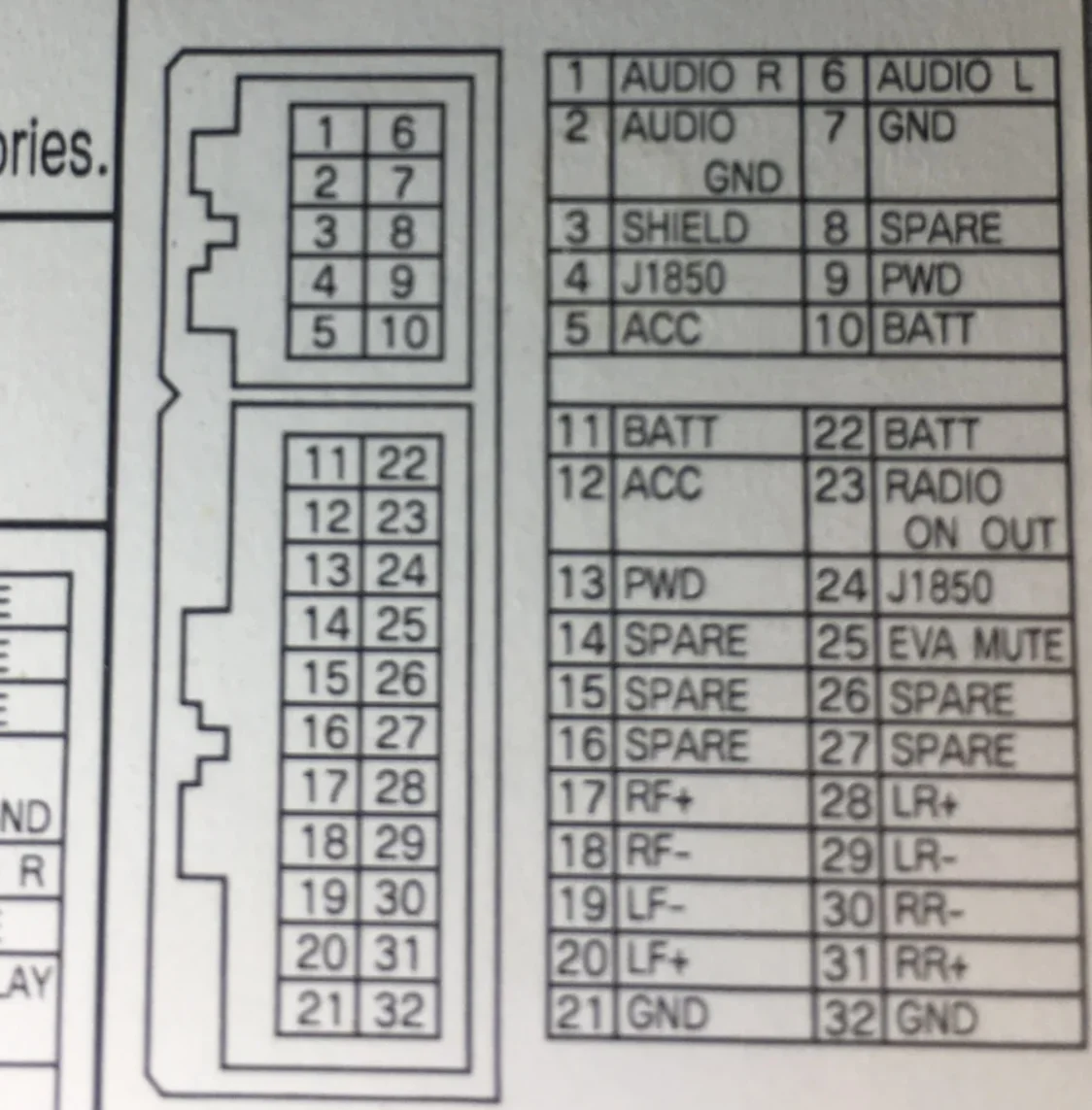

Ok, i have pins 11 thru 32 figured ouy to put in a new head unit. What i don’t get is what appears to be a small connector pins 1 thru 10. Is this connector even used on a new ddin unit with the iso connectors. I know they sell adapter cable which matches up to the larger connector to iso.
