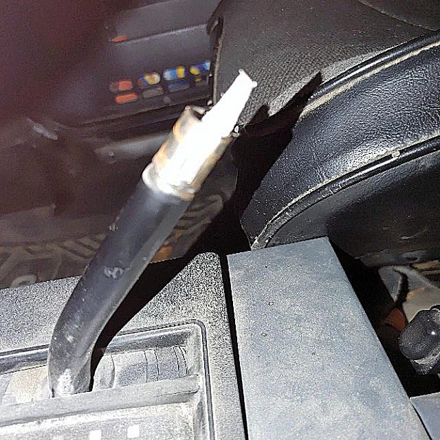

I finally took a picture with the handle off. No idea how far up it is supposed to protrude so if somebody can take a look at theirs to compare I'd really appreciate it.

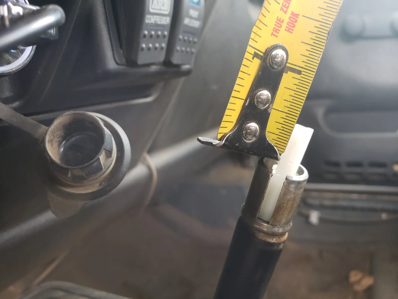

Sorry for the really shitty picture but my garage was about 105 degrees. It appears our shifter sticks are protruding about the same distance. This is my carved plastic coat hanger stick.
