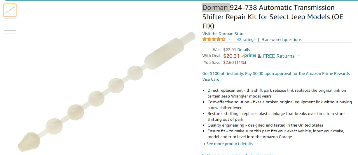

Sure. And it's cheap too! Not as cheap as a chopstick, but $20 isn't bad. Here is the link. I don't know if the link is working, but there is also a picture of it below too.
https://www.amazon.com/dp/B00FLFY93I/?tag=wranglerorg-20

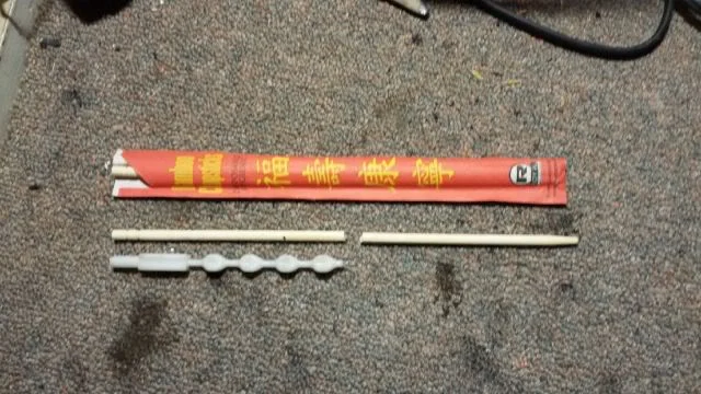

Better fix: Cheap and easy. Simply make your own replacement piece out of a chopstick (yes, Chinese food), or a piece of plastic coat hanger. Cut it about 1/8" longer than the broken piece you pull out. Massage one end to fit back inside the shift handle. Put it back together and you are done! The larger diameter of the chopstick, or coat hanger, will not pass the broken piece way down inside the shifter, and you interlock will function again.
5 minute fix.
My chopstick has been going strong for ten years, with no signs of failure.
This is my spare along with the broken plastic rod out of my shifter.

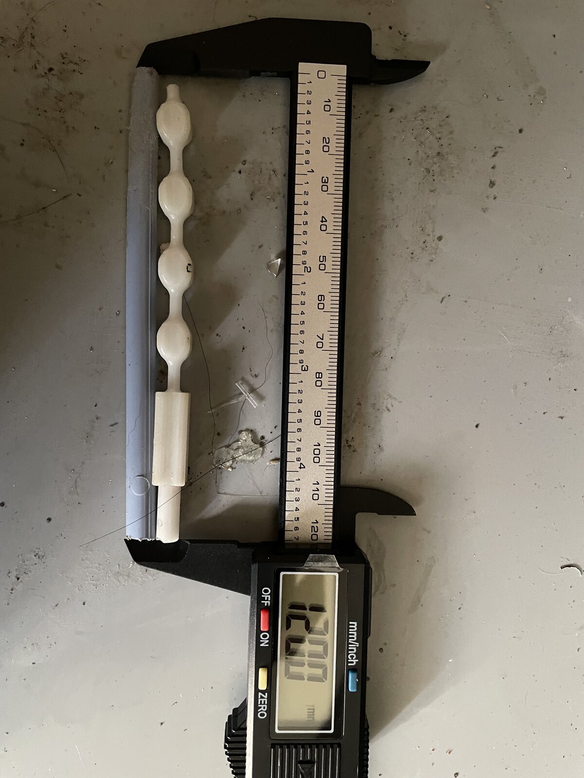

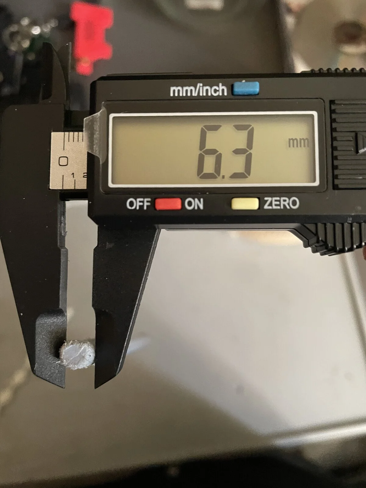

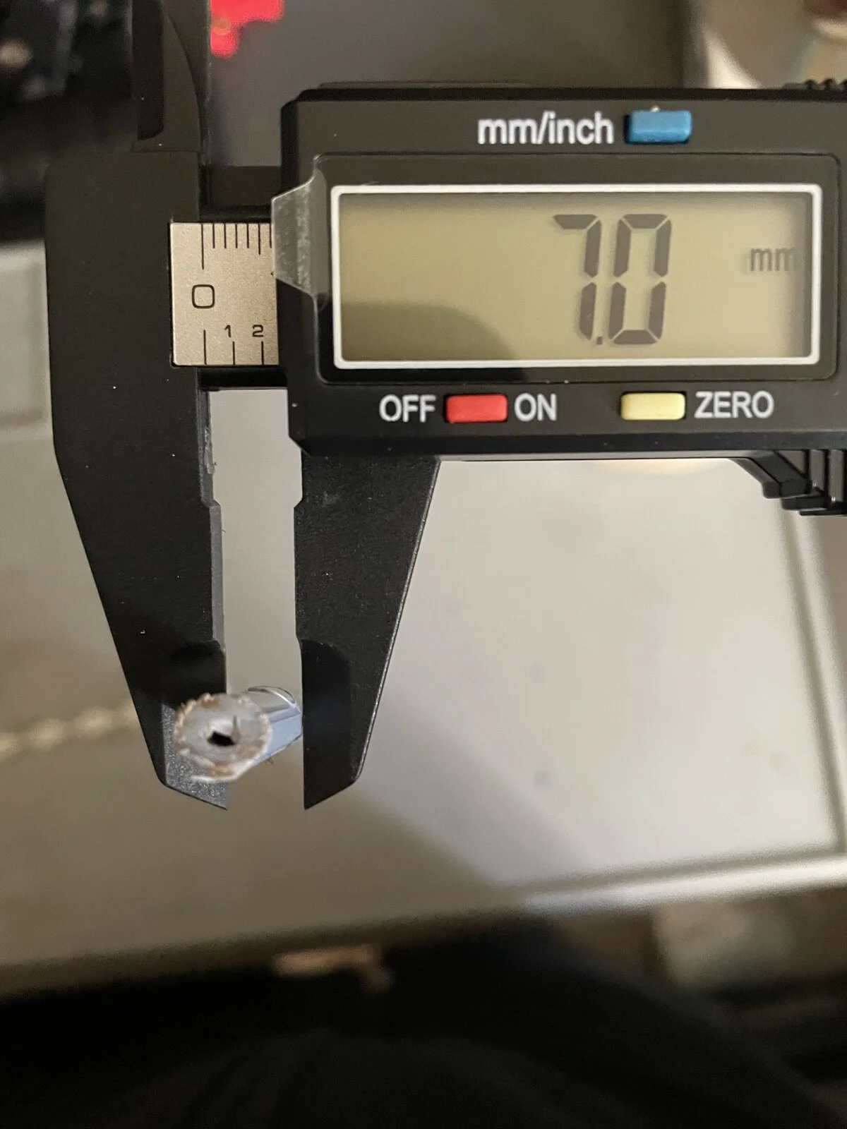

My shifter started sticking in and out of park this week. Pulled the handle and sure enough the plastic is broken. I took calipers to all of my plastic clothes hangers and found one under 7mm, cut it to length and hit the end with the dremel to sand it down a little to slide in the handle. Put it all back together and I could cycle through all of the gears without pushing the button, trimmed it a little shorter and it’s working great. Cut and sanded a second and dropped it in the console. Thanks guys.

Looks like my hanger was oval instead
of round, the wide side was right at 7mm. The smaller side closer to 6mm. I sanded the wide side down to 6.3mm. My total length was 120mm.

IMO it is such a flawed design that it isn't worth a penny.
I guess we'll have to keep using chopsticks and hangers!
Thanks for letting us know. Was thinking about buying the Dorman as a backup.
