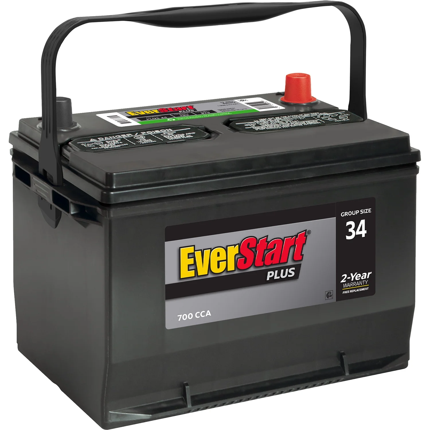

I usually get 6-8 years out of my "quality" Walmart batteries. $109. 🤫
