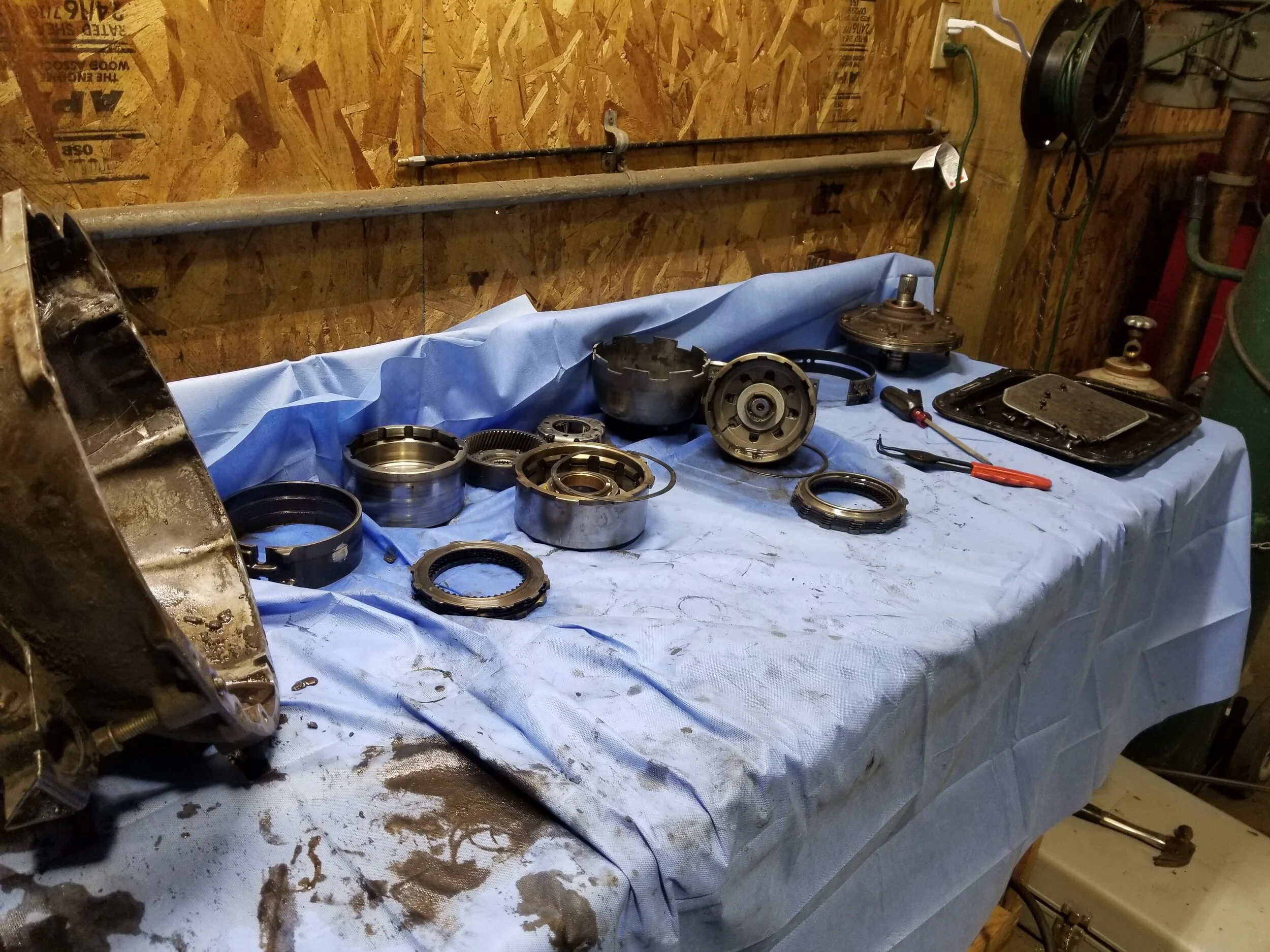

First and last automatic tranny rebuild.

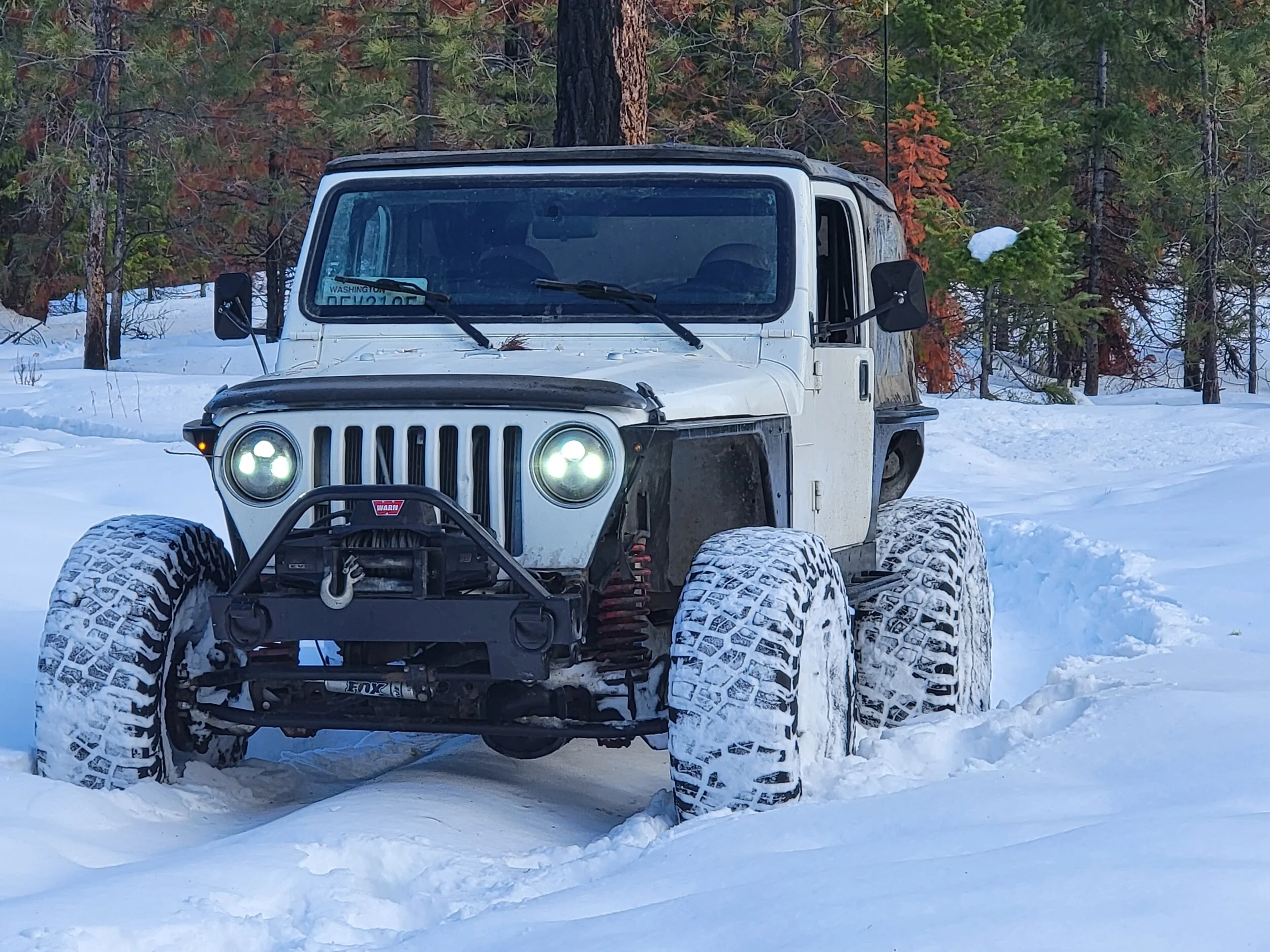

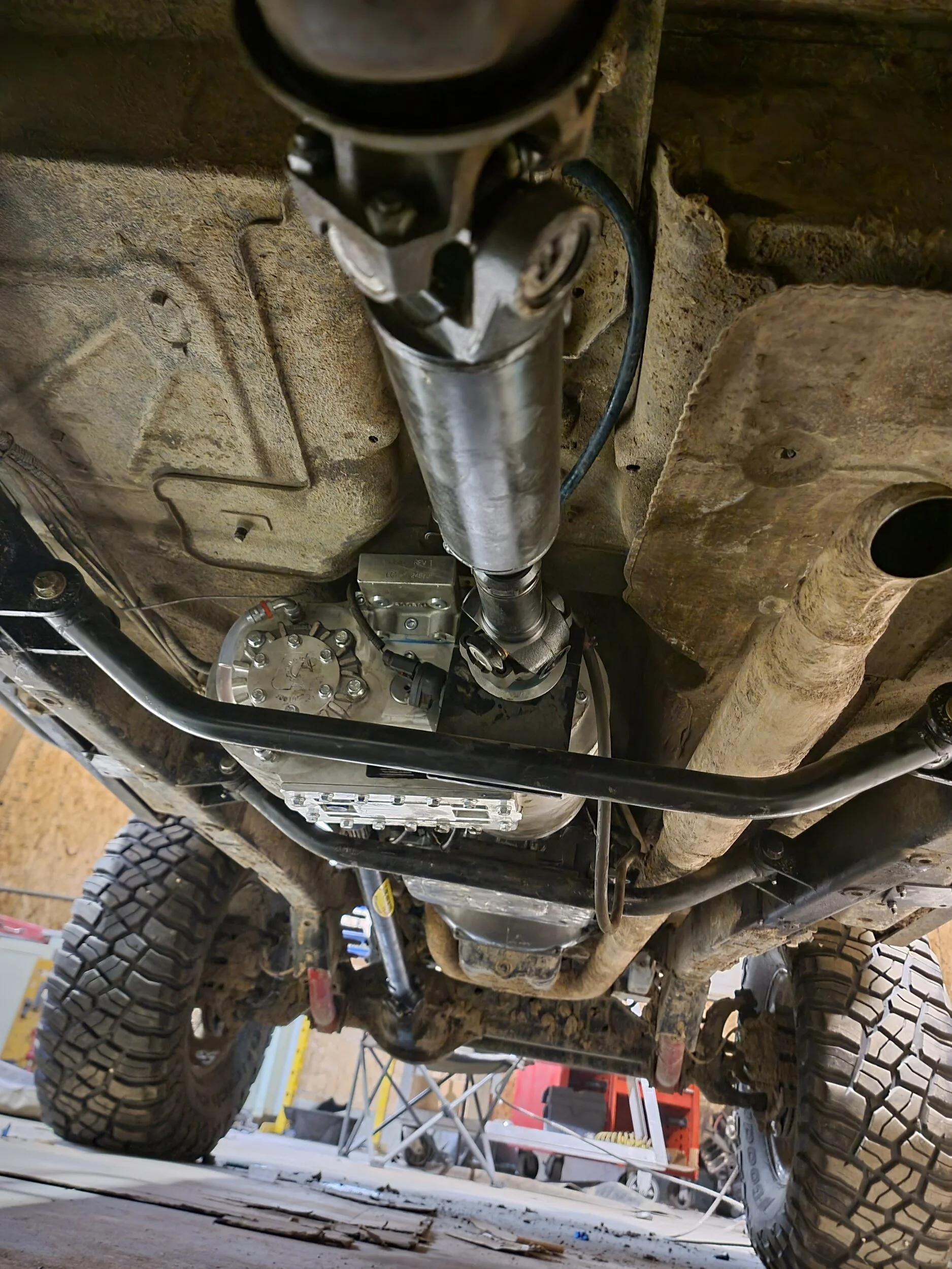

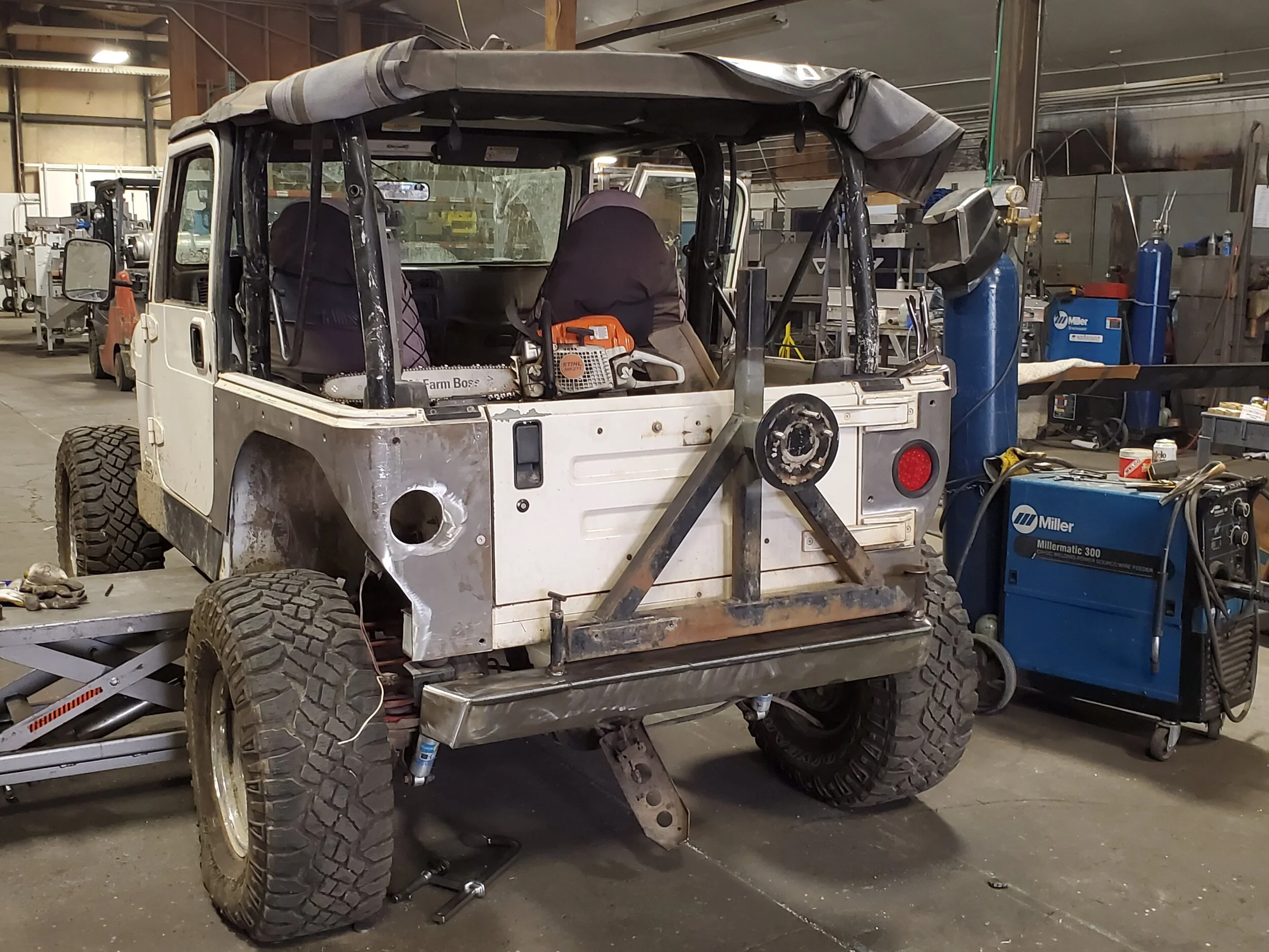

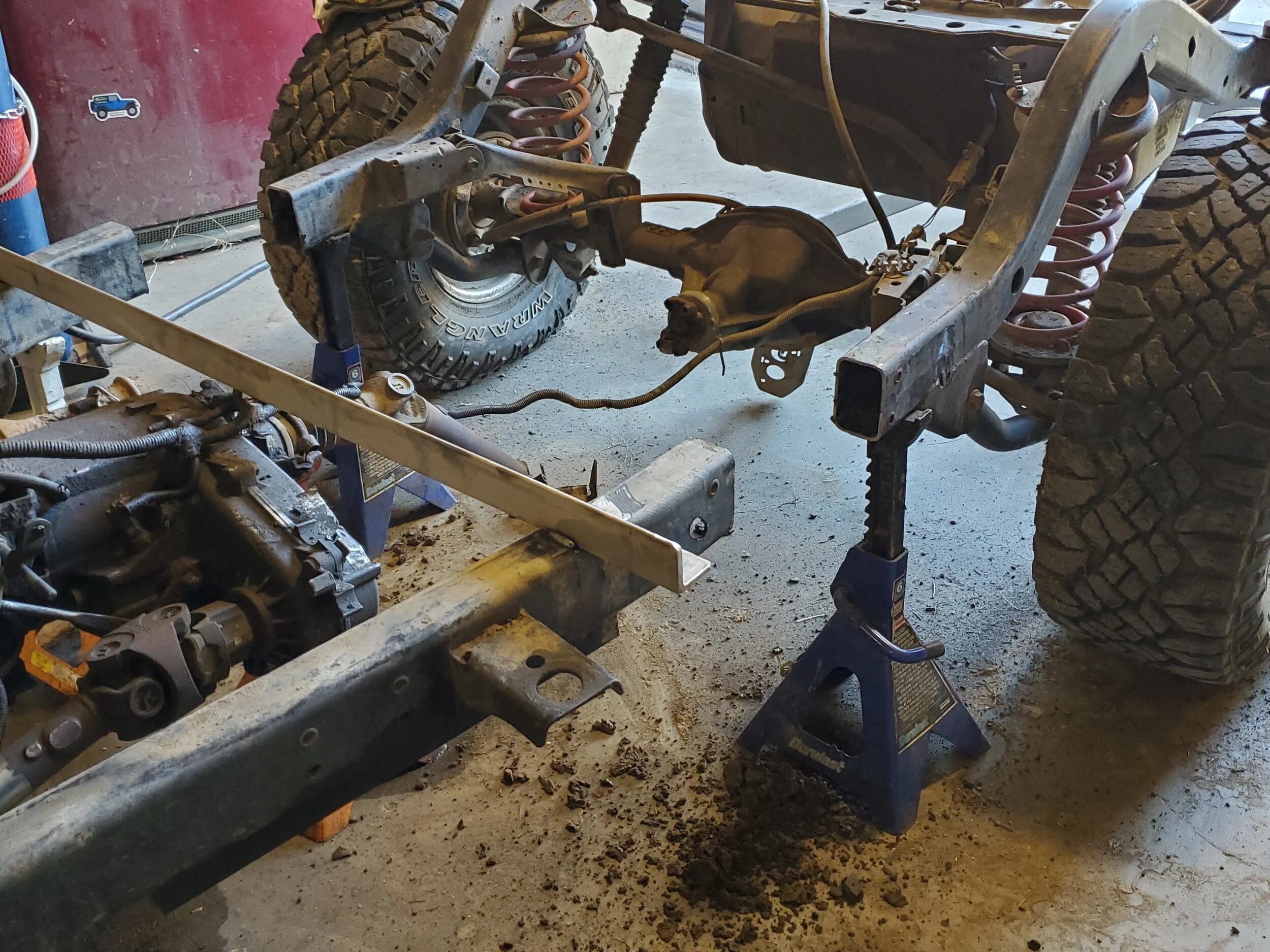

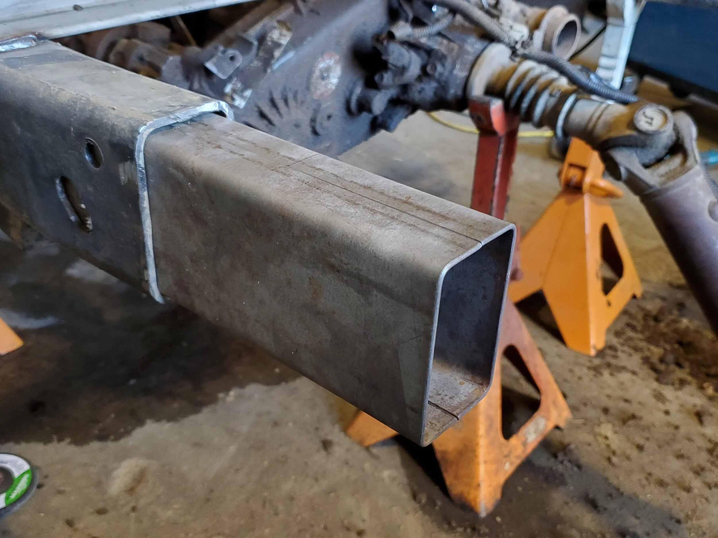

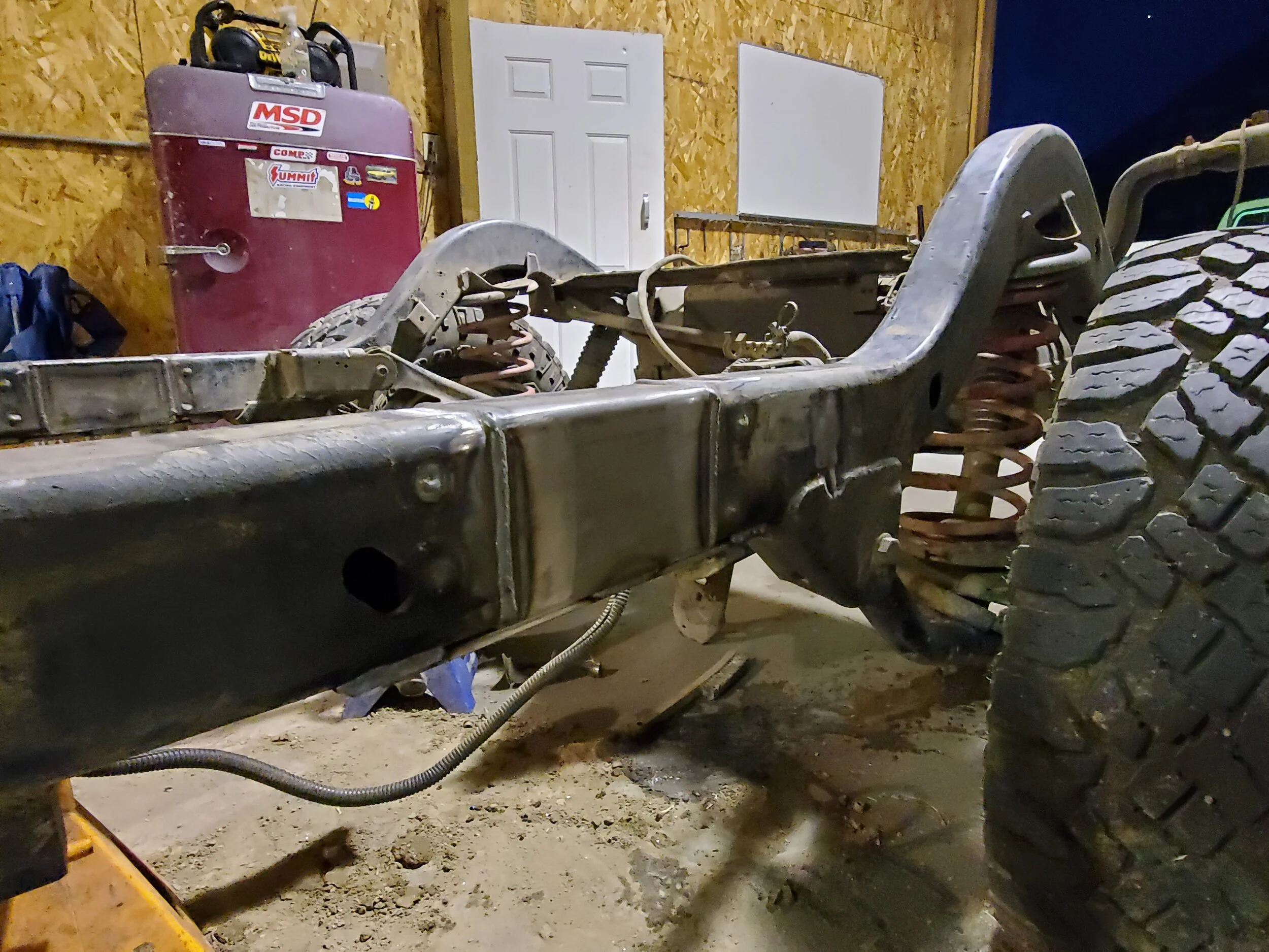

Have always wanted to stretch my wrangler but was undecided on which way I was going to go about it. Not sure if the route I went was advantageous or not, but I had access to a press brake and decided to do it my way. I was able to make sleeves and channels to match the frame dimensions and stretched the frame 9" in total. 6 in rear 3 in front. You don't see the addition of fish plates in the picture, but they were added. Stretching the frame the way I did allows me to keep my axel centered under the frame arches. Overall I didn't run into too many unforeseen issues and I am happy with results.
Custom bumper, spare tire carrier, and blank corner guards.

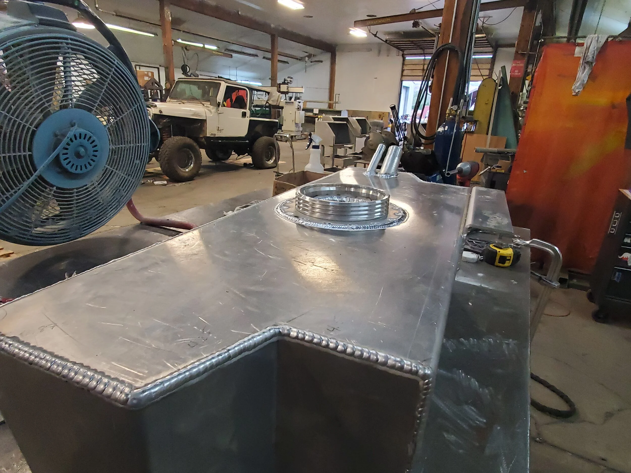

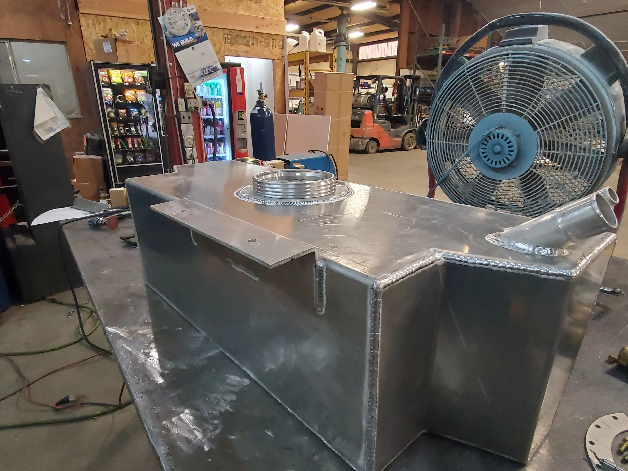

Honestly, this custom aluminum fuel cell I made was by far my favorite part of the project! It had been many years since I made something out of aluminum. Capacity came out to about 15gal, and uses stock Jeep pickup. No leaks and works like a charm.

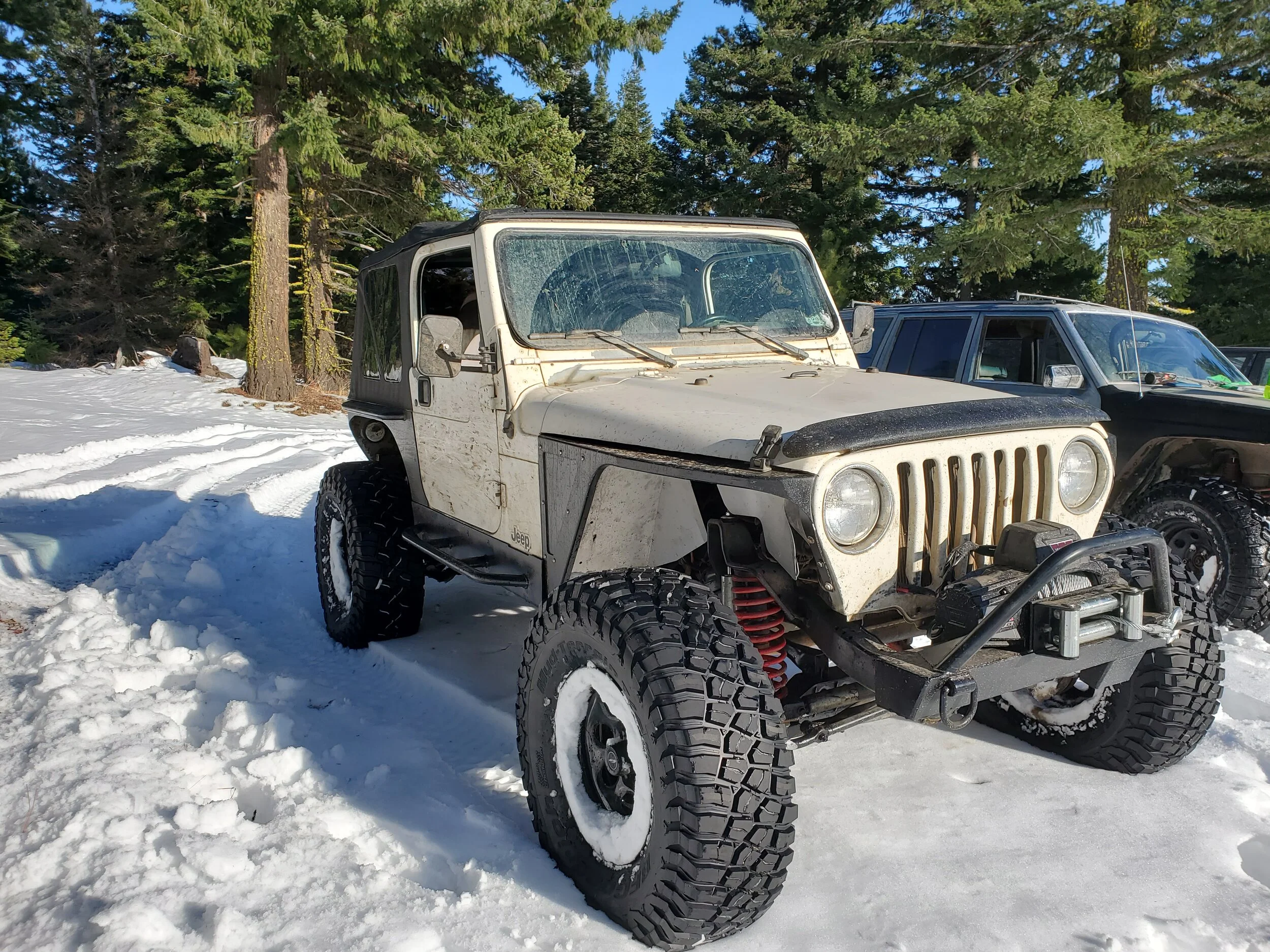

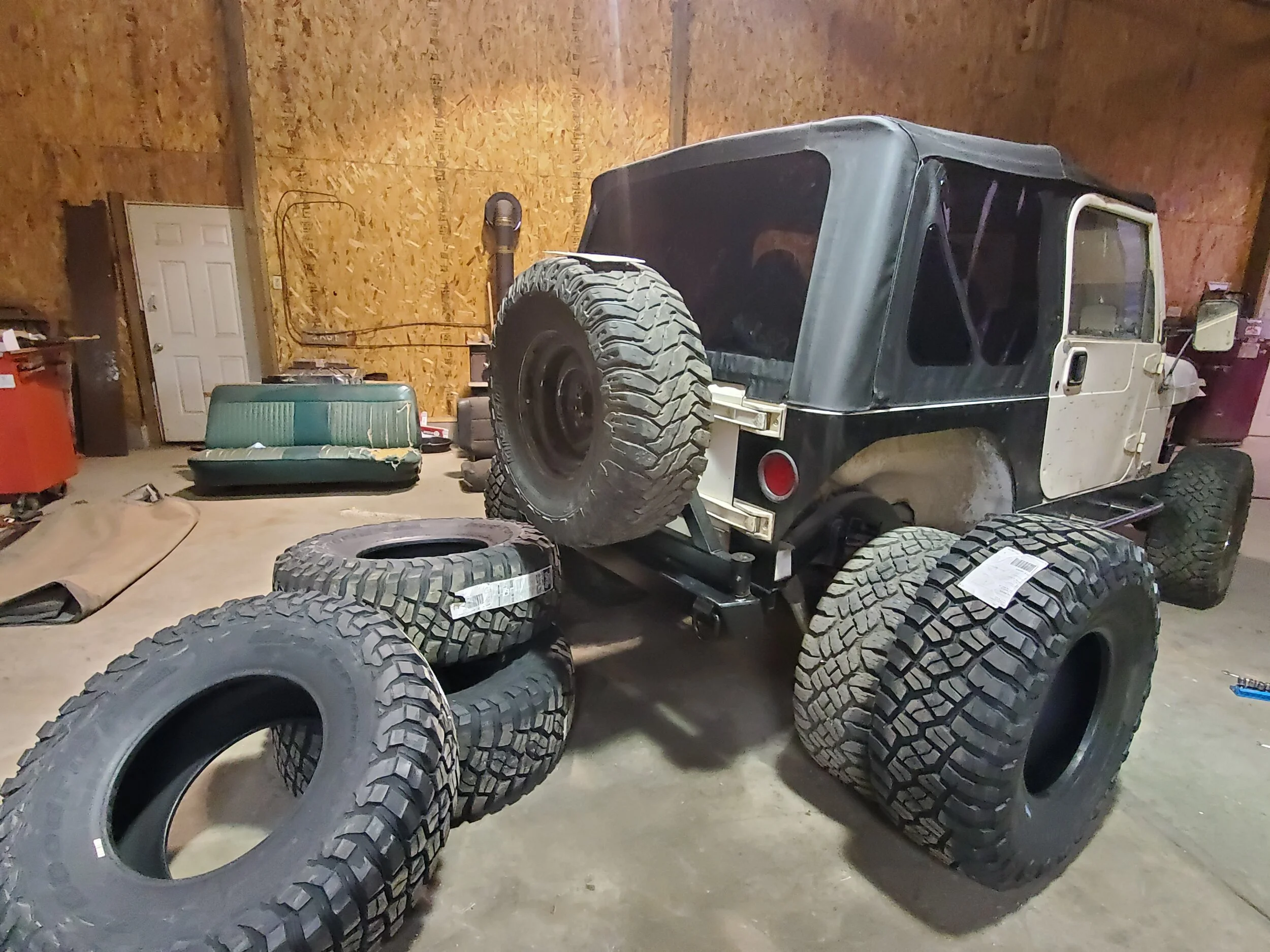

New Rubber. 33s to 37s.

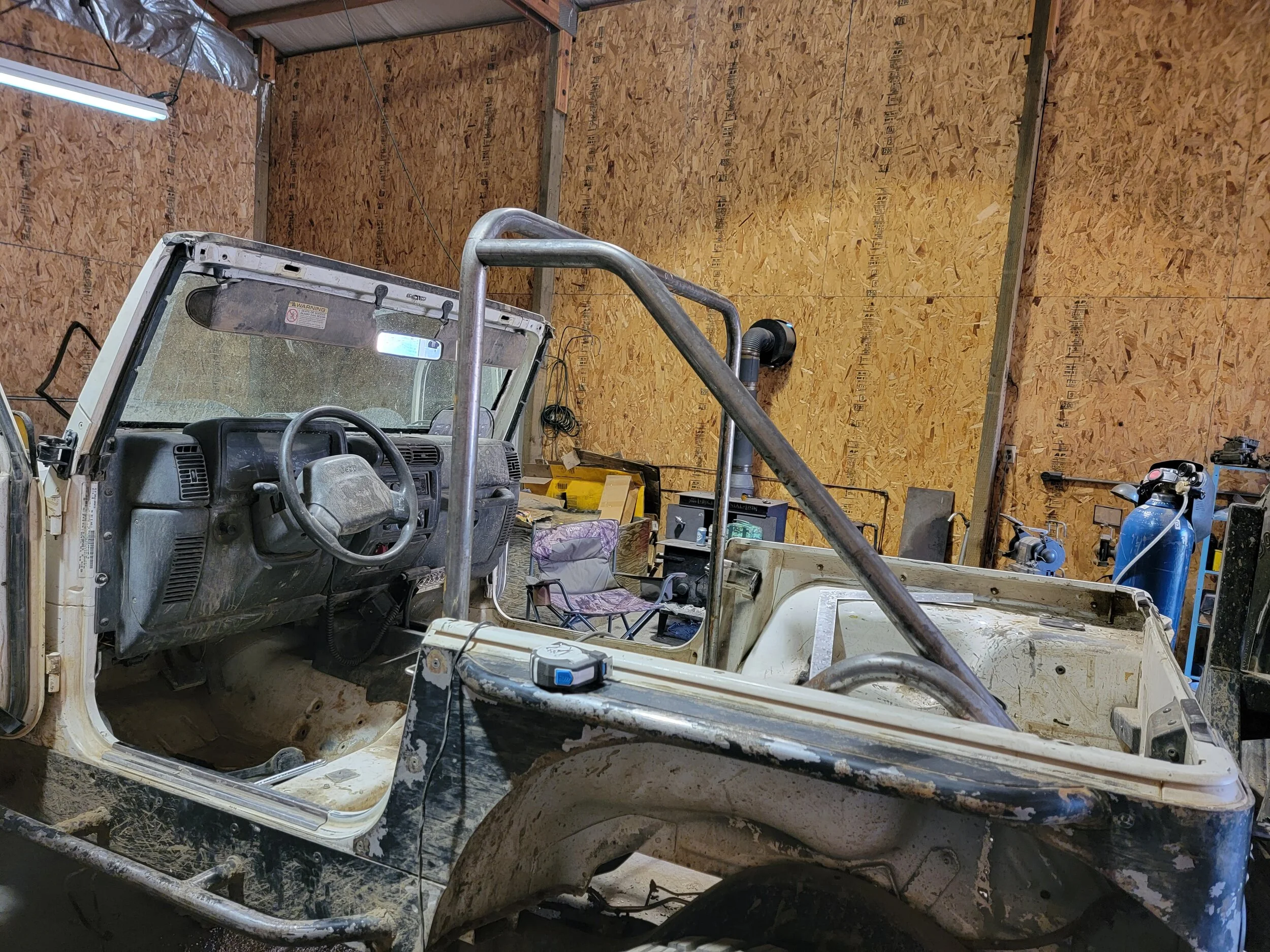

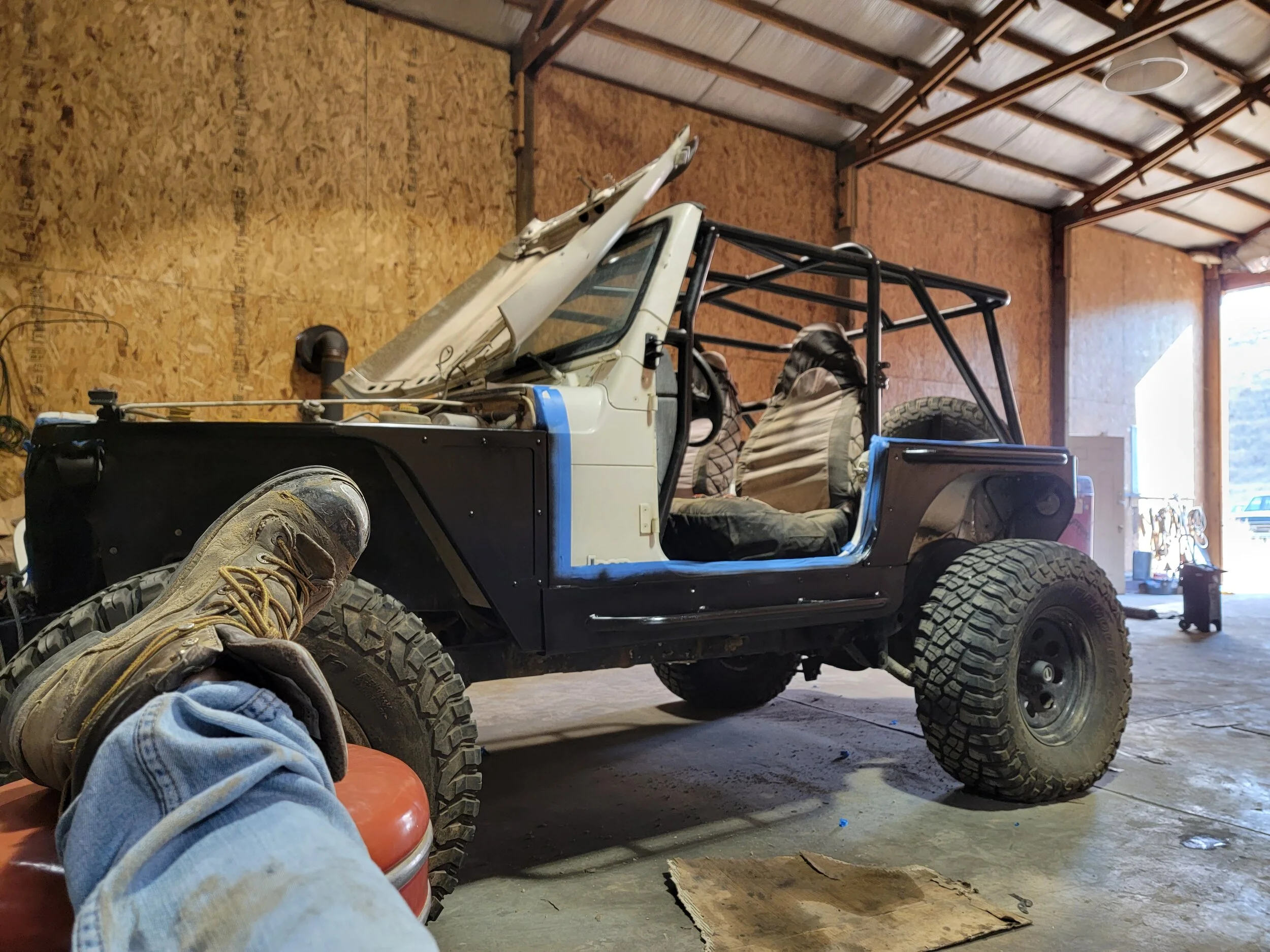

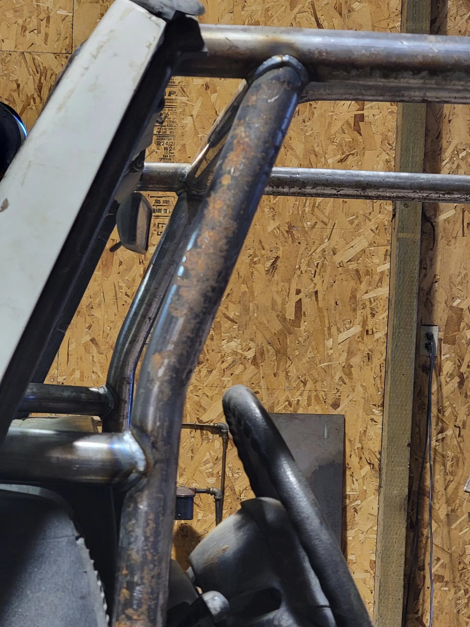

Decided it was time for a cage...This is about 2 years after the stretch, as told by the worn paint...
Watching paint dry! design is bases on Poison Spyder cage, with a few differences.
Atlas 4 Speed 10:1, Tom Woods drive lines, and the start of a skid pan.
