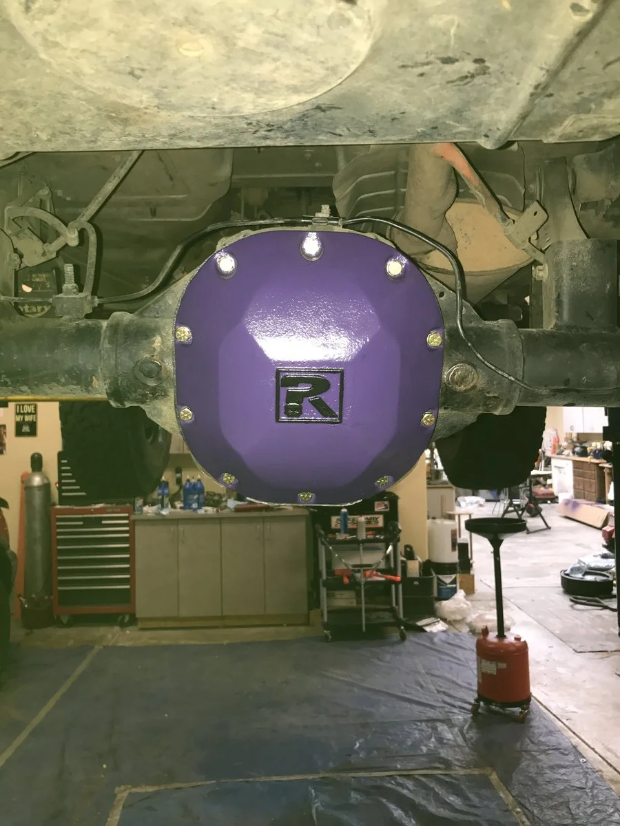

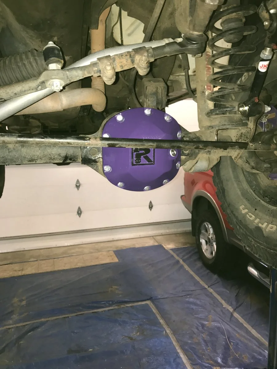

I use the Riddler differential covers. They are local here in Colorado and I got the Dana 30 and 8.8 covers for $50 each. I asked if they had any blemished units. I still can't find the blemish. I like these because they don't have the bulky size of most cast diff covers. These clear my track bar with no problem.
Reactions: matkal
