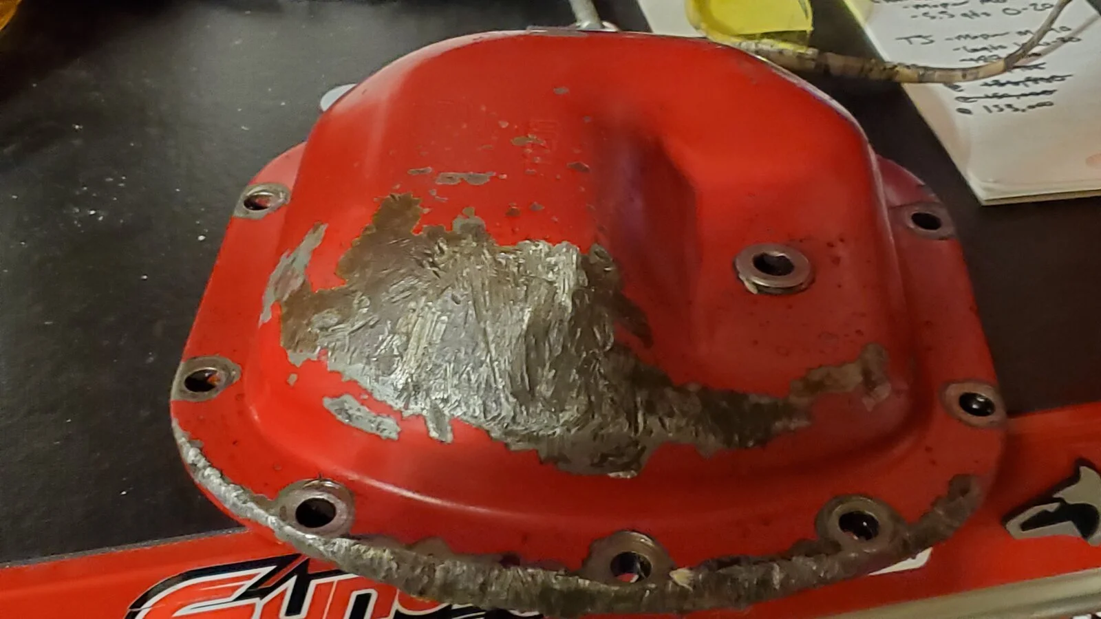

This isn't flashy nor does it have a manufacturer painted on it. It has taken some serious abuse on the rocks I hit

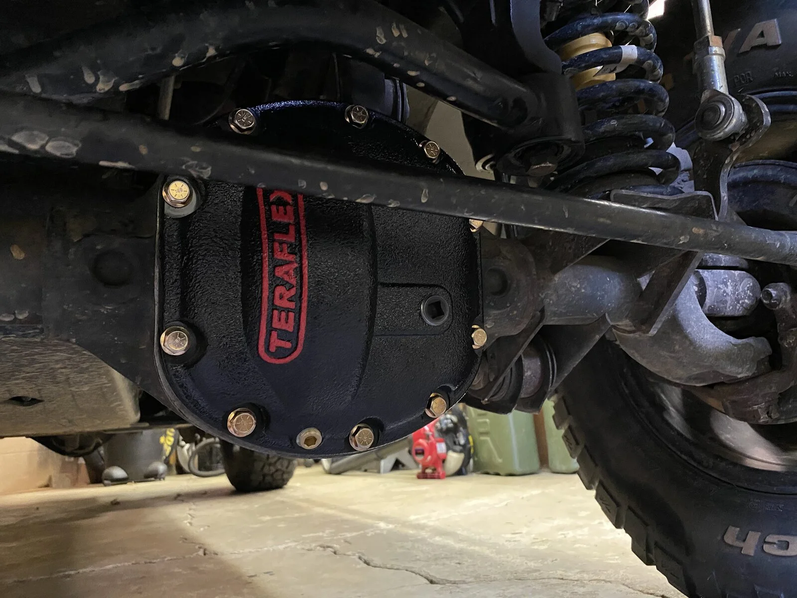

I have a Teraflex Dana 30 cover too: it's beefy. I used some teflon tape on both plugs and used a Lubelocker gasket. Not leaks since I put it on in Nov '22. I'll probably get one for the rear Dana 44 sometime too.

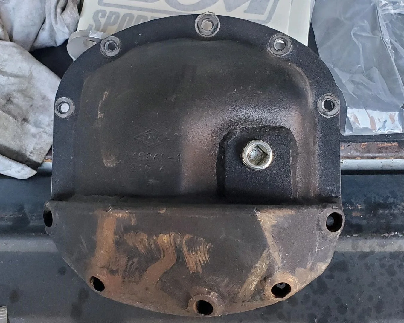

I have a teraflex cover now. It works for but I wanted to remove the branding. The brass drain plug is useless after a few scrapes with some rocks. You can't tell my drain plug even was an Allen plug anymore
