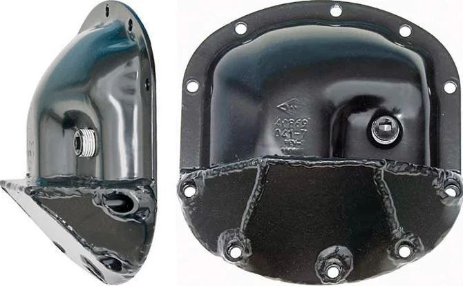

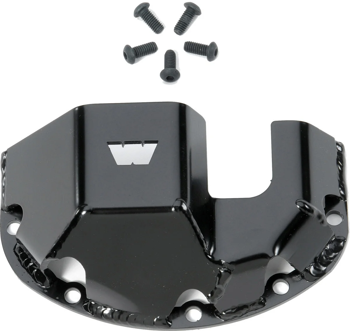

I'd go with a lower-half diff cover from either Warn or Rock Hard that just beefs up the lower part most likely to be run into a rock, or (better) get the diff cover from Barnett or Currie that beefs up the lower half together with a ramp leaving the stock upper diff as the factory designed it.
This is the cover available from Currie and Barnett

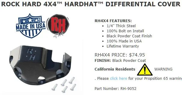

This is the one from Rock Hard but Warn's is similar...

I wouldn't run anything other than Barnett or Currie.

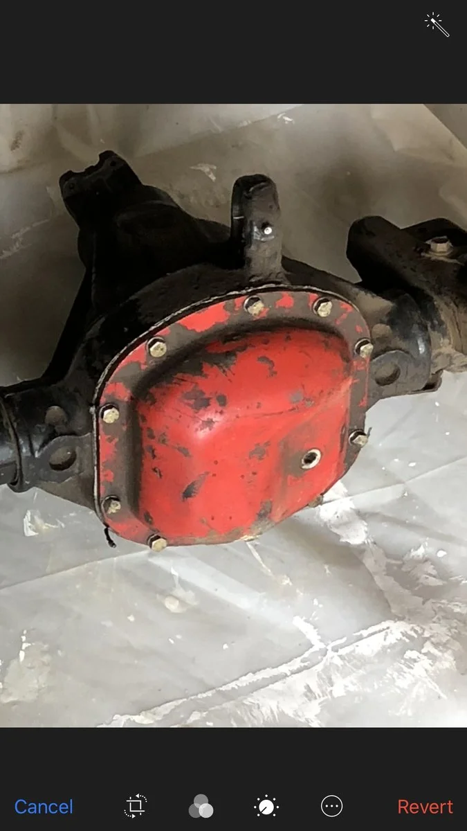

This post made it easy to decide what I need after banging my diff cover in last weekend. I also banged in my rear D44 cover. Does it matter as much what I order for that?
@jjvw has a 90s dodge ram dana44 cover that I believe is thicker than stock plus has a fill hole an inch or so higher
3/16" if I recall. It is definitely thicker than stock Jeep.
Is this something I should / can order online or should I just head to my local junkyard hoping to find a W150? There doesn't seem to be an interference issue in the rear to me (unless maybe the gas tank possibly?) so I was just looking to go as beefy as possible.
I say it's a junkyard part to make sure you get what you want. Mine was $20. I'm pretty sure it was Dodge. But I was walking a lot of rows that day.
