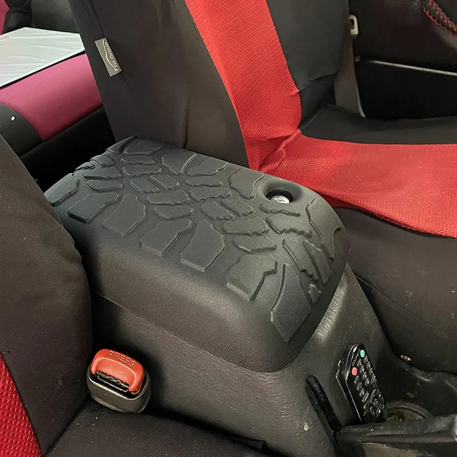

I'm thinking about putting something like this on it, I bet it would help
It probably isn't an issue with the later models since they have a shorter seat base
I put one of those on mine because the lid was cracked when I bought it. It’s ok, but I’ve noticed on long trips, my elbow feels raw and irritated for some reason. Not sure why, it’s relatively soft and smooth-ish, except for the tread design. Iv’e been thinking for a few years of getting one of the leather ones I’ve seen mentioned on this site but just haven’t done it yet.

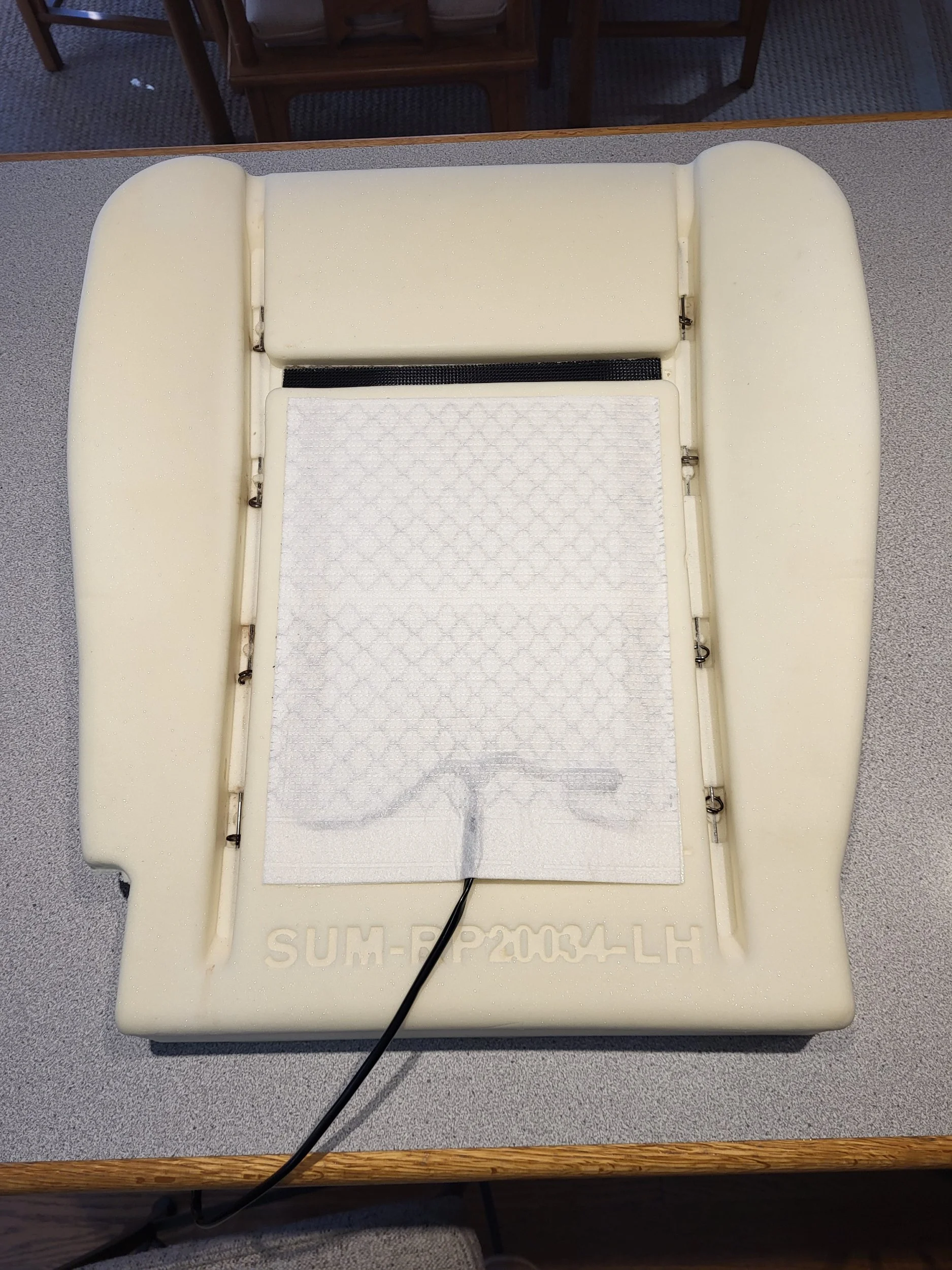

I did mine. No need for hogs rings or pliers. Jeep used split rings. I just pulled the wires out of my upholstery, swapped the rings over to the new foam, and fed the wires through on the new seats.
It's a good time to consider seat heaters. You can install the panels and wire them up later. Metra or Dorman.
