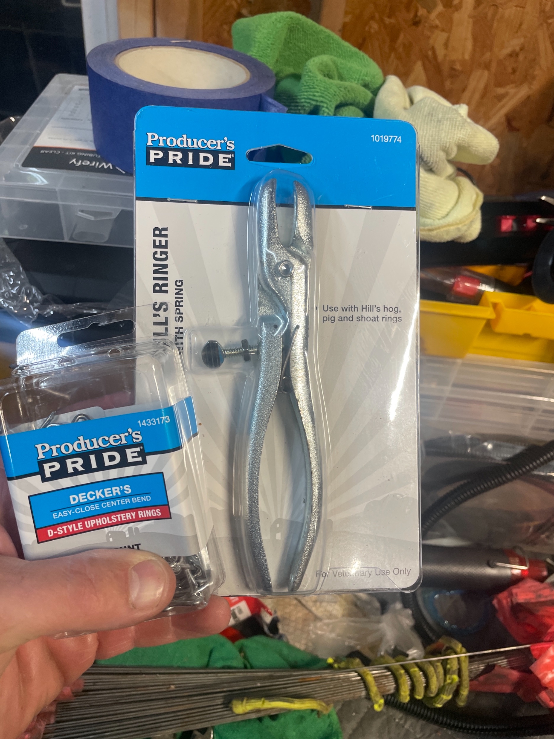

Well I was going to get a Dewalt that I saw at tractor supply because they seem to think things out pretty good...They were sold out and we picked one up and it looked pretty basic and it worked really good- You’re only doing about 8 rings per seat
I think the bend of the ring is key....If I was shopping I will try to get everything from the same manufacture.

In a minute I’ll see if I can add a picture of the set that I got.
I was afraid these weren’t that great but it turned out they were very good- I think it’s important that the ring is designed by the tool manufacture.

You need hog rings and pliers. They do provide rings but the ones we bought seemed to work better.
