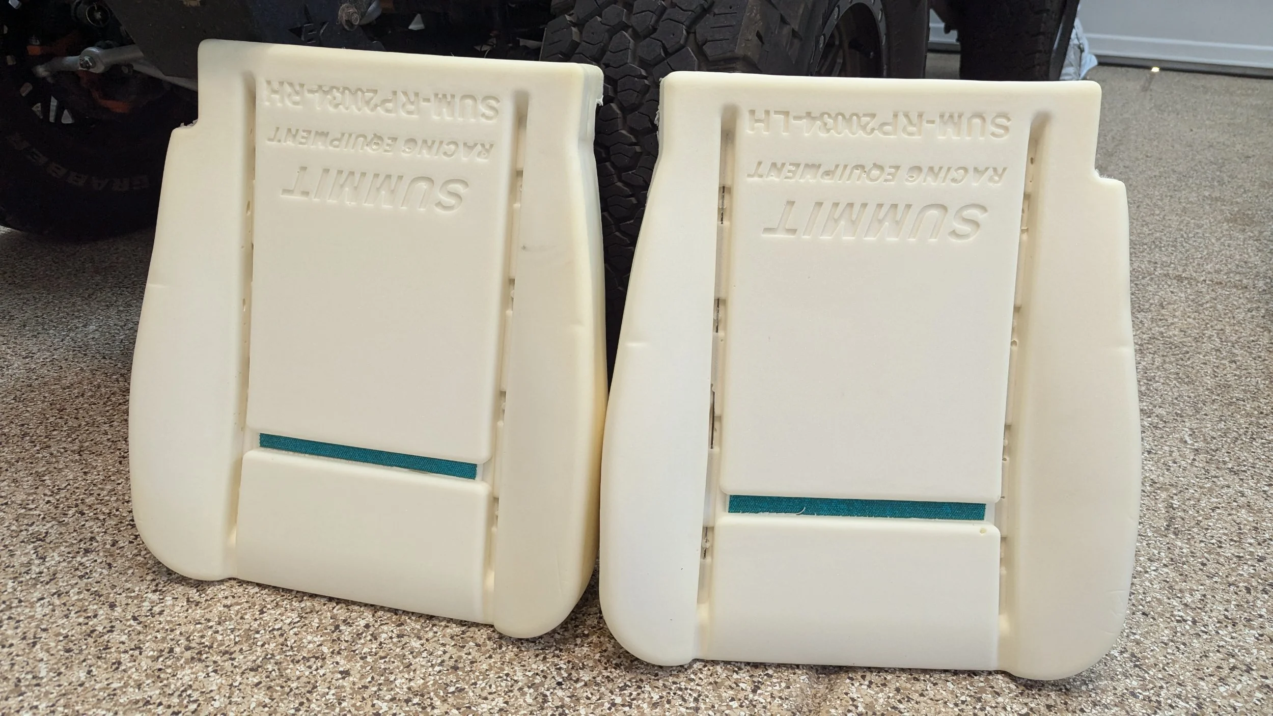

I don't need another project right now but I placed my order with Summit. Since I am at it I ordered the seat heaters. May as well only get in into the fabric one time. 2 birds stoned at once situation. Maybe I'll get around to installing this before 2025

Finally made time to install the cushion I ordered back in May. Seat risers used to be in the top three comfort mods I have done along with B&M short shift and Bartact seat covers & warmers. The new seat foam might have demoted the seat risers, if not relegated them to completely unnecessary. Seat feels amazing. Mirrors, seat position, lumbar pillow and steering wheel tilt all needed to be adjusted. I left the risers in and after a short drive I am feeling a bit of pressure against the back of thighs that might prove annoying so the risers are now on the watch list. Uncovered that the seat warmer was all bunched up under the Bartact cover. Feels like the Bartact lumbar pillow is now too low as well.
As far as the installation.. it wasn’t difficult by any stretch. I’d say one out five banana’s at best. That said it was about as fun to do as stretching a new soft upper onto the window frame. One pinched finger and scraped my thigh on the rock rail. Not bad.

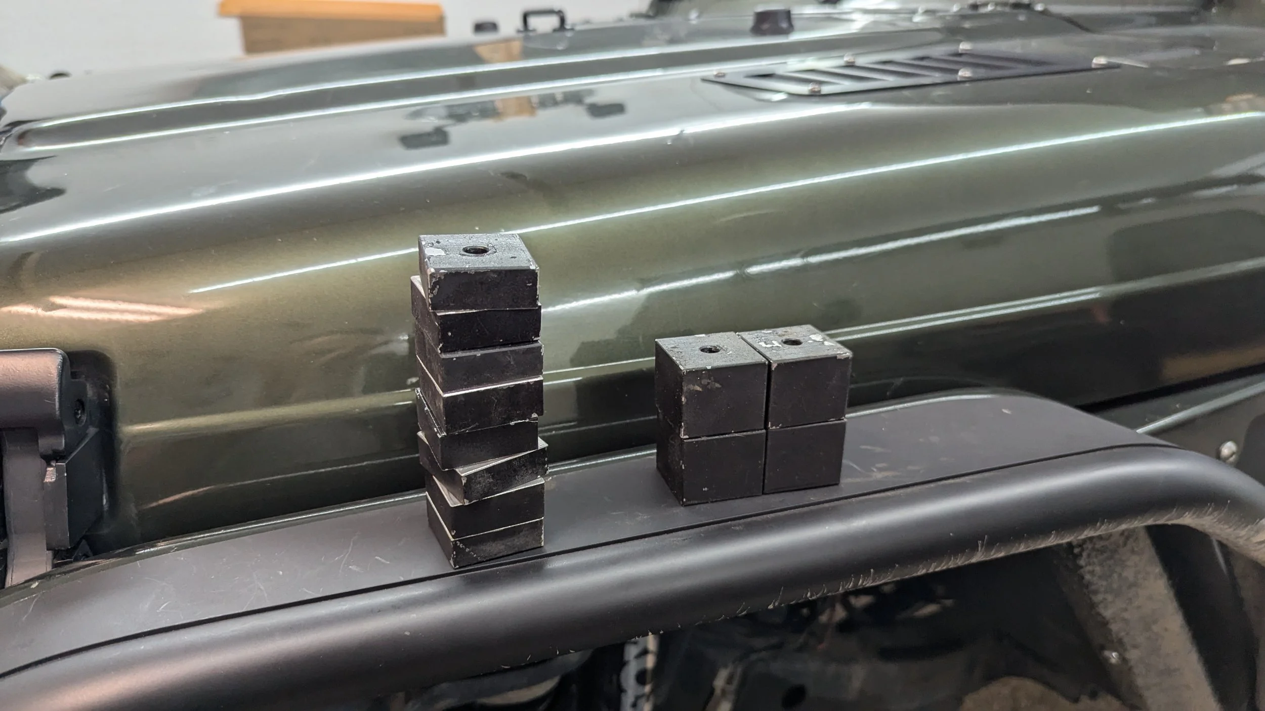

Definitely sitting too high. Feeling pressure on the back of my thighs that I am sure will be really uncomfortable over time. And my right arm can’t rest on the arm rest. I couldn’t find the original seat hardware so grabbed what I needed from the supply house..
  • One 7/16-20 x 1-1/4in bolt
  • Three M8 x 1.25 x 30 bolts
Without the risers the pressure on the back of my legs is very much relieved. Might choose to cut the risers in half and try 3/4” of lift.

Man I love this foam.
Ordered Friday, delivered Saturday. The hog ring pliers won't be here until Monday. Looking forward to this.

I now sit about 2” taller than I did the day before the change. I had previously installed 3/4” risers, and I took them out.

I am undecided on whether to keep the seat risers. Mine are 1.25". Prior to the foam I sat perfect. With the foam I am too high. Took them out and I feel like I am sitting on the floor. Plan is to cut them in half and try again or find a set of 3/4" risers. Can't imagine the foam added more than 1" of height.

Chopped down a few extra seat risers I had to bring them down before installation of the seat foam. Finger crossed it's all the hype. I'm sure it will be, mine is broken down at 210K.

In that vehicle I have 1/2” seat risers on the drivers side and none on the passenger side
I’m convinced that you’re really not gonna want to use seat risers with this product in most circumstances.

I am still feeling my way through the risers dilemma. Been driving the past few days with the new foam, which feels great, and the risers installed. I noticed my left shin hit the knee bar under the dash a few times while depressing the clutch so that pretty much seals the deal for shortening the risers.
When I had the drivers side installed with no risers, with the risers still installed under the passenger side, the difference in height of the headrest was immediately disturbing. I am too anal retentive with the height difference and would be bothered every time I looked at the Jeep. If I do half the size of the drivers side risers, I'll have to do the same on the passenger side.
