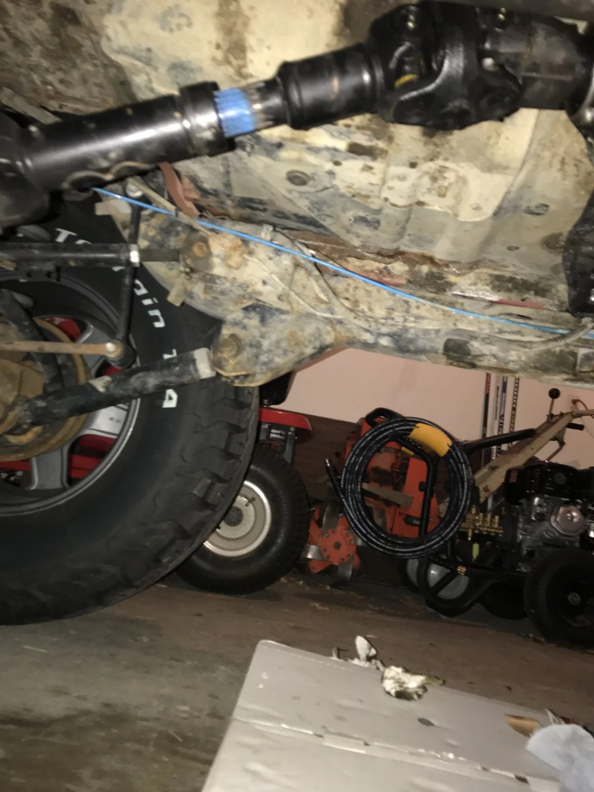

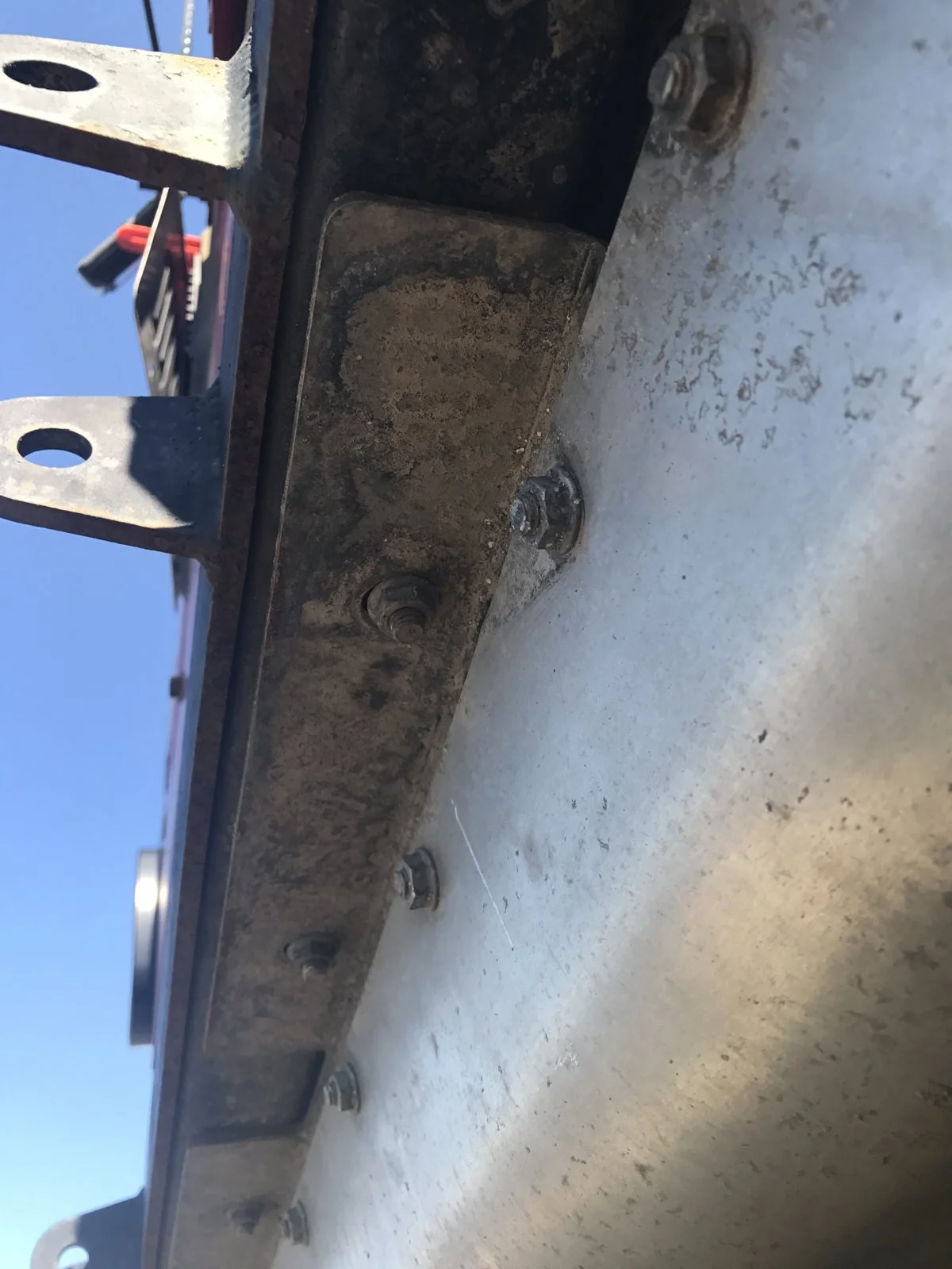

I think the only option I have left to get rid of driveline vibration is a SS SYE. With a 4" lift and the Savvy under armor tummy tuck I am out of room for adjustments. I was looking at the JB, anyone had luck, no luck, etc. ?

I do have a Tom Woods DS. But between the Savvy under armor and gas tank skid plate my DS angle is still too much. I talked to the guys at Tom Woods and my trans guy and they both agree on way too much angle for my set up. Every thinks I'm crazy because it's a 4" lift and am still having vibration issues with all the right parts but I do.
At this point my options are get rid of the Savvy UA, get rid of the gas tank skid, get a shorter lift, or explore other components such as the super short SYE to give me more room for adjustments.

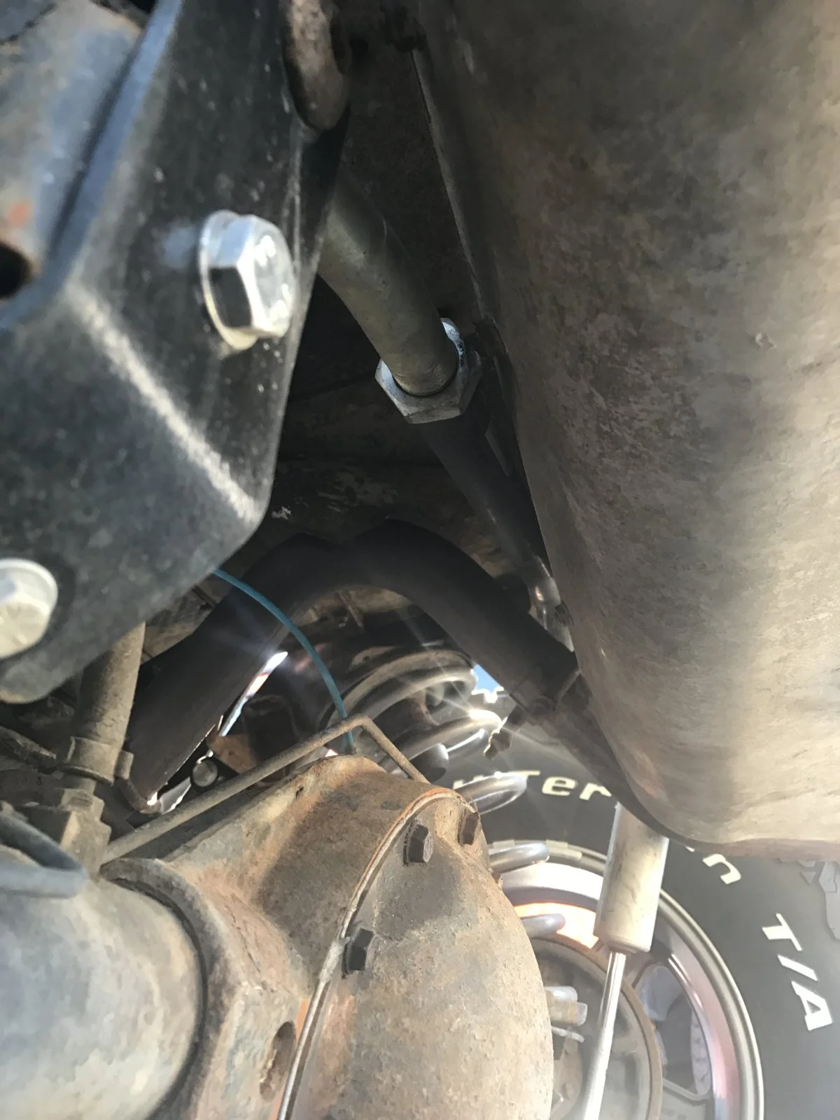

With all that I'd go for a SSSYE and replace your existing straight trackbar relocation bracket with an angled track bar relocation bracket. Look at the minimal clearance you have between the gas tank and track bar bracket, replacing it with an angled bracket will increase its clearance.
It's a JKS adjustable track bar and does have the bend in it. The guys at Savvy did recommend the angled track bar mount and the SSSYE. I was going to see if I could also get different mounting brackets for the gas tank so I could push it back a little further.

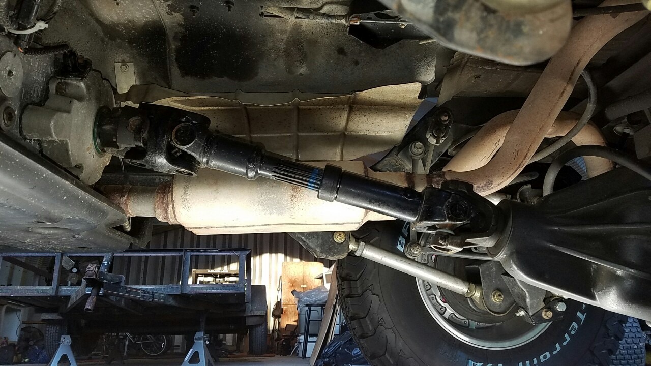

Yes a very good sye. The speedometer isn't an issue either. JB sssye uses a speed sensor that plugs into your existing wiring and a tone ring behind the yoke. It is only off 2 MPH with 33s. I researched a lot before buying this one but after looking at all it offers I thought it was a good fit. I have a 4 inch suspension lift btw. Smoooth.

Most of my vibrations were tire related. When I bought my Jeep it had a transfer case drop with stock driveline. I thought why not get the shortest sye to have as long as driveshaft as possible. Now my skid is where it belongs. so far so good with ride quality. I do have the JKS rear adjustable trackbar and angled bracket. If you get your parts and gas tank situated you should be good.
I don't believe the 4" lift number is accurate. Could be, but I doubt it.
Get me a dimension from the bottom of the front spring on the driver's side front to the bottom of the isolator. 4" of lift puts that number right at 16".

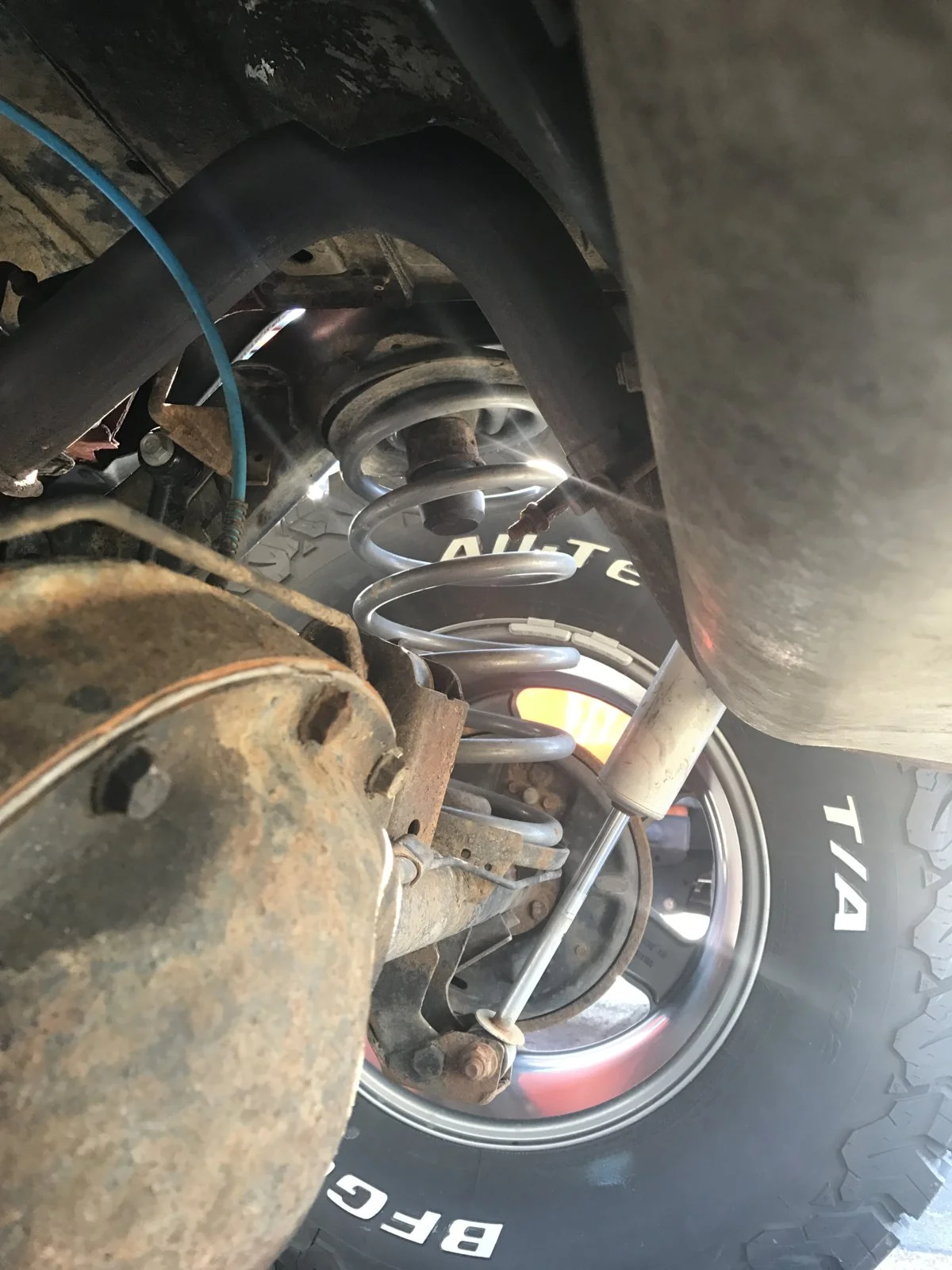

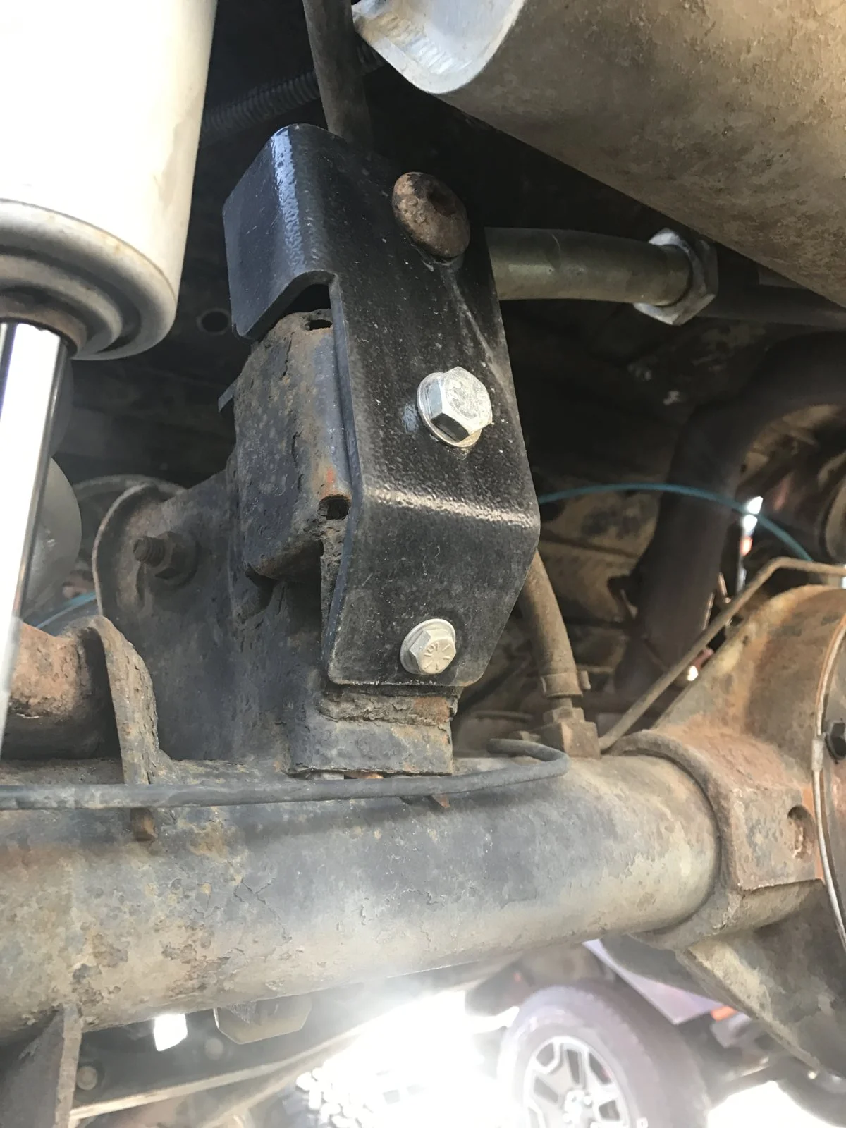

Get the angled trackbar mount before you move anything. It makes a big difference. No need to move the tank at all. Simply drop the trackbar and add some forward bend to it where it rubs. I just did a JKS bar a couple of days ago that was set up the same way as yours. The bend over the exhaust was hitting on full stuff, we added some bend past it so when the axle was all the way up, the bend over the exhaust didn't go up as high. It was hitting on the crossmember where the bolts are for the gas tank skid. We added some bend and moved that section of the bar forward and then bent it back closer to the mount. The main reason the Currie bar clears as well as it does is I bent one up and sent it over to them to help with the design.

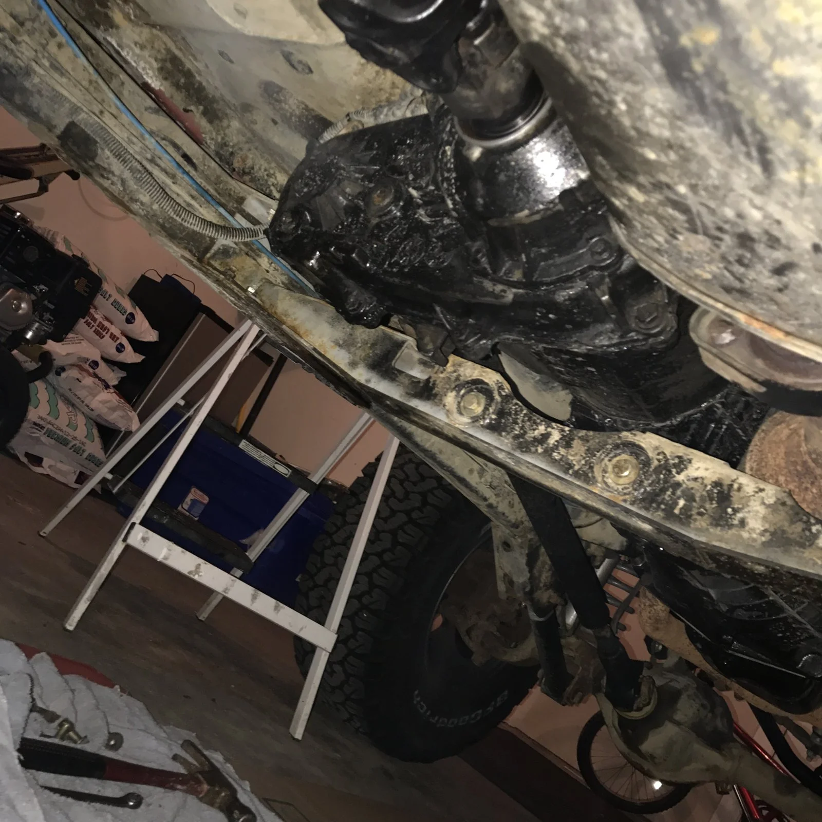

No, your issues are from combining a lot of things and not making sure ahead of time that they all work together. I designed the Under Armor around the Currie Trackbar, angled mount and the GST is the same. That and there is always a limitation on lift height when it comes to drive shaft angle.

How did you bend it? And yes I am absolutely going to try just the track bar mount before moving into any other options. Mostly the problem is I bought this jeep with everything that's currently on it, therefore I am the new engineer to someone else's re-engineered cluster F lol.
In all honesty I have no problems wrenching and can pretty much figure out most things, but brand-new to the jeep world, driveline angles, skid plates, track bars, etc.
I ordered the JKS angle track bar mount and it should be in this week. Do you mind if I reference you for what I got going on?
