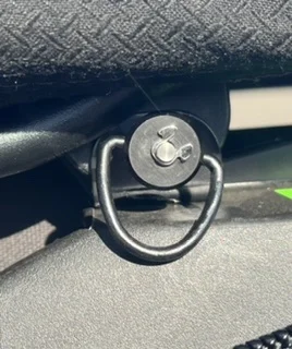

Annoyingly yesterday when I went to put my top back on (weather in the UK having started to get chilly, and I had a 75 mile drive to do on a 50 degree morning) I found I was missing the pin at the corner of the door surround which should clip the frame to the door surround for the sunrider feature.
I've emailed Bestop about getting a replacement. No doubt shipping to the UK will cost more than the part. I am guessing the circlip came off. Is this a common failure? It's annoying…
If they won’t ship to UK I’ll have to ask a friend in the US to take delivery then re ship, I guess.
This one (this is the one I still have!)

I have lost one also, and the other side almost worked itself loose and fell off but I caught it just in time. I wonder if they had a run of defective ones or something. They did send me a replacement free of charge and I glued the other one in place.
Post a pic of the entire pinl. Maybe we can make a suggestion for an alternative.
Checked my TrekTop NX and the pin looks different…
