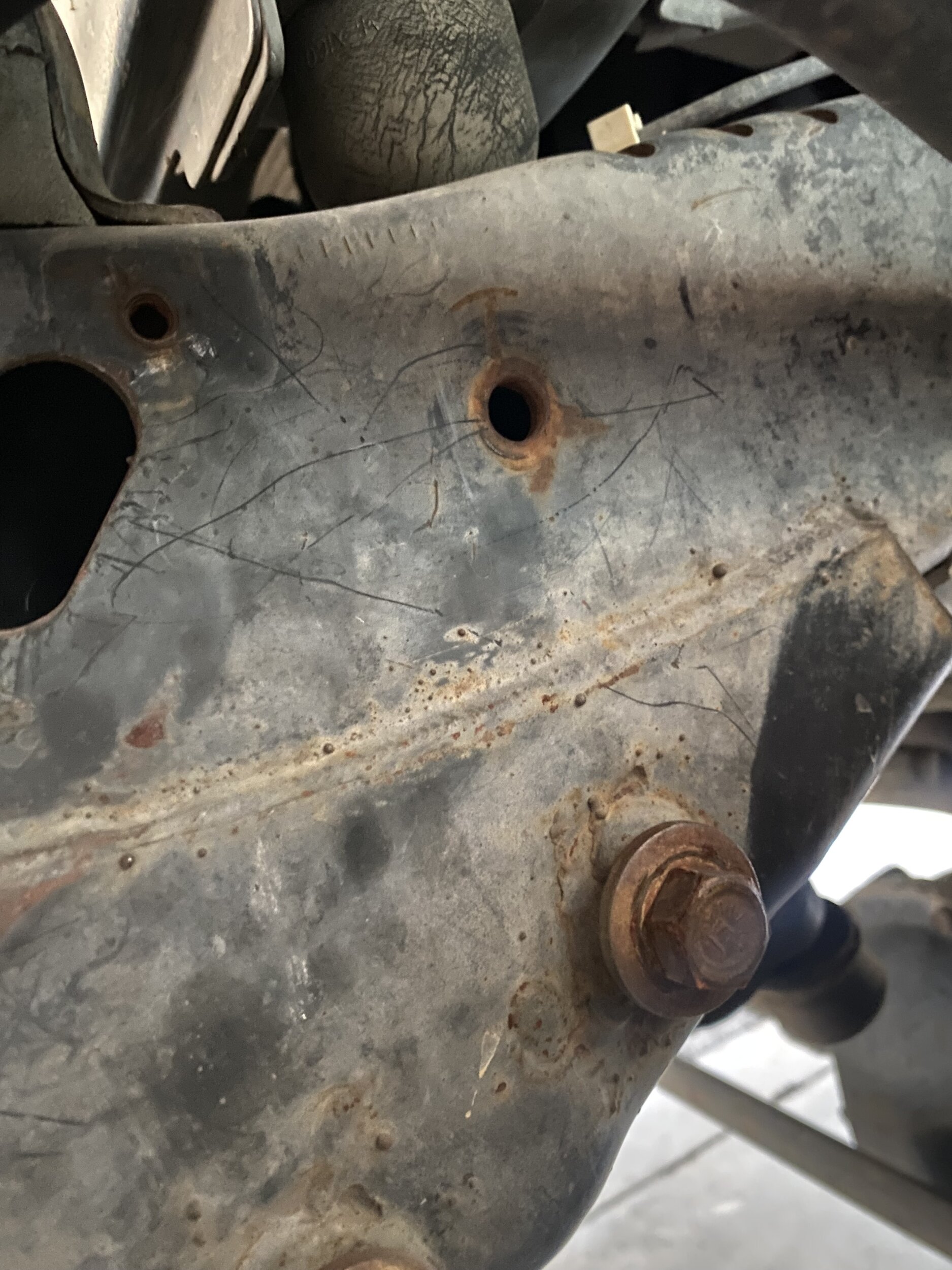

Sway bar disconnect pin is missing

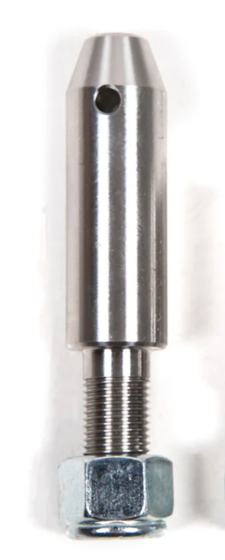

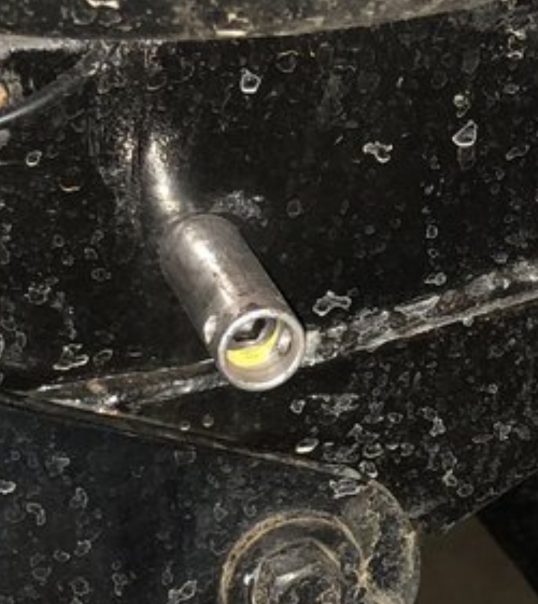

anyone have suggestion for how to affix a new bolt when the hole from the old bolt is warped and stretched out? maybe with Loc Tite tape or something? Or I guess I could weld in a new pin

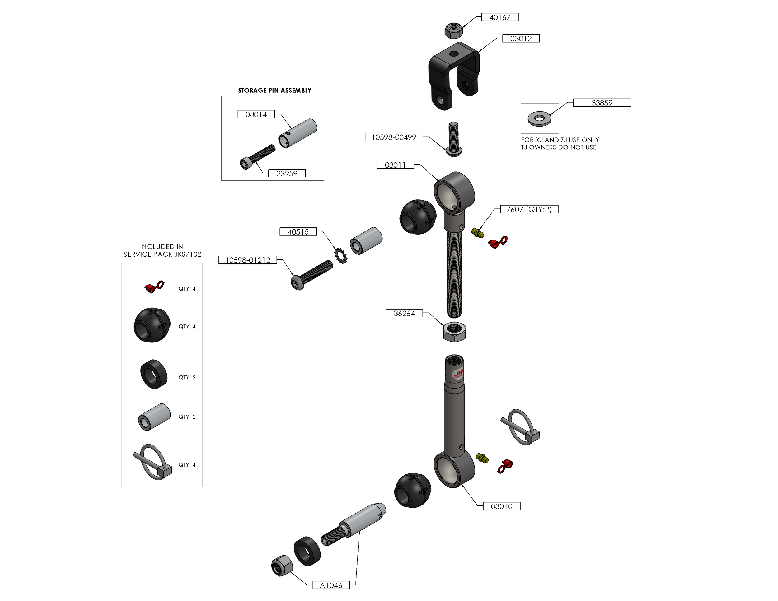

There is a service kit for the links and that part isn't in it. You could call them. You might not be able to get just those, but they might sell you the hardware bag they are in.
On the parts list its called a storage post. On that drawing they call it a pin.
And @L J was correct. The kit comes with a self tapping bolt. And I was wrong on the size. The hole is drilled 17/64" or F and tap it 5/16". And the bolt is a 5/16"x 1.5".

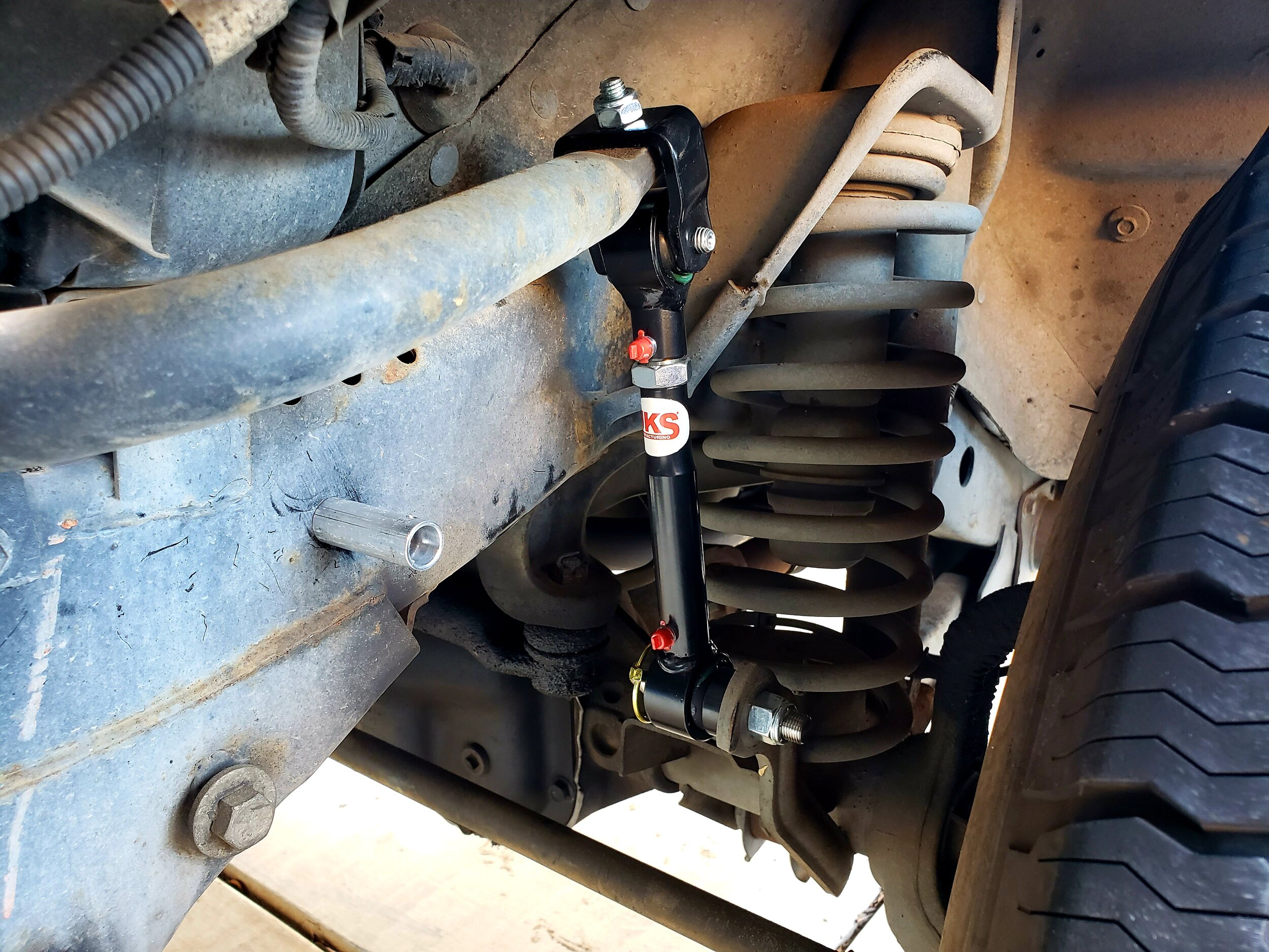

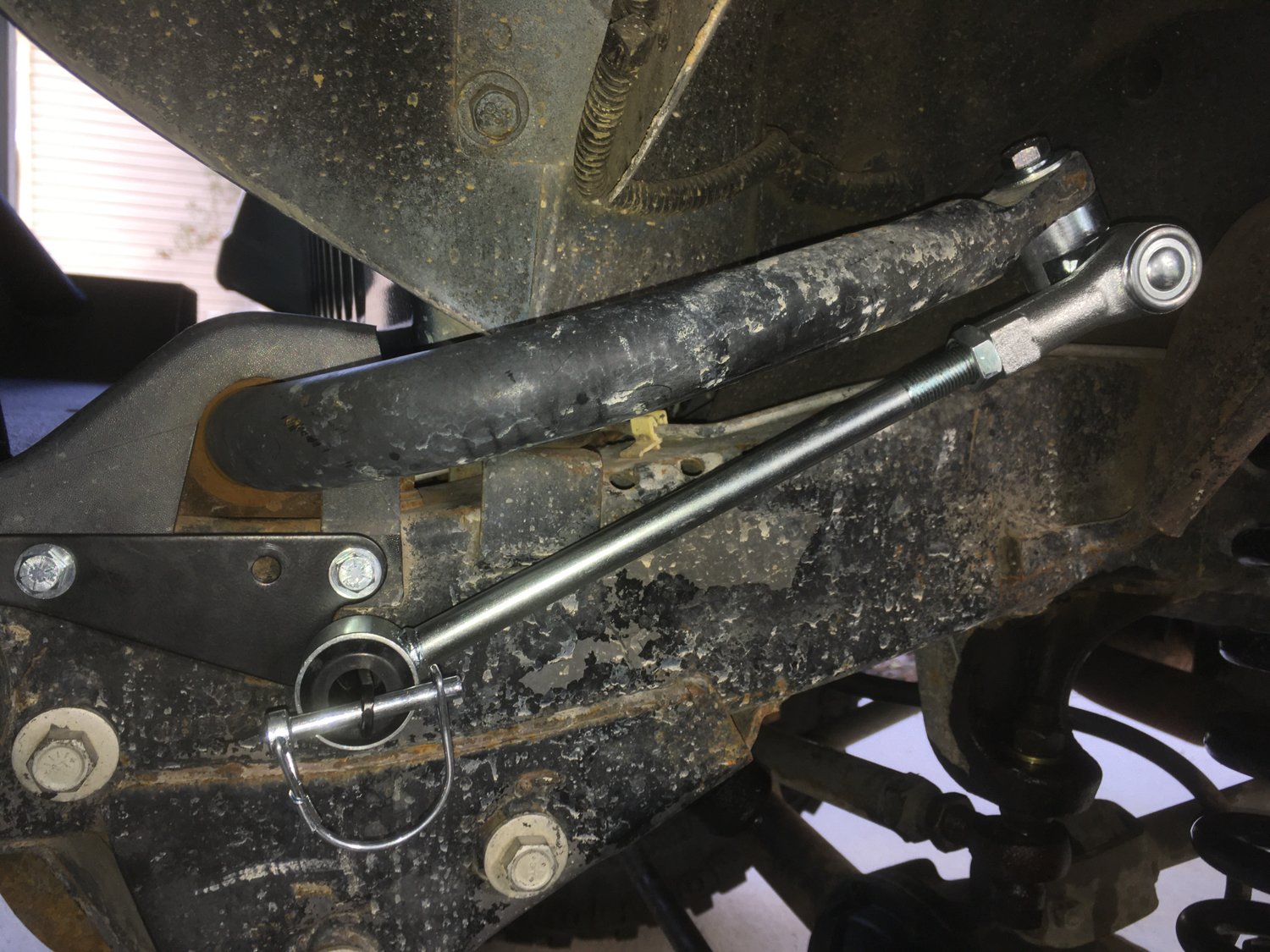

This IMO is an overengineered, expensive, and inferior design. You have to fiddle fart around to get the holes to line up for the lockpin if the either the holder or the coupler pin gets rotated from vibration.
👇 This kit has the lockpin fastened to the axle and does not move. The swaybar link is disconnected and through the large opening gets pinned to a post. Quick and no adjusting necessary.
good info! what is the name or link to the second kit that you liked better?
All the JKS stuff gets tightened. Nothing rattles around or moves.
The other one you are describing is exactly how the JKS kit works.

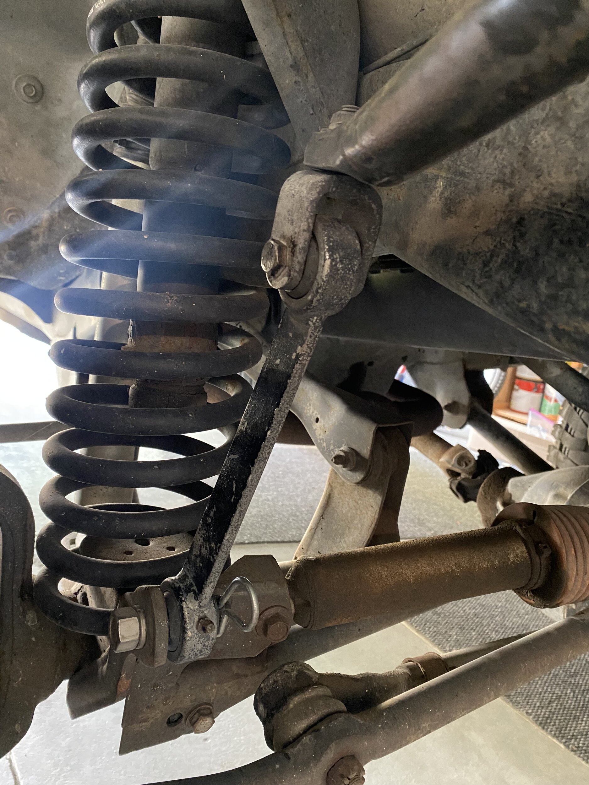

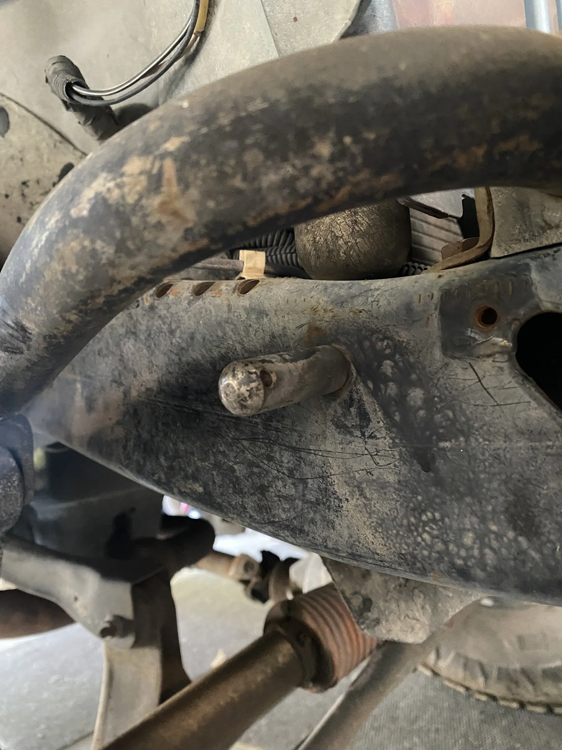

Post a pic of the pin you still have on the frame and the links. Was guessing it was JKS.
This is JKS.
That pin looks nothing like the JKS one so don't expect one to fit. The hole's threads look eroded from rust, but the hole does not look stretched out. If you're dead set on repairing this you're going to need a tap. You can get cheap tap and die sets from Harbor Fright and they will be extremely useful in the future. I personally wouldn't buy a pin. I would make one from a partially threaded bolt by cutting the head off and drilling the cotter pin hole. Of course you need to rethread the hole to match the bolt's thread. If you don't want to mess with this repair, you can do what other's have said and keep the QD link secured with a small bungee.

If you still want to fix it (like before), you should be able to fish a nut & washer inside the frame through the larger hole.
Another option would be a nutsert.
