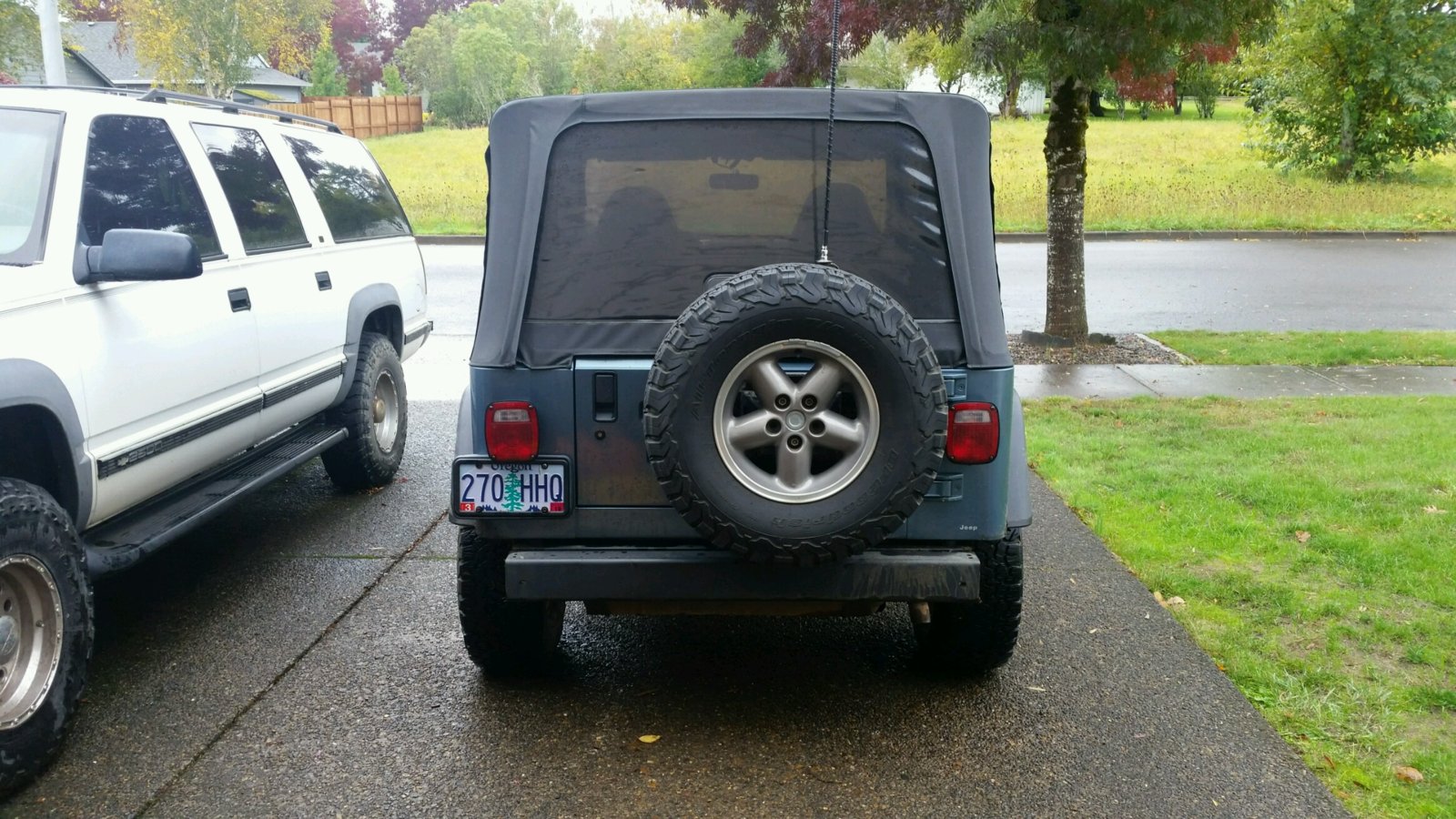

Redoing the back end of the body / tailgate and would like some input.
I'm moving the spare tire mount to the right 4-1/2" (towards the hinges), out away from the tailgate 1" and adding a NATO gas can mount to the rear bumper on the left. (oh, and the body up 1") I need some input on a couple of parts.
1) Taillights - I'd like to go with a flatter taillight that doesn't stick out as far from the body. Something without the flanges turned out would be nice. What would you all recommend? Square, round, pretty flower shaped...whatever. As always performance over price, but my money tree is a little wilted. I do kind of like the square one's a little better.

Here the rear end shot after the move:
I can get another 3/4" to the right, give or take (more if I cheat a little), but I will have to fabricate new hinges that incorporate the mounting holes for the spare tire carrier. I will also need to go with low profile tail lights. I need to do that anyway, and it was in the plan. This iteration moved the tire to the right 4", which is the center to center distance between the mounting holes on the upper part of the spare tire bracket. The NATO gas can lacks 1-3/4" from clearing the left tail light completely. Nothing was irretrievably modified. It's a prototype, and I'm still fiddling with it. This is solid as all get out, but there are no tire bumpers on it yet. Going out this weekend for a little Elk scouting, so we'll see how it does in the real world. So far, qualified success. Next up, custom machined hinges and tailgate support bars, low profile tail lights, license plate move.

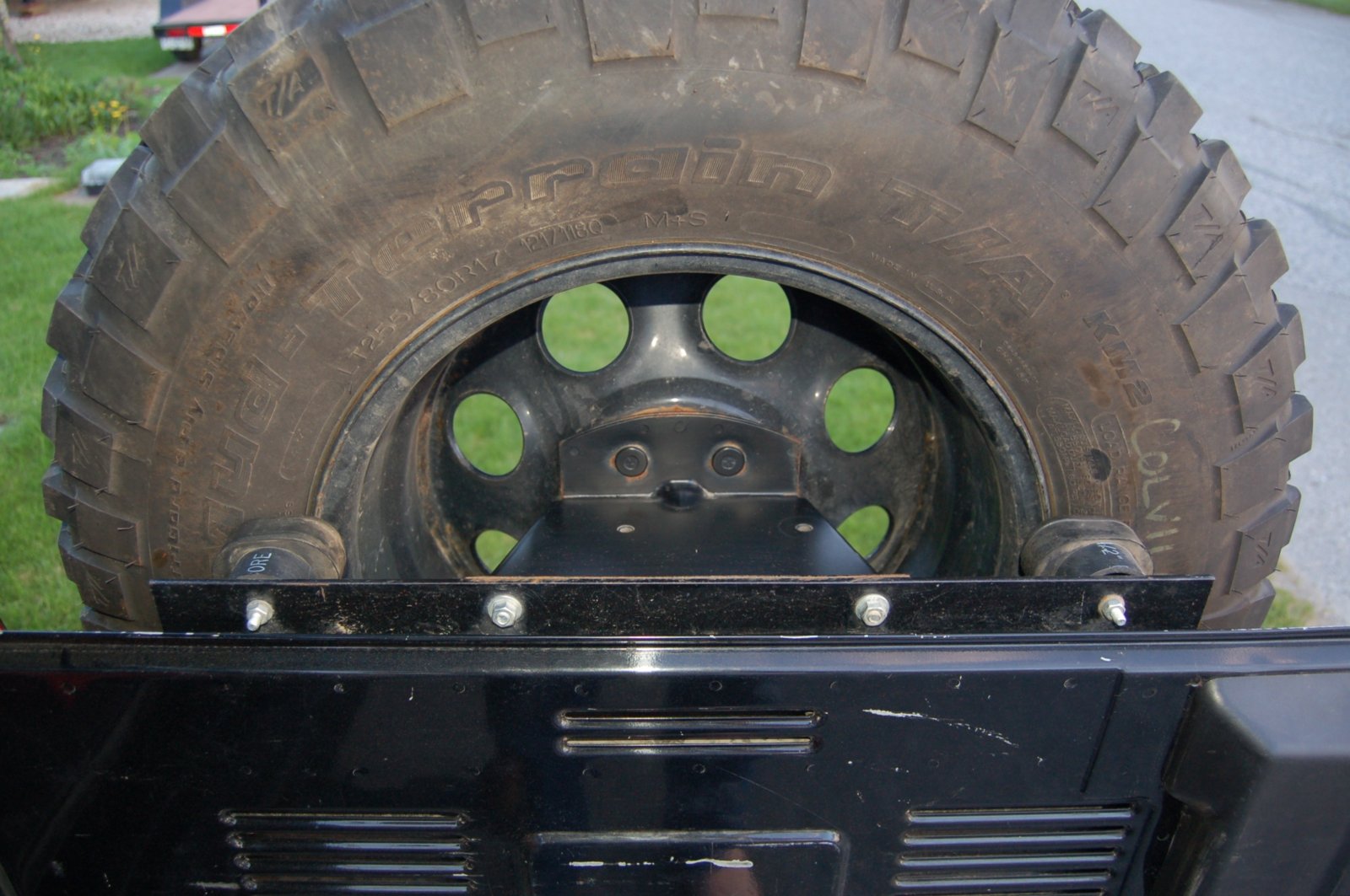

I wanted to center my spare.... an anal thing... and raise it so the 33s clear the hitch. I added a tab to the bottom and bolted a plate on the top...
Nice thing is how the 33 now hits the body before crushing the taillight.
