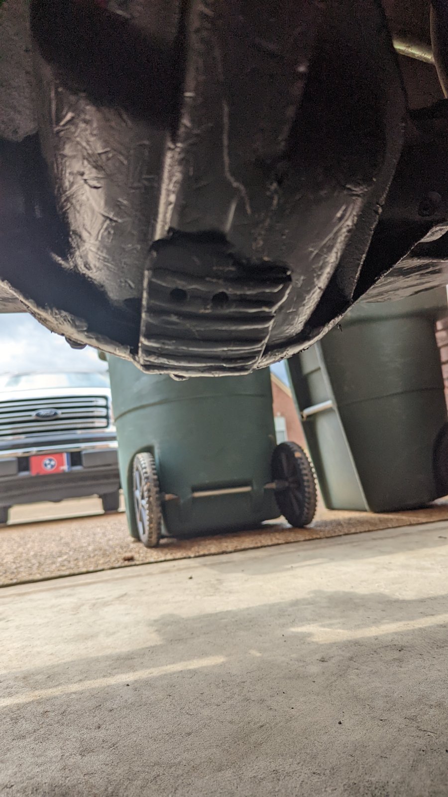

-Welded 1/4" plate to bottom of rear diff housing and then ran a few hardface beads across the plate. Eager to see how that holds up.
I am not much of a picture taker, but I got a few.

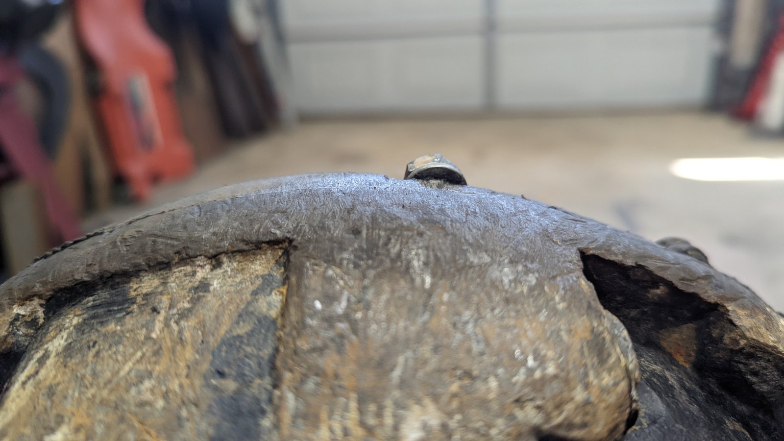

Here is how much it was wore down:
And here is the plate installed:
The horizontal beads is the hardface.
I used my press to bend the plate, it had to be bent in two directions so it took some tweaking to get it right. The two holes in the plate were already in the plate from another project, they weren't added or needed for this.
Not sure if this is the correct way, but I will find out!
I need to address the bottom of my rear axle. What did you use on the hardface beads? Stick welder and special rods?
Yes. They were from Blue Demon, I think BD-7000. I have a whole box of them, if i lived closer I would give you a handful.
I did rip the 1/4" plate off, bad welds, I think oil contaminated the welds. So the second plate I welded on I cleaned it up real good with brake cleaner and then I took a torch to it (trying to burn off any residual diff fluid in the metal). Second plate welds held up much better and the plate and hard face was still intact when I removed the axle.

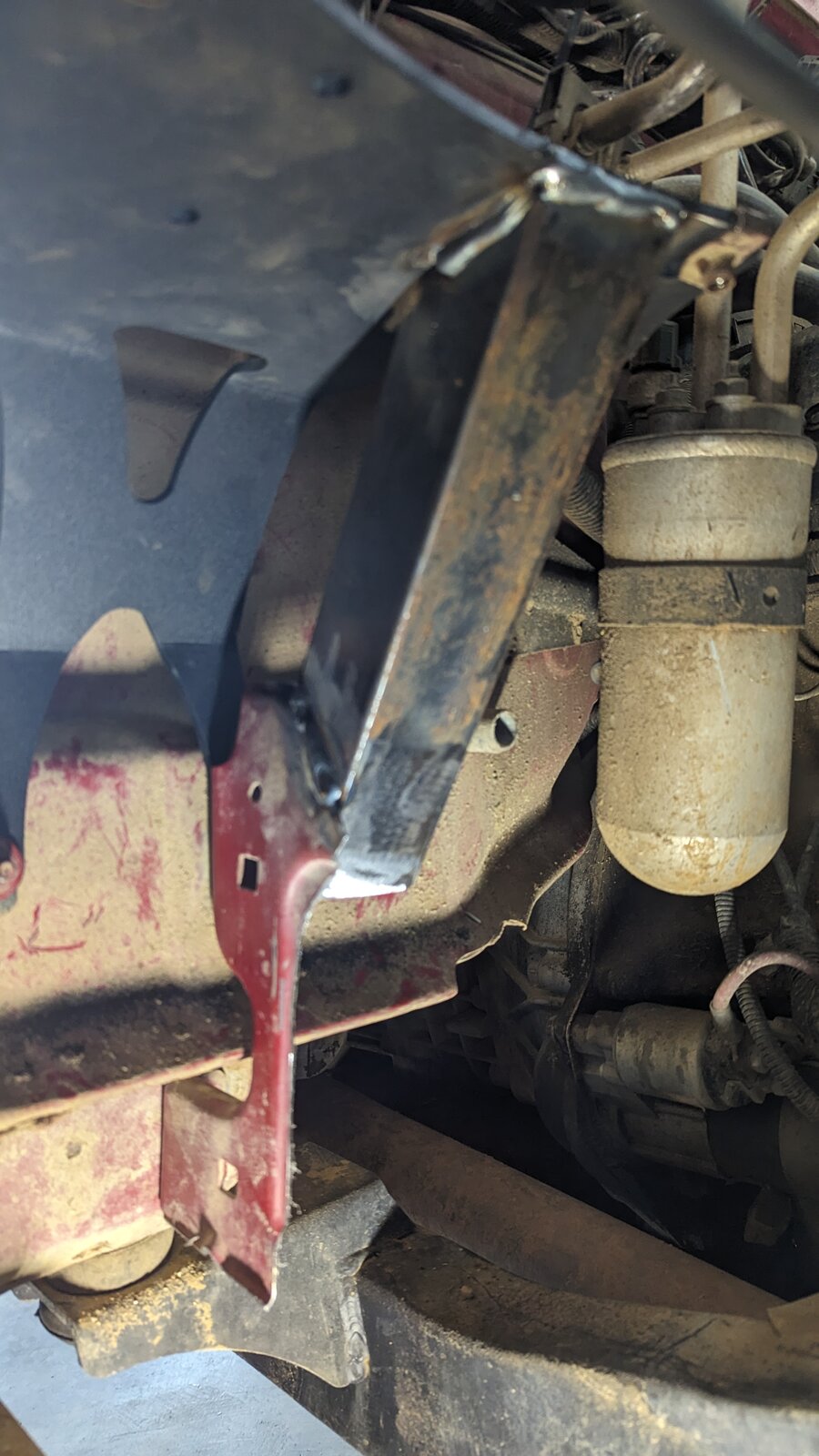

The battery mount that they provide only has a front support on the outboard side and with no support on the inner front side it has some bounce to it. So I added a support to that inner front side. I cut up the factory bracket and used the inbd side to pick up two holes on the firewall, then I welded a tube between the modded factory bracket and the crawltek bracket. I had a piece of square tubing laying around from another job so I just used it for the support which is way overkill and kind of ugly, but it didn't cost me anything. Once the mount was installed, I installed the factory battery tray but I moved it forward and outbd slightly in order to get me clearance for battery and for the hold down. Just a matter of drilling a few holes for the tray attach and also for the battery temp sensor.
Here is the added support, ugly as can be, but no one will ever see it. Also, my photo skills suck :) I didn't take a picture of the tray installed.

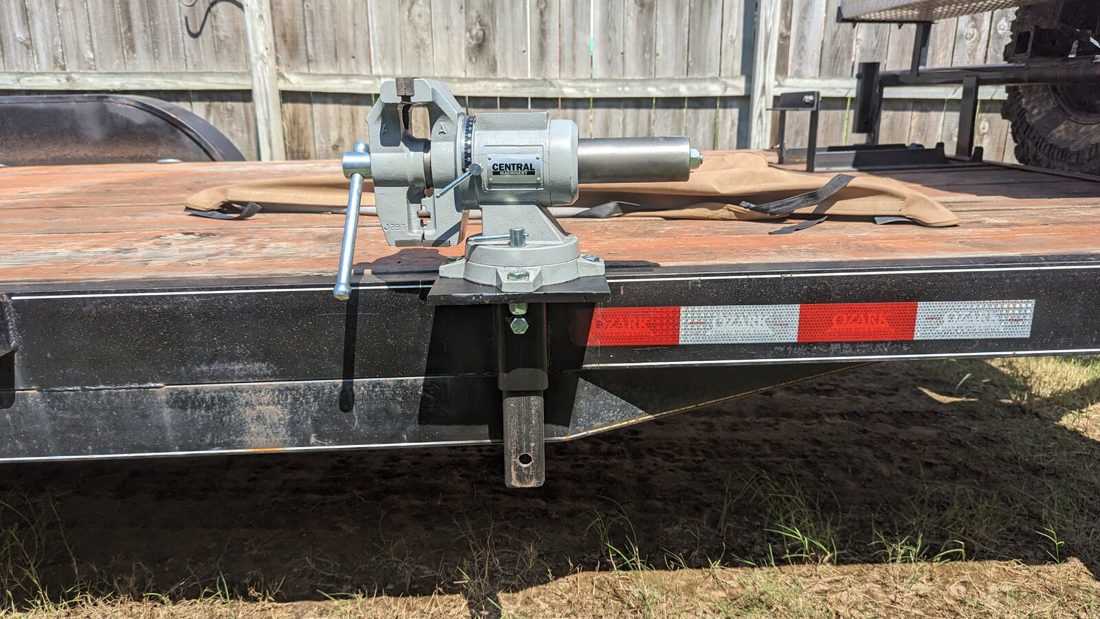

Last few wheeling trips we had some work to do on rigs in the evenings and a vice would have come in handy. Harbor Freight sent me a coupon for a cheap vice so that kicked off the next project.
Mounted vice to 1/2" plate and welded on 2" square tube. Then I welded a 2" ID square tube to the trailer in two places. 1 on the LH side on the front side which is where the vice will stay during transport and is also at a good height to work. To keep it somewhat secure I put a lockable hitch pin through and also added a clamp bolt to keep it from vibrating around while in transport (and to hold it tight when working on it).
Transport mode:

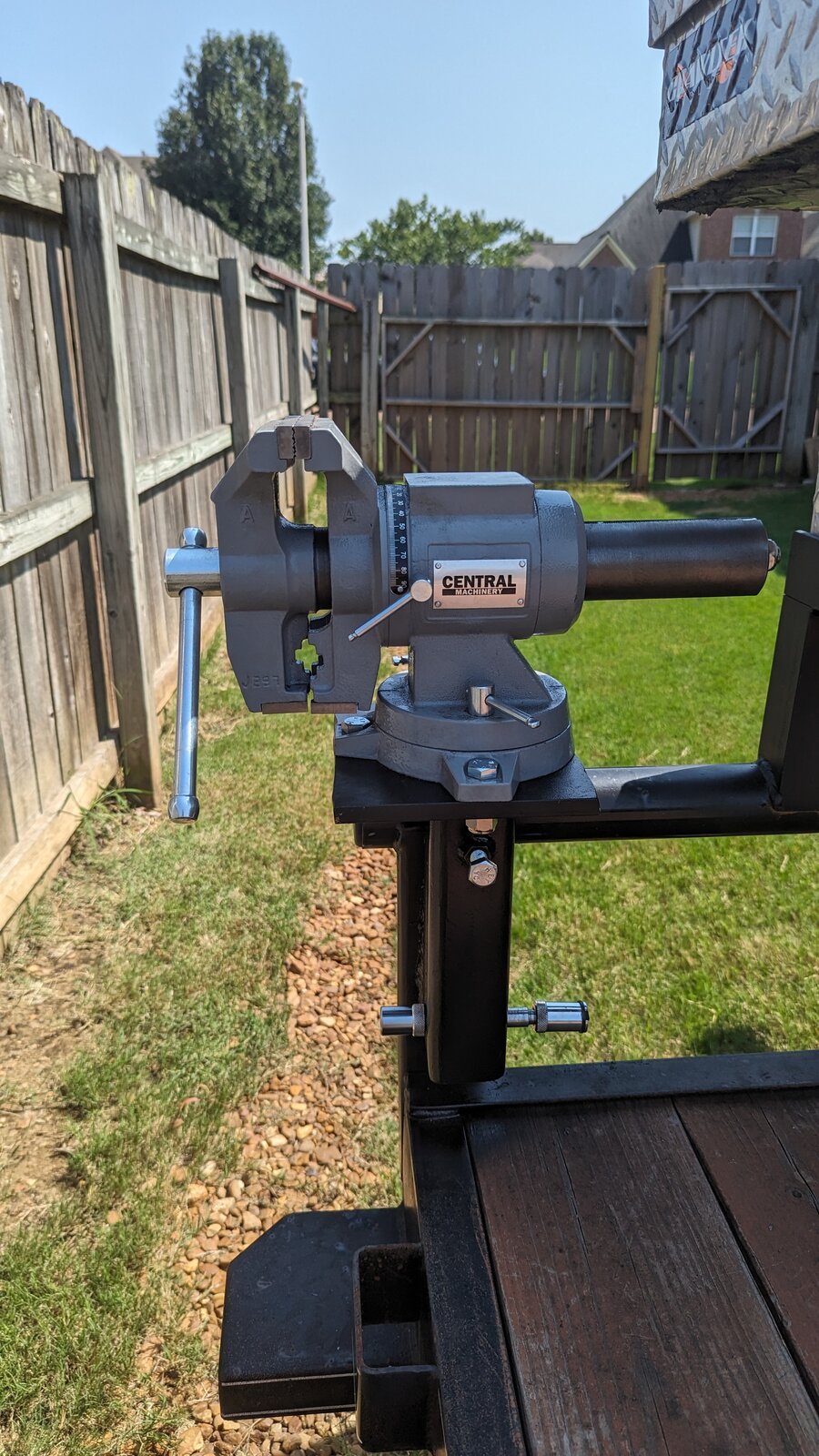

Work Mode:

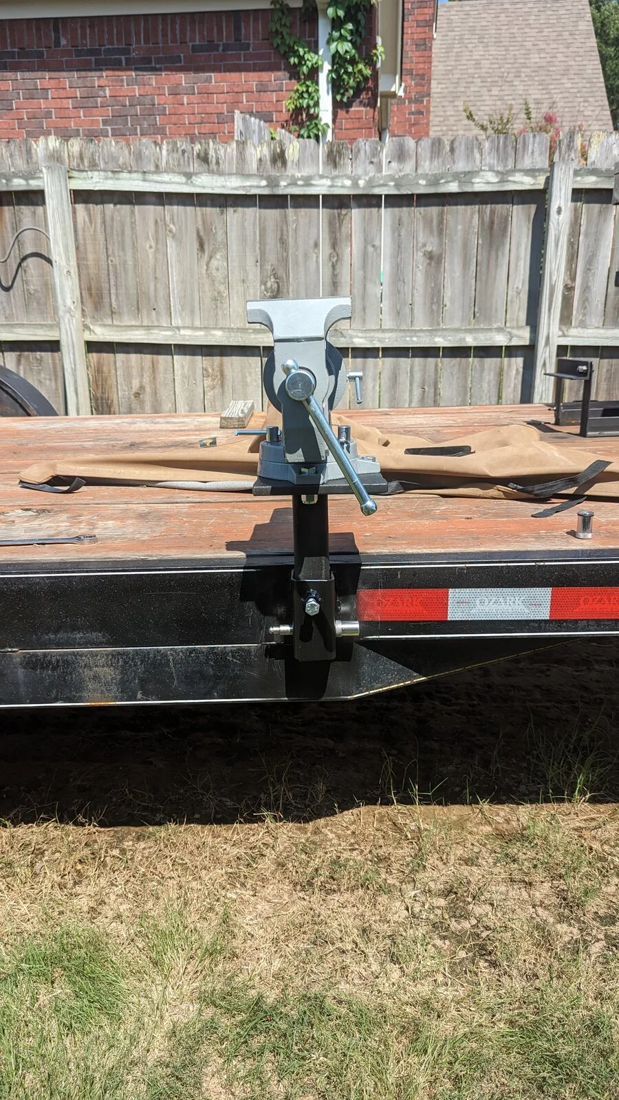

Sometimes the trailer is not always parked in a place where I have easy access to both sides, so there is a chance that the vice could be in the wrong location, so the 2nd receiver was mounted on the RH side about 1/3 of the way back.
Work flush with trailer:

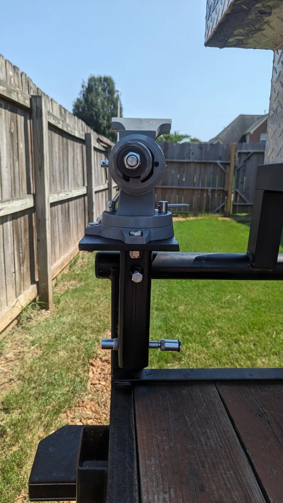

Raise it to not have to bend over:
