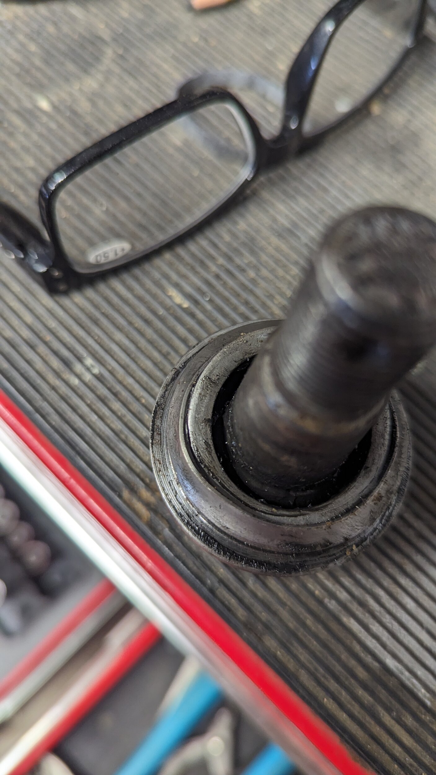

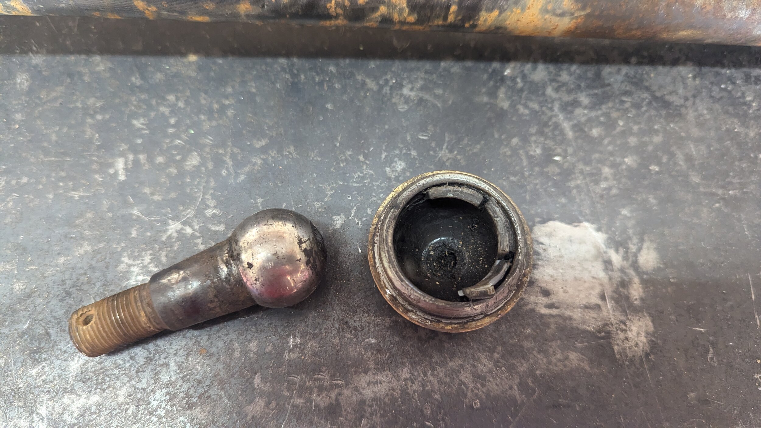

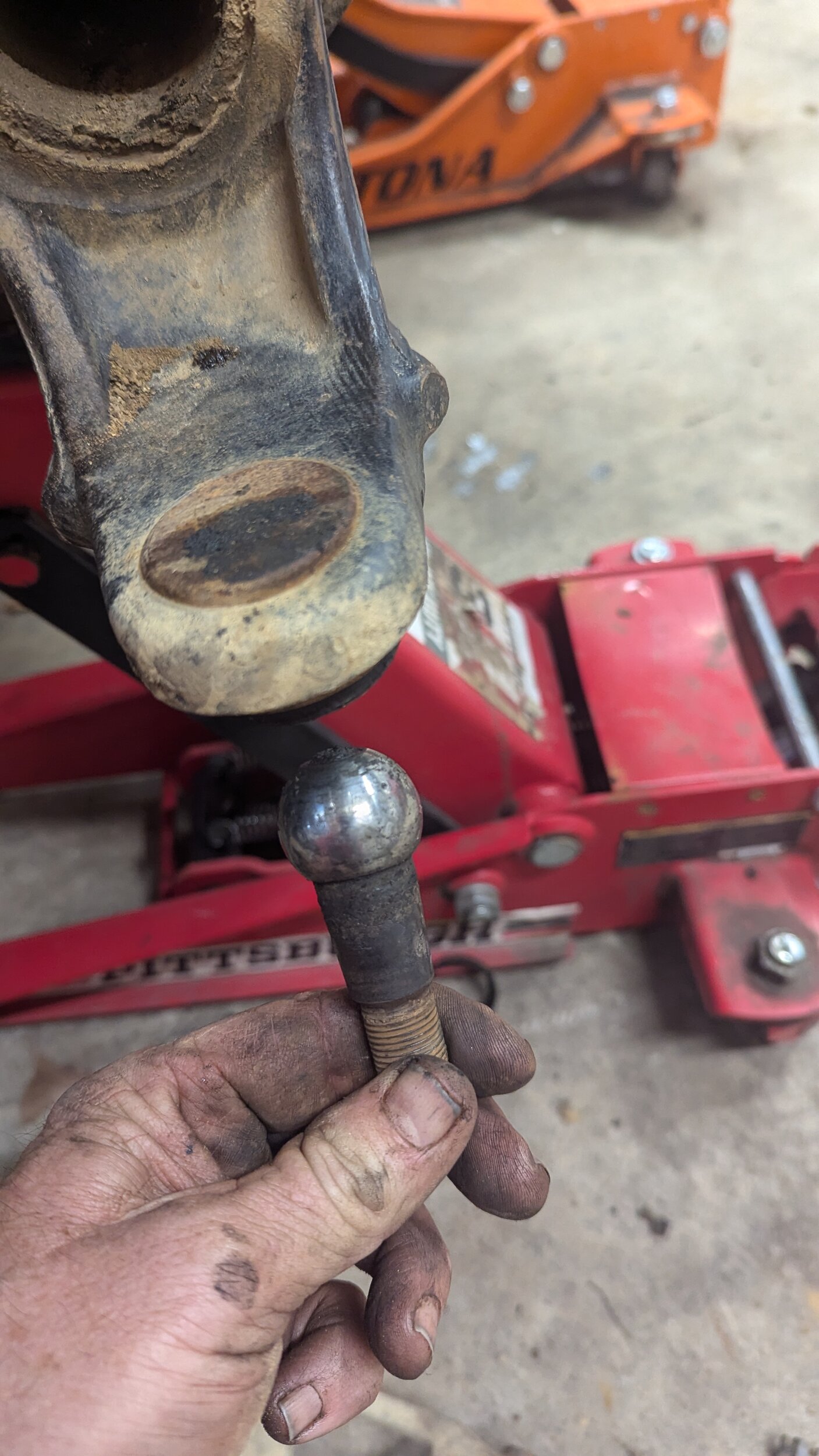

Prepping the Jeep for being trail guide at the Jeep Jamboree in Hot Springs and I thankfully found that the Passenger side lower ball joint had failed and that the Pitman Arm had developed some fatigue cracks.
The ball joint was a spicer and only had three trail days on it. Pretty sure that it got overloaded on the No Limits trail with Garrett, that trail was tight and technical and the wheels were getting pinched pretty hard. You can see in the picture that the ball was pulled down pretty hard which forced the retaining ring out through lip.
I swapped out the lower and upper ball joints with another set of Spicer Joints and need to start looking for a Dana 60 for the front in the future.

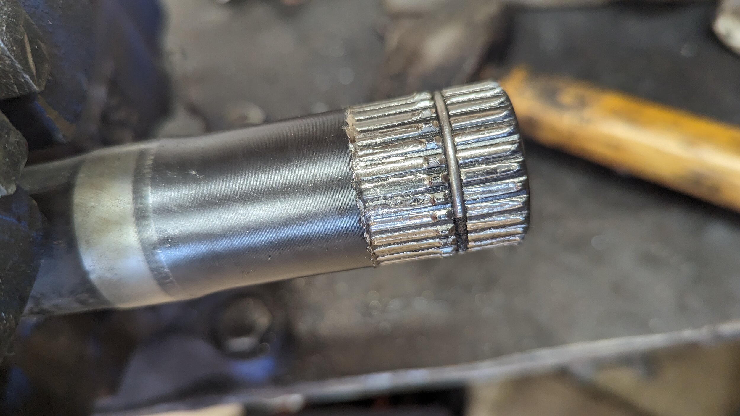

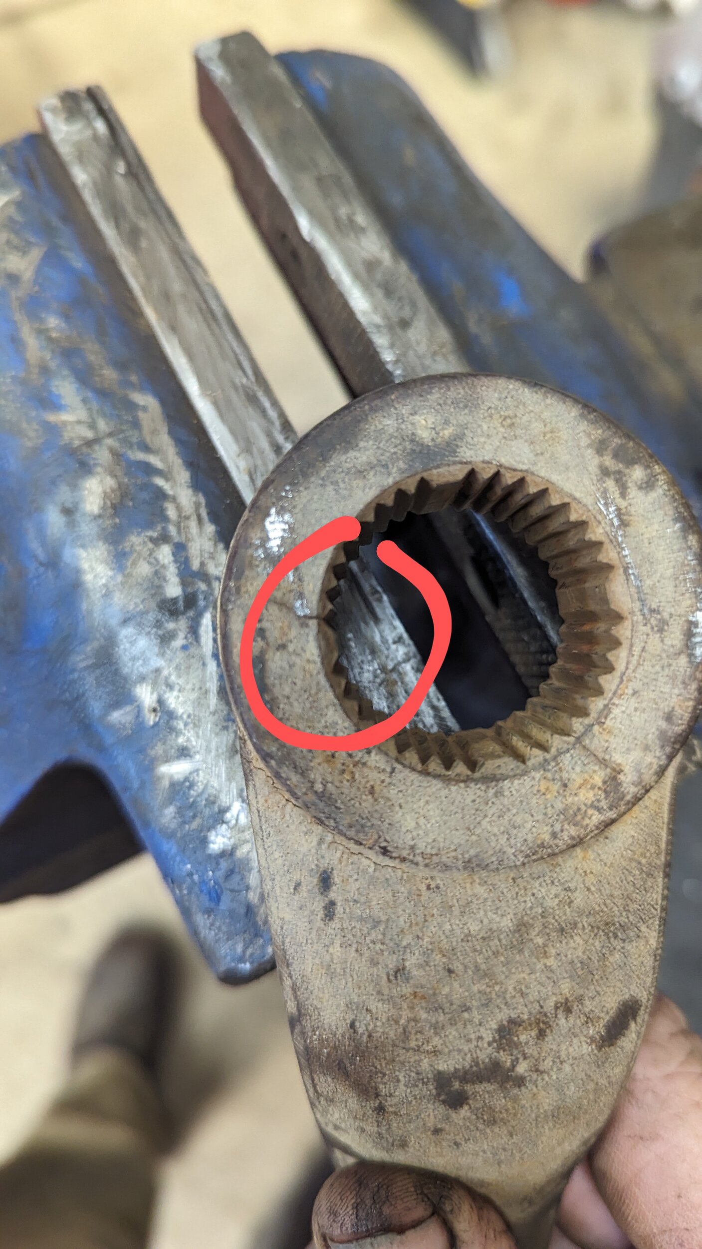

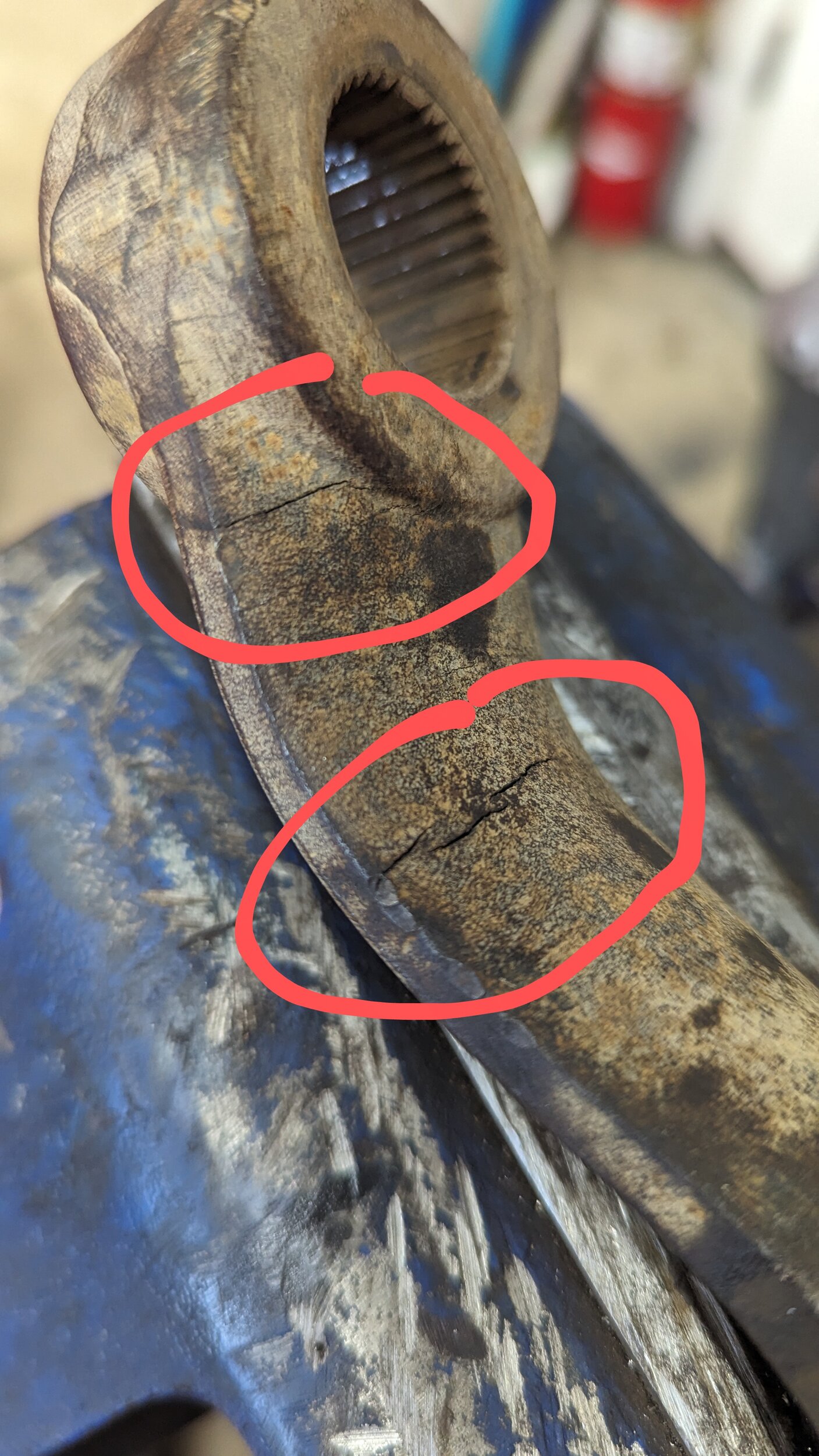

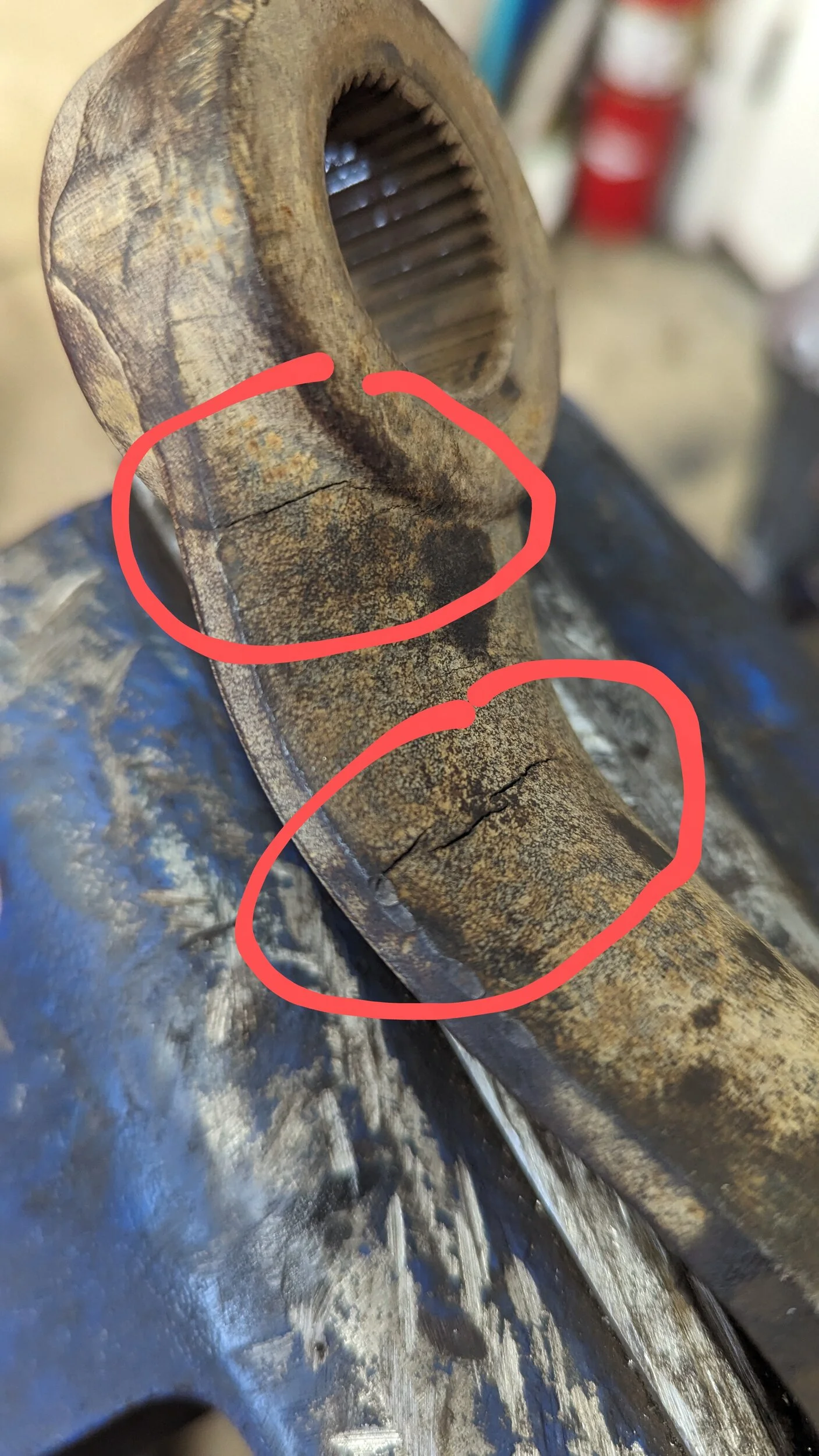

Pitman Arm - My buddy told me that the axle shaft failure was life's way of saving me from a disaster after showing him the pitman arm cracks. I need whatever help I can get, so i will take it!

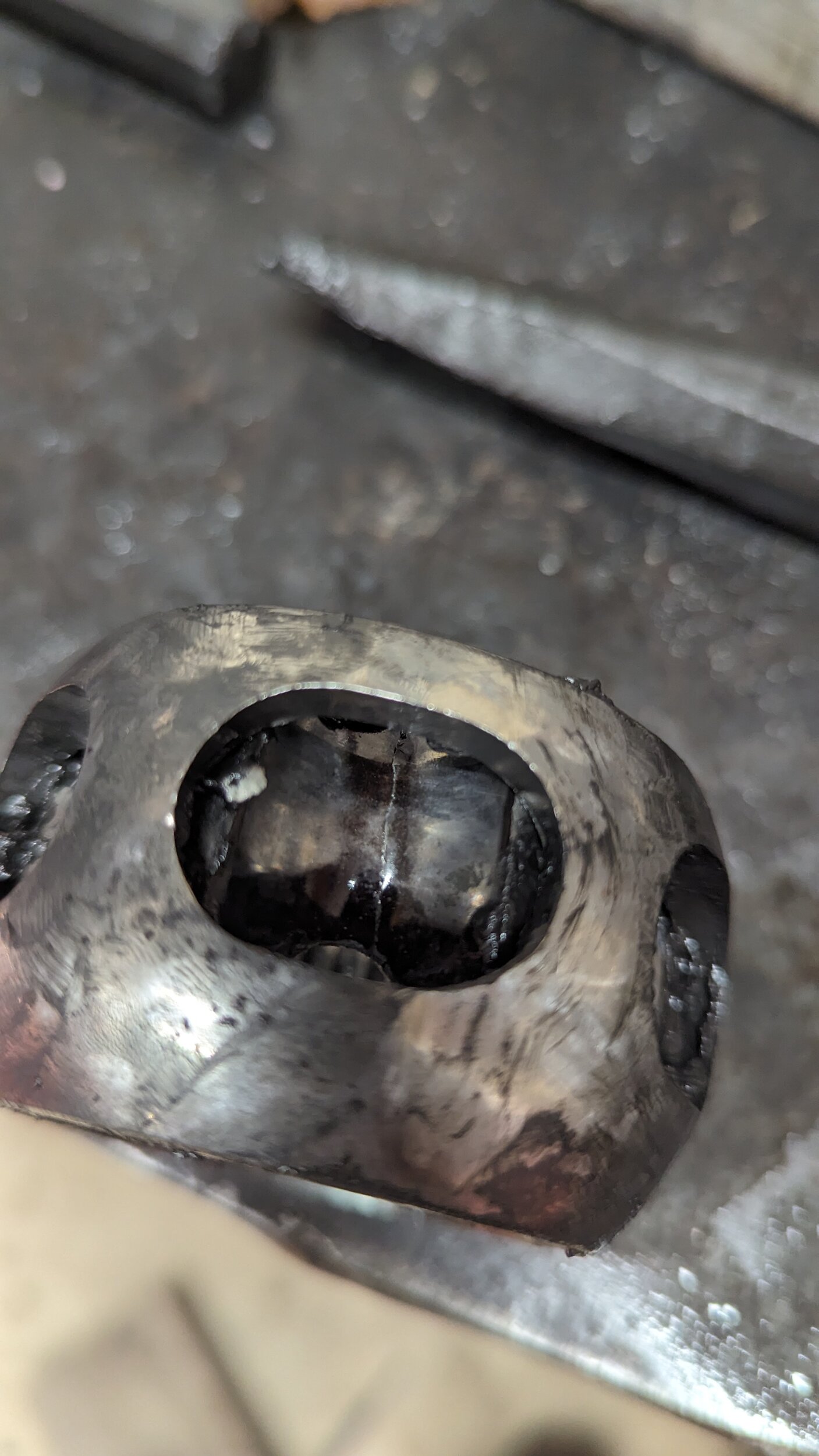

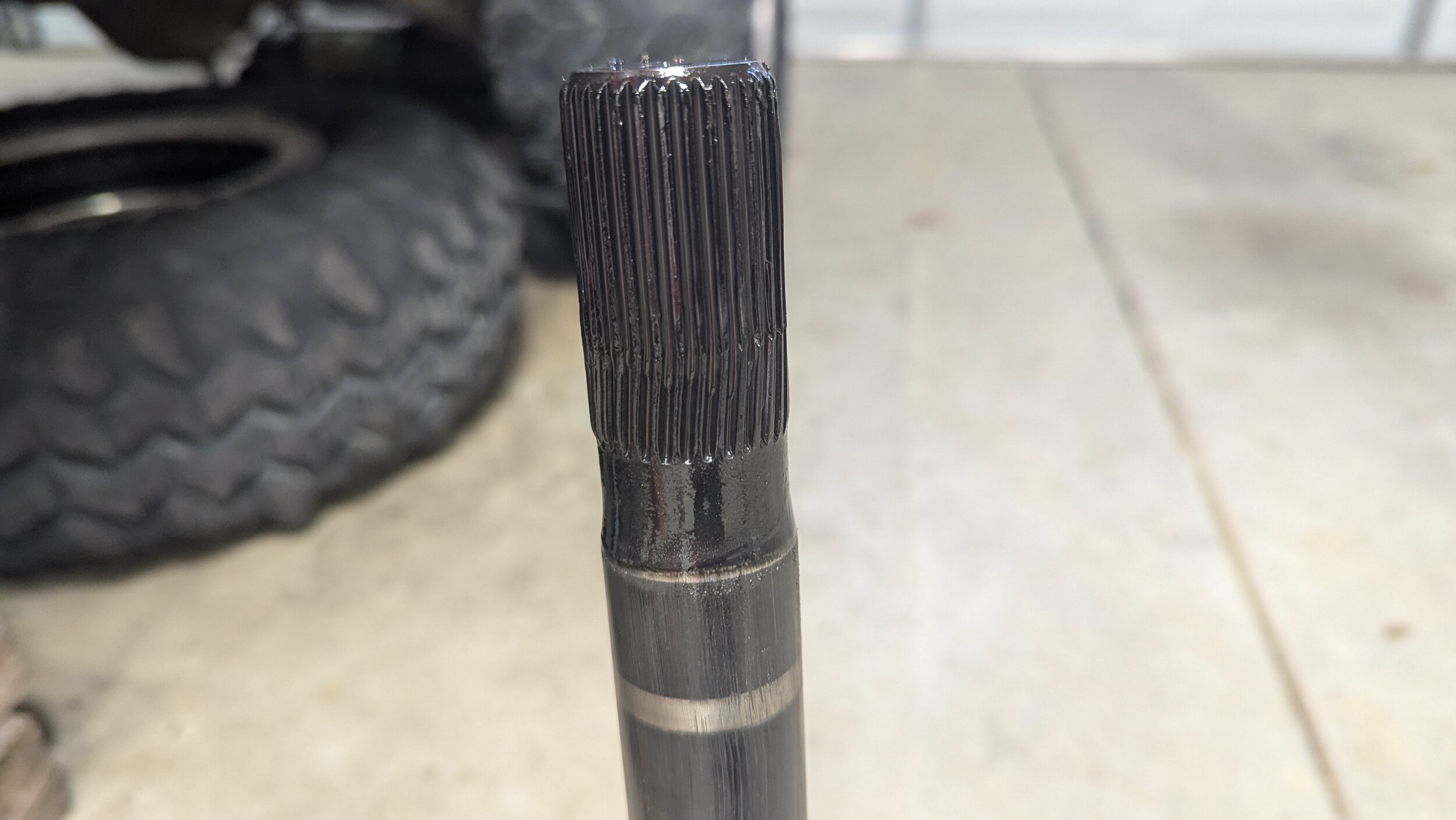

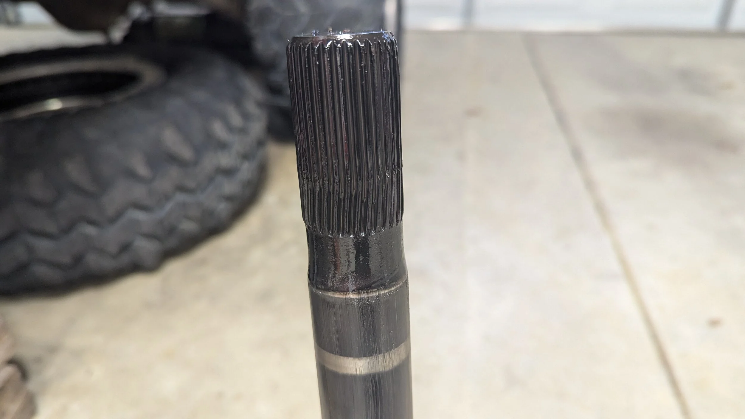

After looking at the pictures of the internal gear that I sent them, RCV contacted me and told me to check the splines on the shaft because they were most likely stripped as well. And sure enough, they were. I guess I was so focused on the cracks in the internal gear that I never wiped the grease off the splines and looked at them. Anyway, my neighbor has 2003 Rubicon with RCVs so he let me rob his front Driver's side shaft for the Jeep Jamboree. RCV has shipped a new shaft and it is on it's way.

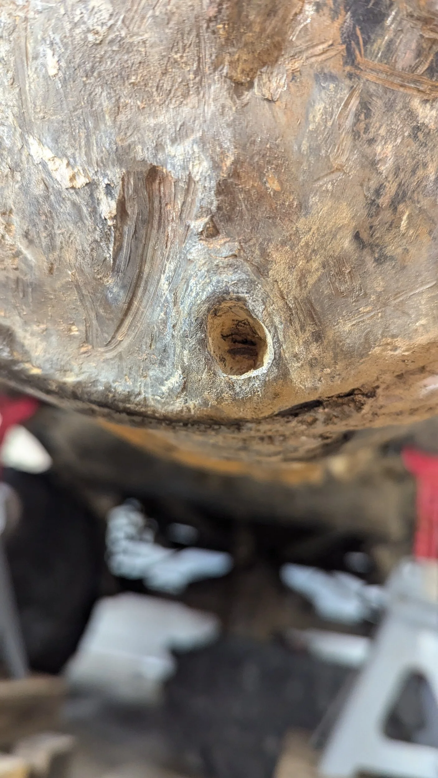

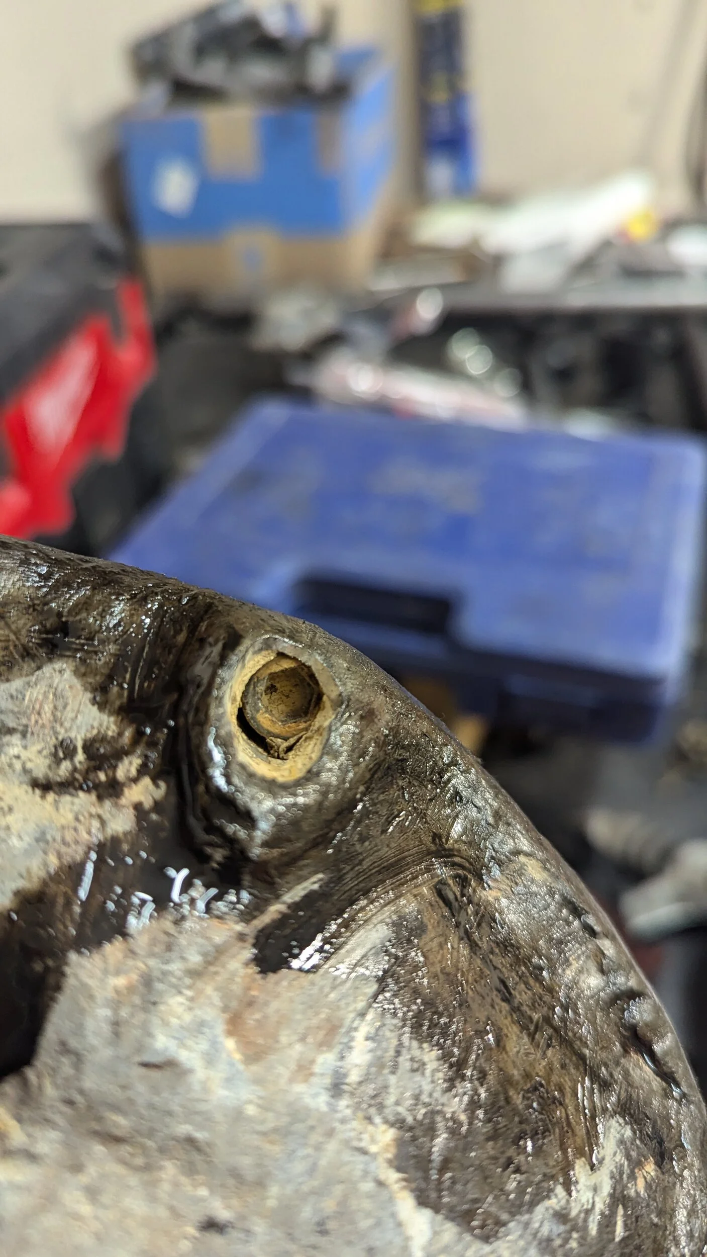

I also noticed that I again had excessive (1/8"+) veritical play in the balljoints. I know that vertical play is normal and per spec up to 0.063" and to only focus on the lateral play in the upper (which there is none). But after the balljoint failure back during the Arizona trip (luckily I found it at home and it didn't completely fail on the trail), I needed to find a way to strengthen the BJs on the Dana 44 to take the beatings that my driving style induces (even though I am no longer running the 37" stickies, the 36" TSL SX are just about the same dia as a normal 37" and provides the same moment arm and loads into the ball joint as a 37" tire). So to try and ease my mind of these BJ's I just purchased the American Iron BJ Eliminator and a new set of knuckles. My current knuckles are original and the TRE do require a washer, etc... and I figured if I am going to upgrade to Eliminators I might as well also change the knuckles to make sure all the tapers are good and match. The elliminators and the knuckles should arrive today and I will hopefully install them in the near future.

When the debates start on 37s and Dana 44 ball joints, etc... just point them to this post. This year I had a ball joints fail in three days and now I had the replacement fail in 9 months and it is a trailer queen and has only seem trails. I also broke a RCV inner shaft this year and 9 months later I found the replacement shaft with the splines twisted. And I am running 36" tires, not even 37s. Let them debate that it is OK and to just stay off the throttle, their buddy has done it for years, etc... Here is the proof that if you are going to wheel it, it will wear out faster with the bigger tires. I have no experience with how they hold up if you only drive it on the road and don't plan on finding out.
This is the passenger side which was completely failed, the driver side was still intact but wore enough to require replacement. Both uppers were good, but they should be they are only 9 months old 😆

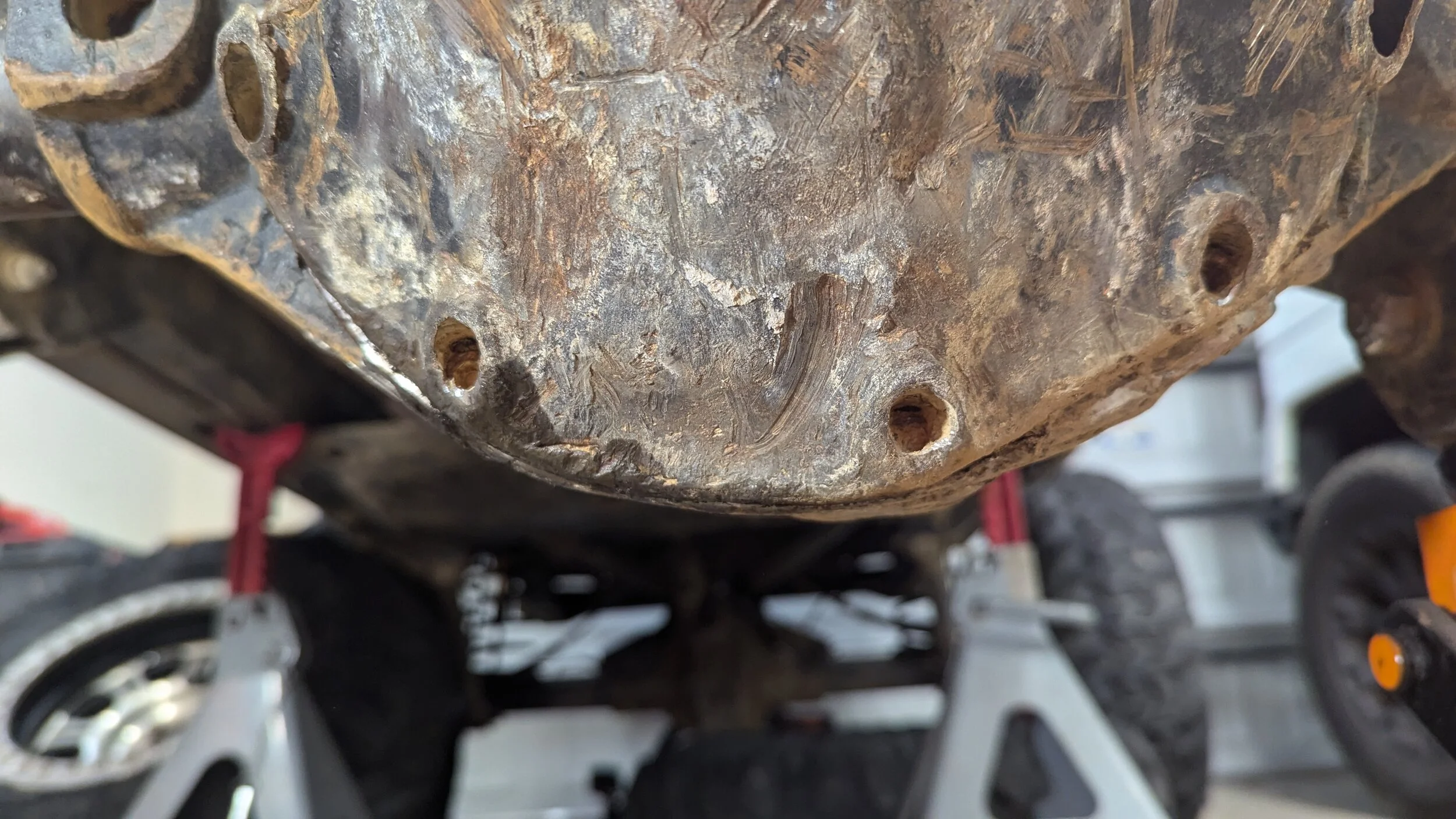

Also found the one flaw with the Barnett diff cover, if you beat on it enough in the rocks, the lower holes collapse in over the bolt heads and you have to grind them open to get the bolts out. The holes also pack up with Alabama clay which dries like concrete.
