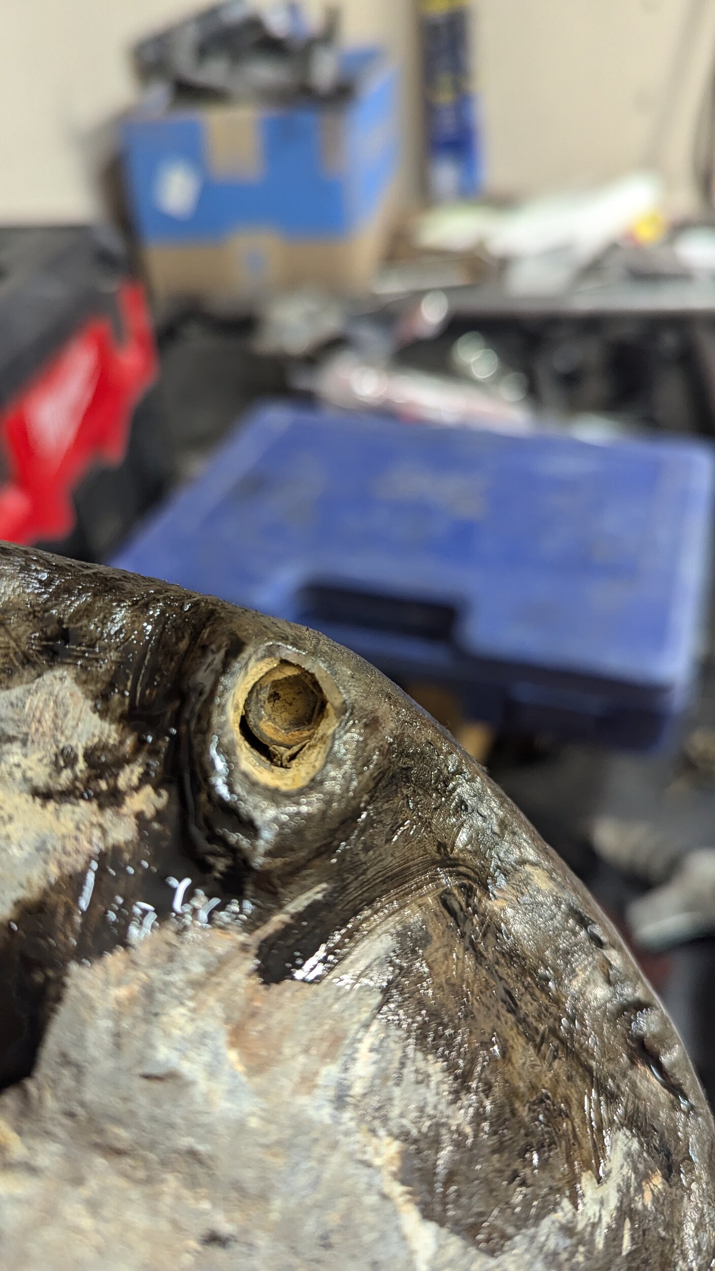

I'm not thrilled with my Barnett cover either. I tried three times to seal mine with silicone and ended up using a lube locker. The 7 o'clock bolt seeped enough to leave a quarter sized or more drip depending on how long it sat. It was not surfaced very well and a little valley from the bolt hole to the inside of the sump caused the drip. That same 7 o'clock bolt had to go in first because the opening for the bolt isn't centered. The one thing I really like is the ramp that helps slide over the hump on washed out trails or rocks.

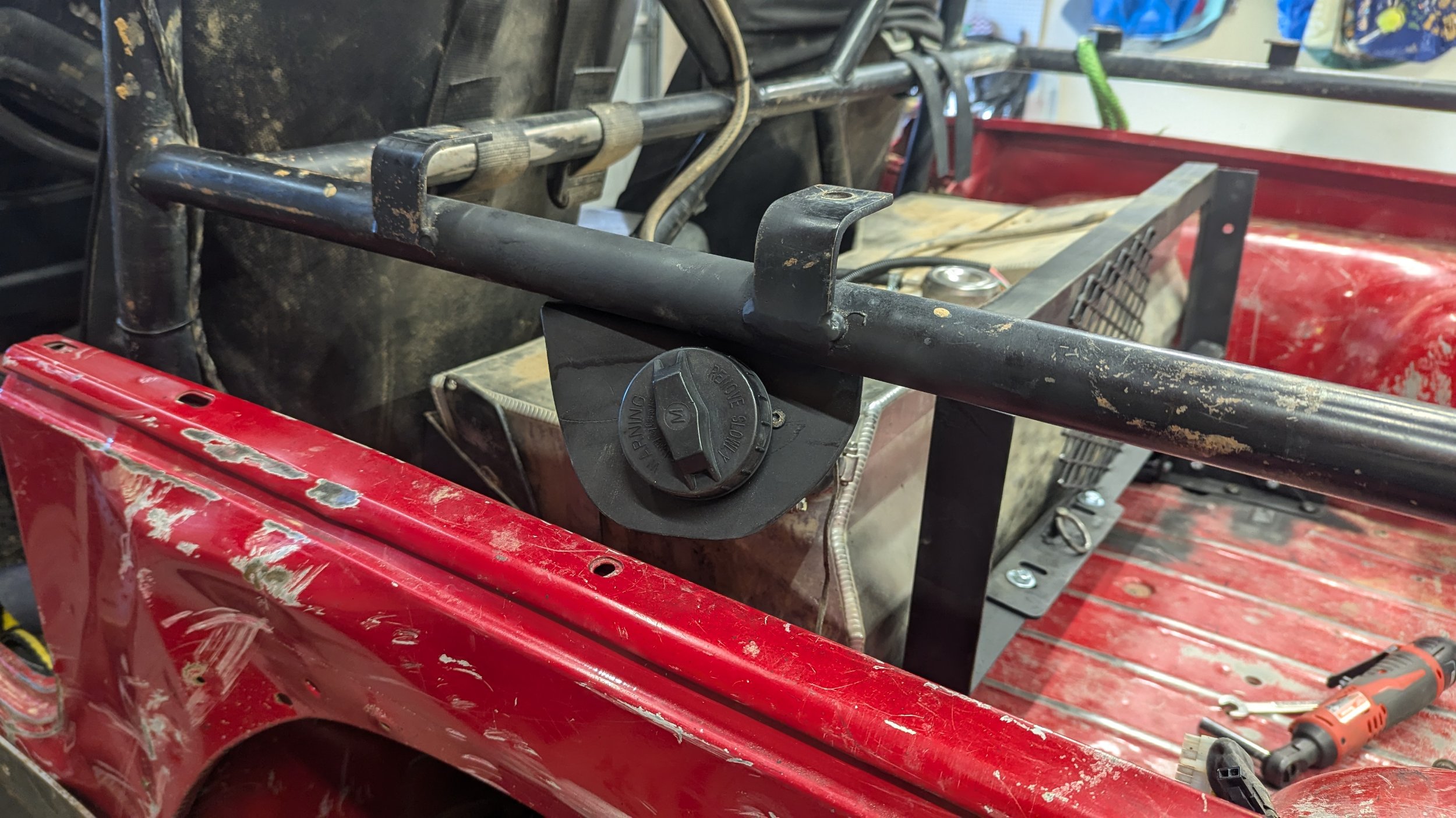

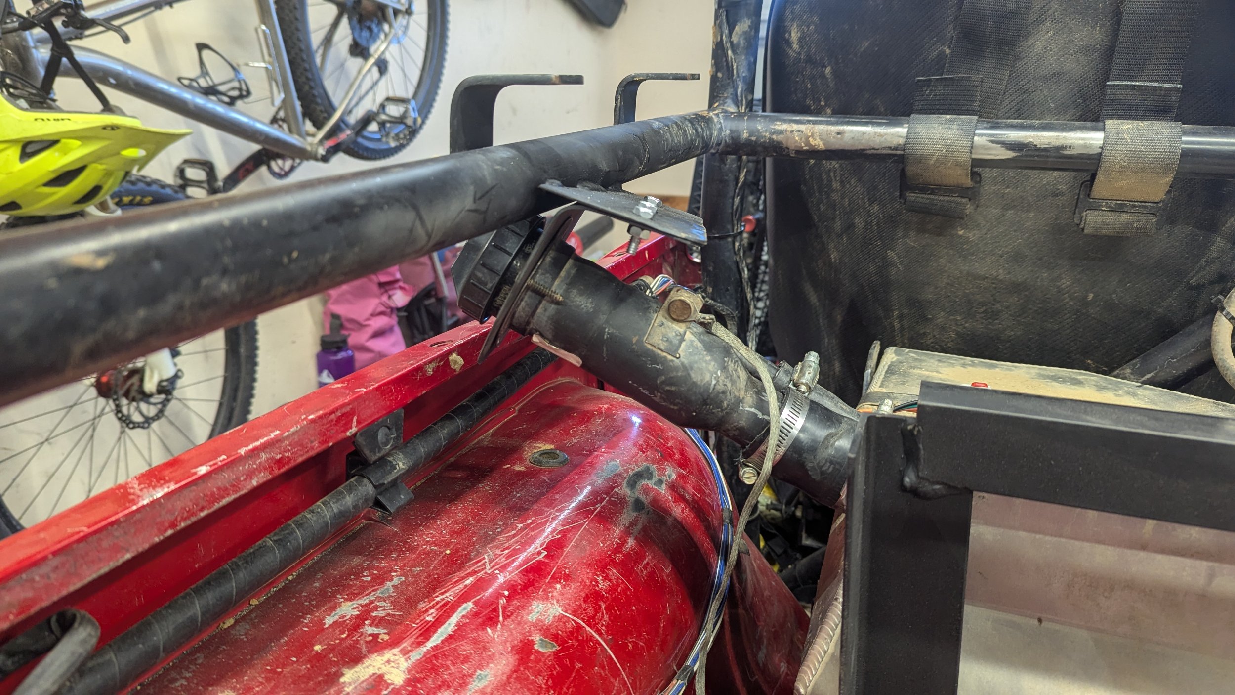

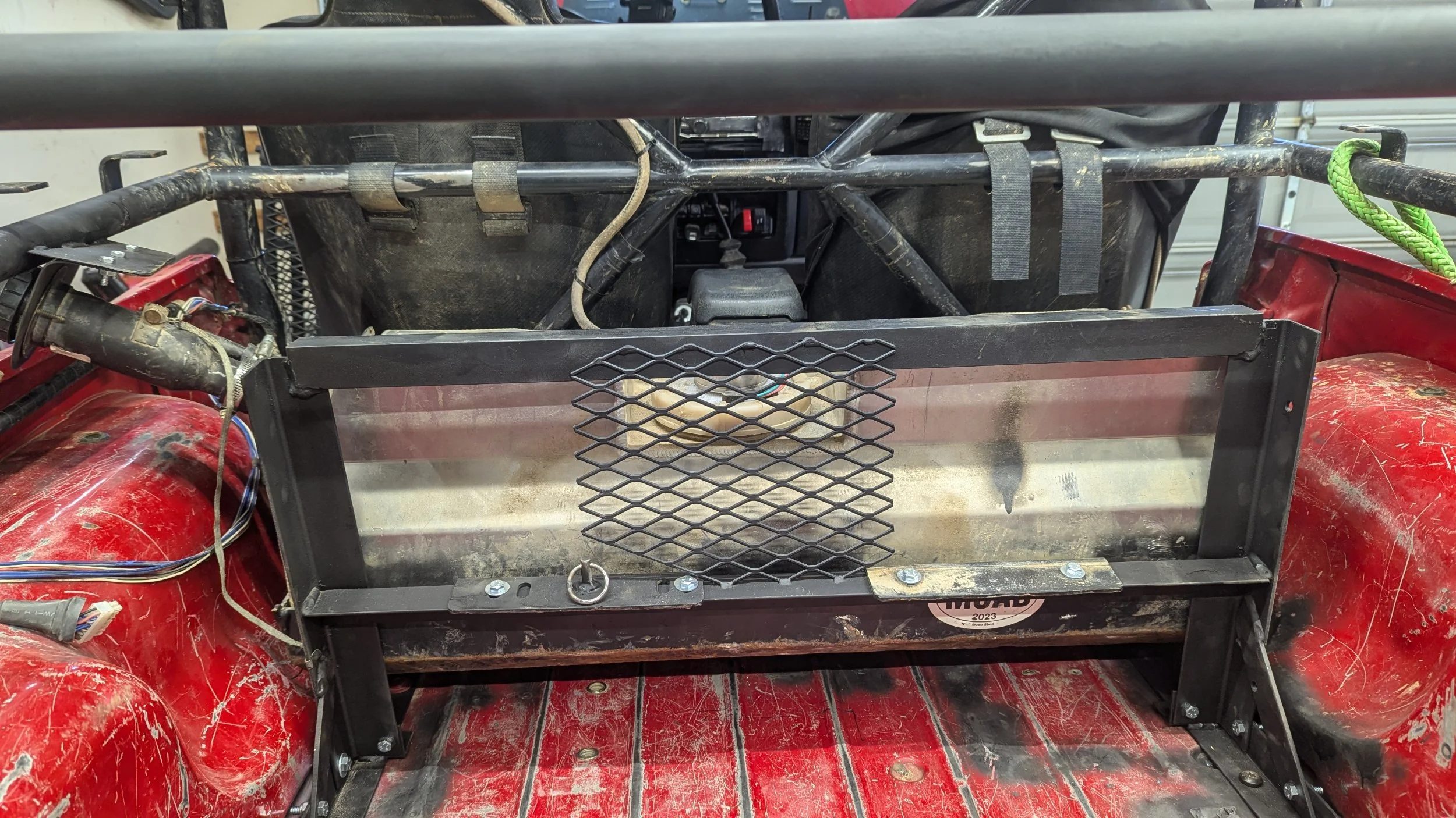

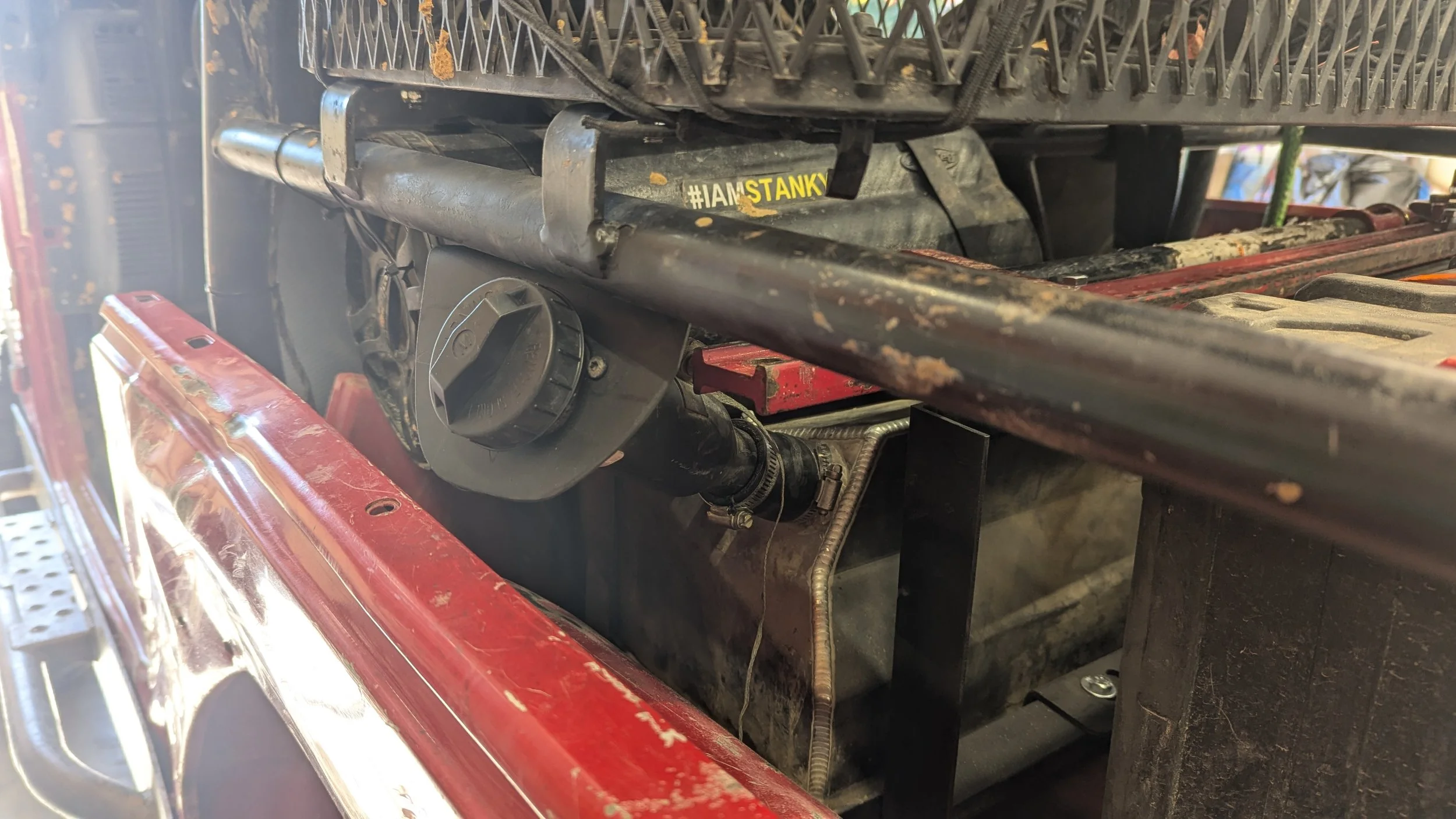

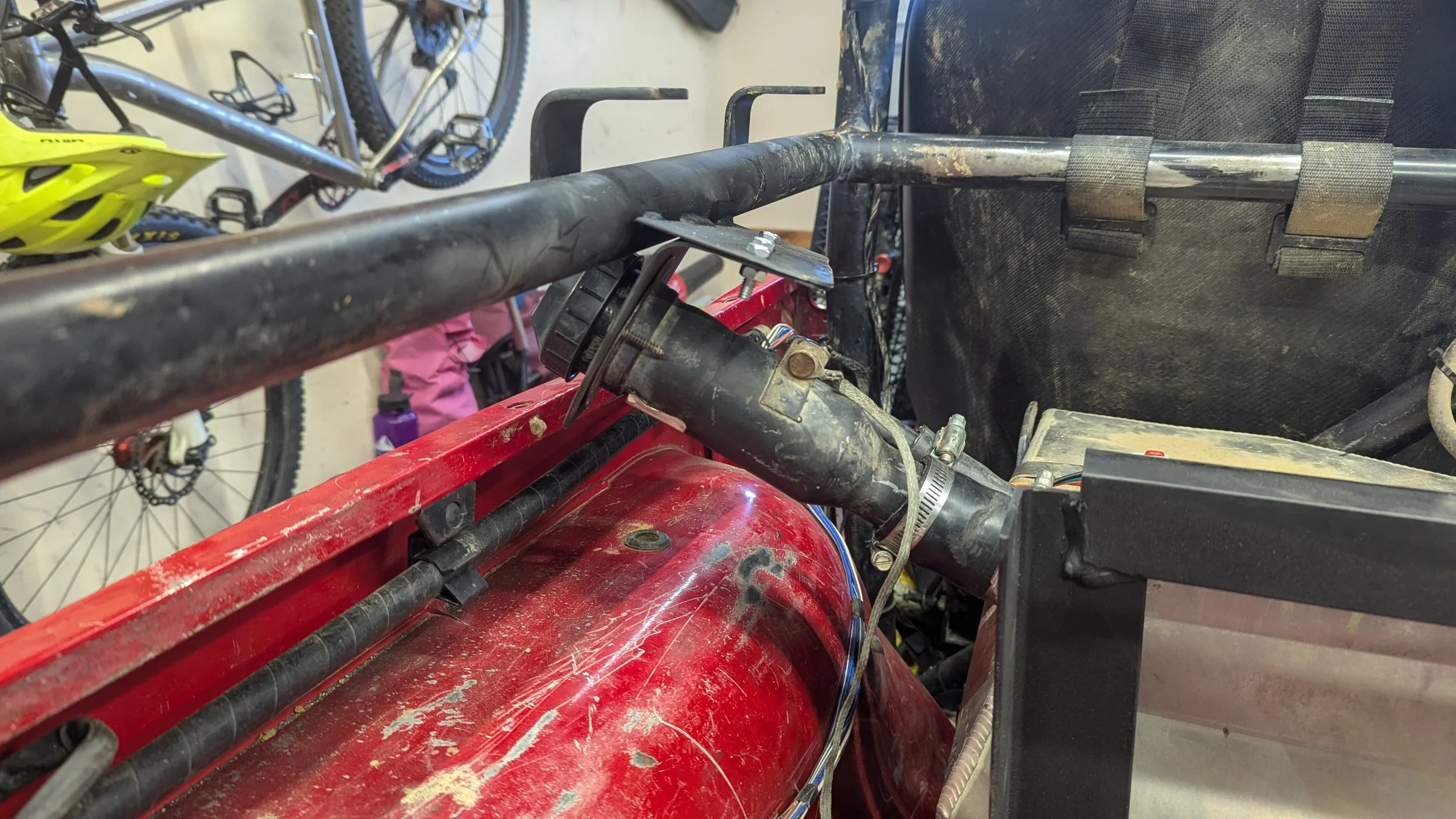

After my fuel pump issue at Golden Mountain a few weeks ago, I figured it was time to relocate my gas tank from underneath up to the bed. I have been keeping it under just so I can put the rear seat in when my youngest son would go with us; however, he is now grown, working full time, and has his own jeep so I don't think he will be riding in the back anymore.

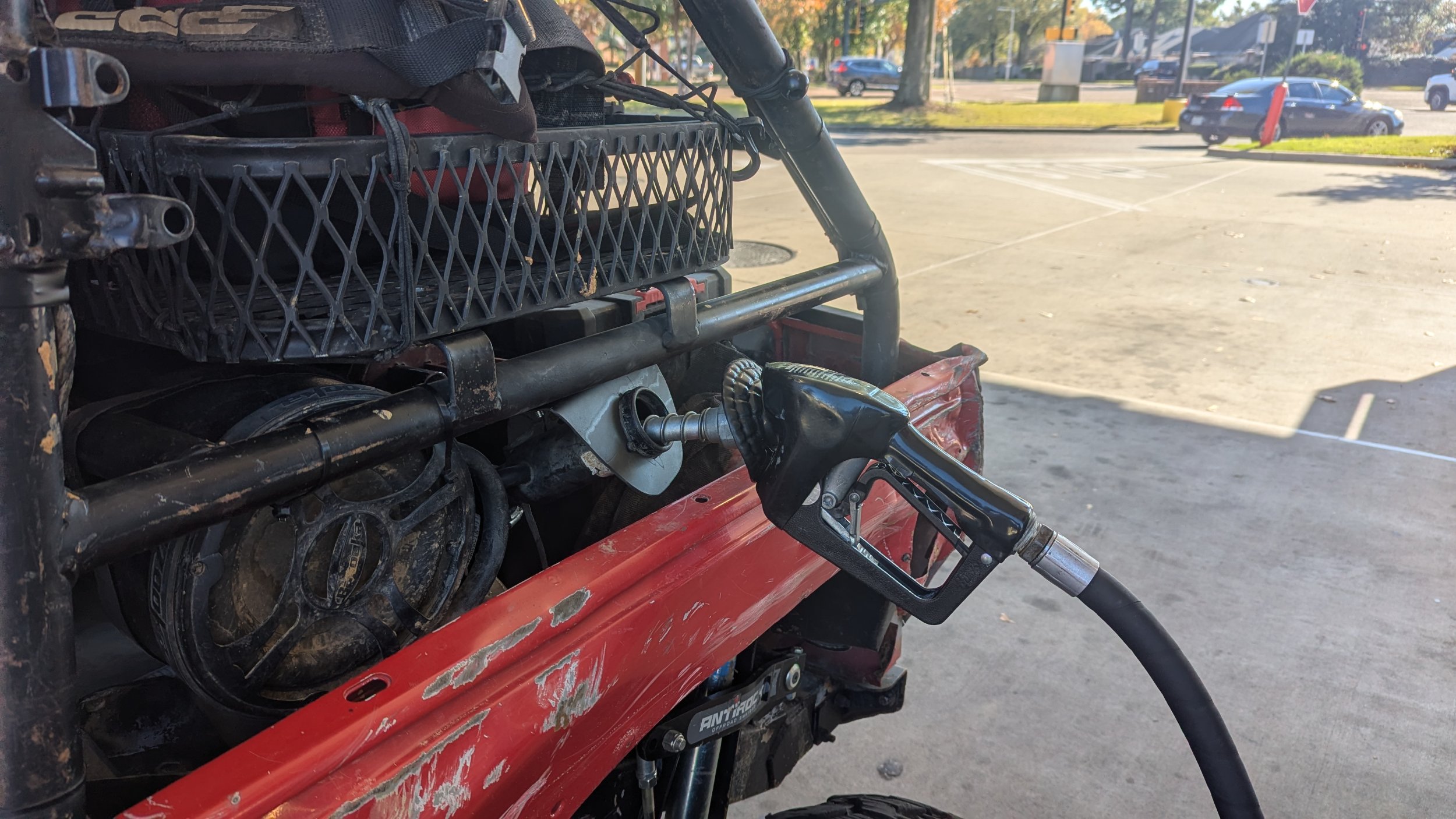

I had a GenRight 23 gallon tank mounted underneath and I wanted to just put that in the bed, I also wanted to maintain the ability to fill from a gas pump and the ability to fill with the top on didn't matter to me because I can't get a top on this thing anymore. :ROFLMAO:
So I "massaged" the bed area to allow for the install of the tank. Fabbed up some brackets, and Wala.

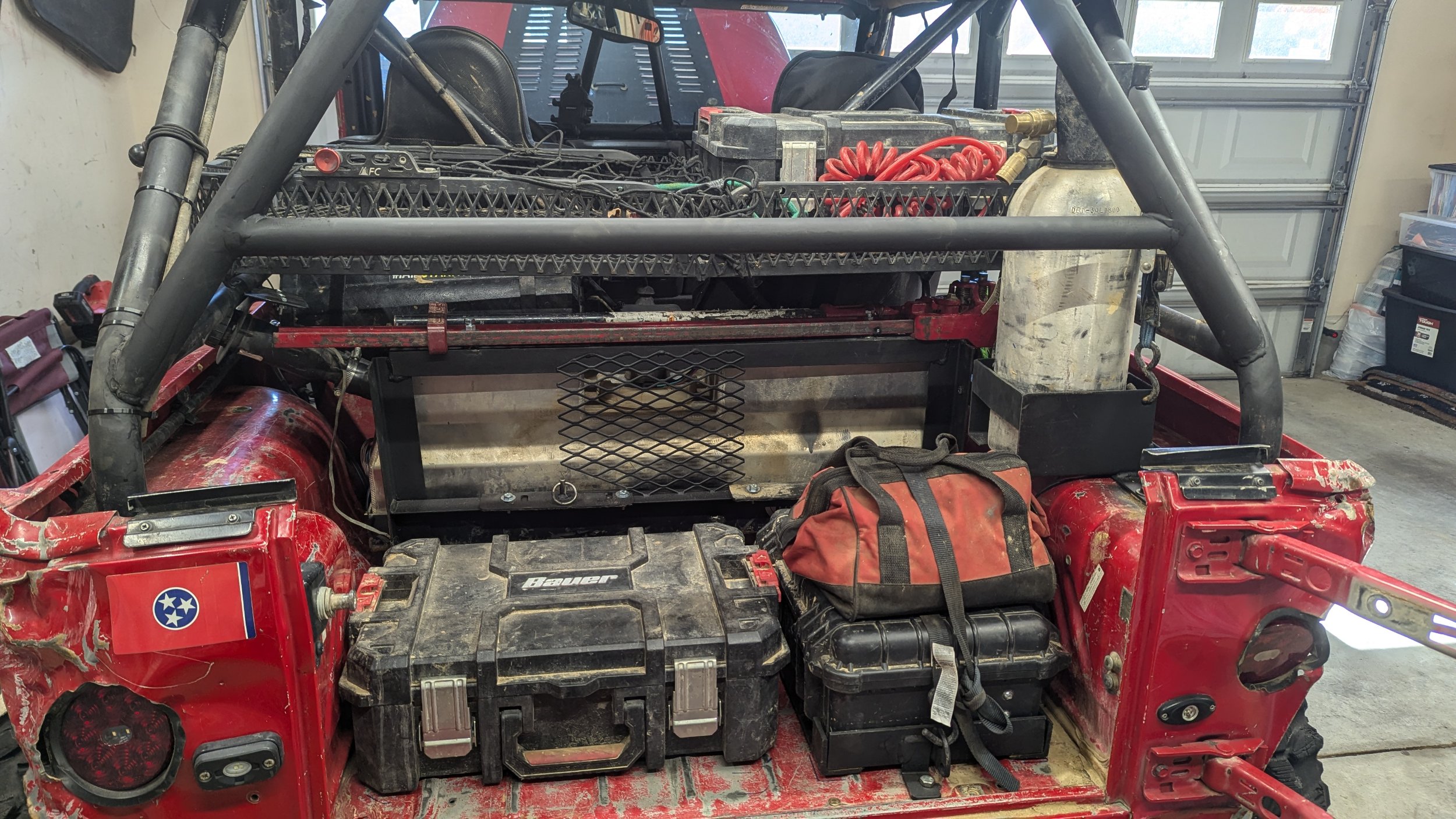

I then made some new additional brackets to install tools, welder, air tank, and the Hi Lift.

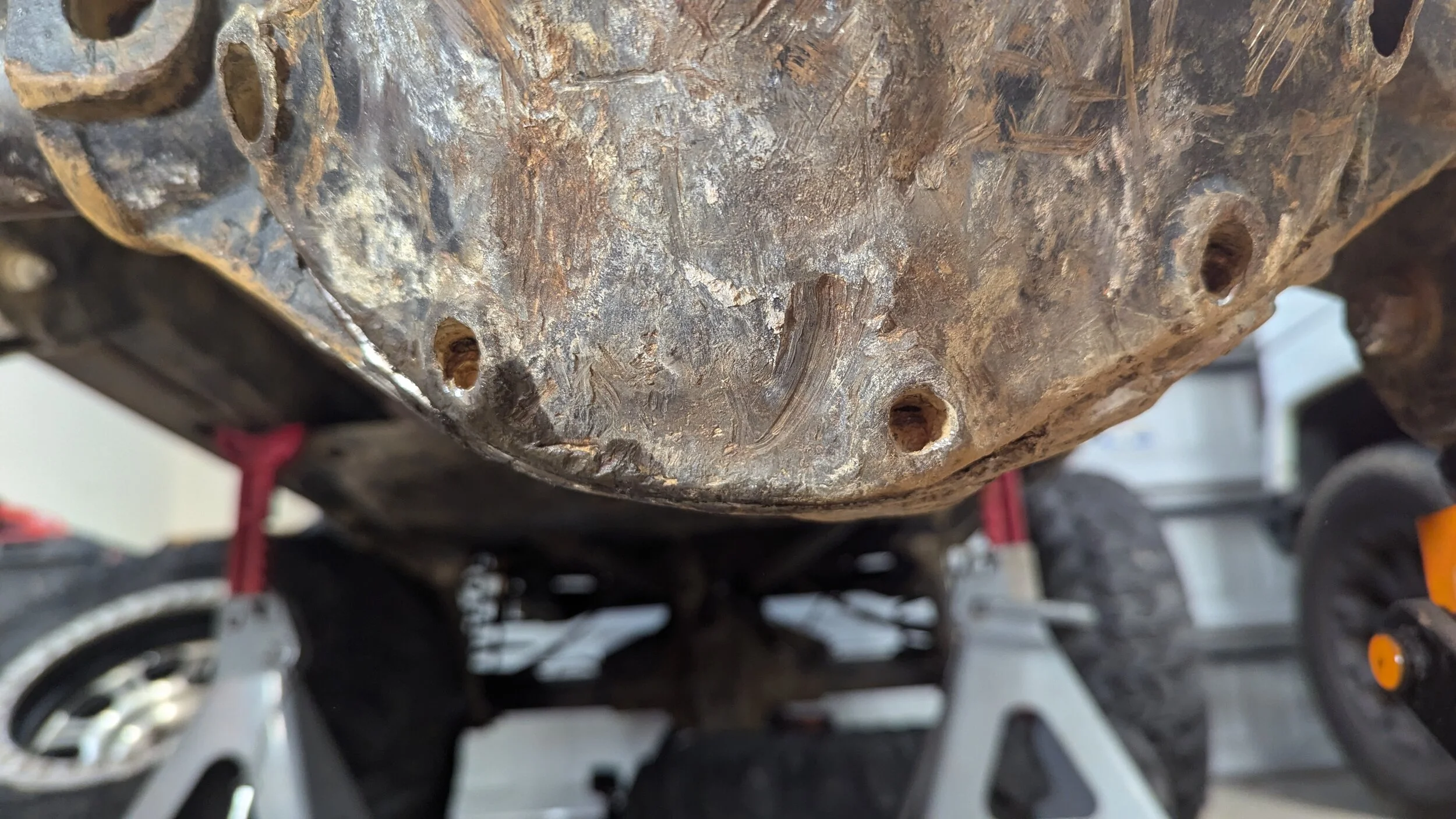

Above Post #376 is the aftermath of Hawk Pride with my Ball Joint and my front inner shaft. I don't think that was all from the one trip to Hawk Pride, it was just that I found it after Hawk Pride since I started my axle swap.

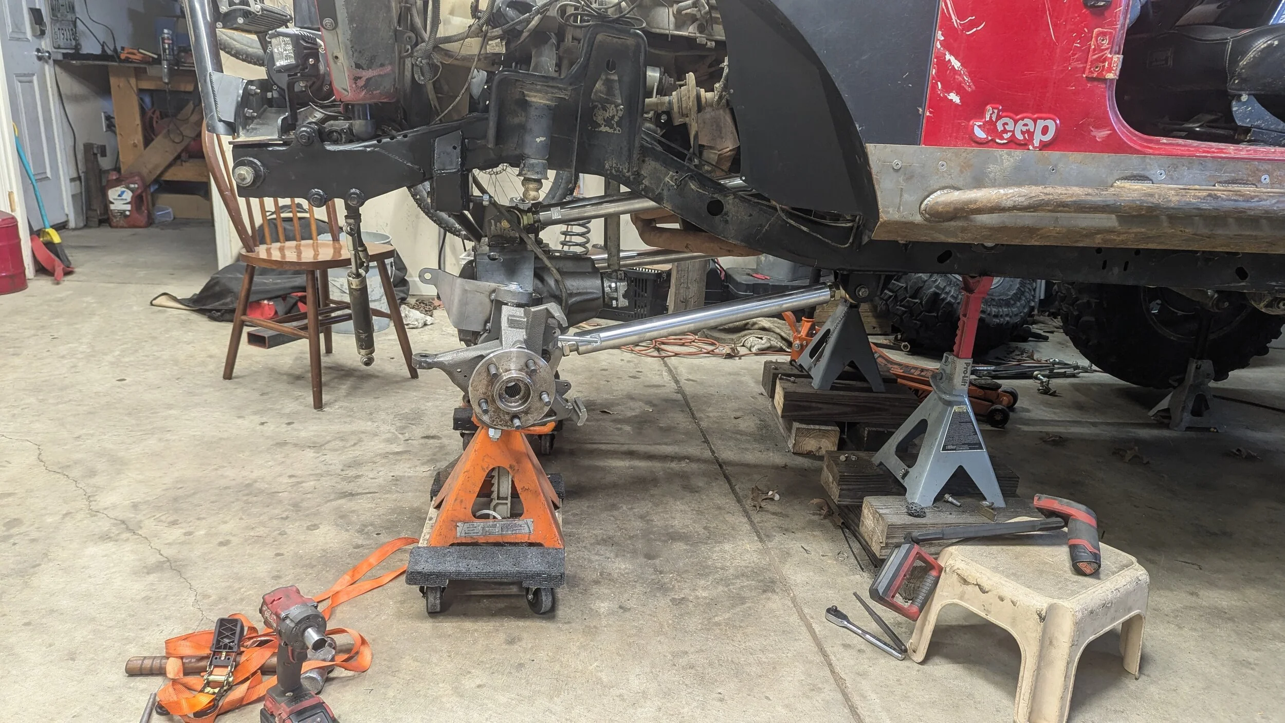

I picked up a brand new Currie HP44 from a guy in florida back in August and I figured it was time to do the install.
Sneak Peek at how that is going:

Currie HP44, TJ width. I bought it from a guy who never installed it, it never had oil in it. It has 5.13 gears which is what I was looking for and it has an ARB locker. It came with Carbon axle shafts which I removed and replaced with RCVs out of my LP44 being removed. With the install of the new axle I also wanted to do a small stretch (3") and to redo the geometry to better allow for the wheels to climb up over ledges in lieu of being jambed back and down. I had a few criteria I wanted to try and meet mostly due to finances, but also since someone told me it couldn't be done. My criteria is that I wanted to do the stretch while still using the currie currectlync steering, the currie track bar, and my hydro assist setup that I currently had, and that I wanted to make as much stuff that I already had work I lieu of buying. I also had to use as much scrap metal that I had laying around to fab in lieu of buying parts. I still ended up spending about $1500 in parts to do the stretch, geometry correction, and axle install. AND I currently don't know if I am done since I haven't gave it a test drive yet due to still waiting on parts.

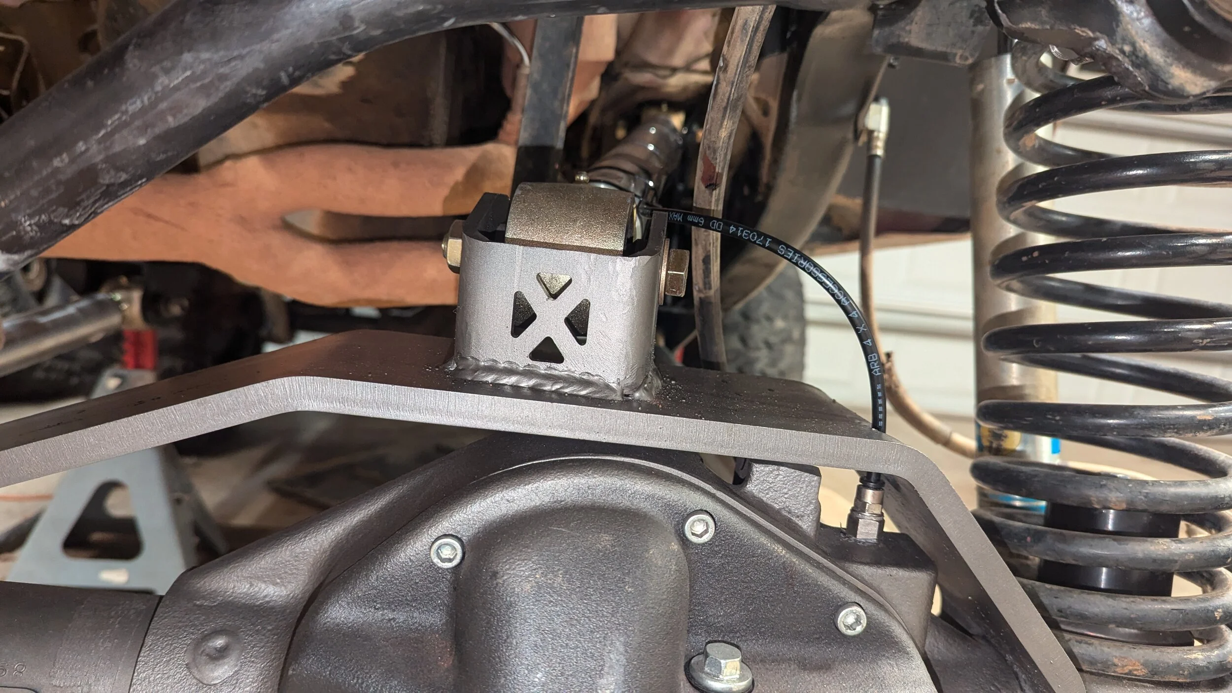

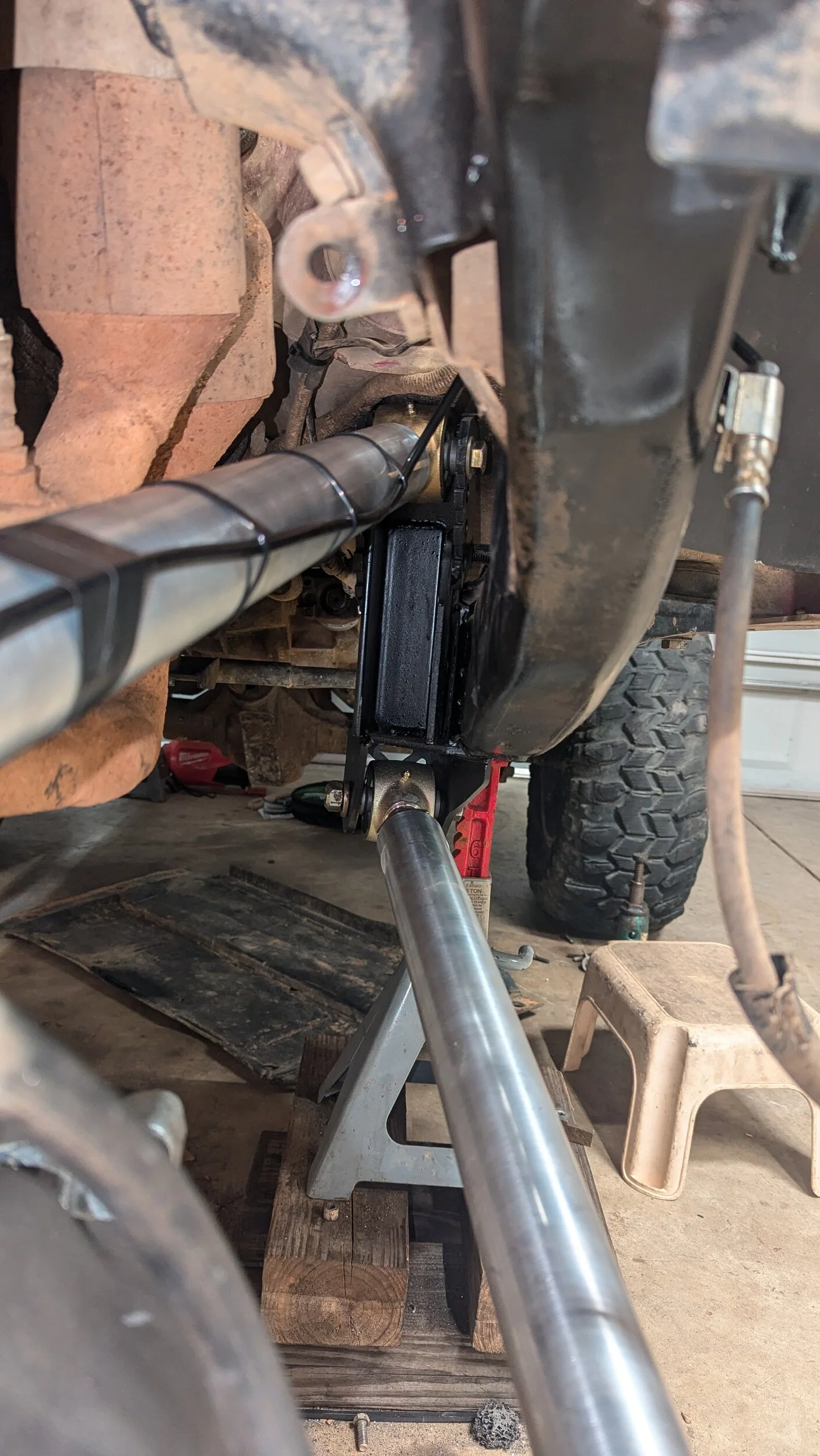

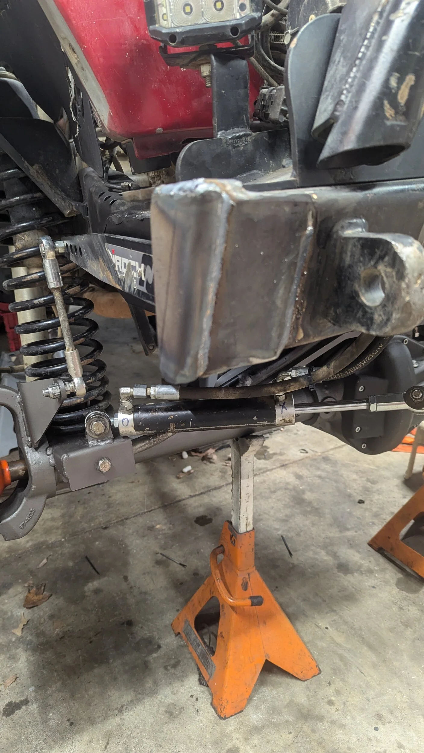

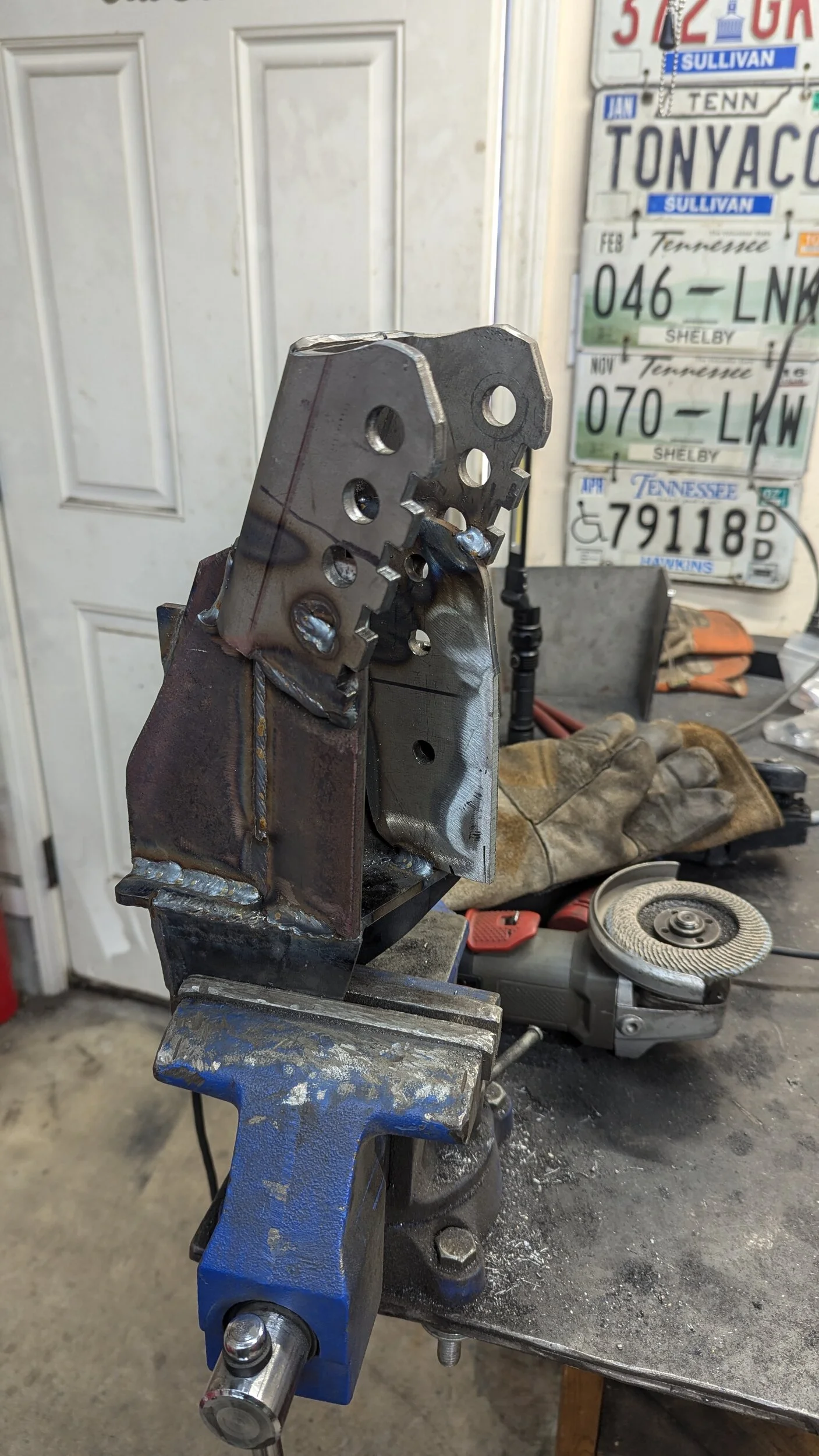

Anyway, here are some pics. I am really happy with the frame side track bar mount that I made, I had to do a little bending of the antirock arm but it clears.

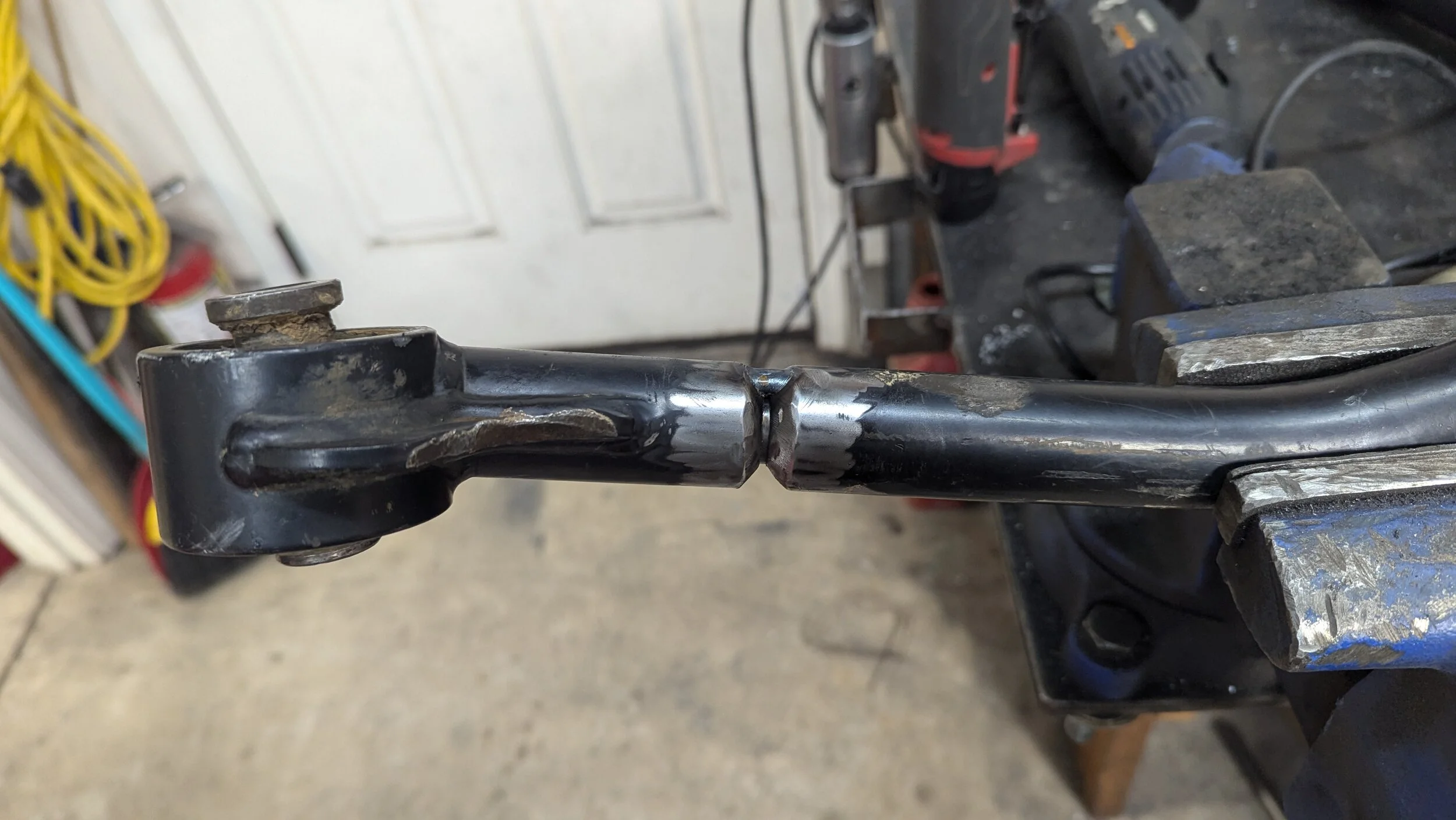

In order to reuse the currie track bar I had to cut it and rotate the frame side joint.

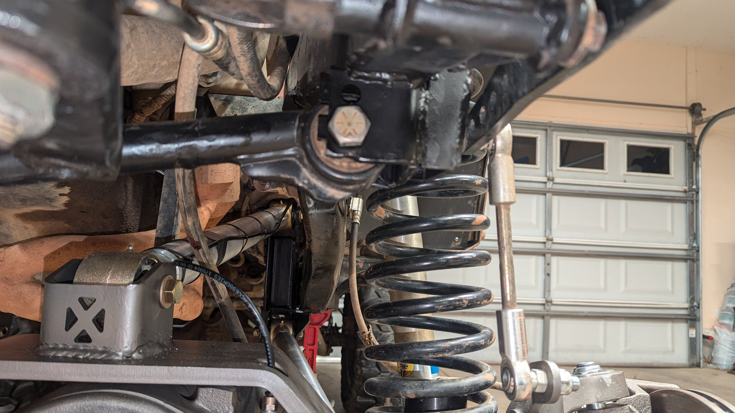

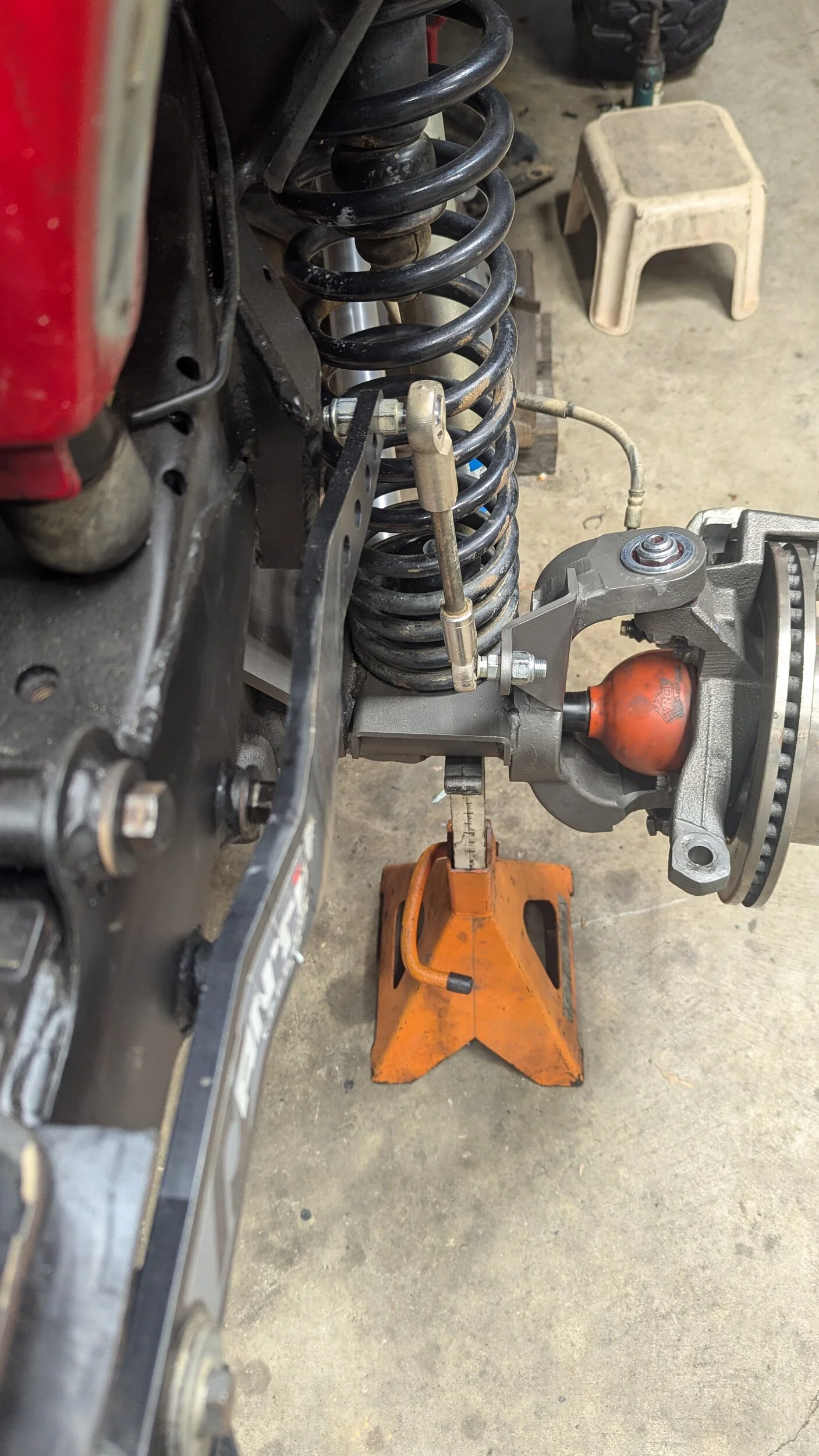

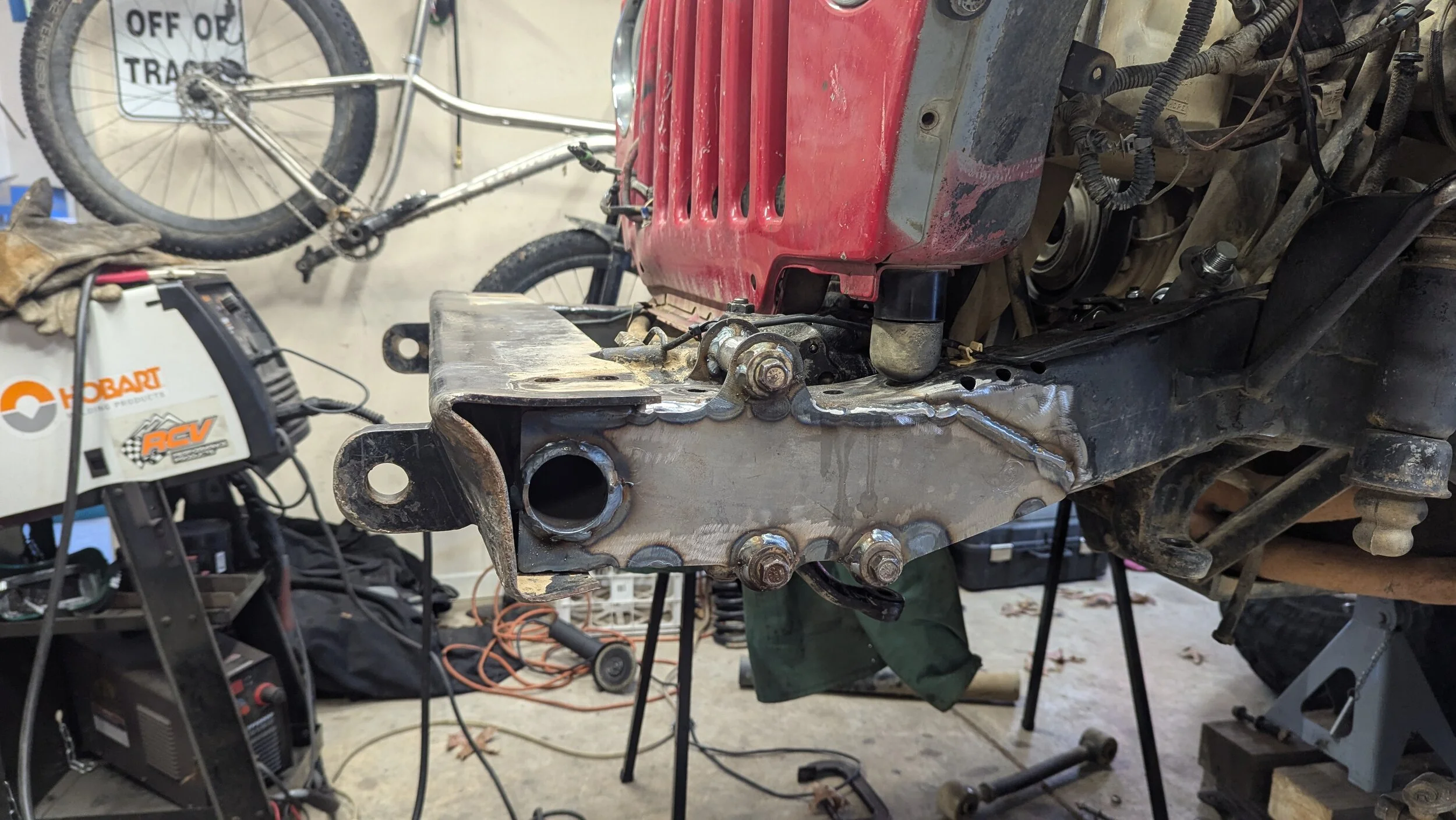

With the geometry correction I went 3 link and I cut off the factory upper mount and installed a 1/2" thk truss with a 2-5/8 wide mount to take a JJ.
I modified some purchased 3 link brackets to better suit the geometry I was shooting for (see the frankenmount in the previous post)

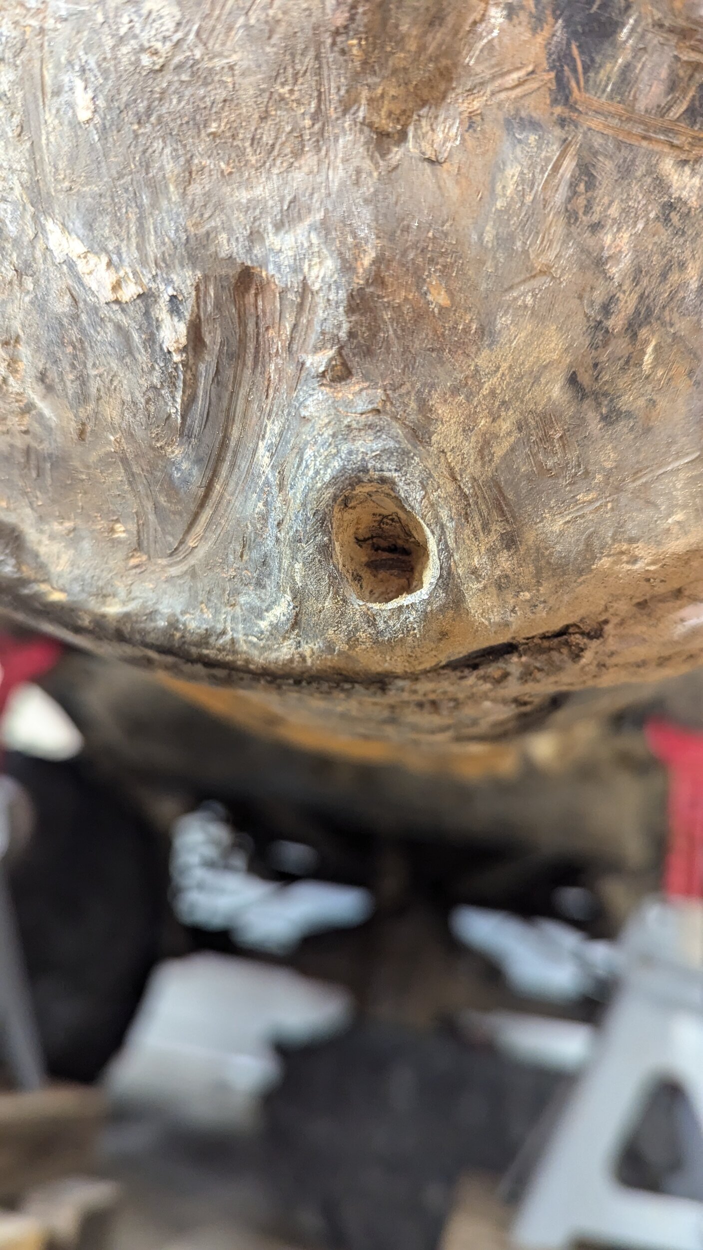

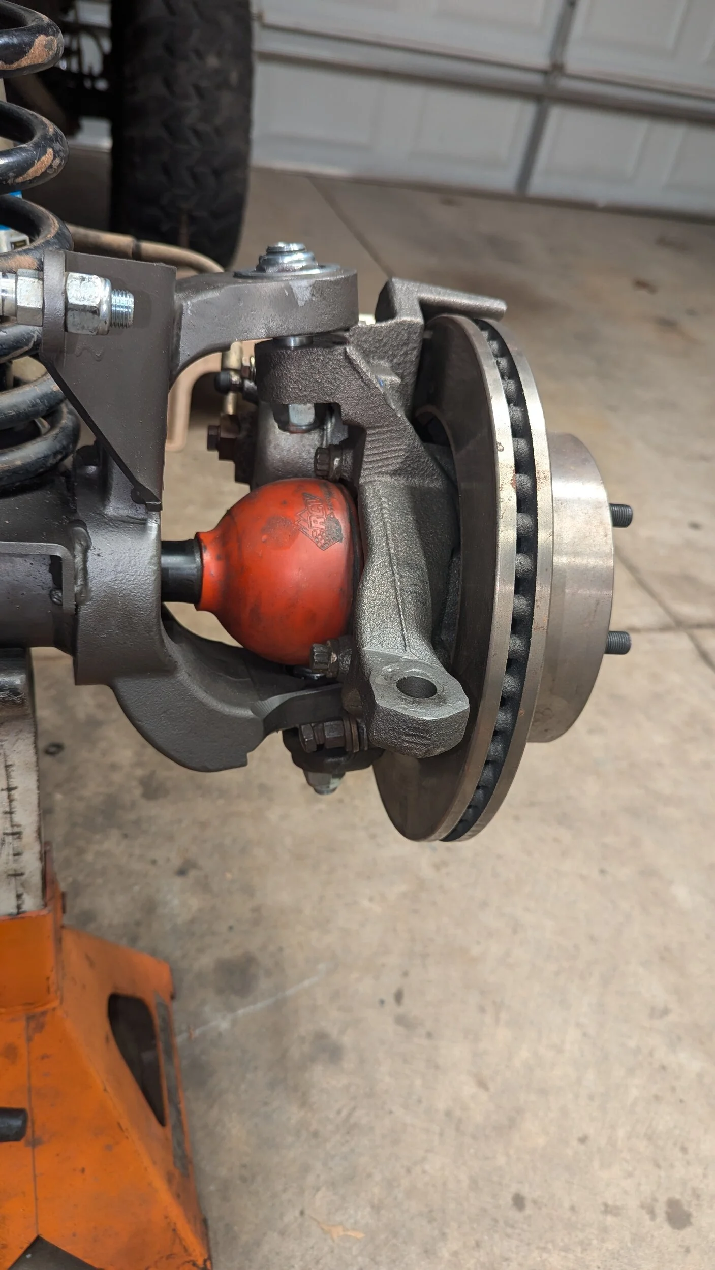

I did remove the ball joints and installed American Iron BJE.

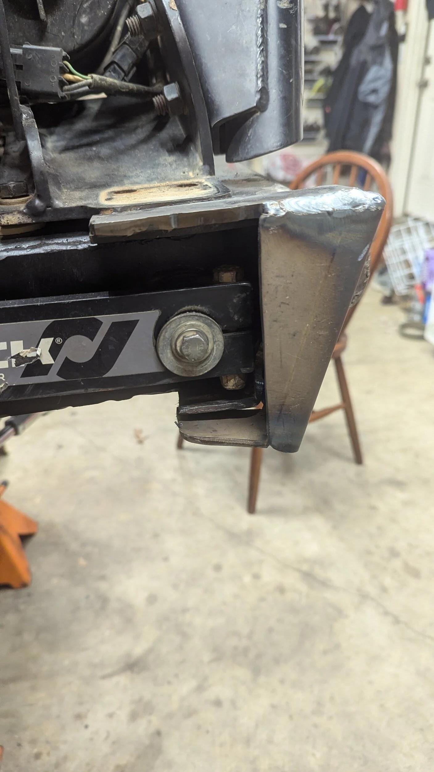

I did have a few more pics, here is the TNT steering box rotation installed. Notice how my bumper is bent on the ends due to hitting rocks.
With the bend in the bumper the antirock arm wouldn't fit, so I cut out the bent part and reinforced the ends.

Other than the new links it looks like the 3 parts to this stretch are steering box,track bar and coil perch relocation? Looking forward to how it works!

Just now finding your build thread. I like what I'm seeing. You will really like the front stretch on steep climbs. I did a very similar frame side front upper control arm bracket on my build. It's held up great for me so far. Keep up the great work!

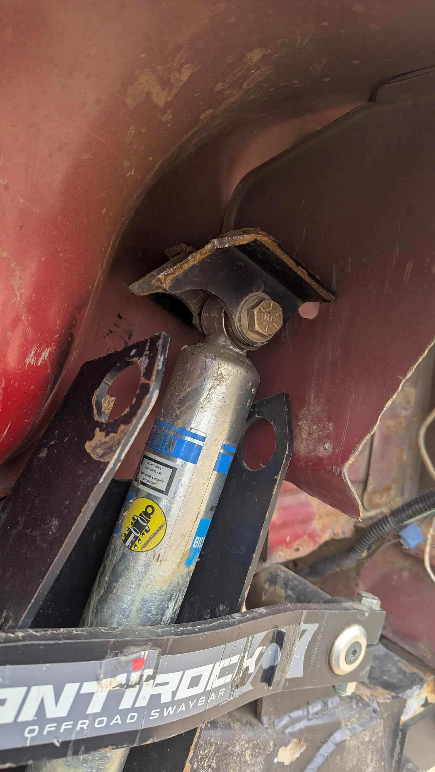

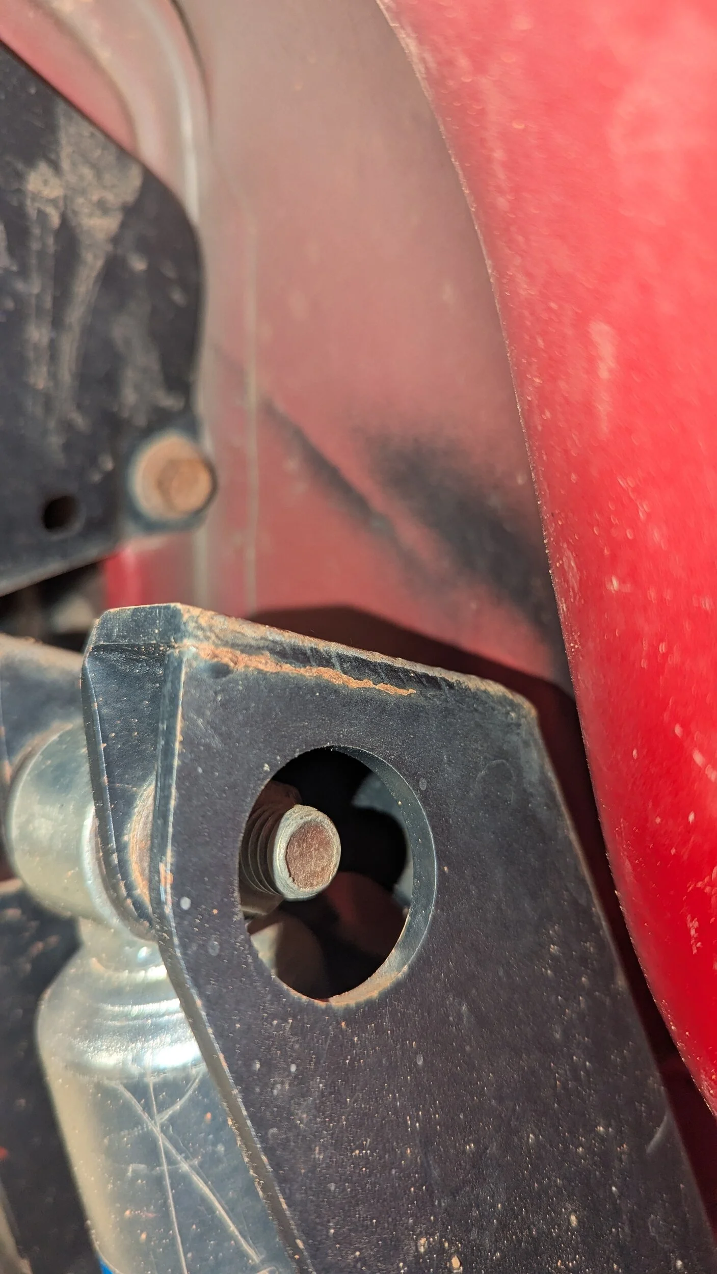

I then went to give it a spin around the block to see how it felt and something felt weird right off the bat, but it felt weird from the rear not the front, so I turned around and headed back to find my rear shock mount broke.
And yes, I checked the other side and it is also cracked.
