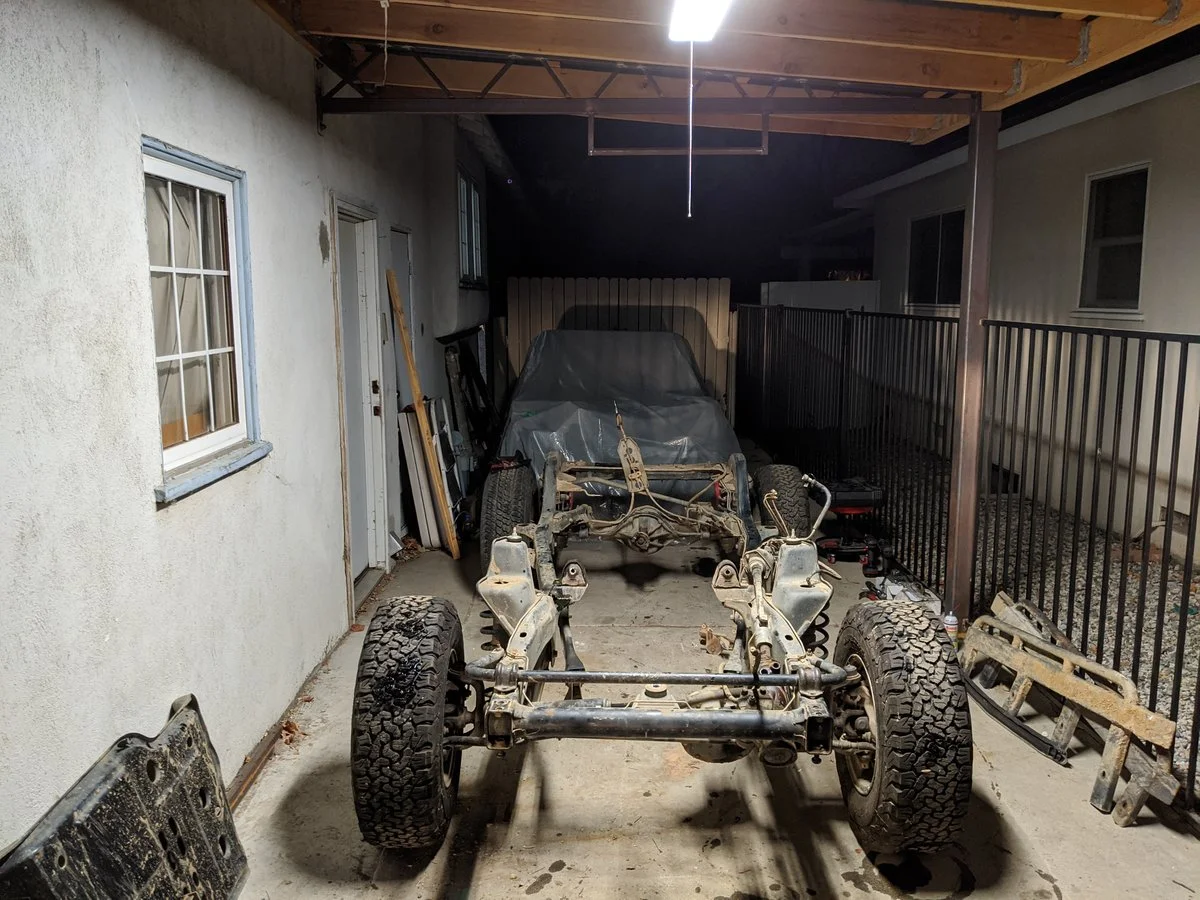

Got a few minutes of time at work :) . Where was I? Oh yes... the frame on wheels to the shop to check for straightness. Checked out! Hooray

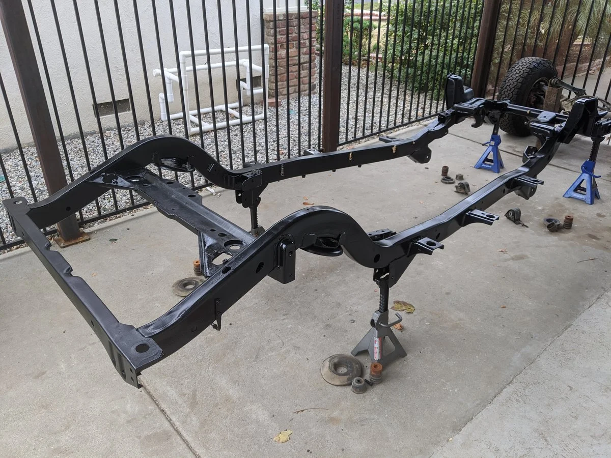

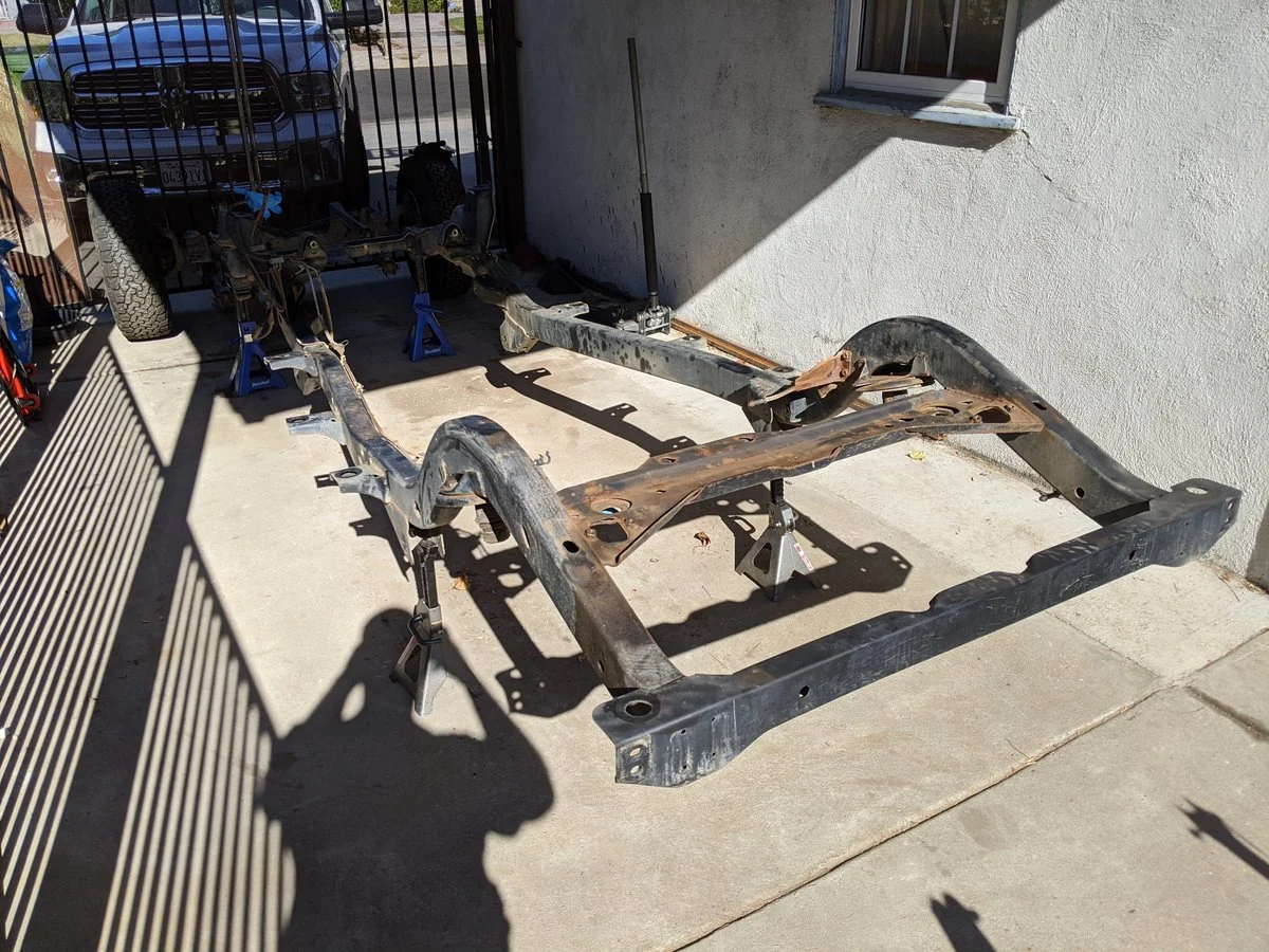

Until now, everything was just disassembly, but with the bare frame standing on the jack stands, it was time do some actual work. I decided to wire clean the entire frame and repaint it. Wow! It took many hours of hard labor under and over the frame to get every little crevice wire brushed and sanded down. Luckily, being a pure California vehicle, there was only surface rust, with most of it in the rear, right above the axel. I guess the moisture gets trapped in this area the most. I went through several large and medium small wire brushes for the drill and a dozen of small wire brushes for the Dremel. Oh yes, I burnt down the Dremel and ended up finishing the job with a cheap Harbor Freight one, which surprisingly held up to the abuse.
It took several hours to thoroughly paint the frame and when that was finally done, I felt good!
Boom ;)

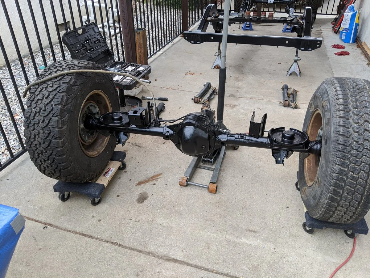

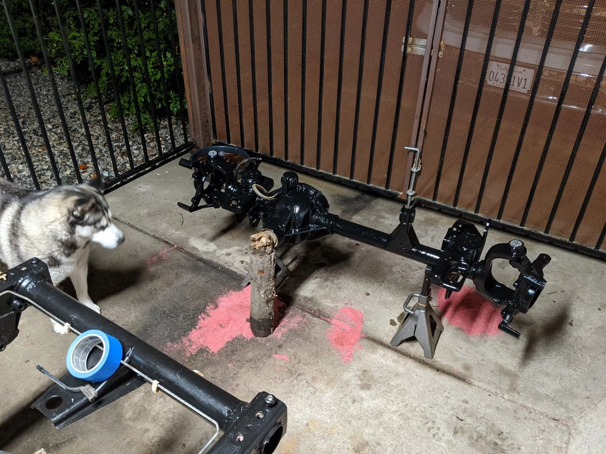

If you think that wire cleaning a frame is time consuming, try the axels! Yes, I took the time and did the same to the axels. Voila!
Rear
If you are wondering why I have the rear axel on dollies, that is because it is an LSD Dana 44 and you cannot easily reposition the axel without dollies.
Front
I lied. i did have help. My dog was always with me, doing the sniff sniff test on everything. You can see the inspector hard at work here.

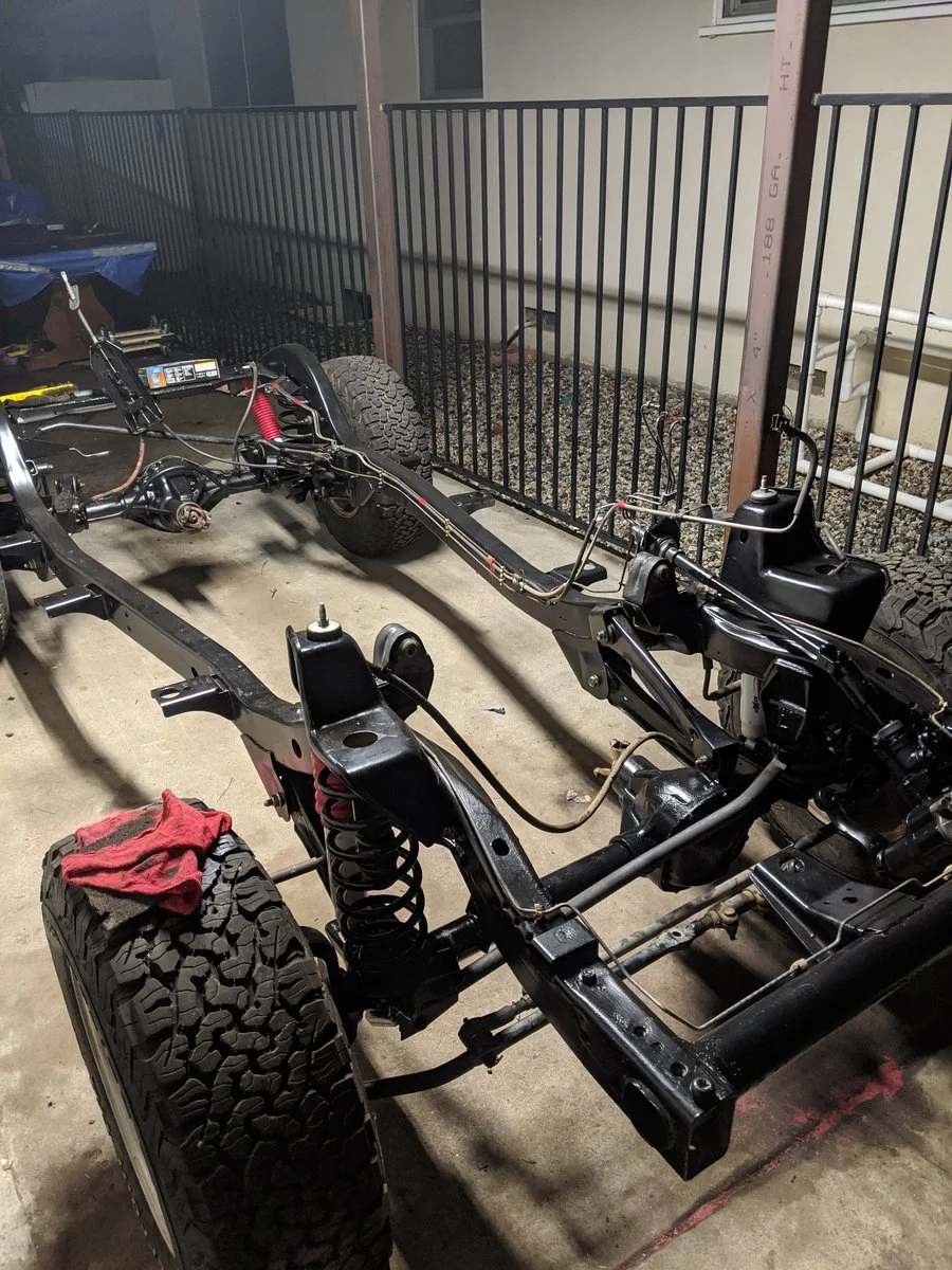

Ohh, almost forgot! cleaned up the brake lines as well... and yes wire brush and sand paper, coated the lines with matte clear protective enamel.
Finally I reached an important milestone. it was the first time since the start of the project that I was going to actually bolt things back together and not just unbolt them. Let me tell you: it felt really good!

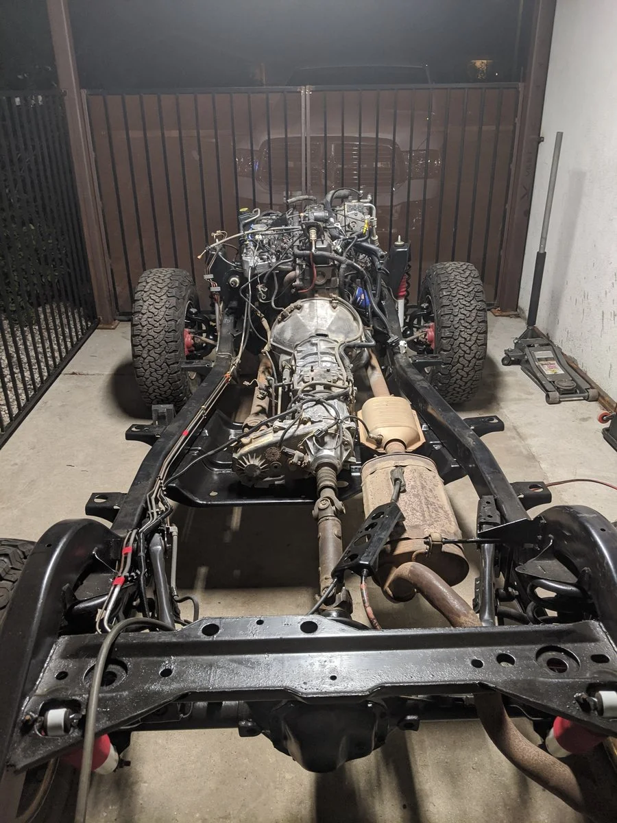

Since the motor was out and it was easy to work on, I decided to put in some wrench time. Removed the air intake manifold and the exhaust manifold and did what? correct :) wire brushed and cleaned.
  • Replaced the gasket and the rusty bolts (one of them was a PITA to remove, but the heat eventually did its job).
  • Cleaned up the fuel injectors and
  • Repainted the fuel rail.
  • Replaced the o-rings on the fuel injectors
  • Wrapped the fuel injectors with heat resistant fiberglass cloth and taped reflective heat resistant aluminum foil over them. (Did you know that the 4.0 injectors when they get too hot evaporate fuel?)
  • Noticed that the fan was not turning very easily. Figured the cost of the new fan clutch was insignificant next to all of the money I was going to spend and replaced that too.
  • Finally, I took a Dremel with a wire brush to the transfer case and the transmission to clean. Half way through, I realized that it was going to get dirty in a single trip involving mud, felt like an idiot for a second or two (bah..meh..) and stopped half way. :)
  • Sanded and repainted the skid plate
I am sure I missed a few items here and there but its OK. It was time to put the motor with the transmission back on the frame. Did this easily alone with the chain hoist. Ohh, MT-90 into the transmission, because I spilled all of the transmission oil out removing the engine. Did you know that the transfer case was the only thing keeping the tranny oil inside? I had no idea (meehhh).

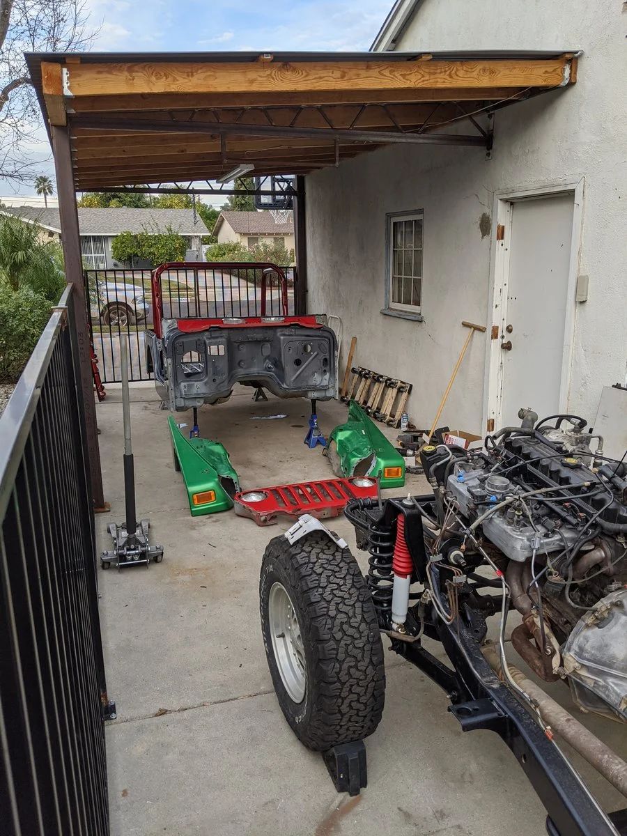

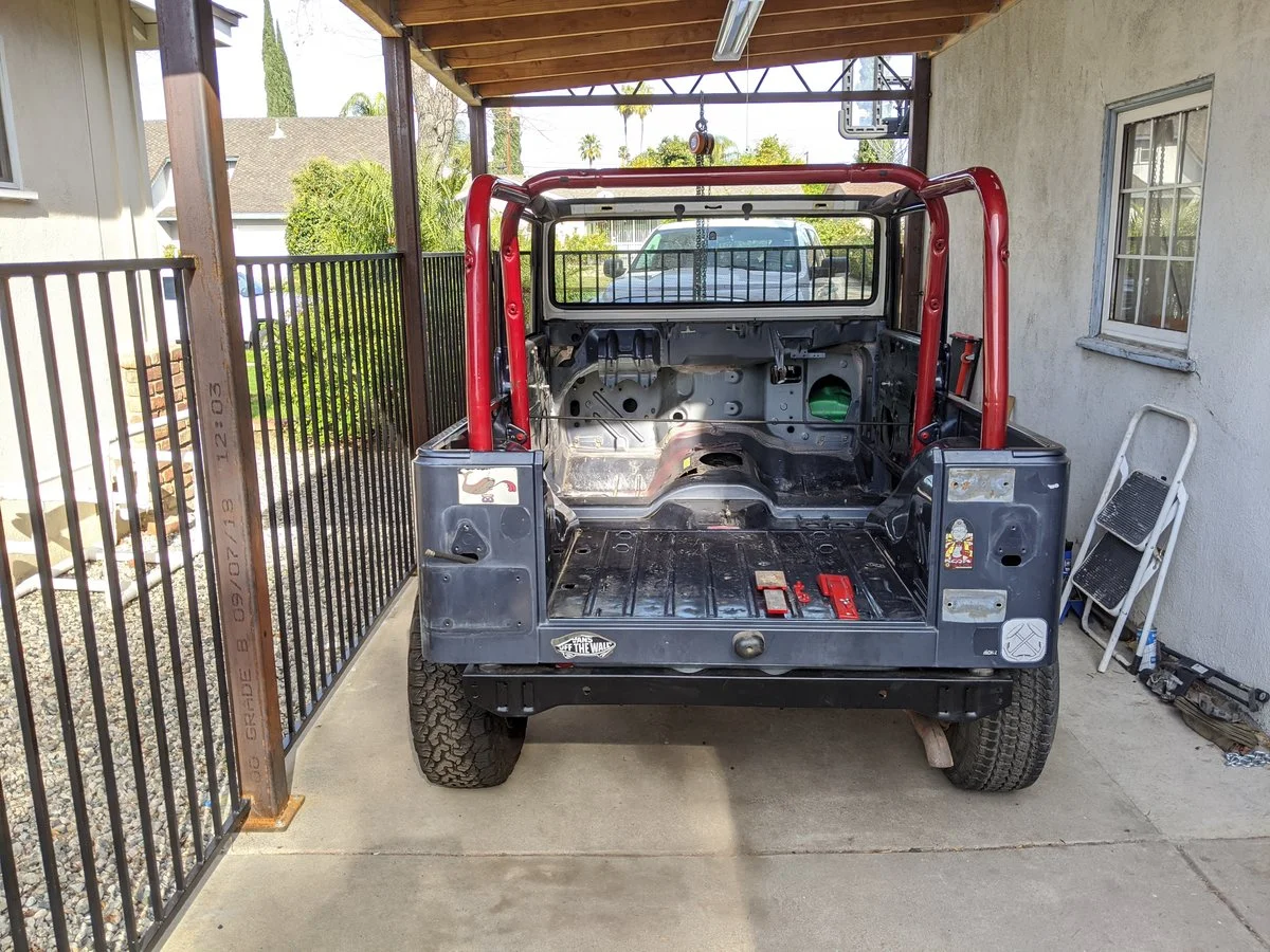

We will get to the rest of the parts later, but here I was, looking at parts, imagining the amazing day when those multicolor parts would actually be a single vehicle :)

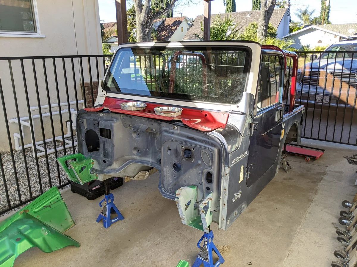

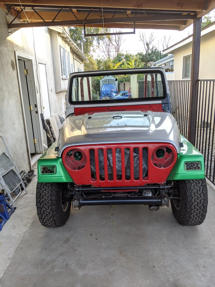

Started test fitting the body parts together, adjusting the door hinges, windshield hinges, fenders, hood... I could not wait to make it look like a Jeep again. On a side node, my dad suggested I assembled the Jeep as is without painting and drove around like that. I thought he was joking, but he was serious. few days later, after I recovered from a virtual heart attack, I was looking at this ;)
Pauses.... deep breathe... awhhh, my Jeep (wife frowning from the kitchen window, feeling how she is loosing the battle to a piece of metal called something Jeep...)
