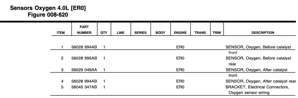

On the NTK website instead of your first one of NTK23158 they list NTK23018.
Strange because the factory parts list has the same part for two of the sensors but the NTK website lists 4 different parts.
Are the upstream sensors interchangeable? Was is the difference between 23159 and 23160 other than cable length?

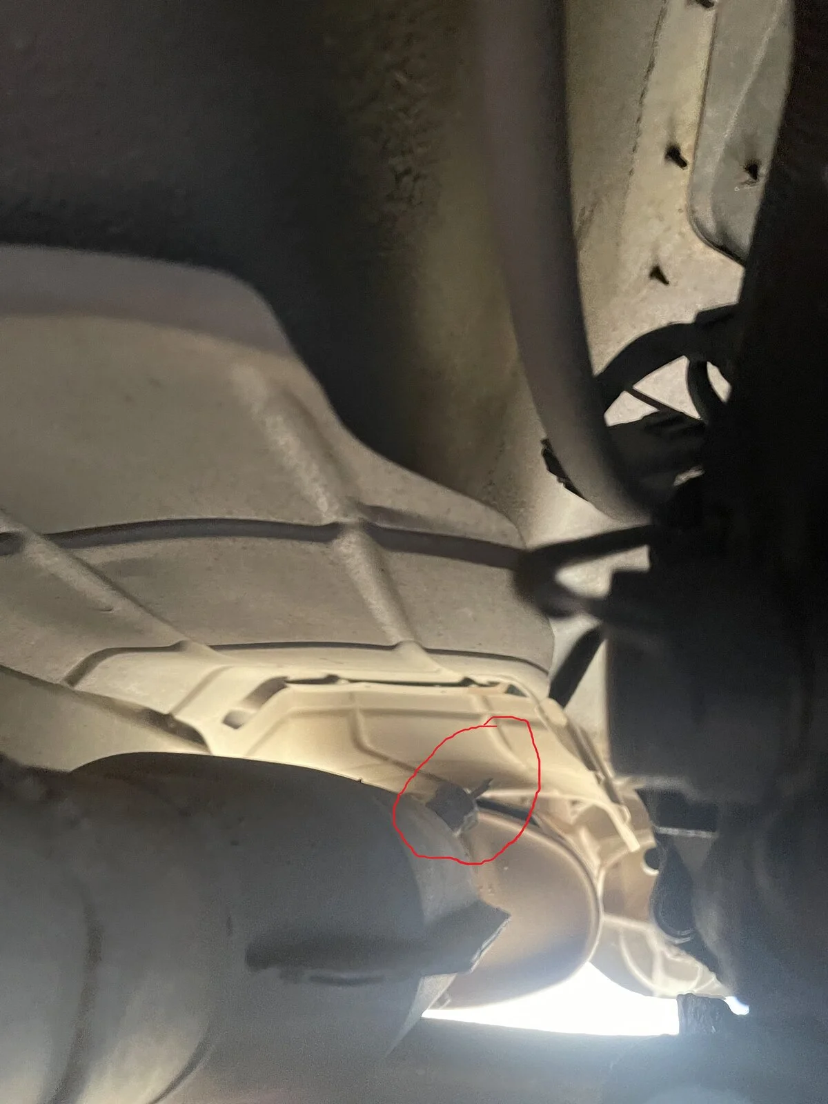

I've got a '97 2.5L. I can only find the upstream sensor that's in the engine bay (by the firewall just south of where the manifold meets the exhaust pipe). Where is my downstream sensor located?? I'm getting a P0138 code. I followed the exhaust pipe around the engine bay, but can't find this second O2 sensor. Can anyone point me in the right direction?
it should be just after the catalytic converter usually above the skid plate
Ok, thanks. Could this be the remnant of the old O2 sensor? It's behind the cat up above the skidplate...but I can't see much of it. Don't even see a wire harness for it anywhere.
Reactions: reddvltj
I'm looking to do this soon on my 97 2.5L. Let me know how it goes and if you learn any lessons worth sharing before I try.
