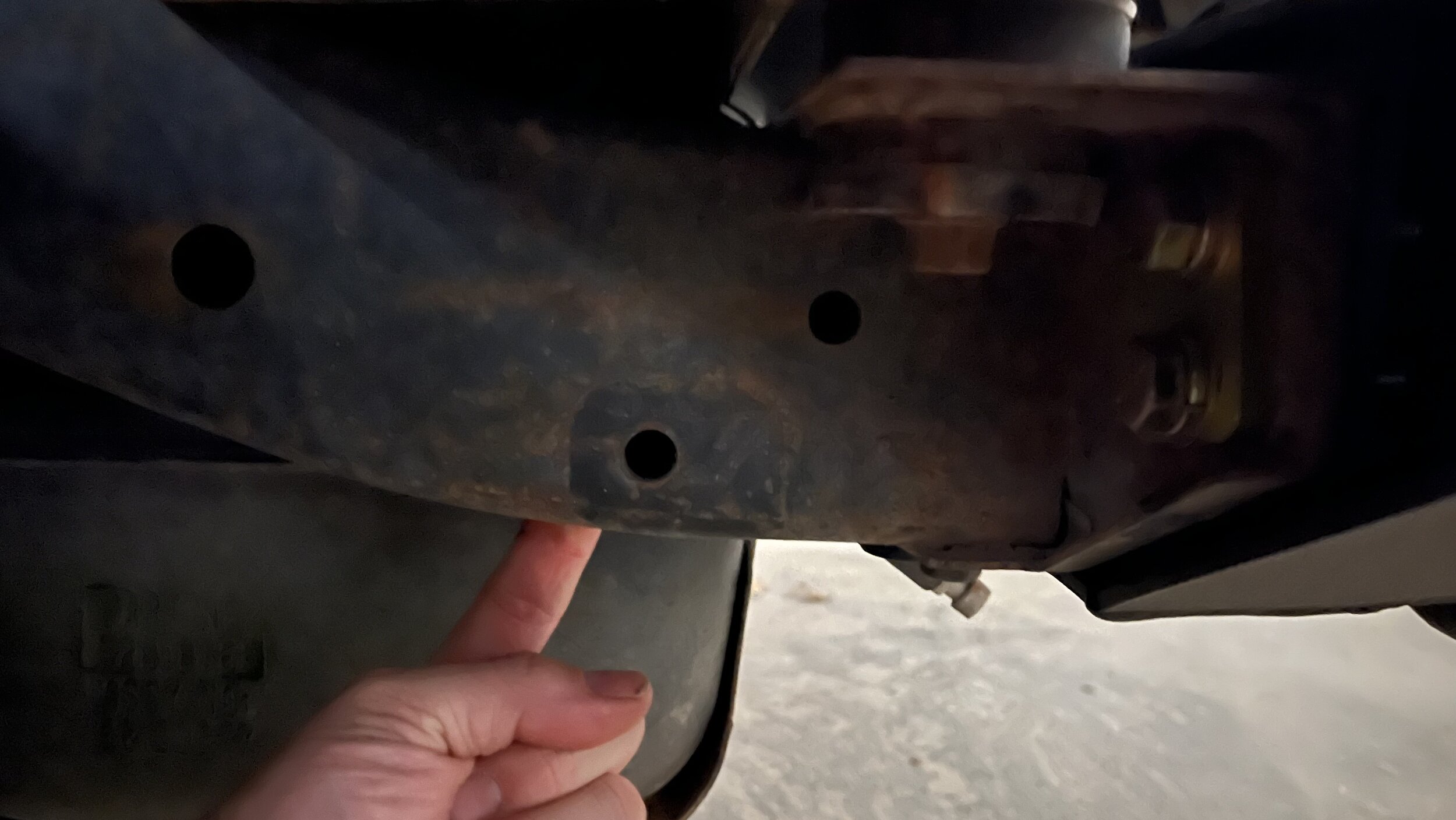

That hose (rear axle breather tube) sticking out the bottom should be zip tied up behind the bezel for your gas cap.

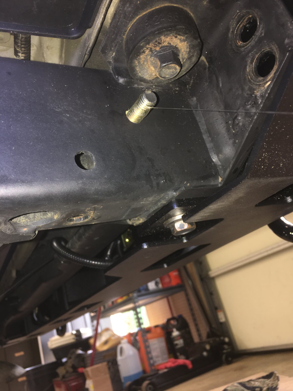

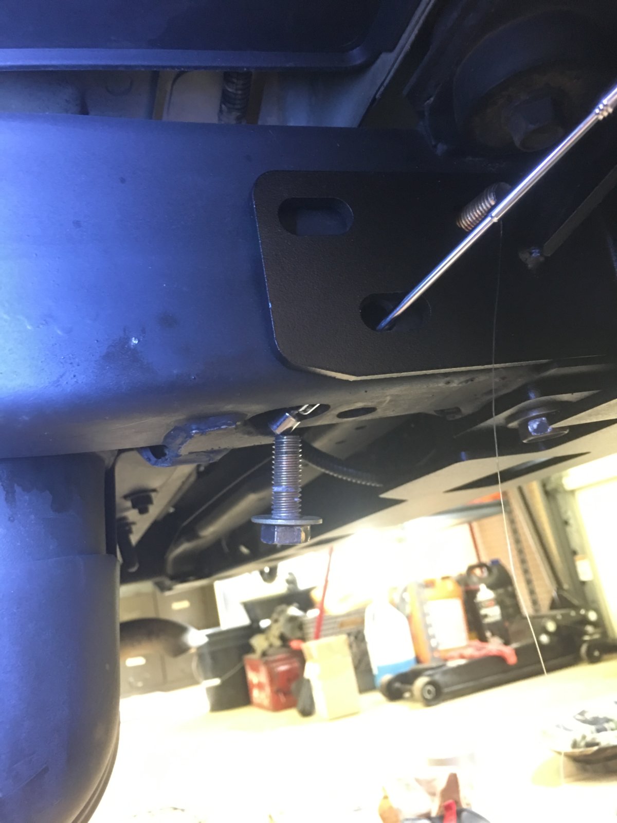

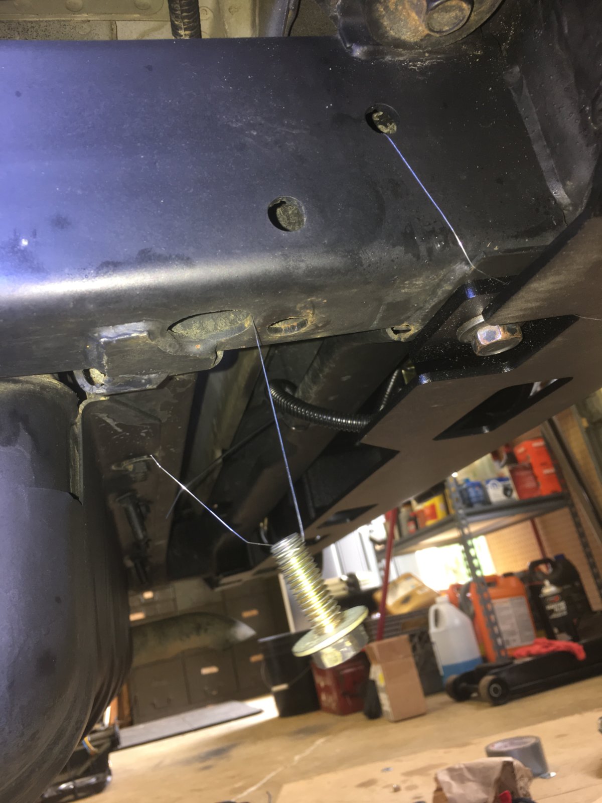

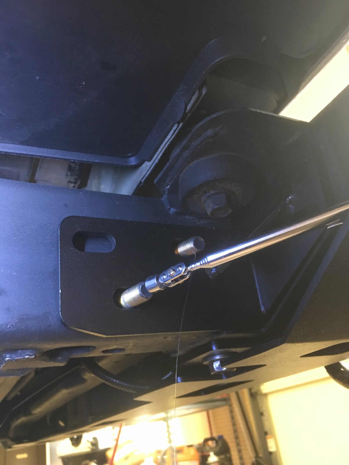

I used some fishing line tied to the upper bolt to pull it through the bottom opening in the frame. The bottom bolt wasn’t to hard to get installed, but a magnet made it very easy. A boxed end wrench fit up through the oval hole in the bottom easily to hold the bolt heads.
