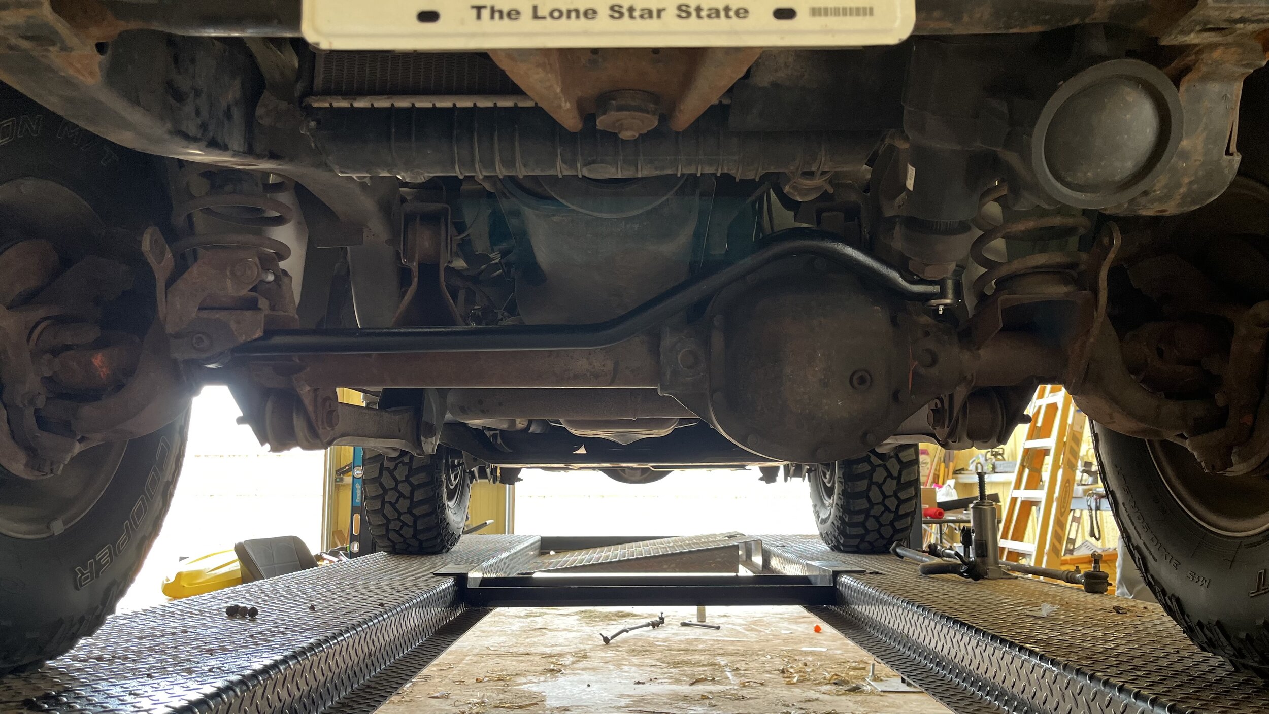

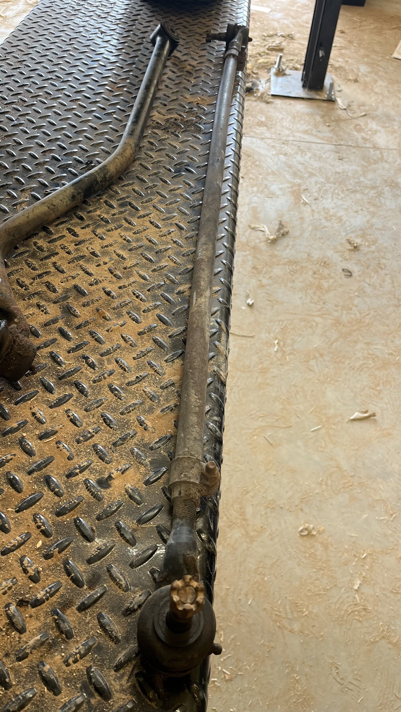

Finally some progress! 2 forward and 1 back. New Track bar, check! New front shocks, check! New steering linkage…I messed up and ordered RHD parts…so another round of parts and hopefully I can send those back. 14YO did good work today but he’s going to need to hit the gym if he’s going to work on rusty old jeeps hahahaha.
Stock tie road definitely has a bow in it and the steering stabilizer was basically a place holder. The rod was jangling around in the body, hahahaha.

The new correct steering kit I found is essentially a heavy TJ drag link with a ZJ tie rod all as a kit. I can’t return the RHD steering because it’s been too long. Hoping to find a local that needs an RHD steering linkage setup for cheap so I don’t have to eat the whole thing.
We got the steering mostly on, about 95% done. Still need to tighten the stabilizer bolts.

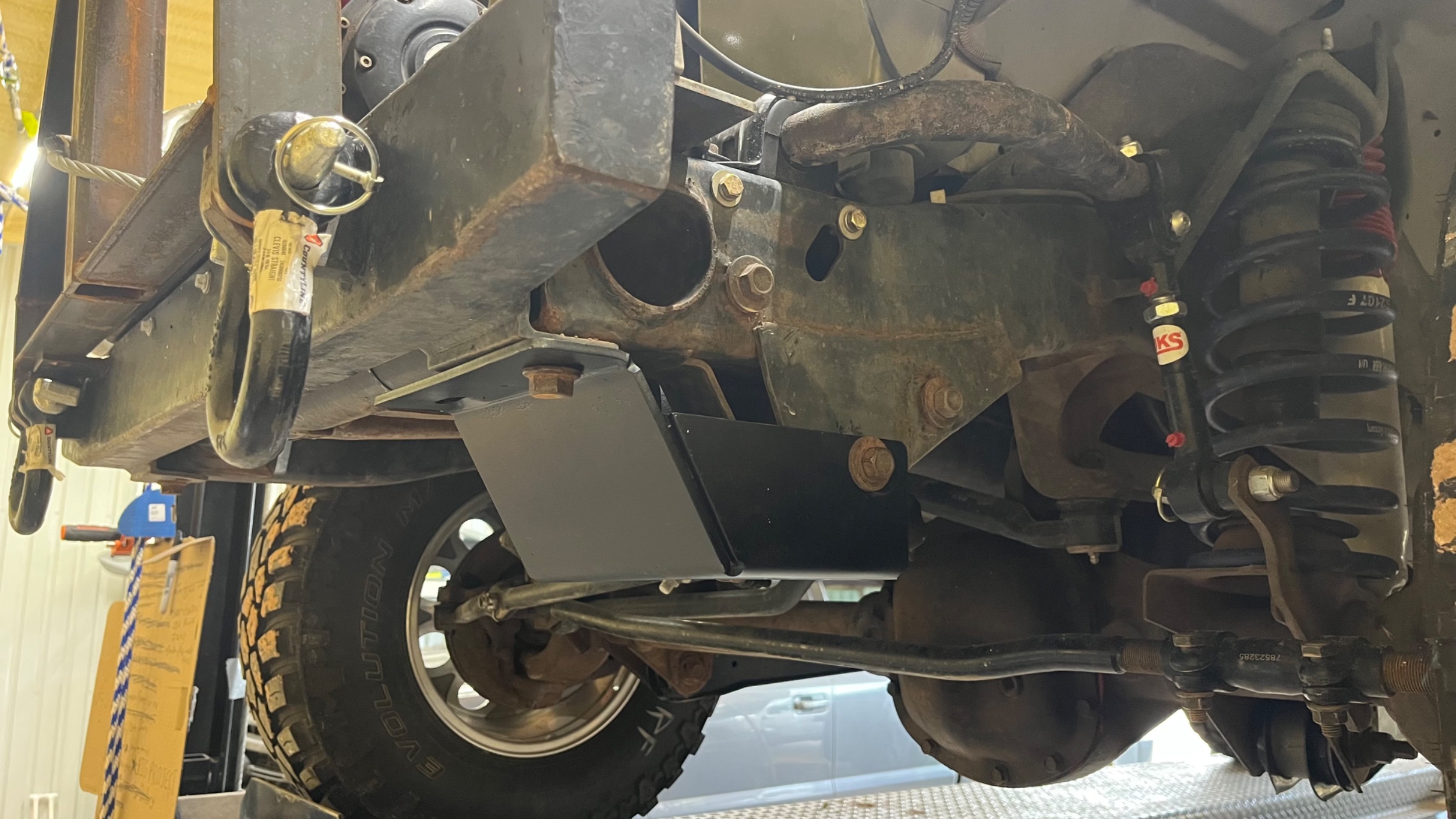

1 new lower control arm is in, the one that needed replaced(driver front). I ordered 2 because of one side needs replaced the other does too. Well they sent me 2 different stock style arms so I have to get that sorted out.

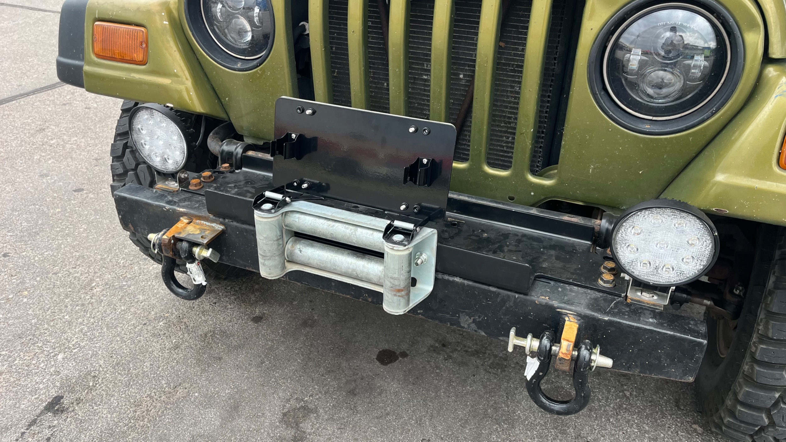

Winch is essentially just mocked up. It can ride there a while but the washers under the plate aren’t ideal. Feeling like it’s a just a little jeep now with that up front.

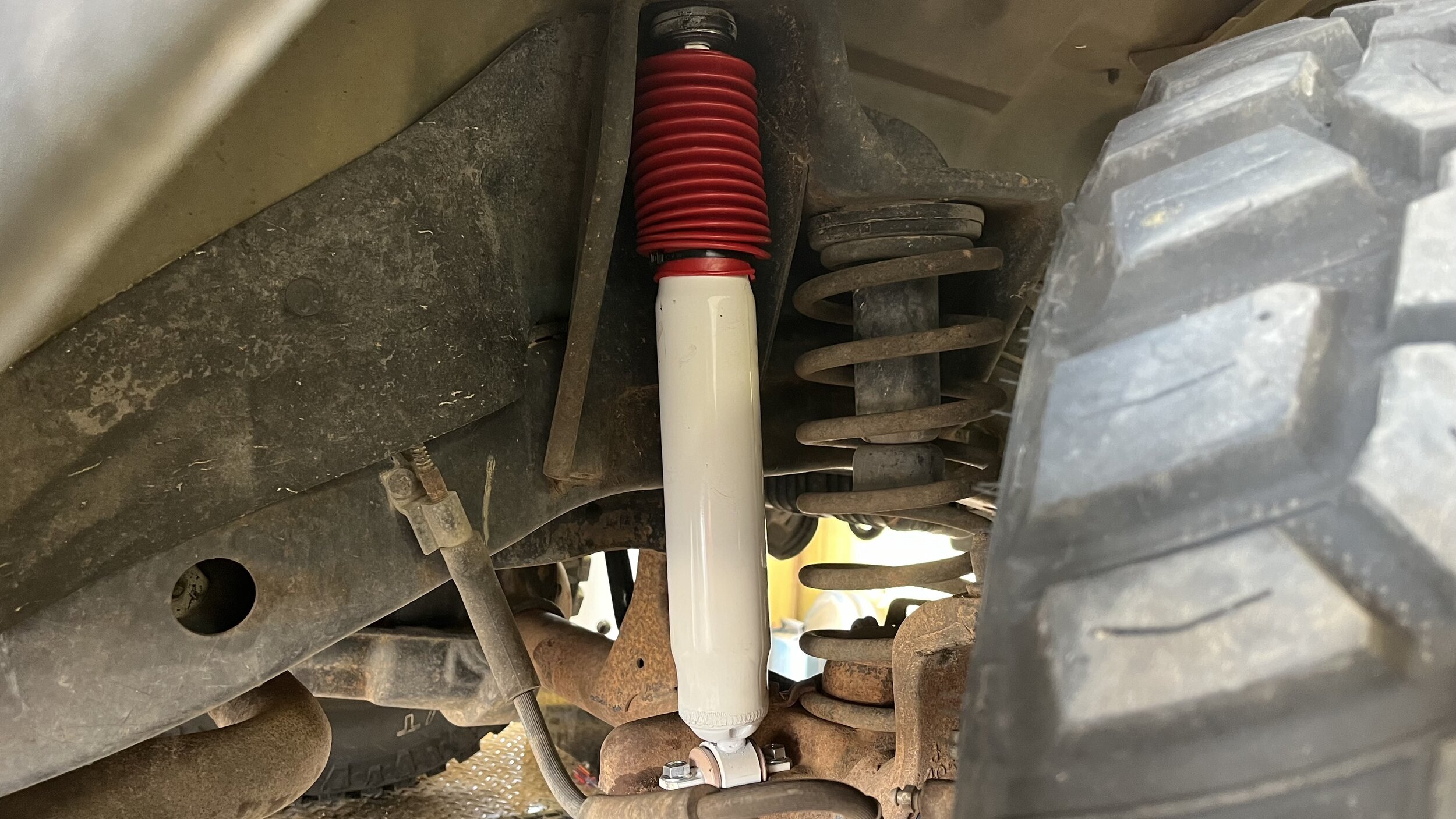

New front shocks, done

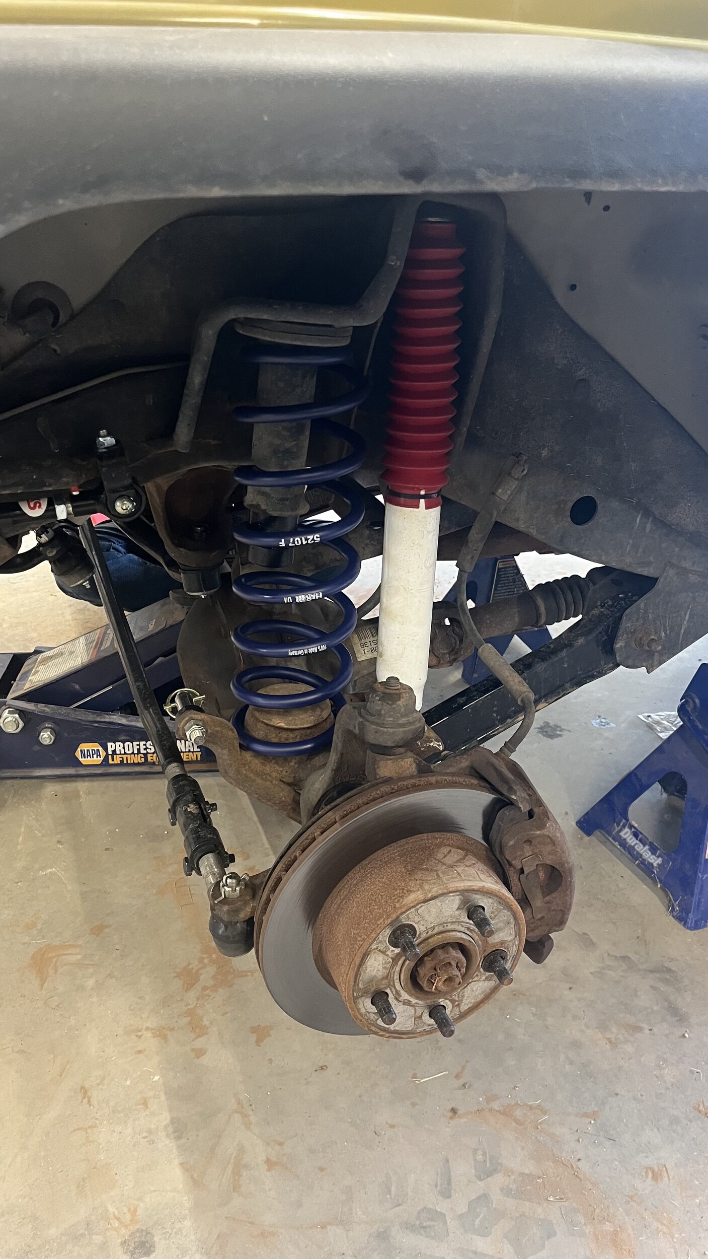

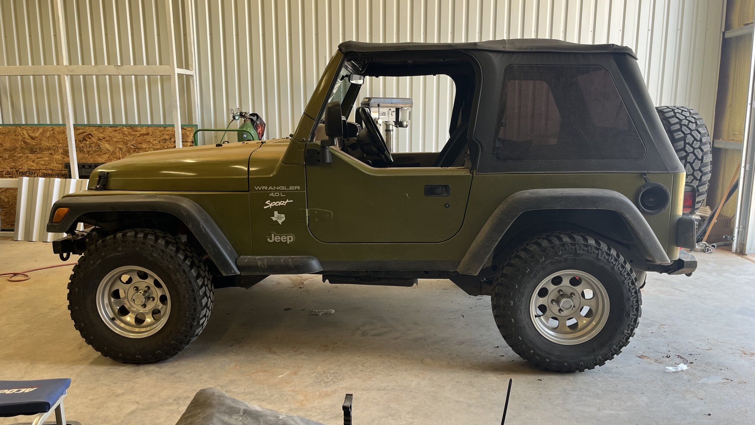

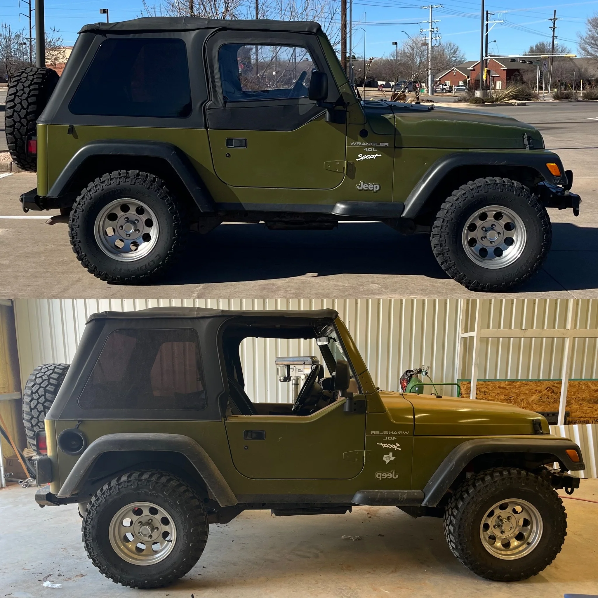

Another big milestone in the build. The H&R Adventure Springs and extended bump stops are in! My son and I did it over the course of a few days 20-30 minutes at a time as we could. Took about 2-1/2 hours and all done.

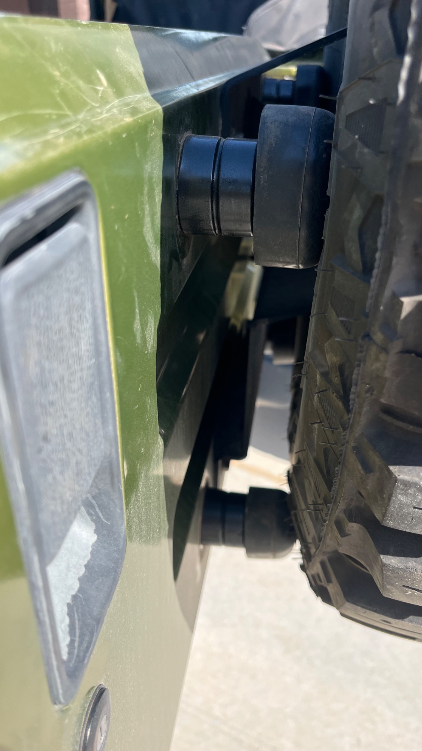

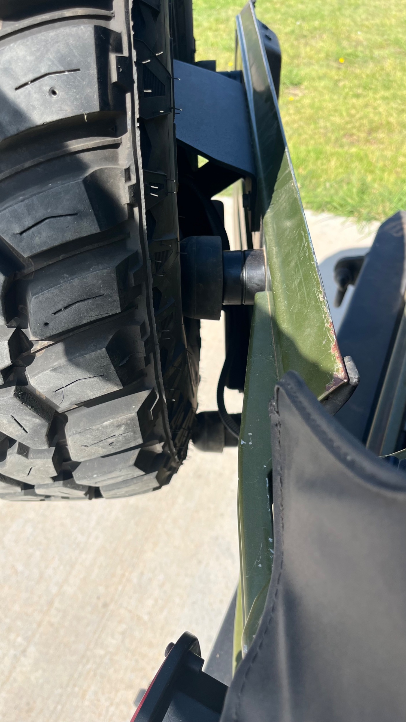

Another minor box checked was extending the tailgate tire bumps for the aftermarket spare mount. It moved the tire out and up for bigger tires. We used the part we cut of the extended bump stops from the lift to space the stock pieces out 1-1/2” or so. It only cost us $5 in hardware that I got free with a tractor supply reward coupon, hahahaha.
Will add a picture soon.

As promised, here are the tailgate tire bump extensions made out of the left over pieces from the suspension extended bump stops. Longer 1/4” bolts and bump stop off cuts.

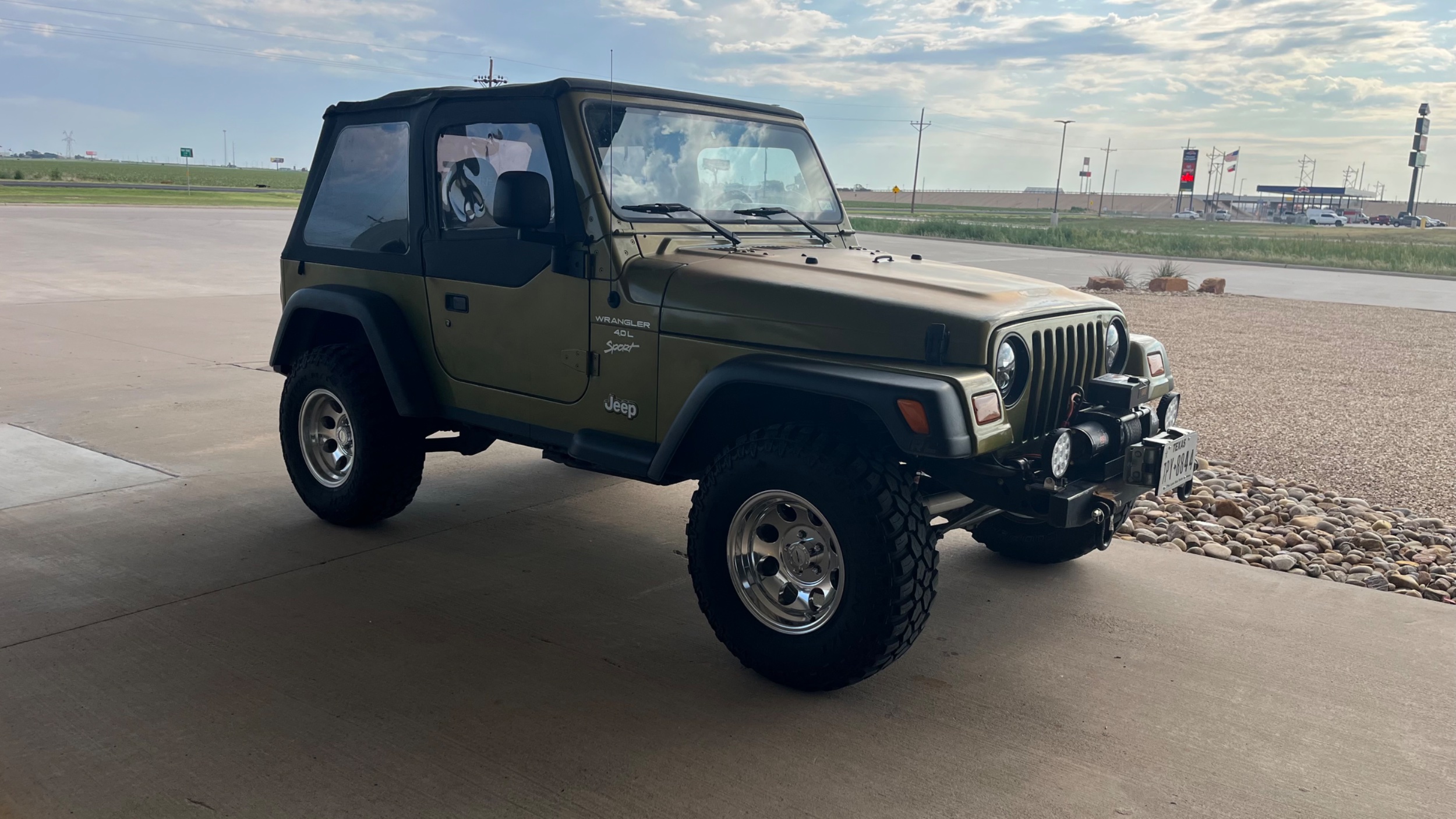

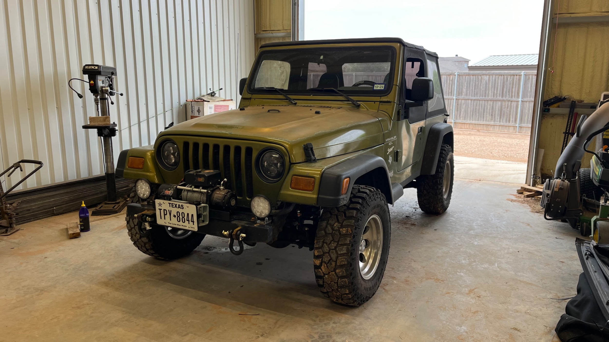

New roller fairlead LP bracket is on and we have a plan to get the winch plate fully fitted with the winch. Definitely a big part of this little jeep appearing and being ready to get some real dirt under the tires. My son is a real Jeep guy now and definitely wants a little trail cred so to speak. He’s driven around 200 miles of Colorado Jeep trail now and really wants his Jeep be seen as a “real jeepers jeep”.
We did our big CO trip in my JKUR and he is fired up ready for next summer and taking the TJ instead. Definitely have to get real picky on gear for next year if we aren’t taking the big wallowing marmot(JKUR got a new name, haha)

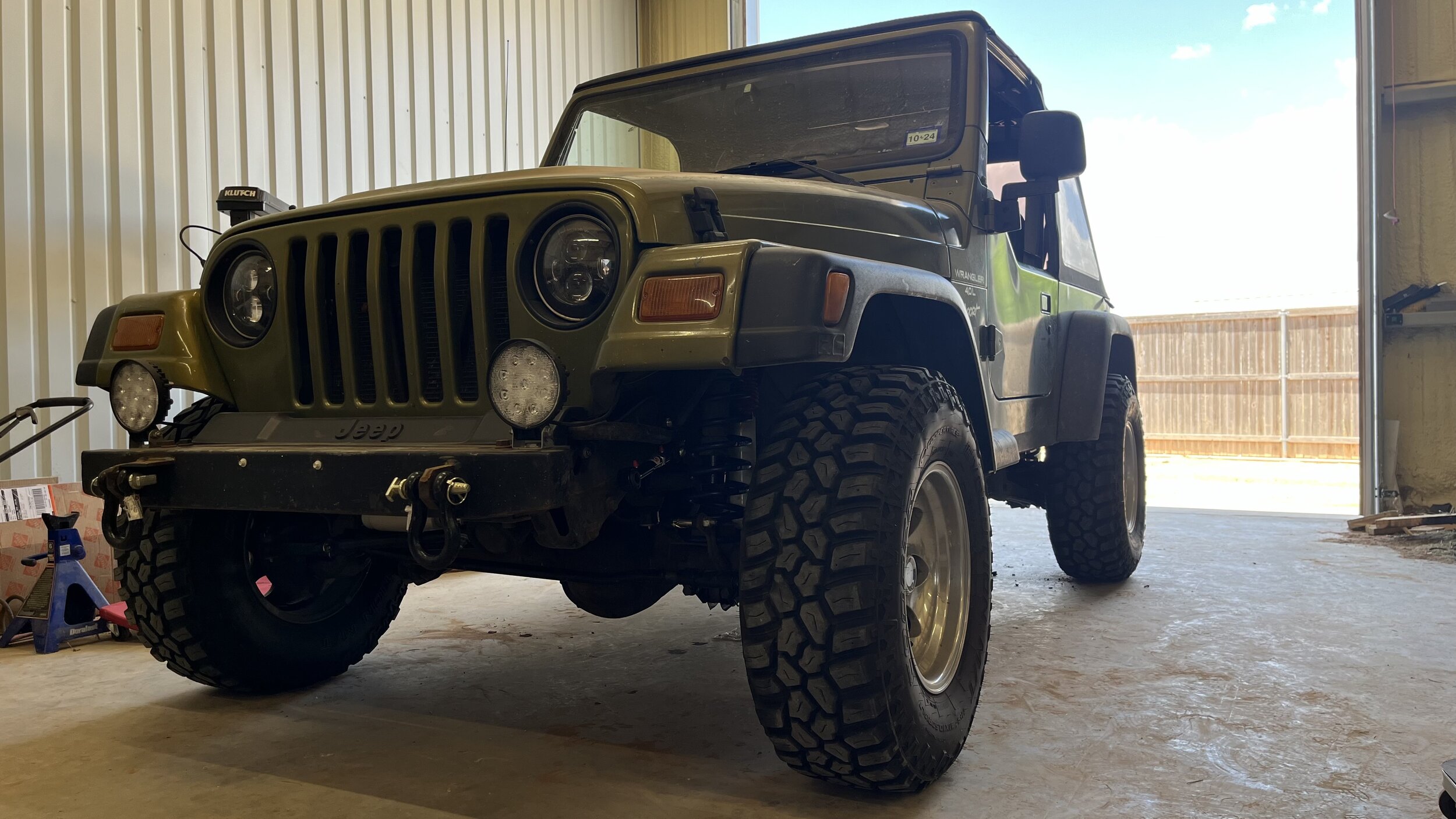

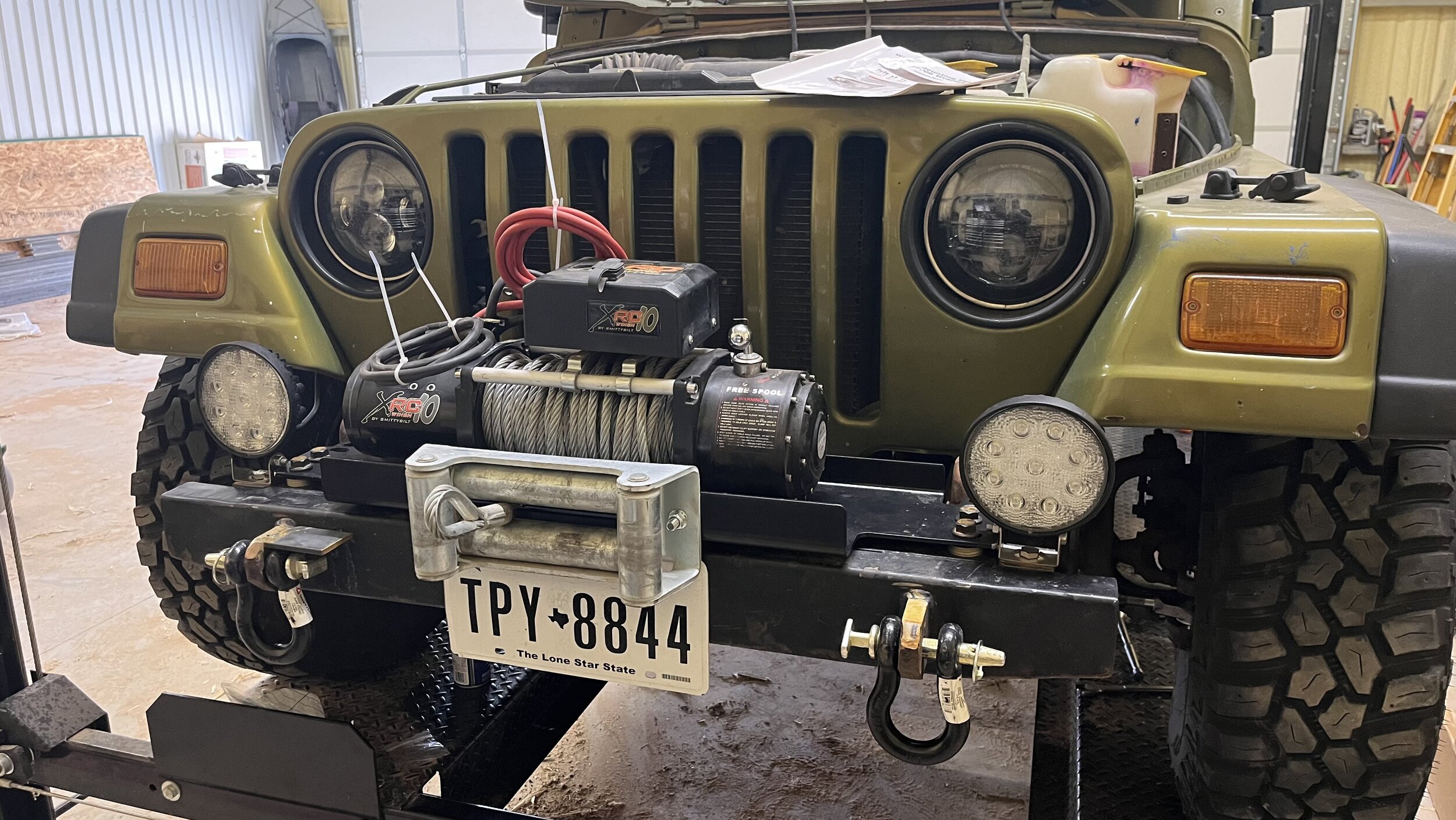

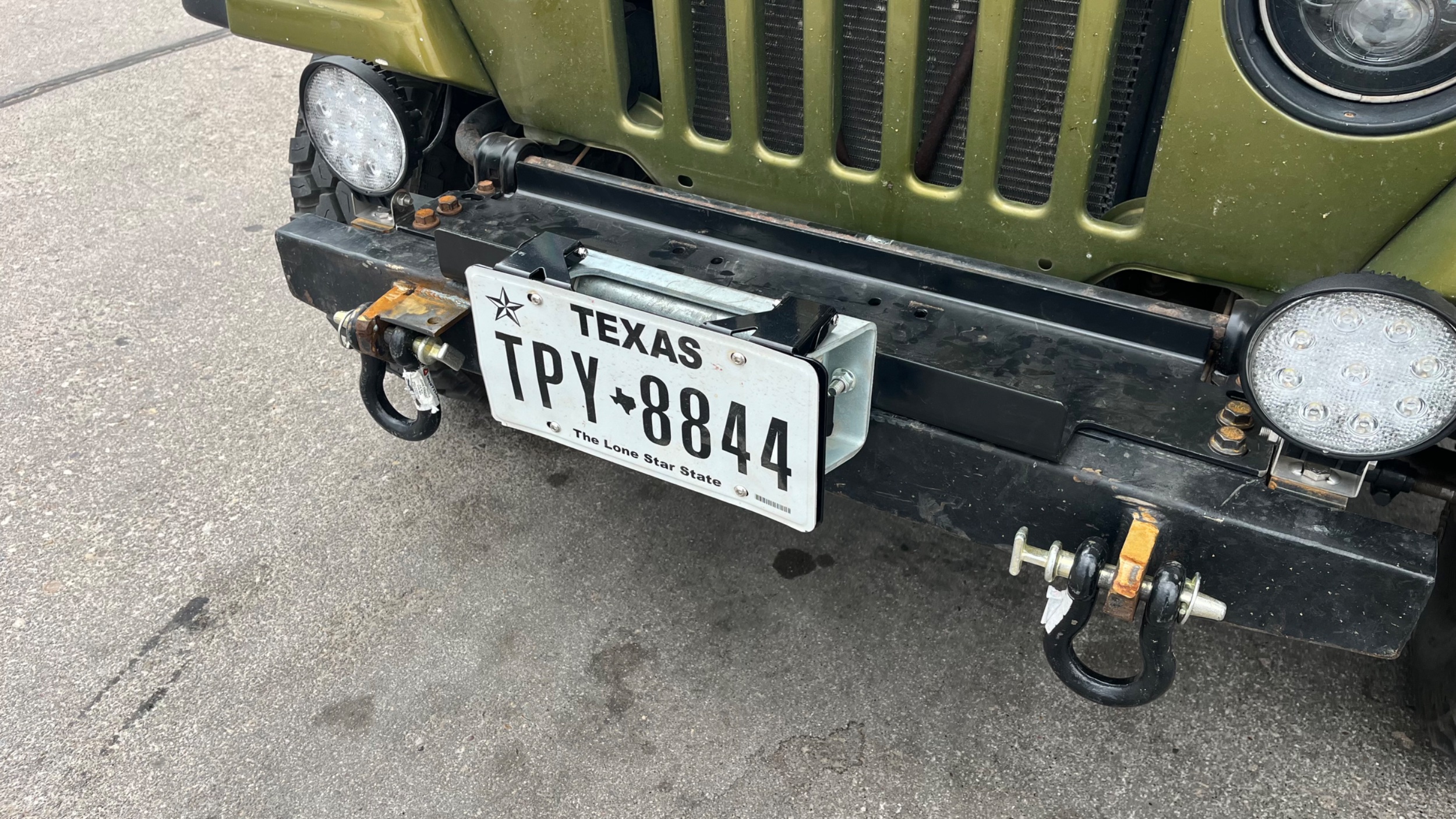

Winch is finally on! Instead of the original plan of building a winch plate to work with the aftermarket bumper, we modified the bumper to work with a basic quadratec winch plate. Drill a couple 1” holes in the bumper for the bolt heads to fall into and that fixed all the problems and it bolted right up. Fished the hole slugs out with a magnet. At some point we will blow apart the whole front bumper/winch/fog light setup and paint everything nice…that day was not today. This little jeep is really coming into its own and we are going to have to get some dirt under its tires soon.
