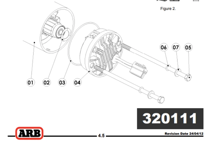

It really shouldn't be as difficult as it is to get bolts 05 to catch. Got one and while trying to get the other side to catch it ruined the O-ring. 🙄

It really shouldn't be as difficult as it is to get bolts 05 to catch. Got one and while trying to get the other side to catch it ruined the O-ring. 🙄 View attachment 699807
Every time I've had trouble getting the bolts to thread into a cap on an electric motor, the brushes were hanging me up. Granted, I've never disassembled an ARB compressor motor...

Putting the end cap on an electric motor is an exercise in patience, for sure. With those bolts, it takes some dexterity and feel. About the time I get to the point of frustration you were at, Jeremy, I usually move on to another project to take my mind off it and cool down. That works very effectively for me, and when I get back to it, I often times have a "why was that so difficult" experience. Hang in there, my friend. You're smarter than those parts!
I was able to get the brush cap flush to the motor housing and bolts still not catch. I feel like these bolts are just barely long enough. I can't imagine once they catch you get more than 2-3 threads tightened down. If they could just be a little longer it would help. The head of the bolt is against the brush cap housing before you even get any threads started. I have to pack my socket full of paper towel to get any pressure on the head of the bolt. It is an exercise in patience. At least I got one and now I can try to source an o-ring locally. I really don't want to order something like that and probably pay $12 shipping and wait 4 more days just to see if I can get the motor to start.

Well, the o-ring is just a seal. You can see if the motor will start without that. You can technically run it with out the bolts, as long as you have a good way to hold everything together (zip tie around cans, ratchet strap, etc)

I picked up an o-ring today. It may or may not seal. The o-ring is recessed, so I don't think it adds any distance to the threads. Still having trouble getting the second bolt to find the threads. I worked 45 minutes on it. Had to quit. Ran out of time. Maybe I could try to start it up with just one bolt threaded. Geez...All they needed to do was add about 3/16-1/4" to that bolt
